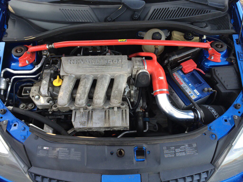

Hi, got a picture see below. Hope it loads ok
I'd personally recommend a ph1 Clio standard airbox (with the ITG or a Pipercross filter inside) and you could possibly cut that red hose down to fit, or just get a ph2 standard induction elbow for use with it.

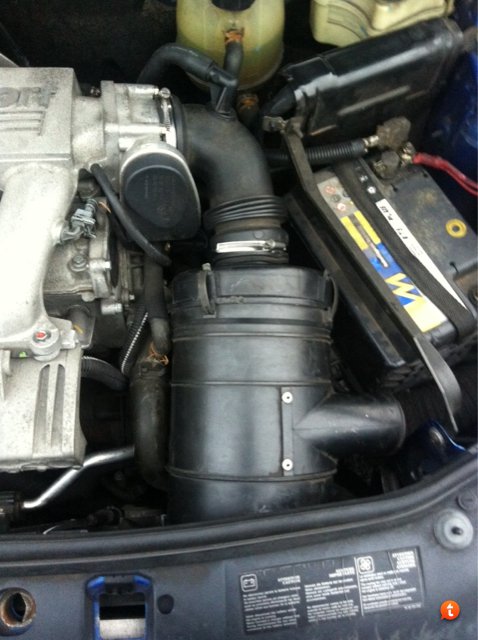

Here is a photo of what one looks like:
That's a ph2 induction elbow with a ph1 airbox. The ph1 induction elbow won't fit in a ph2.

I'm sure the previous owner left a pipe under the passenger side front light that goes all the way to the bottom would that be part of this unit? It's part fabric coated, I think? Is it true that the standard runs smoother than the induction kit I have fitted in the above picture?
the problem you have is your induction kit is located where it will intake a lot of hot air! you would be better just buying another elbow and locating that filter behind your headlight! would cost £13 for the pipe!

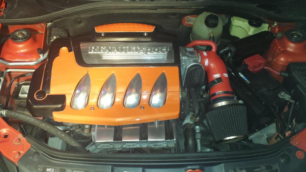

that's what I'm running, if you search fattys induction kit on here you'll find a lot of other people are also!
Looks good dude, I see what you mean by the intake I did look at the maxogen but the price is a bit costly haha! Do you know a good place that sells that fatty kit? Would you rate it as good?
  clio 182
fattys kit is his home made equivalent to ktecs induction kit! you would just need the other elbow I have being about £14 off eBay and I would say a new filter but you could use the one you have if you wanted? filter would be about £20/25
