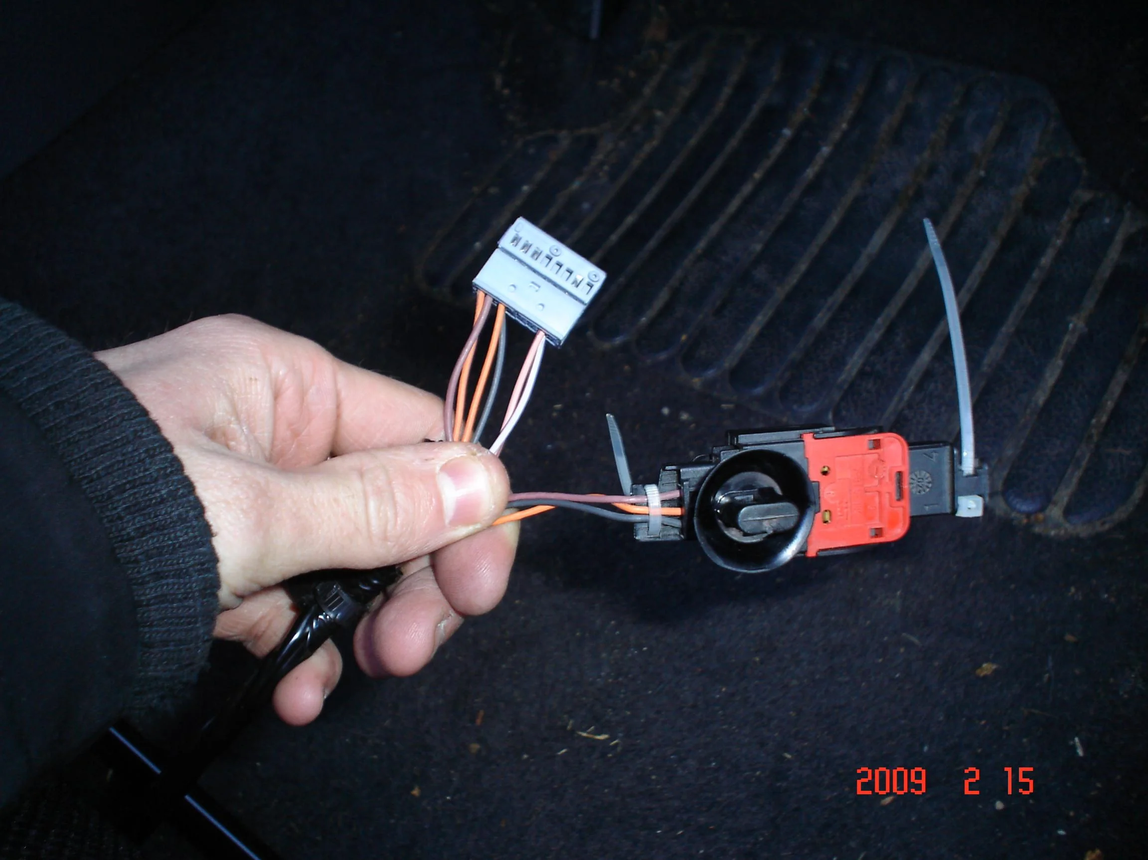

Hiya guys apologies in advance as i know this has been covered 1000 times but i cannot find the answer im looking for as the search button is useless. Just fitted buckets in my cup 172, got a 3.3ohm resistor, but where does it go? any help much apreciated.

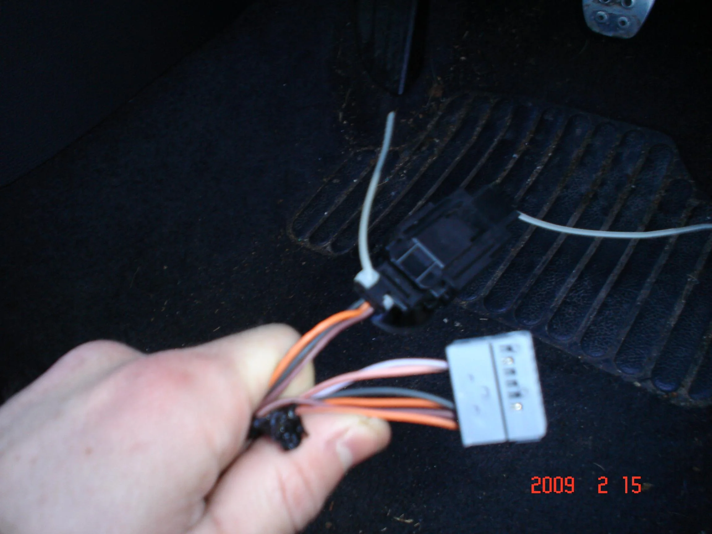

Here is what's under the drivers seat.
You need to stick it between the Orange and Brown! wires dude on the black connector
