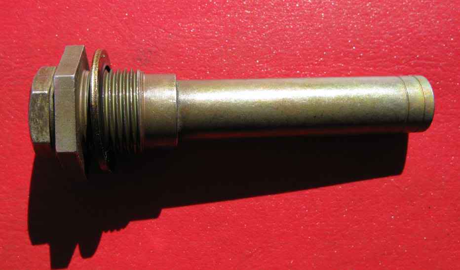

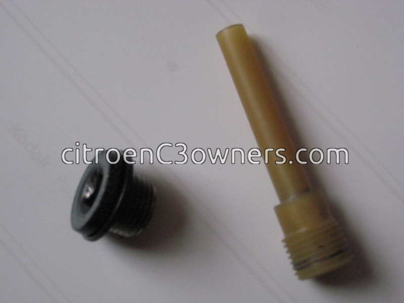

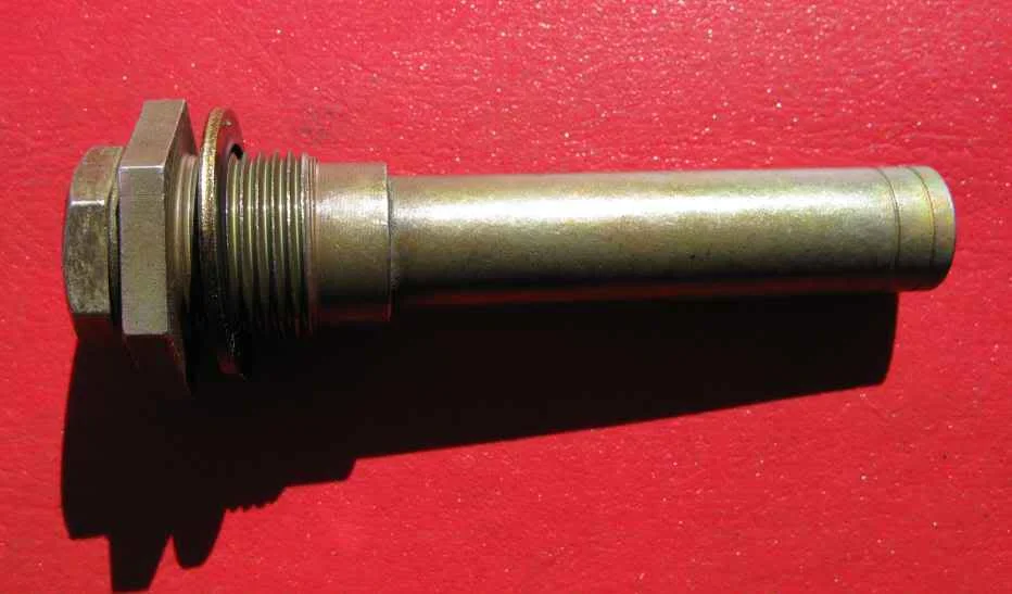

There is also a less common updated drain/level plug on some later models, an ordinary sump plug and an 8mm hex plastic tube inside, both shown here:

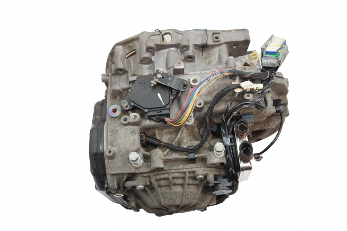

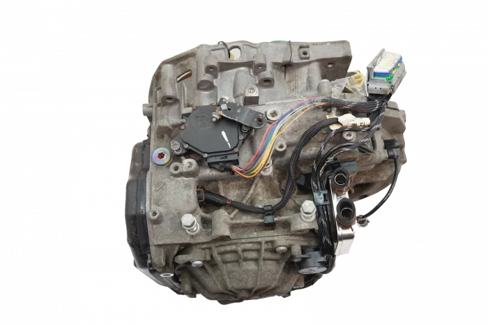

Filler plug is in the middle of image, between the black metal gear selector and coloured wires - if it is covered by this try changing gear to access, into Neutral. Just check gear if you start the engine.
