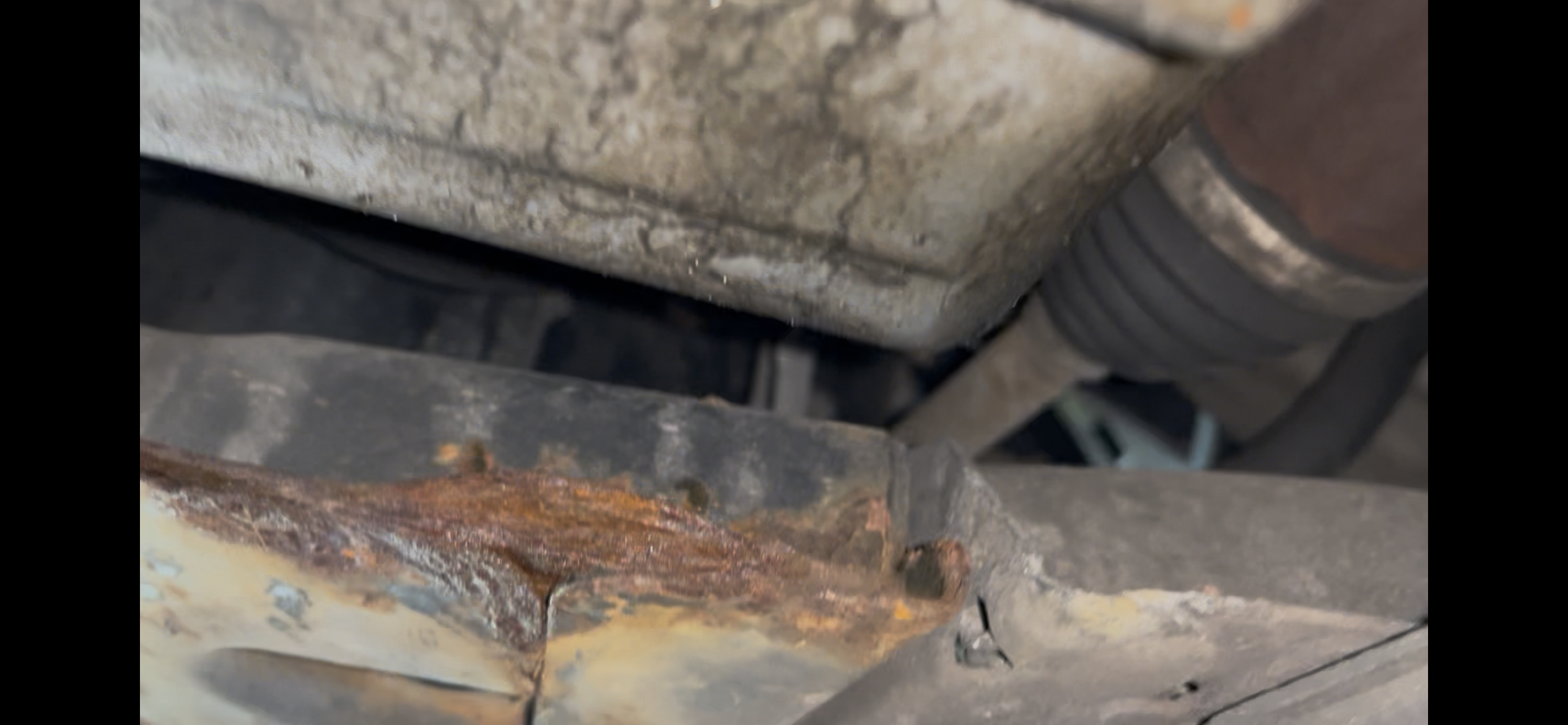

  • Treat the subframe - when working on it so far the subframe is a bit rusty. When the manifold / cambelt needs changing, I'll replace for a new one [got some rust treatment and black metal paint to cover post rust treatment].

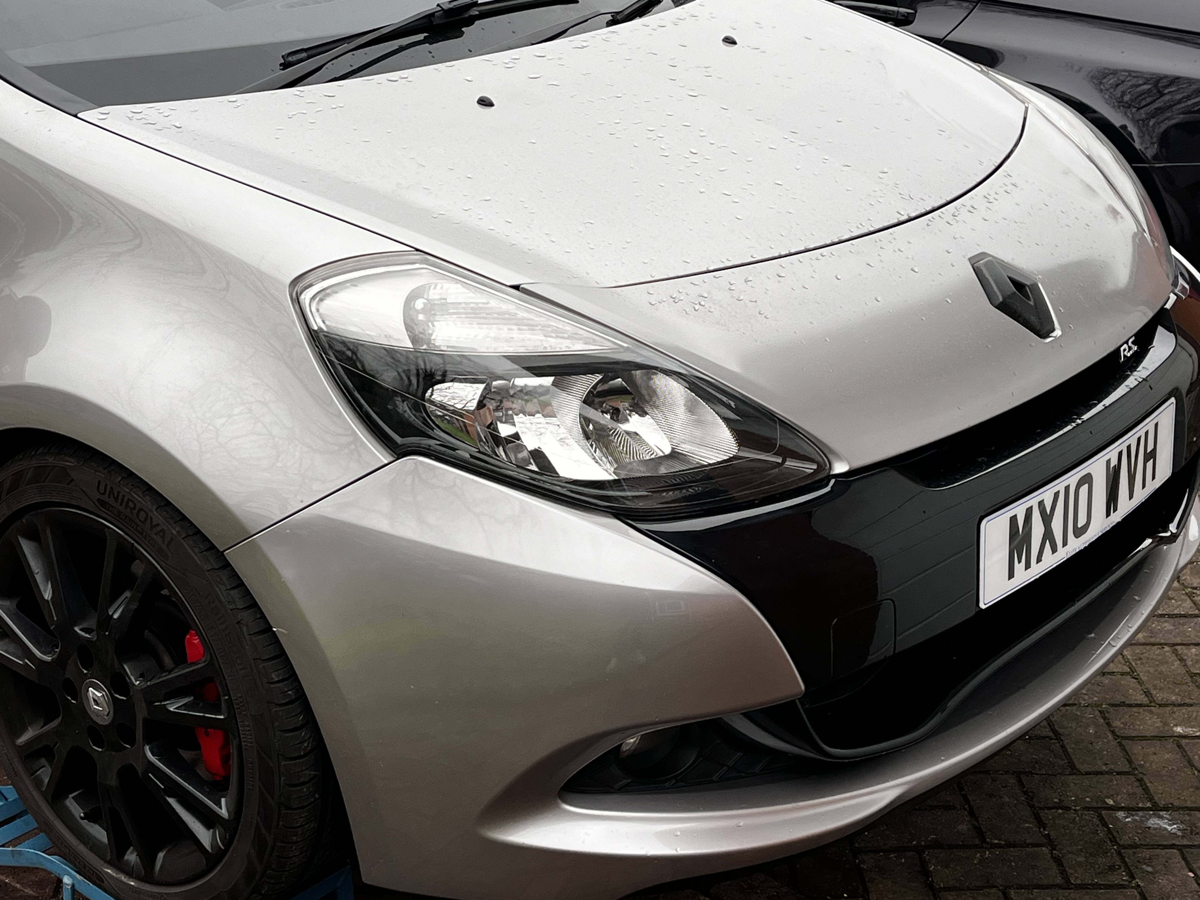

Headlight pass with the polisher
Subframe to look into

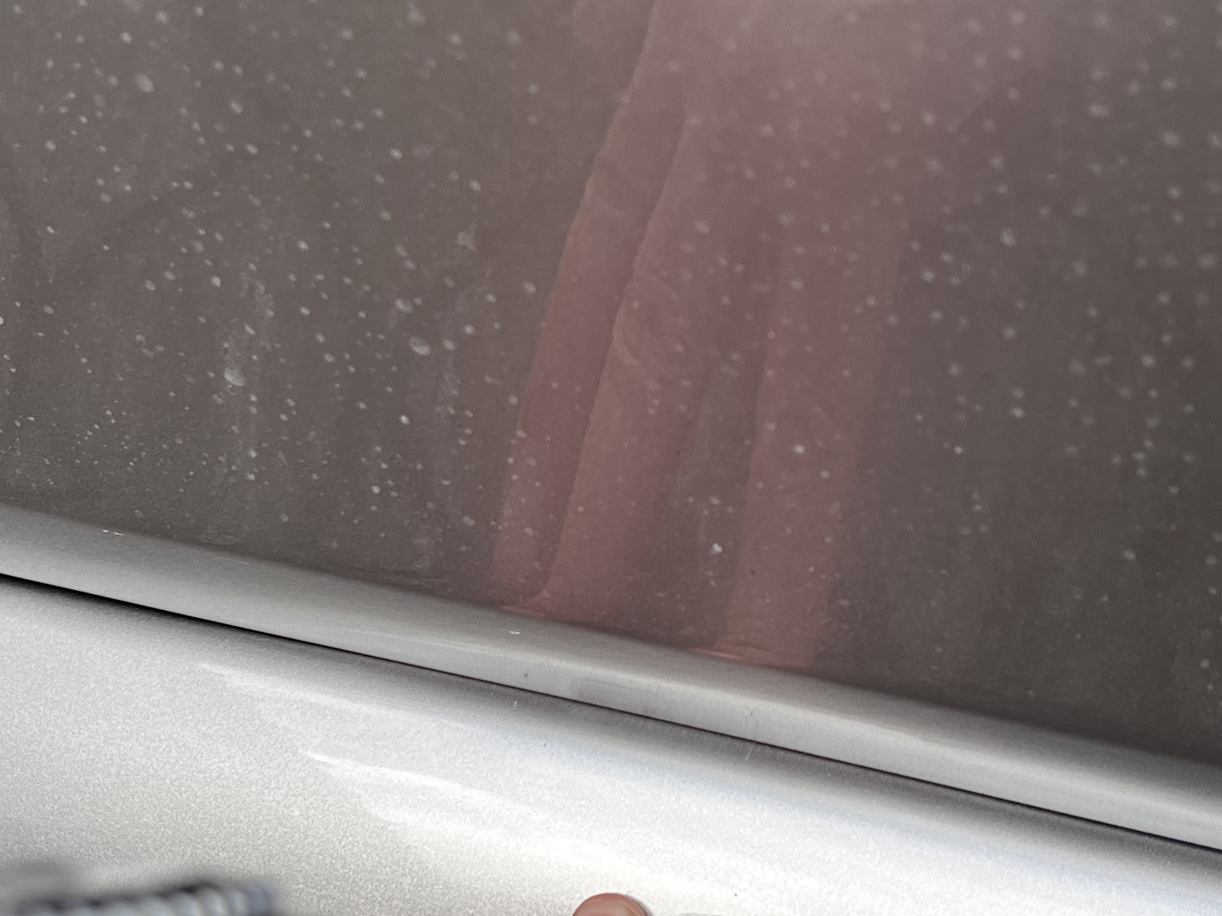

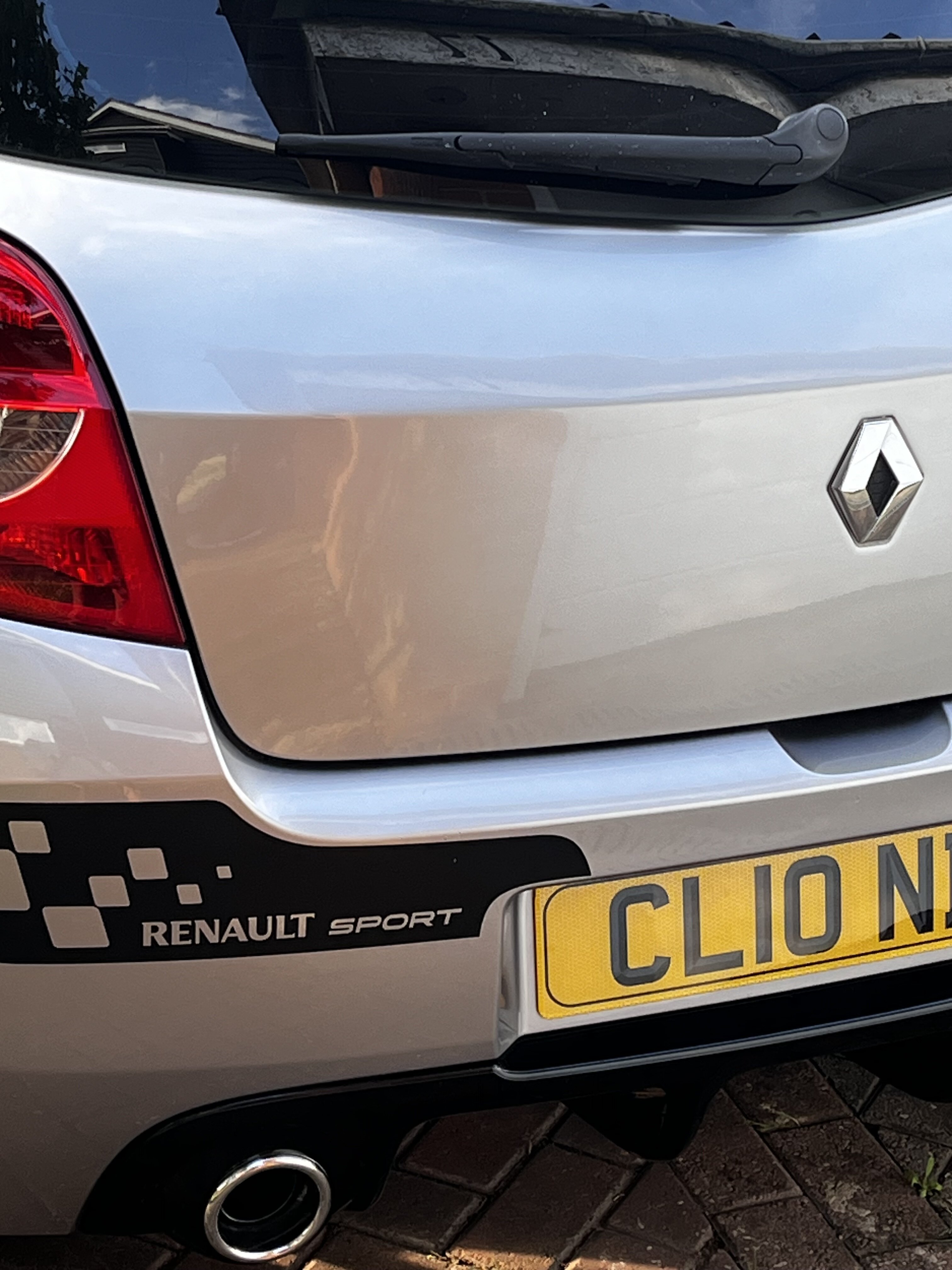

A little rushed, but I machine polished - cut, polish, wax and then sealed and put a cheap ceramic coat on (I appreciate this isn’t a real ceramic coat).
Time was against me, but I just wanted to get this out of the way, as the paint was fairly rough and unprotected. It could be better, but equally, a lot worse.
I largely skipped the wheels, as they will have to come off in the coming weeks so I can protect the arches and paint the centre caps. I did however give them a scrub.

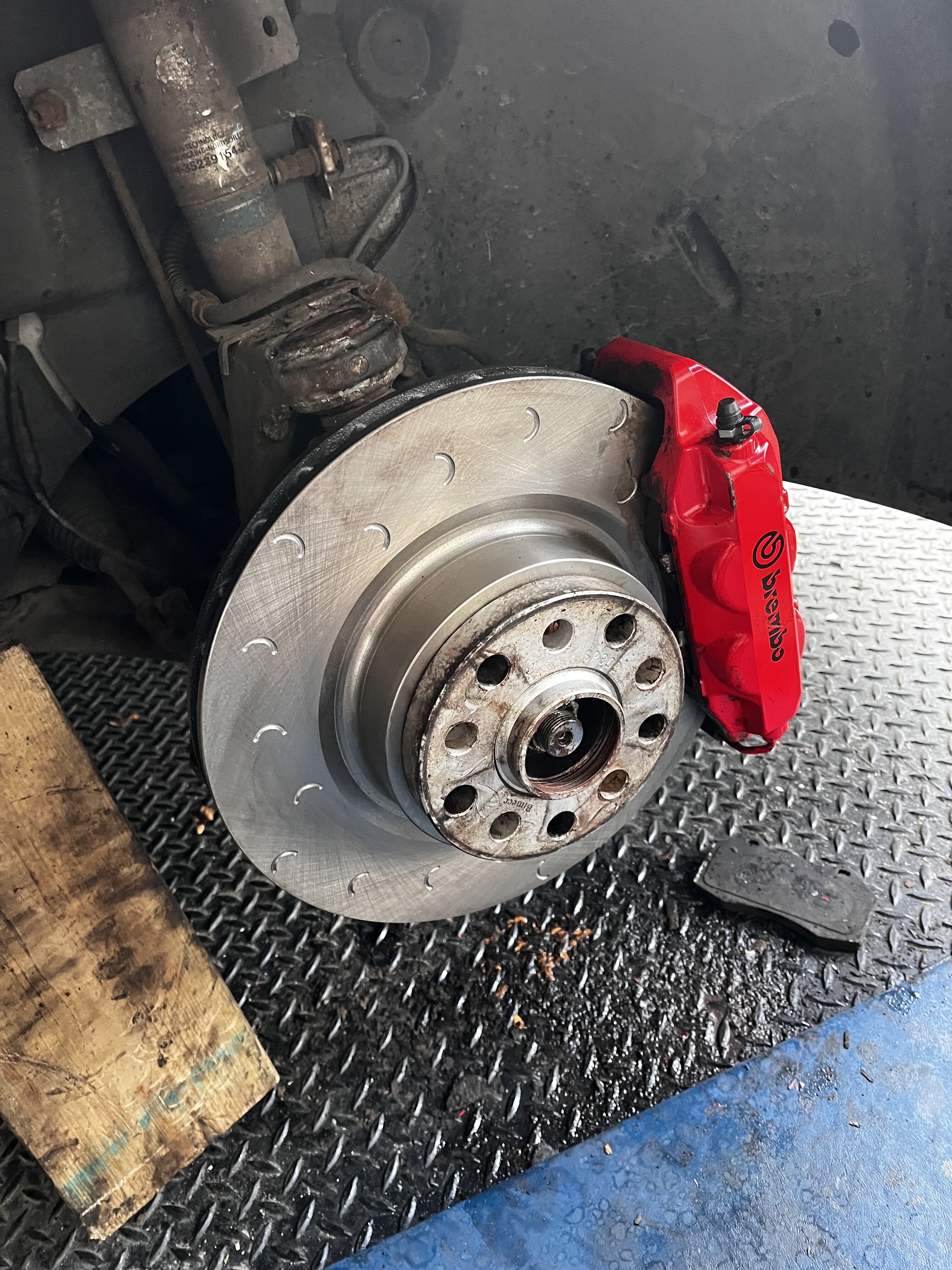

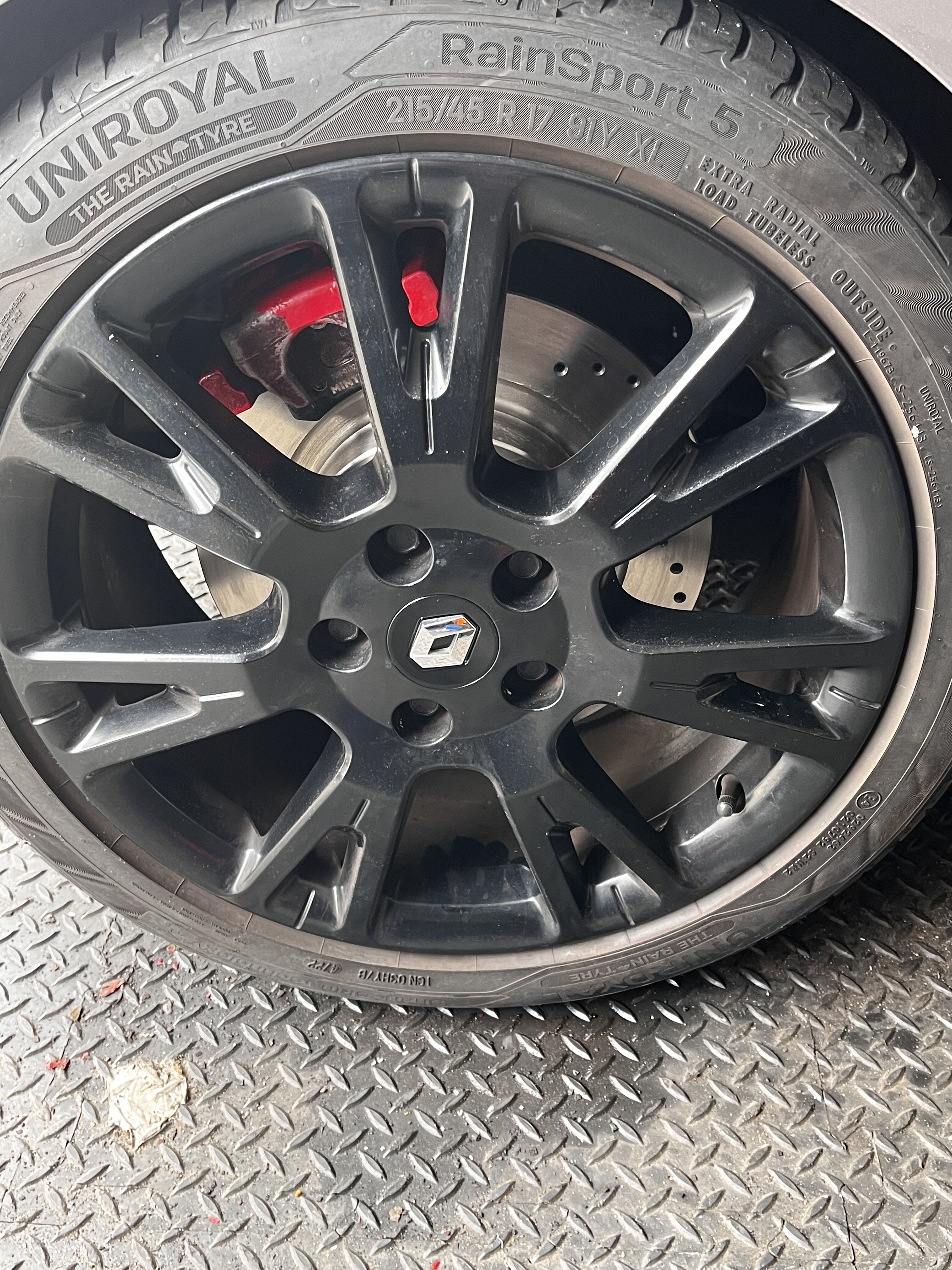

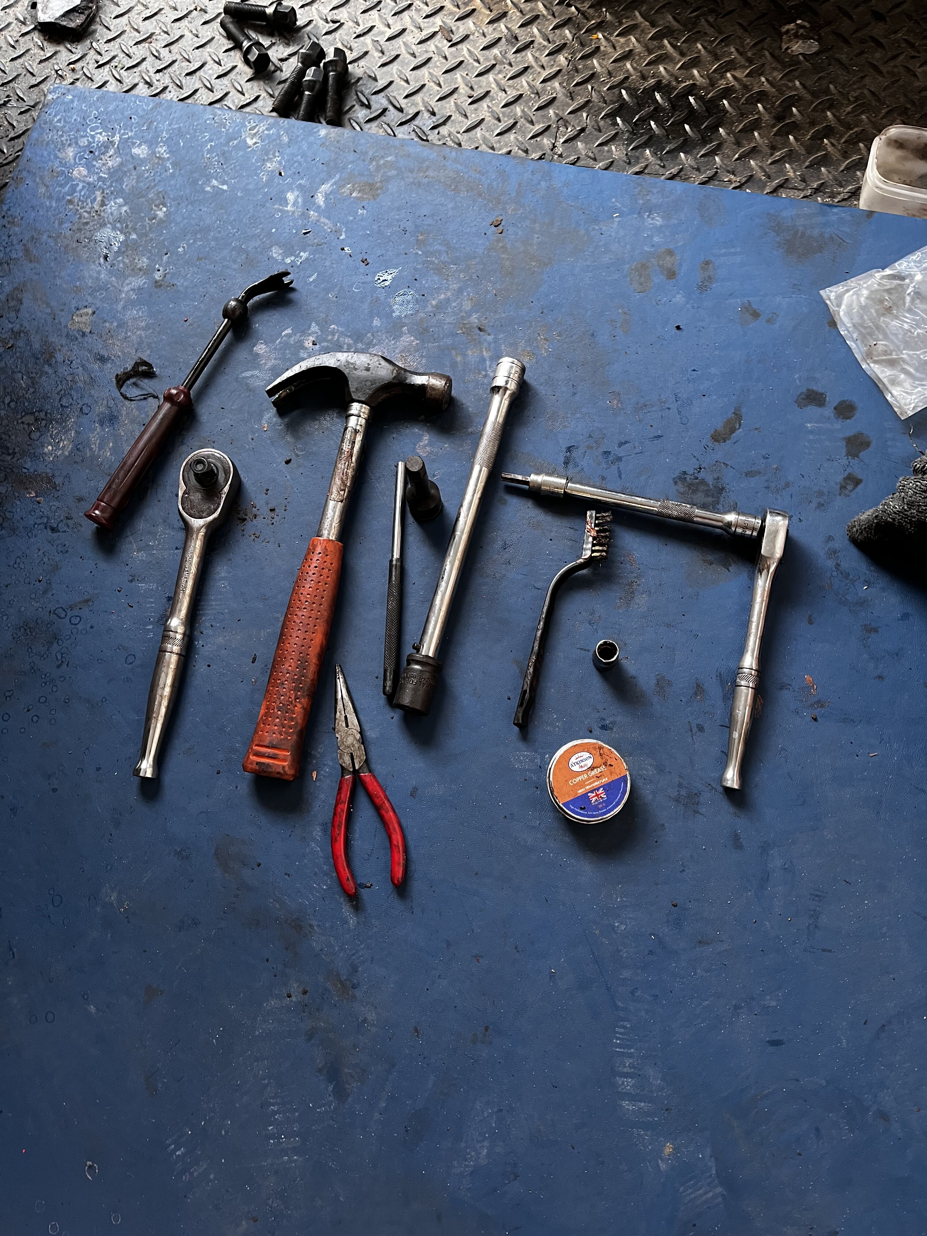

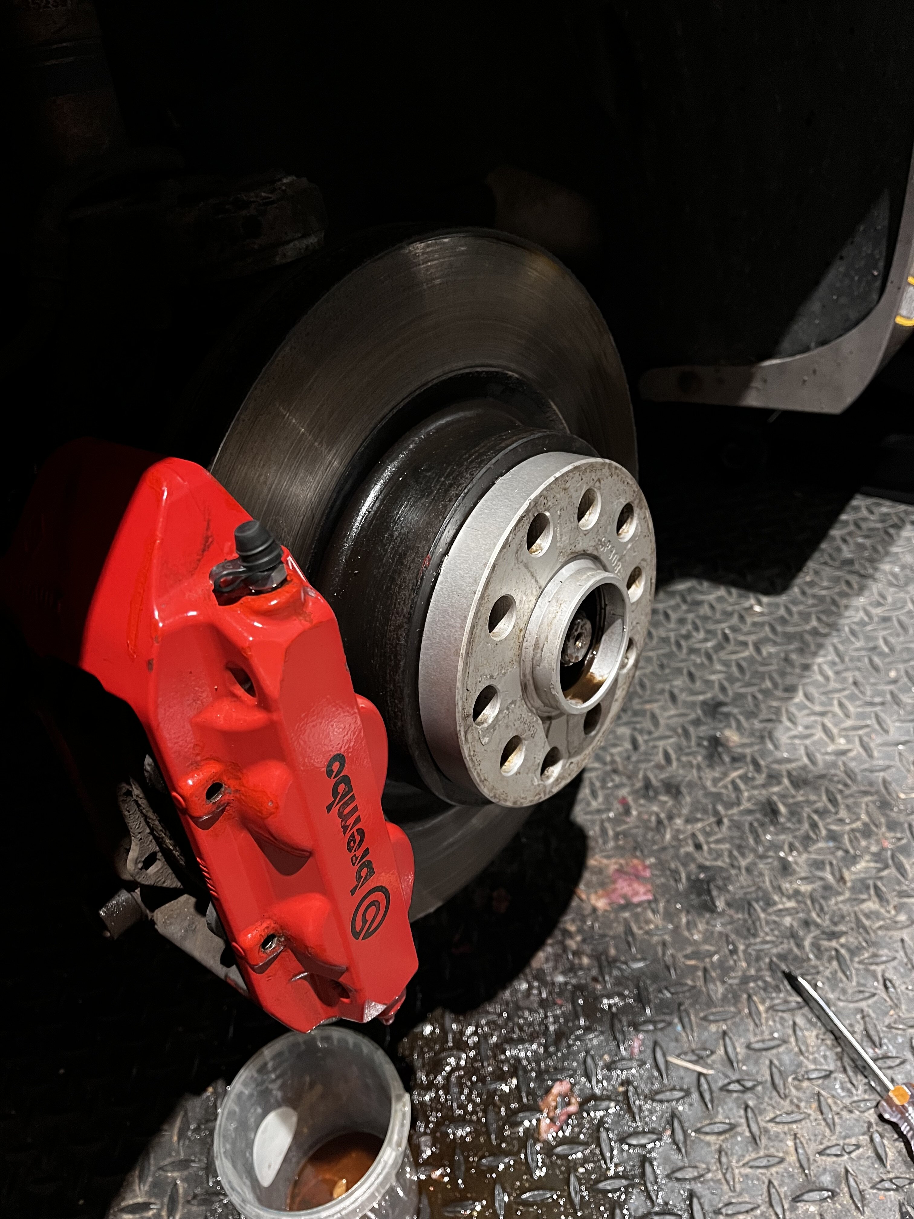

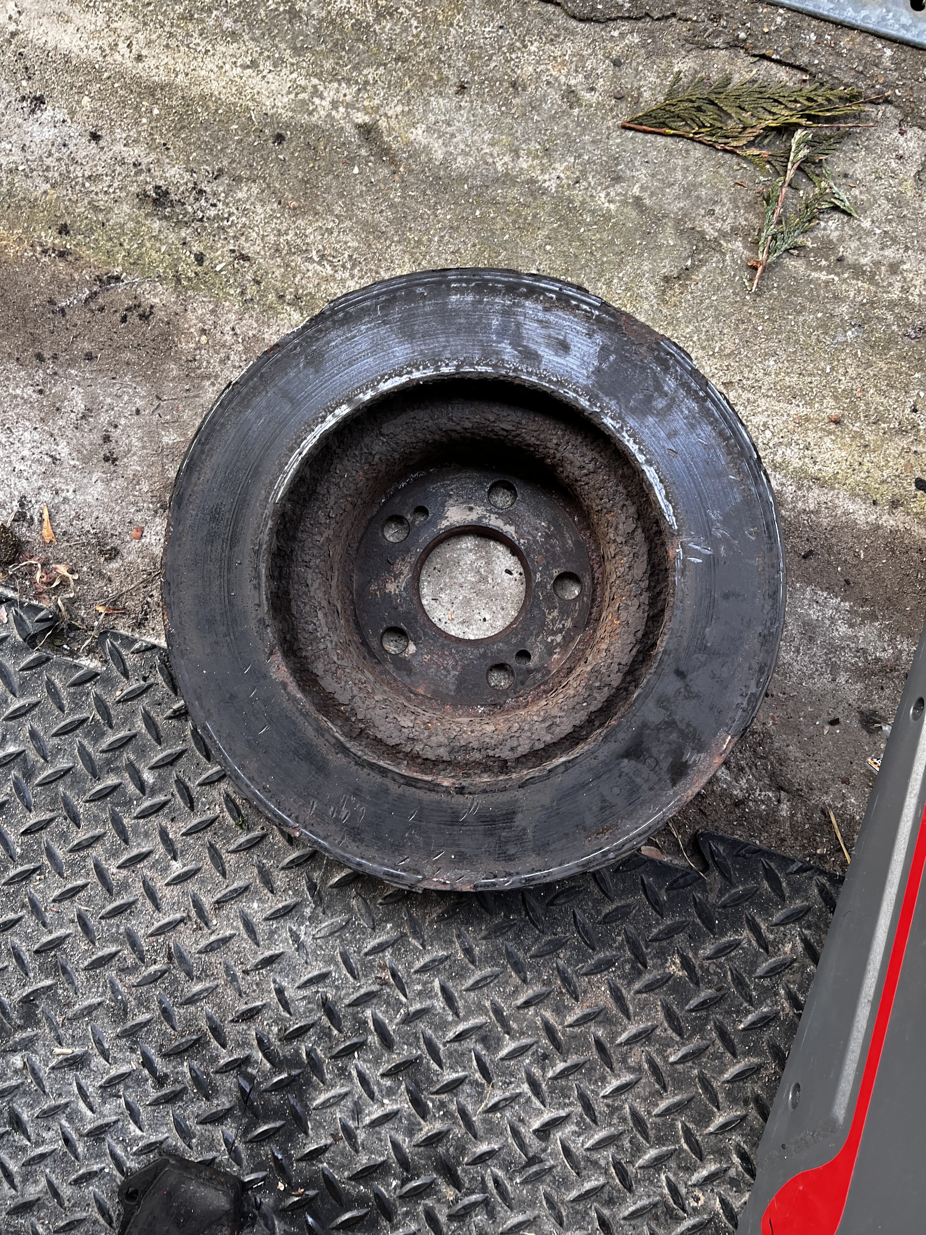

Front discs, pads, and new brake fluid cap.
Watched a few videos and bought some tools to assist. I got some brake pin punches which made the job really easy. I also wd40 for a few days before, irritating with a tooth brush the bleed nipples and all 4 came off with no fuss.
I swapped the valves and installed new pins and spring locator/retainer.
The discs and spacers were rusted on and a bit of a pain to come off, but eventually relented.
Brake fluid reservoir still above min line, but I did lose some when swapping nipples and resetting the calipers.
The pads were also a bit of a pain to get out, even after resetting piston.
I made sure I decontaminated the area with brake cleaner and a rag.
After finishing I did get that ESP warning, but a google and lock to lock and it went away. Mild panic over.
Managed to drain the battery as I must have left the car on over night when in the garage.
Only driven a small distance but the improvement is profound.
Mintex c hook and discs.
Going to take it to a garage to bleed and flush the fluid - £50 and I know the nipples will be no fuss. I’d do it myself, but the fluid and kit to bleed will be more.
Final comment is I want a stud and nut conversion. What a pita to fit the wheels and spacers.

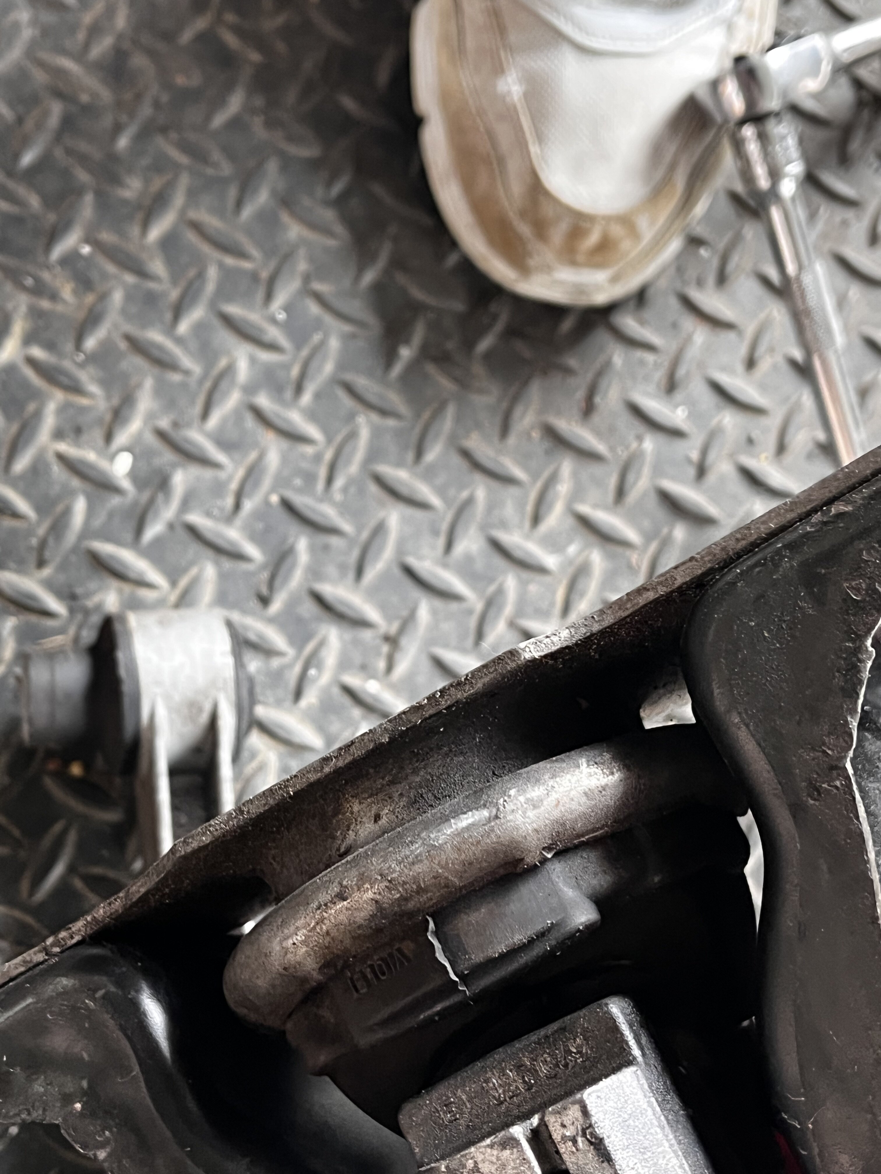

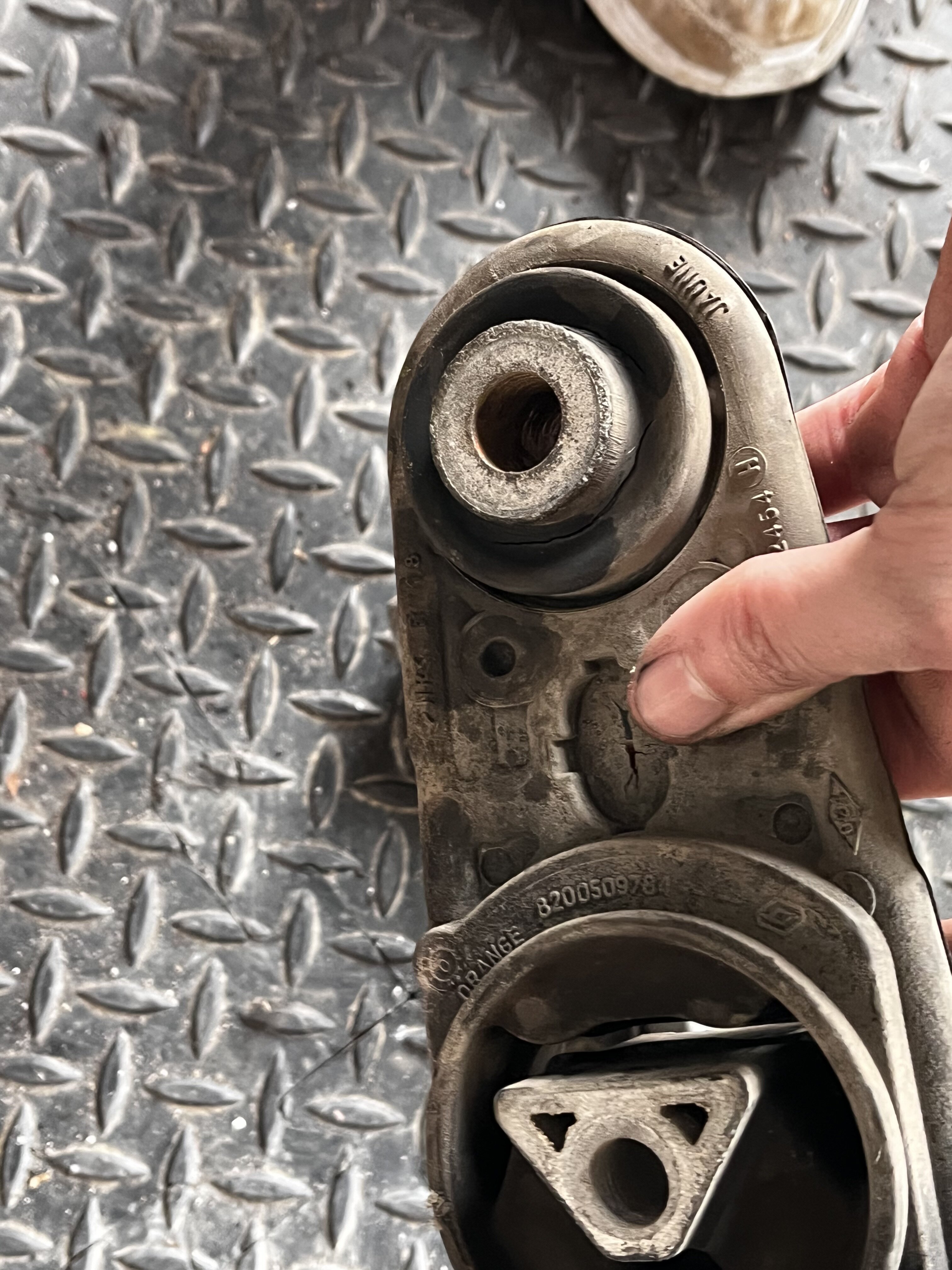

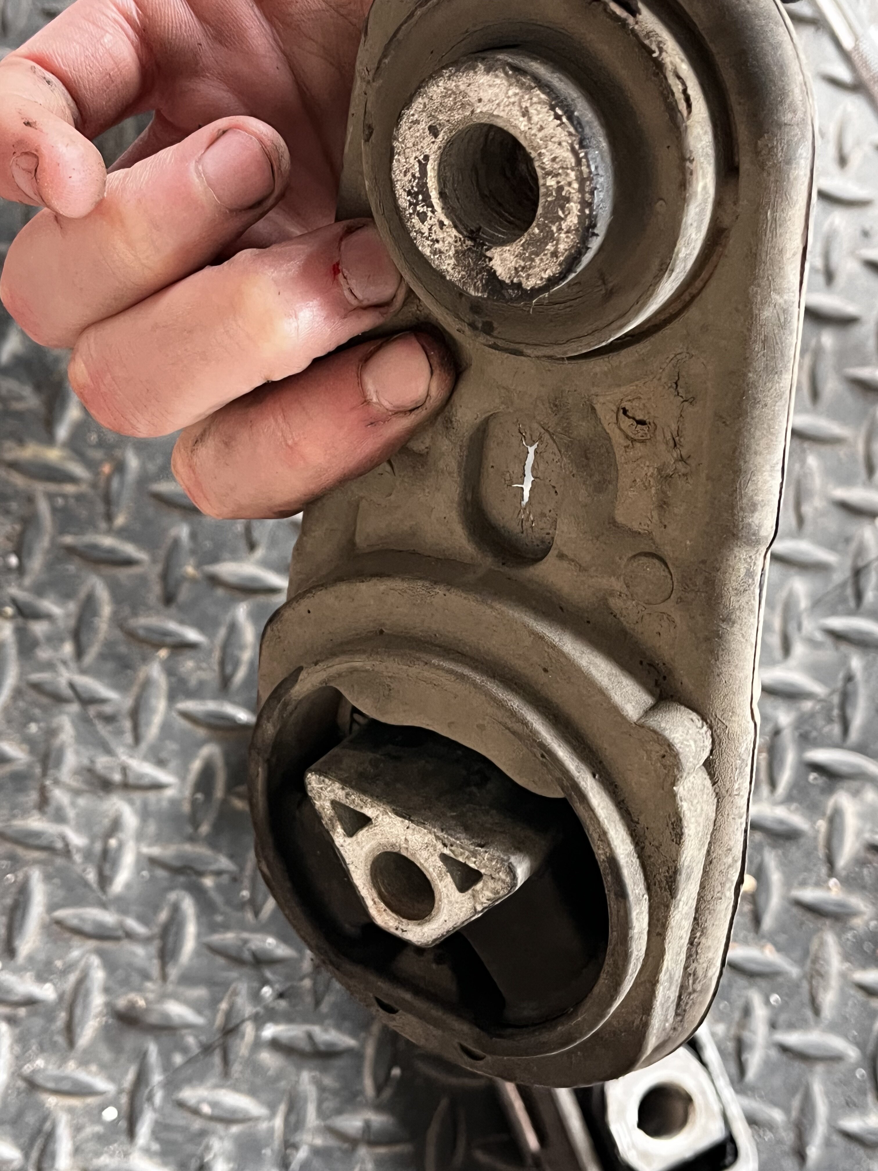

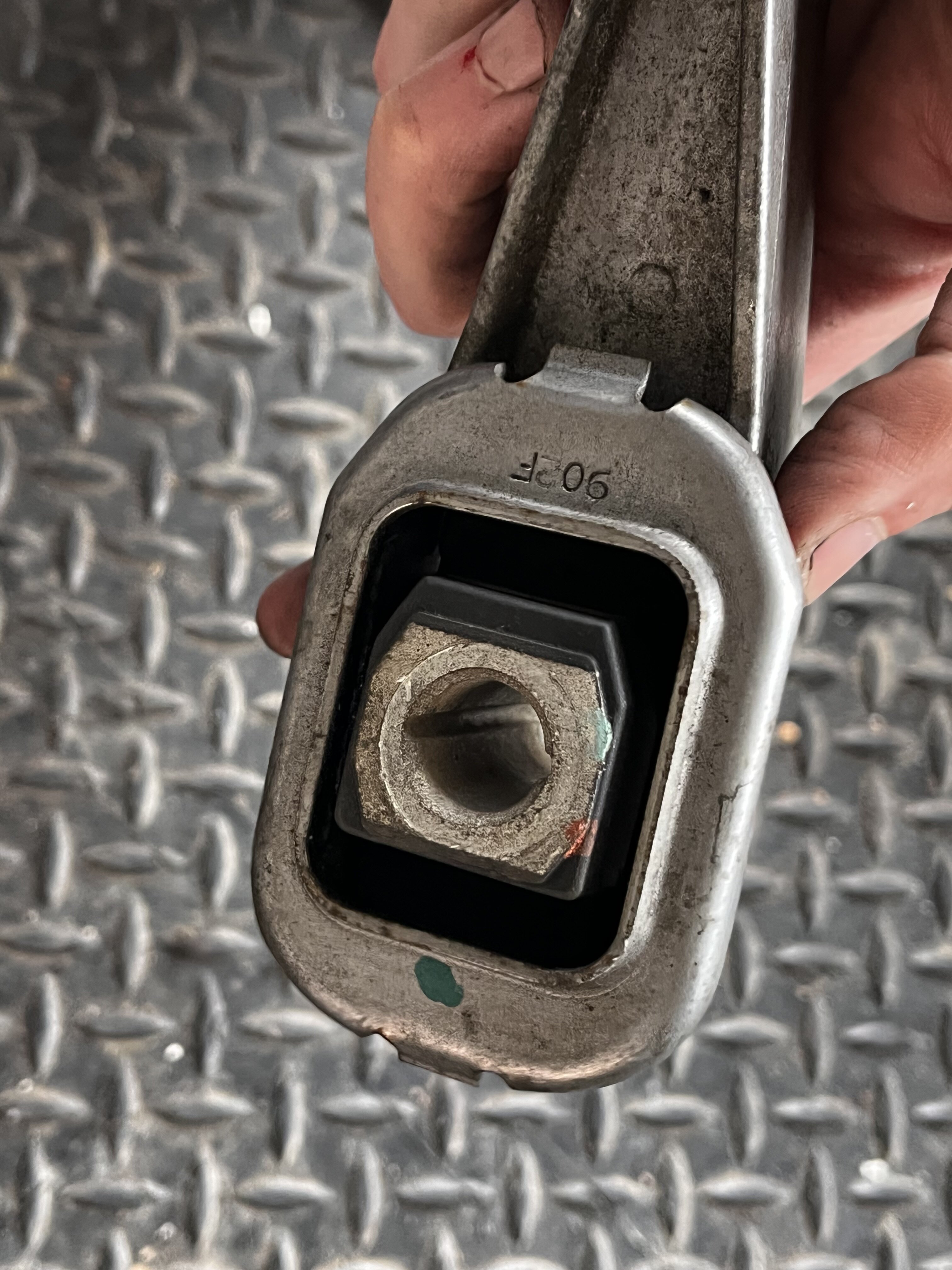

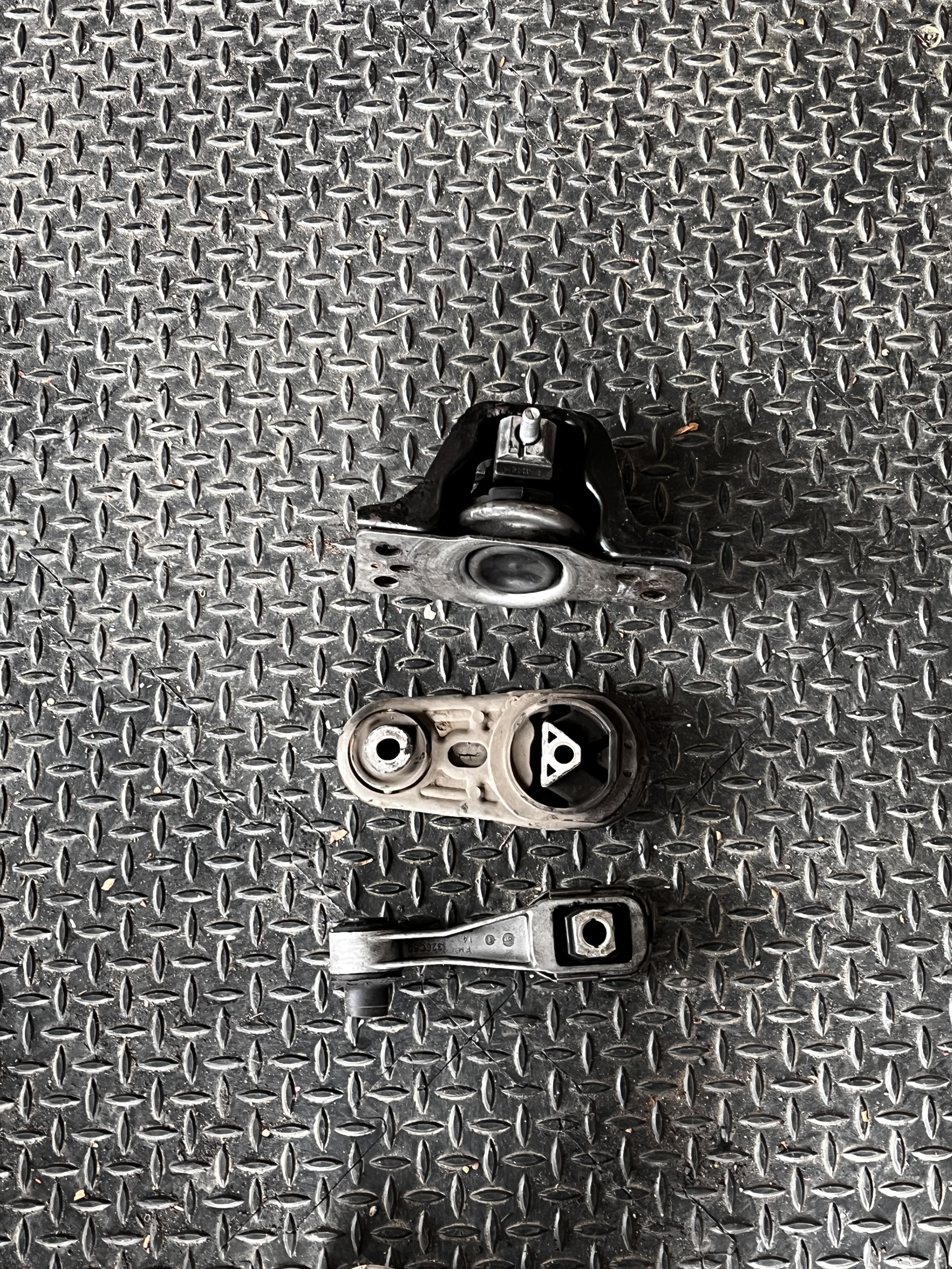

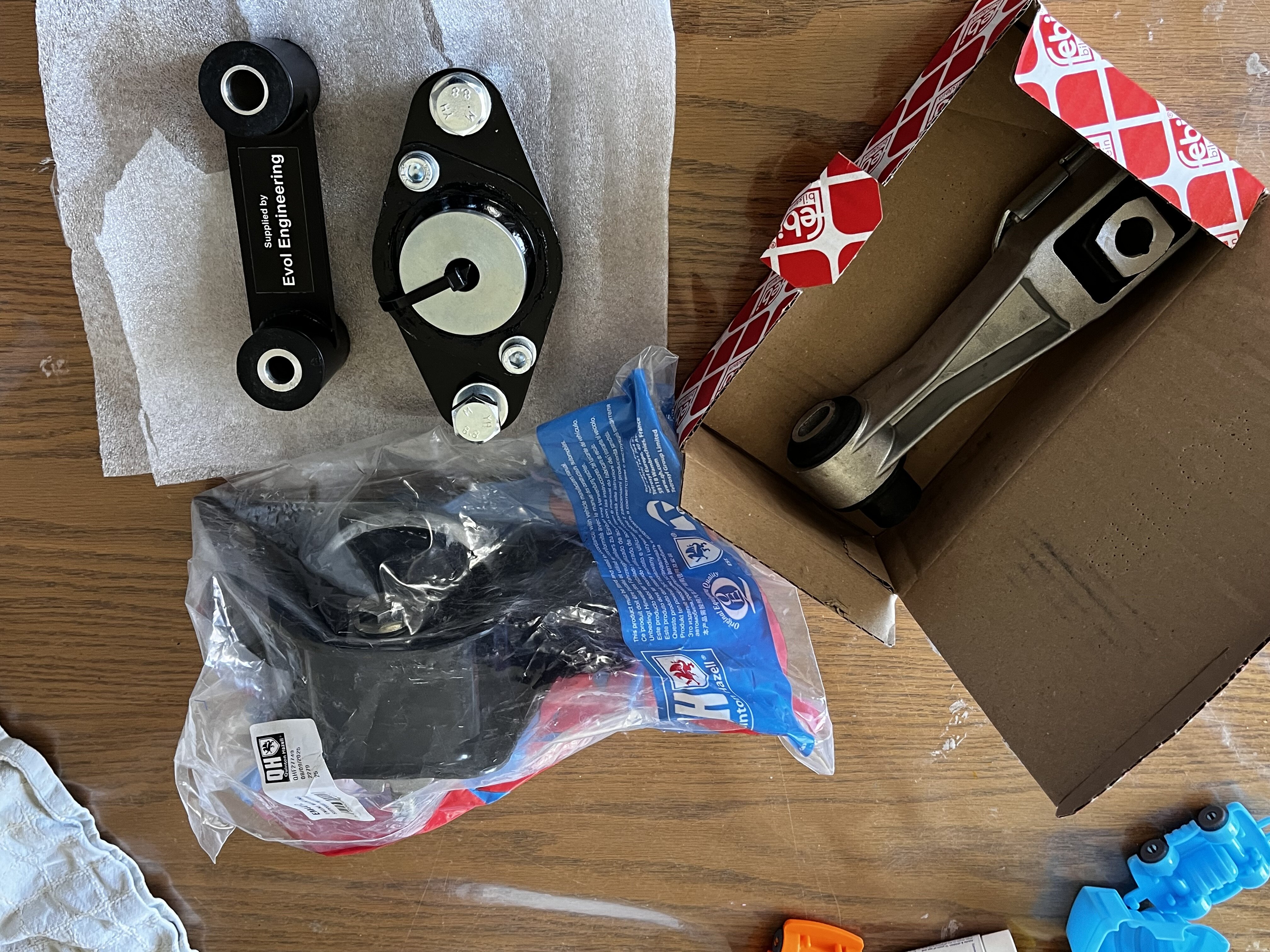

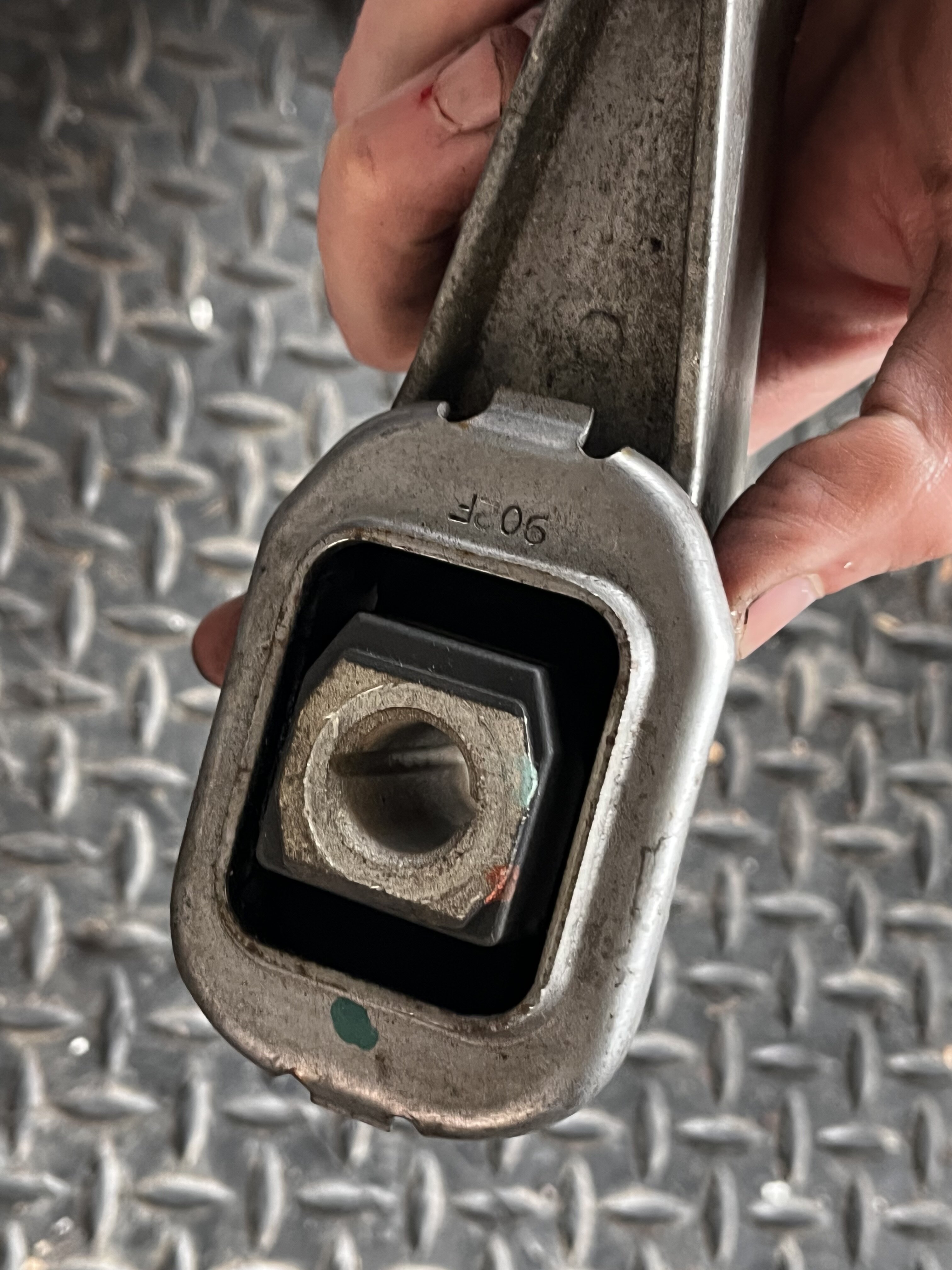

Sadly, not enough time to do them all, but today I did engine and torque mount and lower gearbox. I will do the upper gearbox mount in the next couple of weeks.
Only started the car, and there is more vibration, but not too much. The changes are preventative maintenance - box and manifold in mind.
I swapped out the engine mounts for new standard ones and the gearbox ones I’ve gone for evol. Evol lower gearbox mount was super cheap - £40, so gave it a go. Thus far, this is the only non standard mount so I know where vibration comes from, which albeit I’ve only faffed around on the drive, doesn’t seem to bad.
The torque mount and lower box were extremely easy to change. The main engine mount was a real pita though. People on the internet just say, support with Jack and unbolt. I don’t know if it was because I was on ramps and the angle was funny, but it took a lot of wiggling, jacking the engine up and down.
In the end, I bolted the mount to the car and loosely reinstalled the torque mount. This located the engine as it should be and then I wiggled and jacked and it got into place a lot more quickly.
Pictures of the new mounts - only 3 installed and the ones which came off - which didn’t seem that bad.

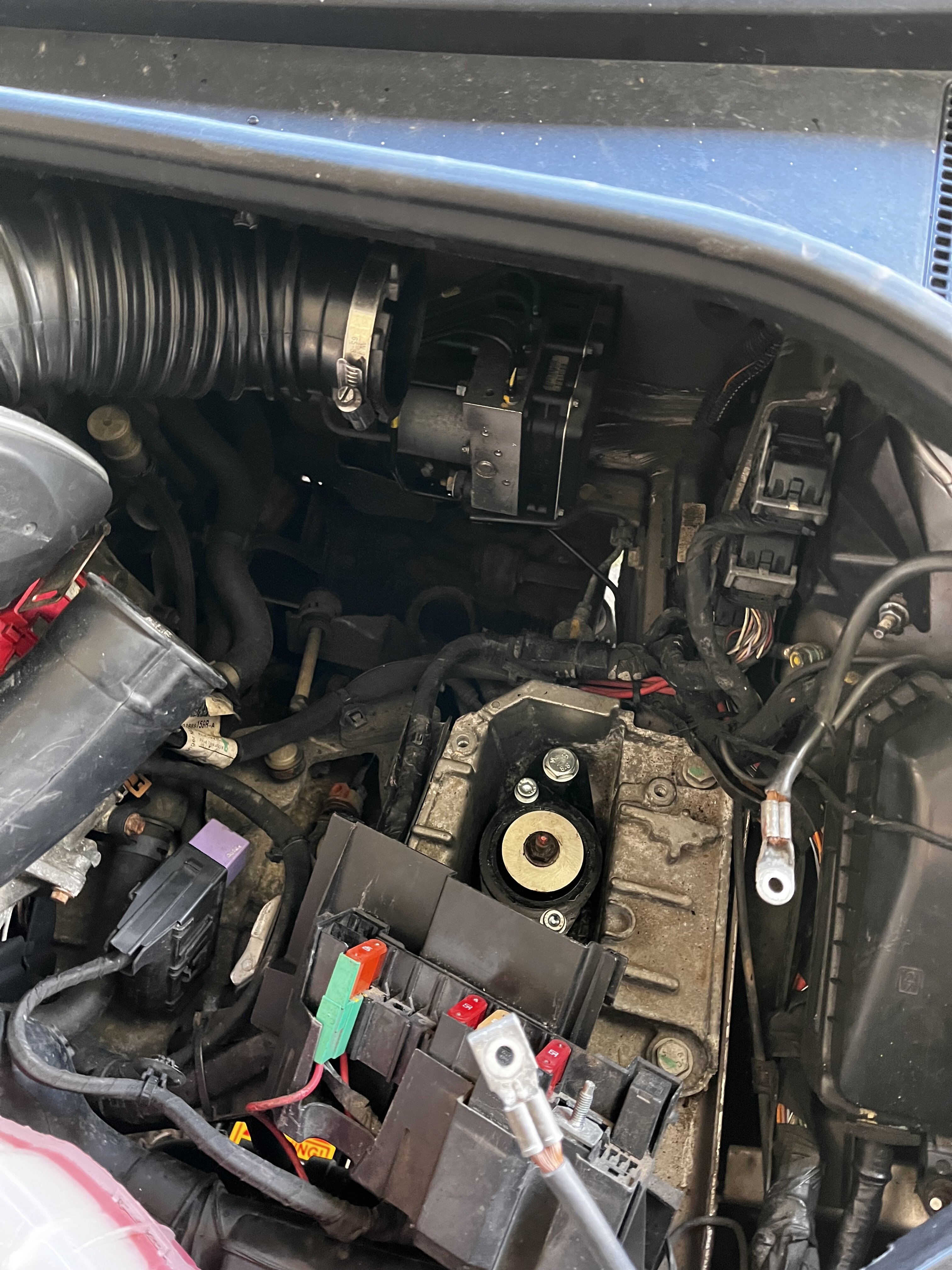

Finished off the final mount this afternoon - the upper gearbox mount. I watched a couple of videos and it wasn’t that bad, just quite fiddly, particularly the battery tray removal and reinstallation.
The upper engine mount took a bit of wiggling, this mount was the same, but a lot easier. I had a little pry bar and some trial and error with the jacking of the gearbox and soon it was off. The old mount wasn’t in that bad condition, to be honest.
Had a short drive shortly after, and this mount contributes nothing to additional vibration. The lower box mount gives off a lot of vibration but is settling (and reducing).
Overall, the gear changes are so much more positive and there is little play when coming on and off throttle, I’m very happy for £200 or so. Well worth it imo.
The gearbox mounts are from “Evol engineering”. The engine mounts were standard new units.

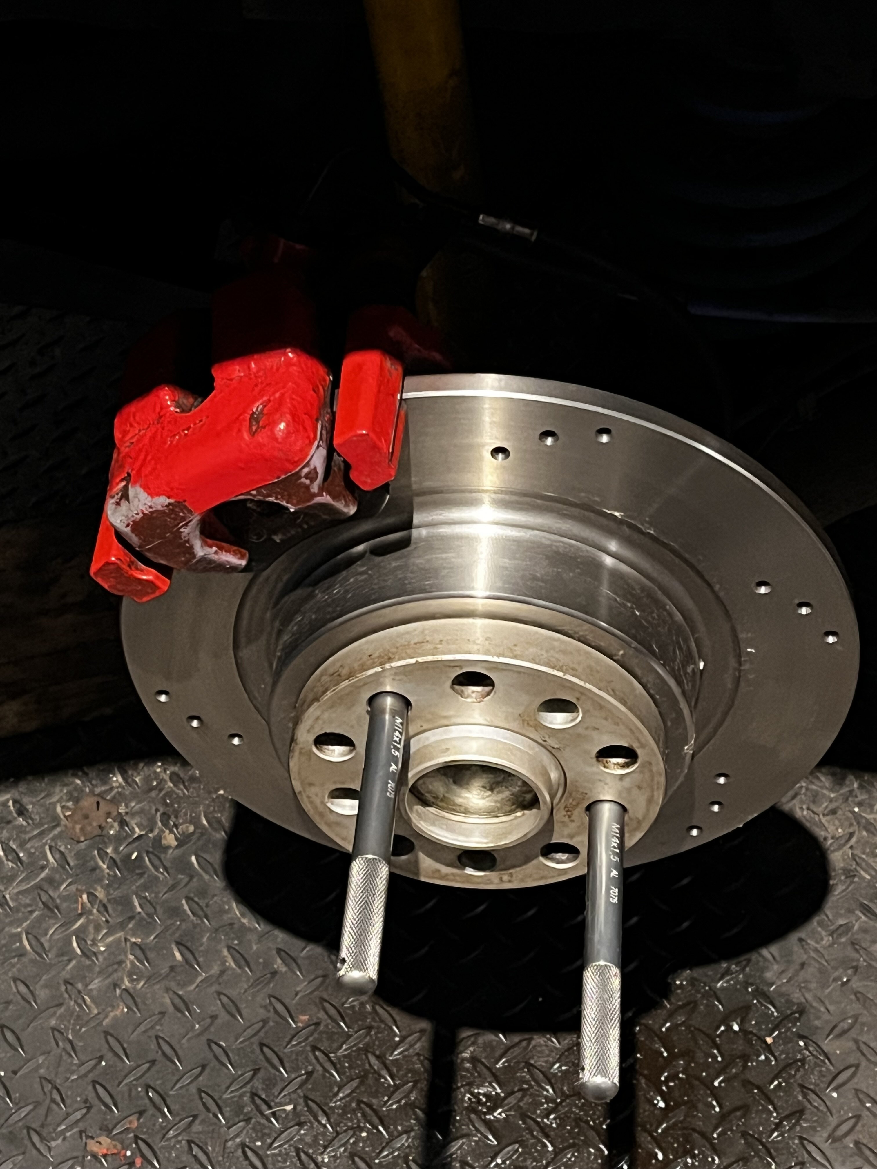

Rear discs and pads. I’ve also sprayed the centre caps black to match the wheels.
I had some trouble with the front wheel spacers, rears virtually fell off, someone actually used copper grease (on the rears).
No problem with any of the bolts, but I did find it challenging winding back the callipers. Both sides were tricky, but the rear left I thought was seized, it eventually relented when I was able to fashion a torque bar for it, for more leverage. The right hand side was stiff, but not to this level.
The callipers aren’t in the best state, some fresh paint or even a new set may be the way forward.
I bought a wheel fitting kit - long wheel bolt to align the spacer (below) - worth their weight in gold imo.

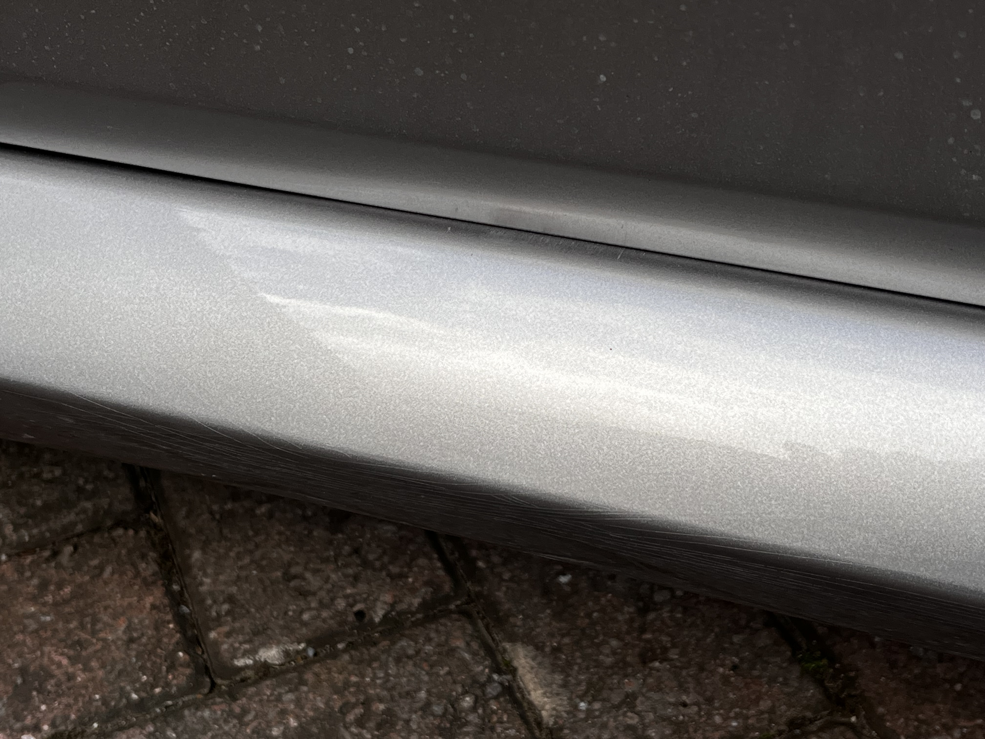

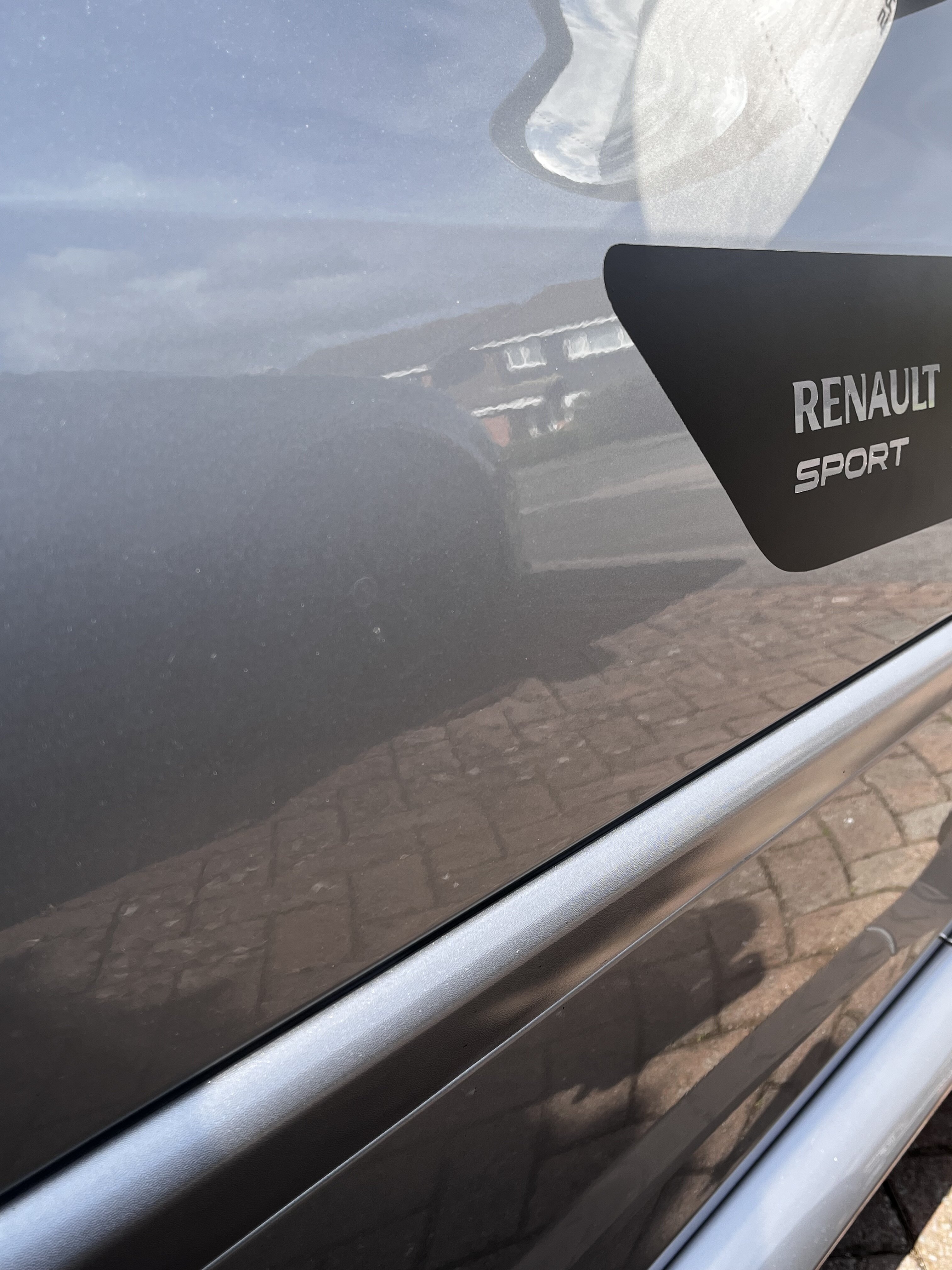

Fiddled with the side skirts, as I have loose fitting clips at both rears.
One clip has evidently snapped (I can see it), went a bit cheap for now, and aided stick with some 3M tape.
I also reattached the trim where I caught it on the jack, and tried to push it back into place. The passenger door no longer catches - hopefully a permanent fix, tbc.

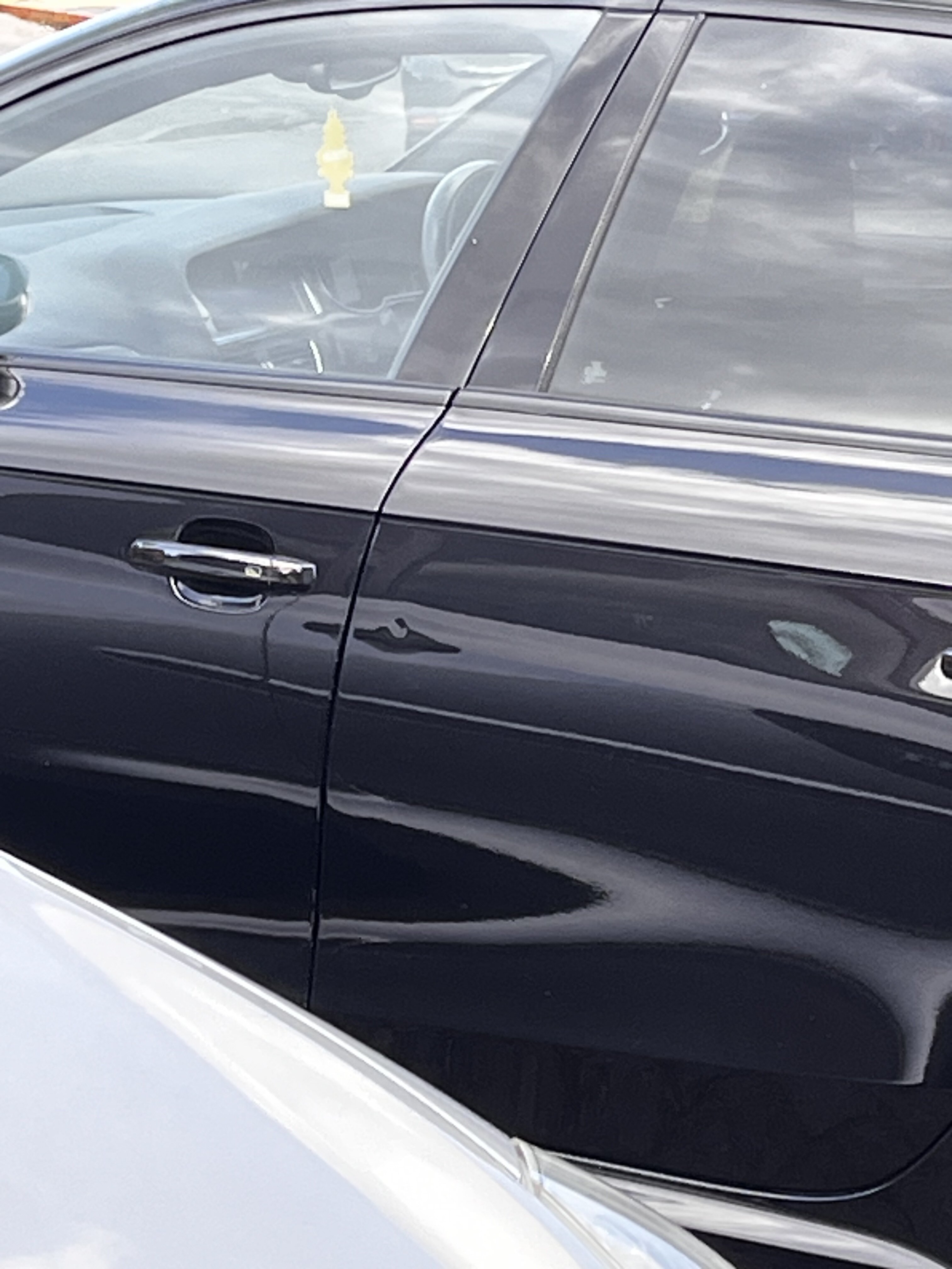

A secondary pic of the RS4, where someone has really dented the door, really irritated about that, as it’s massive.
Pics of the sill line show the door being an inconsistent distance. You can see the hairline cracks in the sill where I bent it from the underside. Hardly noticeable, but frustratingly, I know it’s there

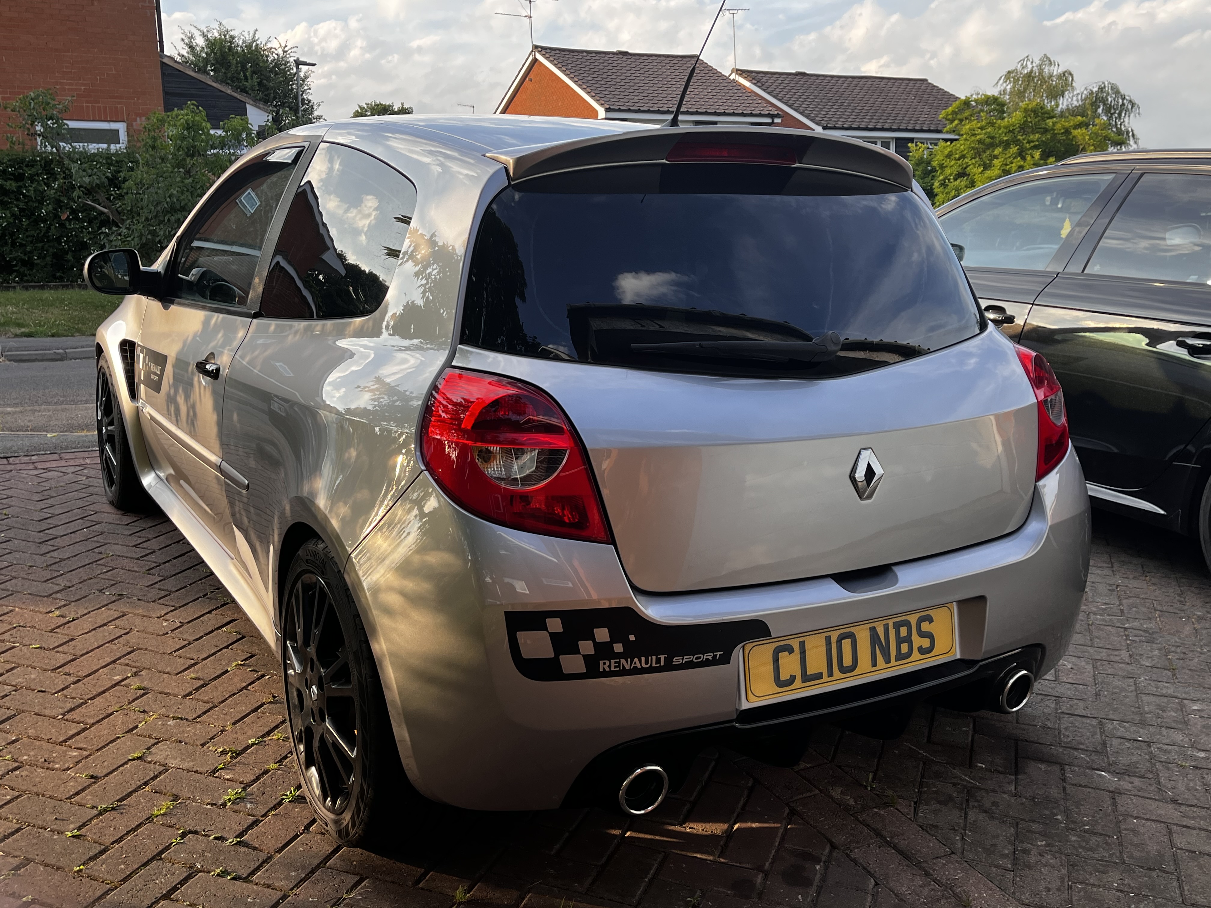

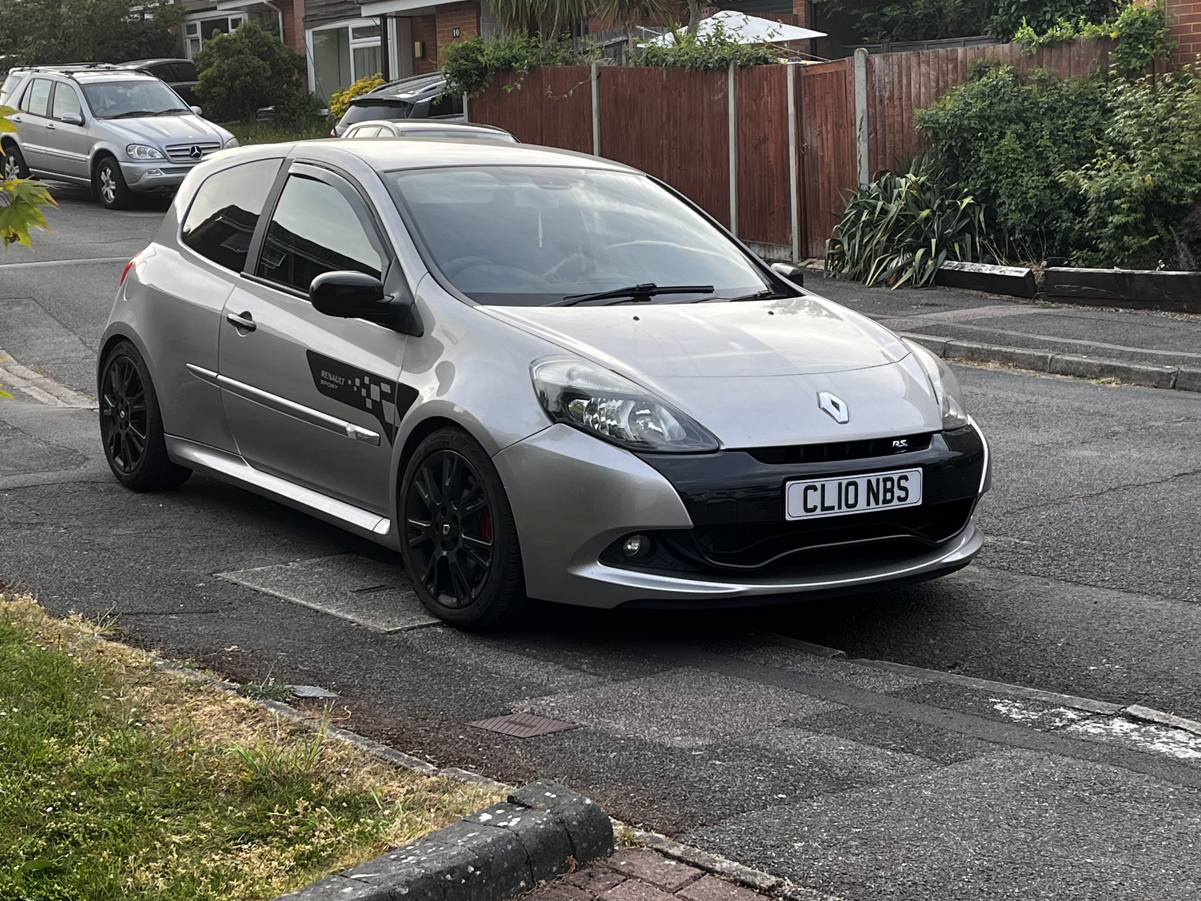

I searched quite a few plates and ended up with this one. Most of the “cheap” good ones had gone. All in, including plates and insurance it was about £300.
NBS is (for me at least), short for nimbus. Having hung it, I can’t see past Clio No BS.

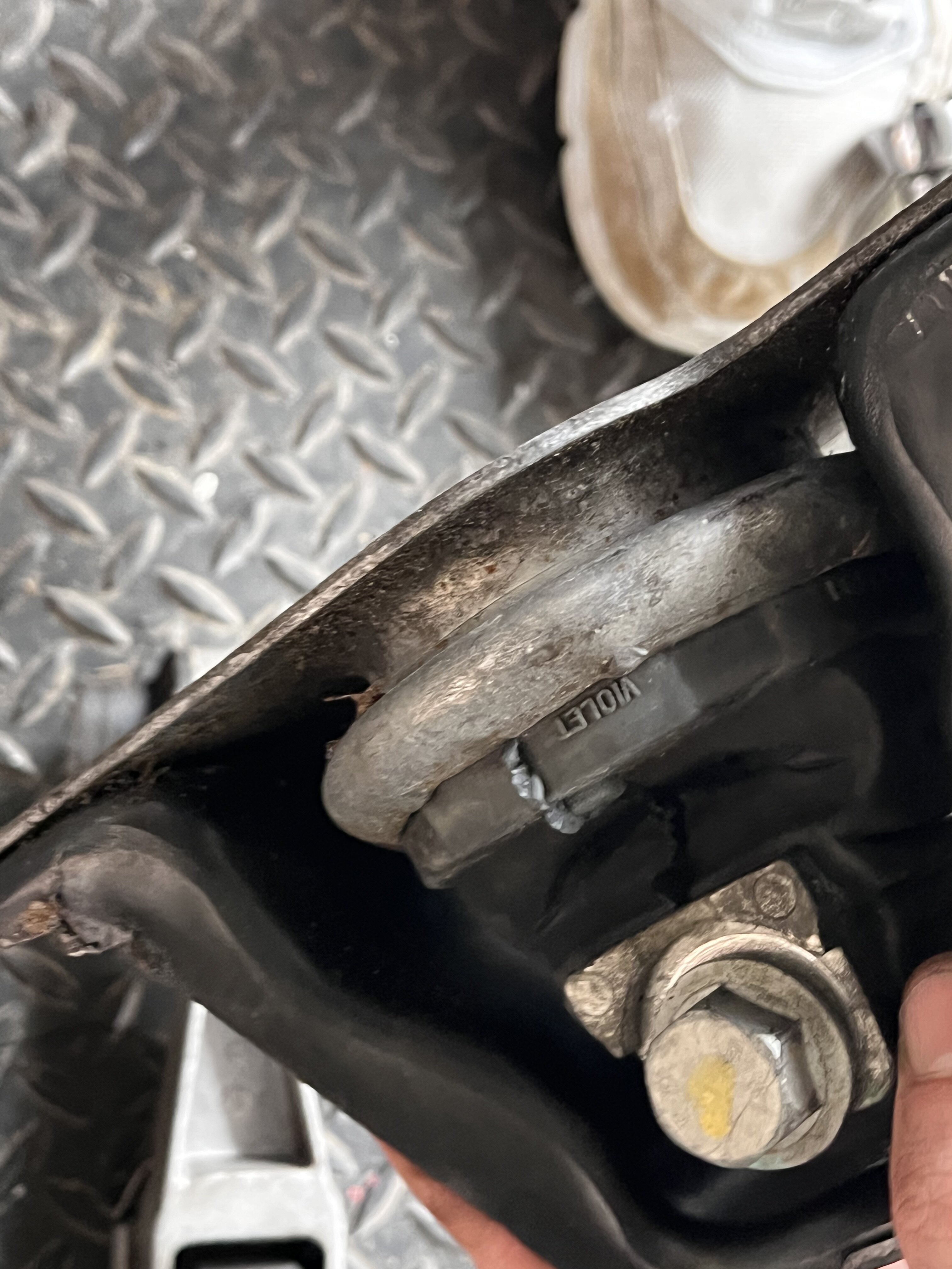

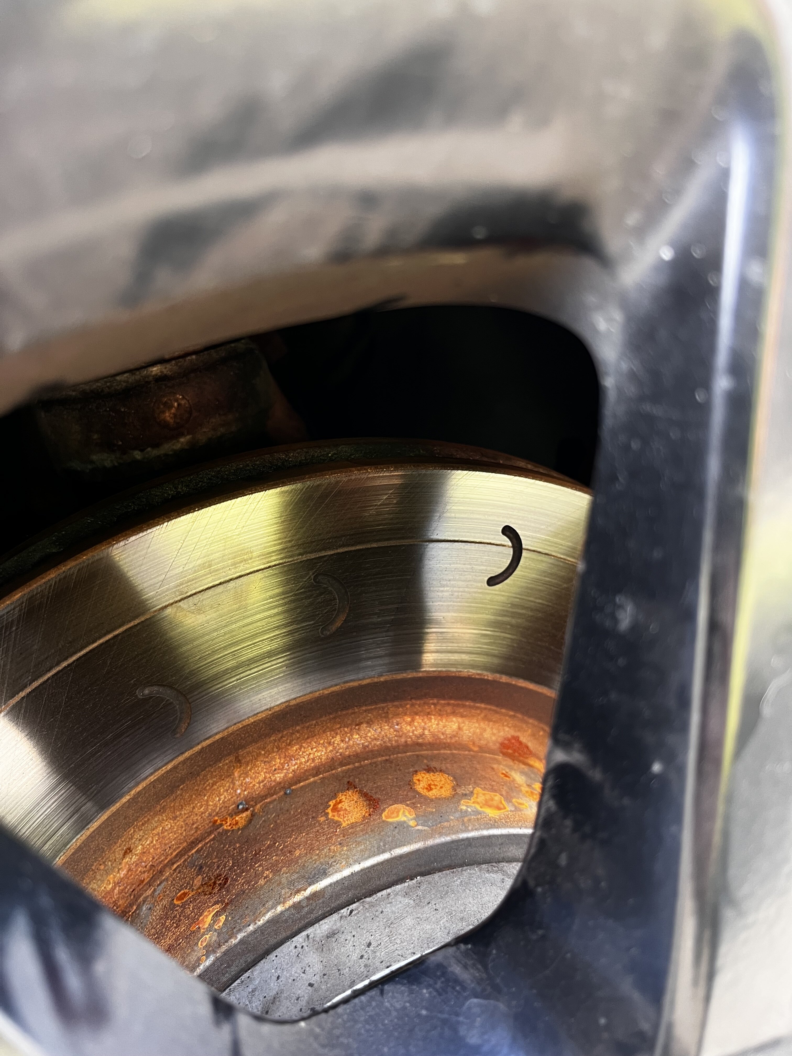

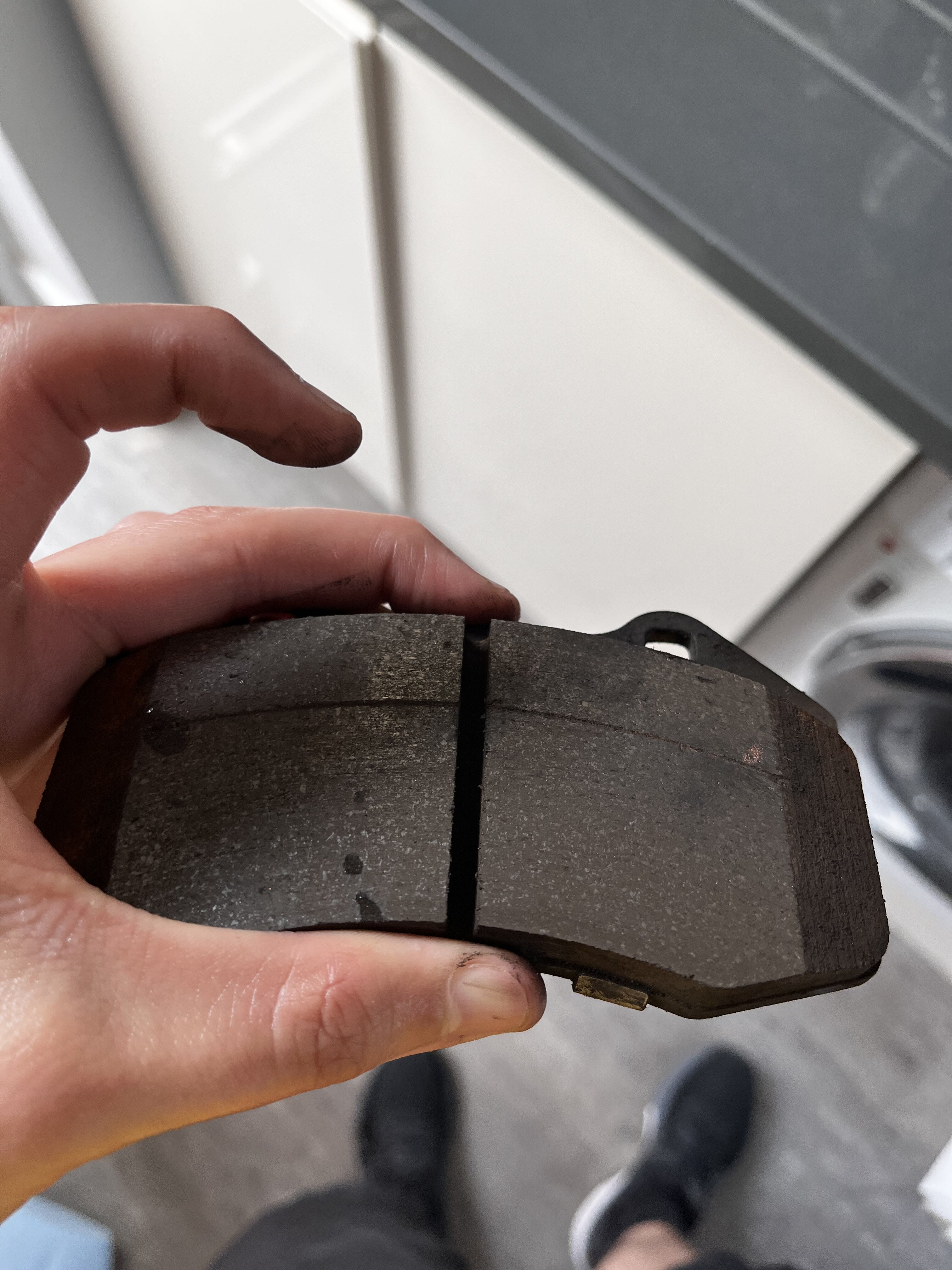

I was prepping the car for a brief wash last Friday and I noticed a scored groove around the drivers disk - it was entirely symmetrical which led me to believe something may have been stuck in the calliper.
With the collection of tools acquired (namely brake pins and the alloy wheel long bolts, very helpful when you have massive spacers) and the recent nature of disc and pads changes, I was able to remove the brake pins and pads within a couple of minutes.
I sent off the pics to Halo brakes, as that's where I got the discs and their opinion was foreign object too. The chap at Halo was very helpful when we spoke, they do in house testing before dispatching discs, checking each set with a micrometer which gave him comfort it would be very unlikely disc thickness.
When I mildly brake from higher speeds there is a small amount of steering wheel feedback; if I brake moderately to hard, there isn't any, so the pad must still be mildly misshaped which is removed with firmer braking - hopefully more miles and it'll scrub out.

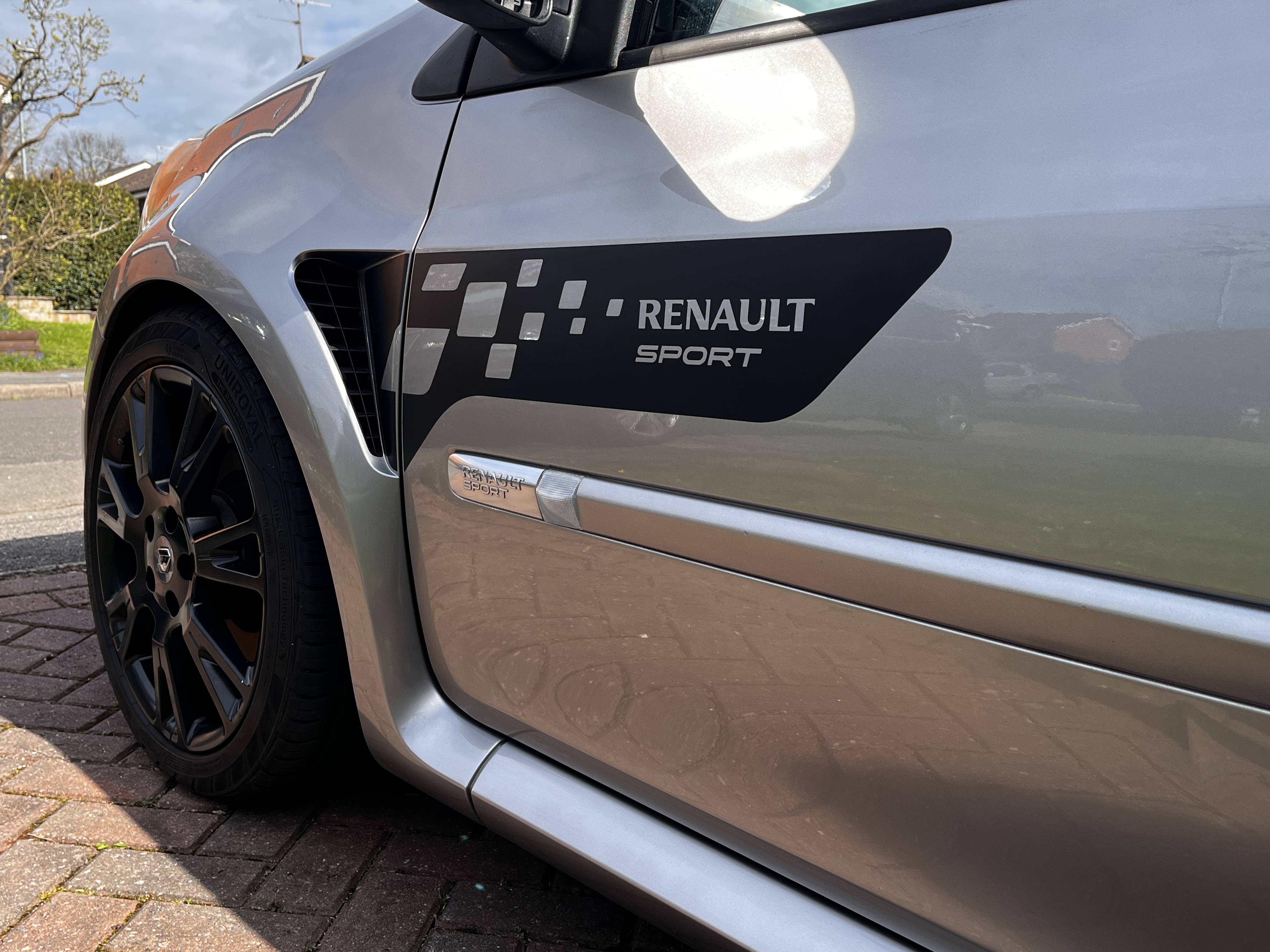

I've got Simply French next week, so I am going to try and give it a good clean this week.
Ahead of simply French next week, I gave it a polish and debadged the rear, in anticipation of my new RS badges turning up, but I really like it bare.
Still got a decent mirror shine on it, but I think I’ll need to invest in some “proper” ceramic coating as the cheapo autoglym/meguiars (the two I have), seem to last only a short period of time.

I had a low speed rattle over bump surfaces indicative of a loose bolt, after an investigation it turned out to be the fitting kit on rear brake pad coming away.
At this same time the track rod exhibited some play, so I replaced this and had the tracking done.

I took the car to Mike at Rentch for a health check. He checked over the car and gave it a relatively clean bill of health - the issues noted were a worn top mount and the clutch biting point being too high. Swivels, steering rack, box and manifold all good.
I did have the clutch on a to do list to replace. No issues still with the box, clean changes and no crunching thankfully. I am going to change the clutch when I do the cambelt and water pump.
