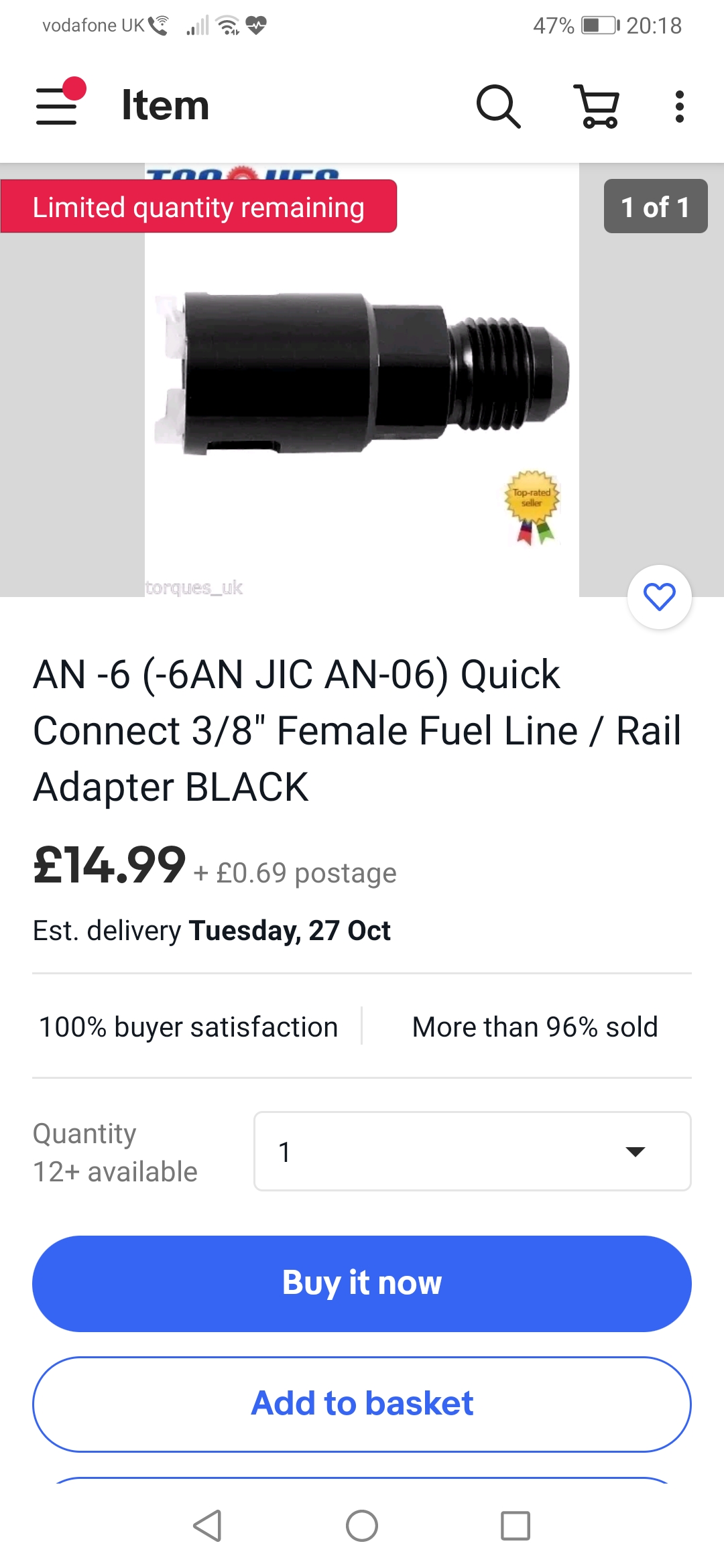

Hoping someone can help. I am going to be doing the fuel lines on the Twingo as they need to run on the inside of the car.
I need a contractor for the fuel rail and the tank. Am I correct in thinking this is the correct one for both?

That one won’t connect to the in tank pump connections mate as they’re not long enough to engage with the connector itself.
I used one underneath the car on my cup, but I had to modify the pipe to get it to engage fully.

Brilliant but it should fit the fuel rail end?

eBay item number for fuel pump AN6 OE connection if the same as 172 Clio ph1 unit.
382292441764
