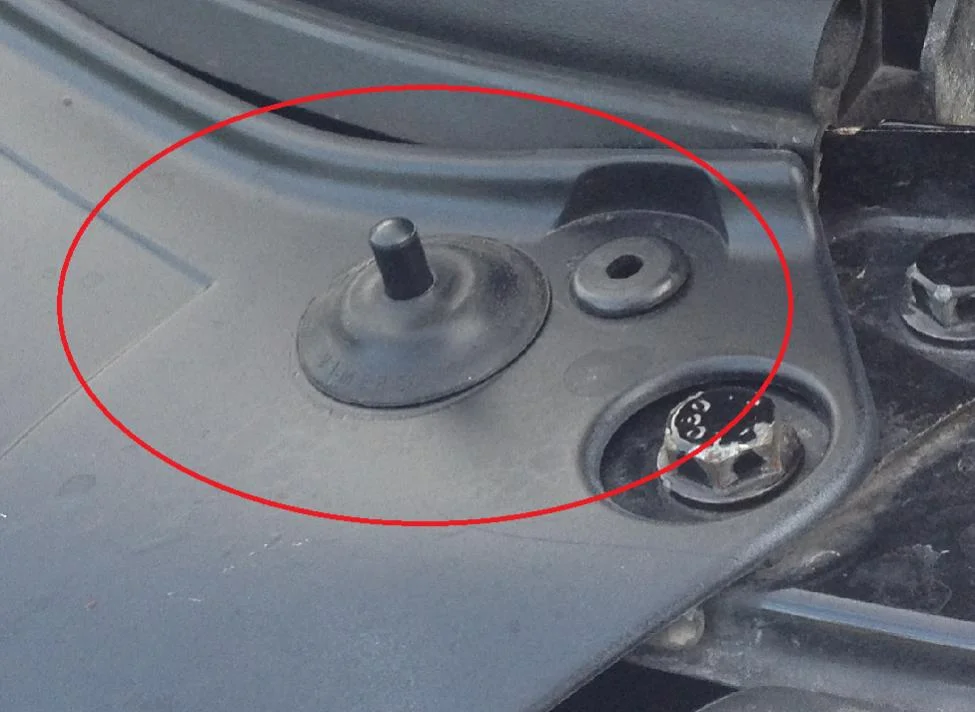

p.s I'll post a picture soon of what I think to be the sensor
  BG182
Here's a picture of what I think is the alarm sensor and also a picture of my car I took last weekend (I apologise for the generic bonnet-up photo)

I have an issue with this too, I lock the car with fob and get a continuous beep looked at the sensor and its kind of loose have you fixed yours or replaced it? I know it's this sensor as when I hold it down and arm the alarm then the beep goes away!!
