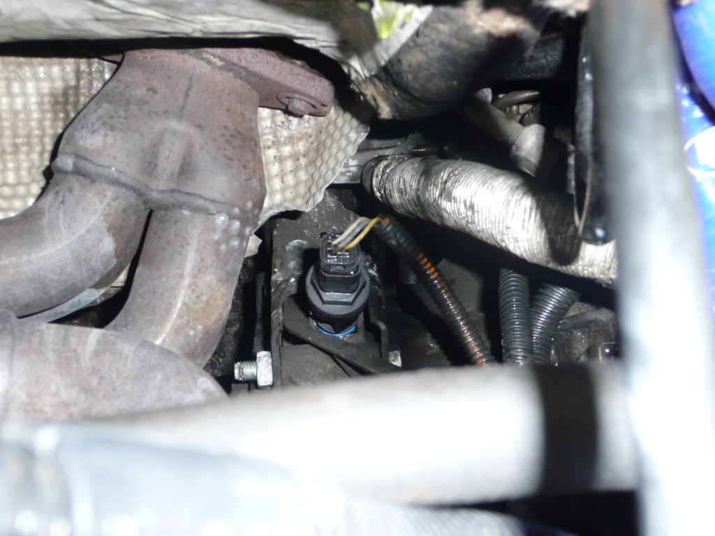

Just been out and if its this...
Then I do lol.
Better take if off and have a look!
Pic is stolen, mine seems to have a heatshield around it
Rob
Yes indeed that is it, and yes indeed it has a heat shield, easy to remove, twist and pull, if you twist pull, clean and re-fit, and it works for min, then you'll just need to get another, I always found when mine was fubar'd it'd still work if you took it out for a bit and cleaned it etc.
