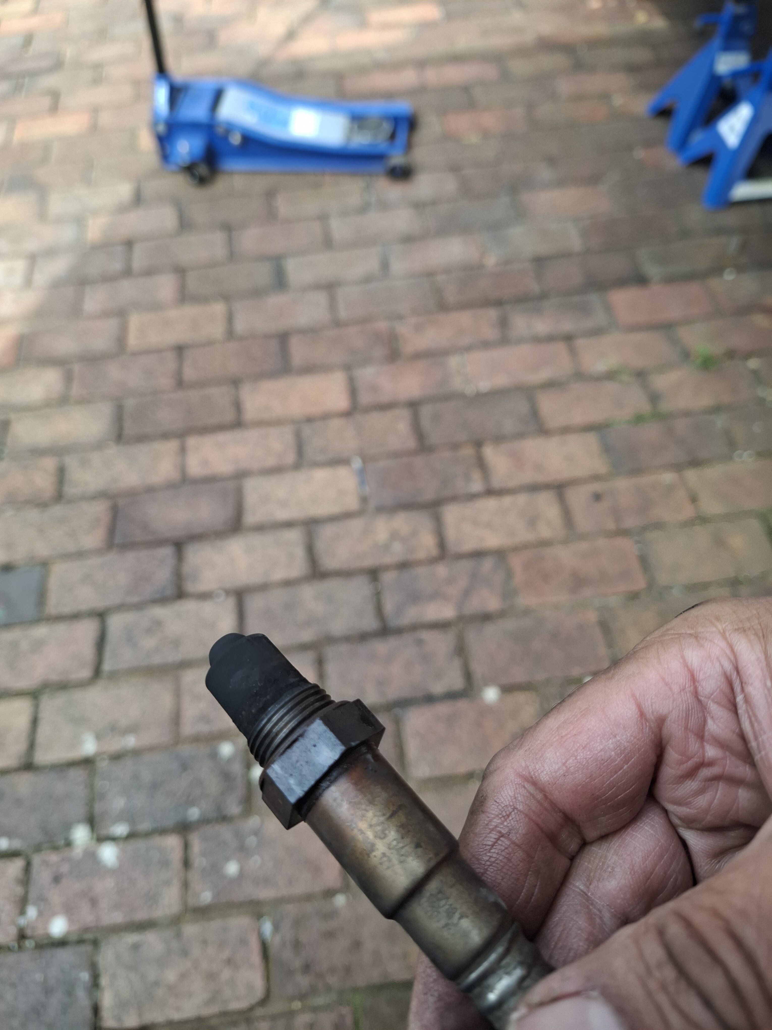

Great, thanks. Could I also swap the lambdas, as the secondary one doesn't have a bung and is just reading open air at the moment? Also, is it alright to remove the plenum without replacing the gasket afterwards?
I did in fact notice the car is running extremely rich, with a strong fuel smell out the exhaust and the fuel needle has definitely dropped despite only being revved in the yard for a collective 30 mins.
