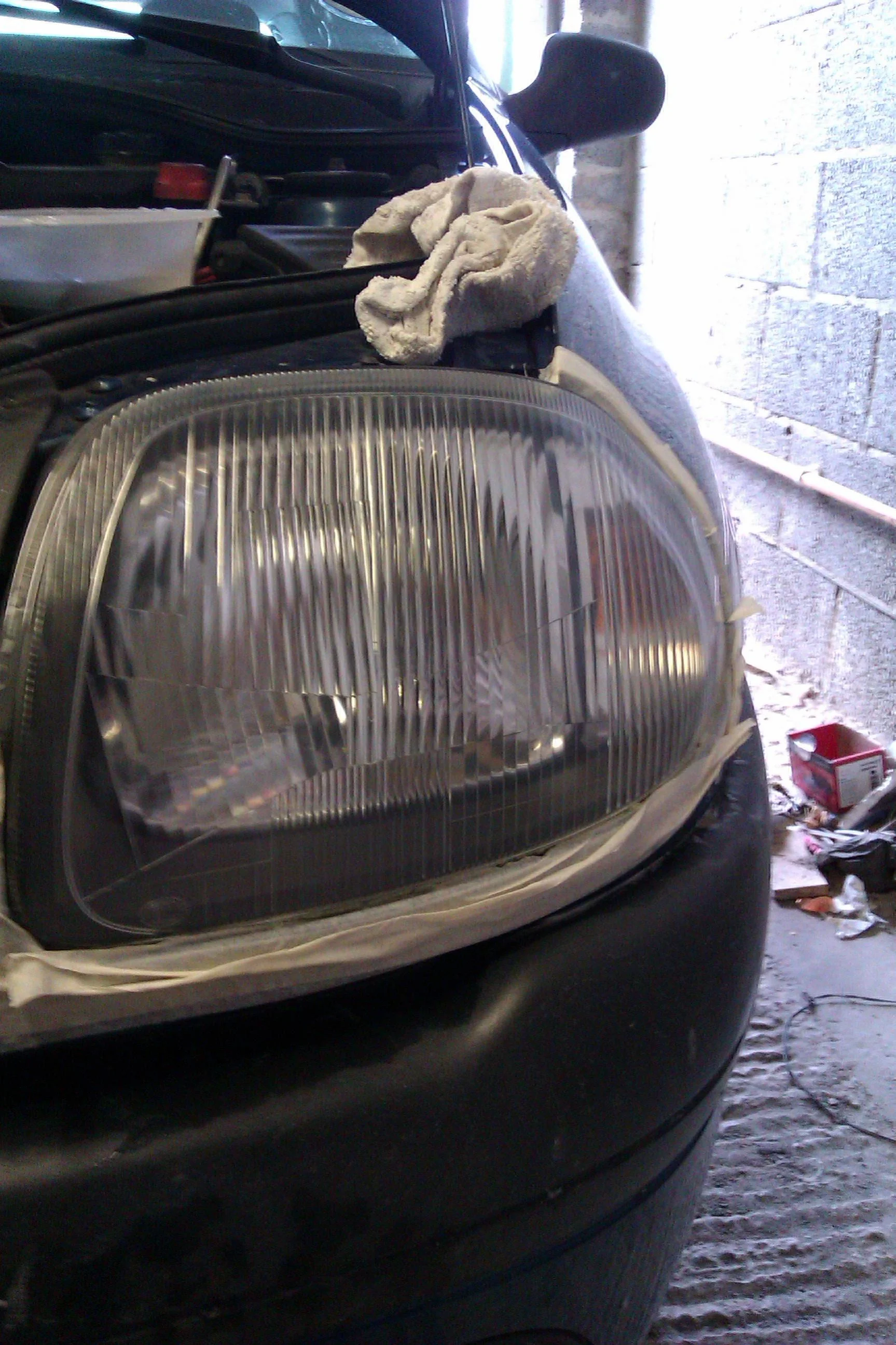

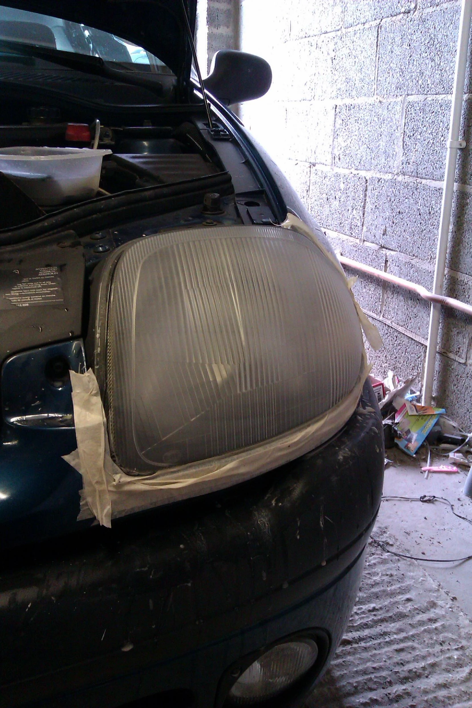

Its time for the M.O.T on my mums car, last year my boss advised on beam pattern deteriorated so I thought i do a little correction on them
they came out tidy considering it was done by hand Haha needless to say arms are hurting now
..... Anyway starting from 1st attachment

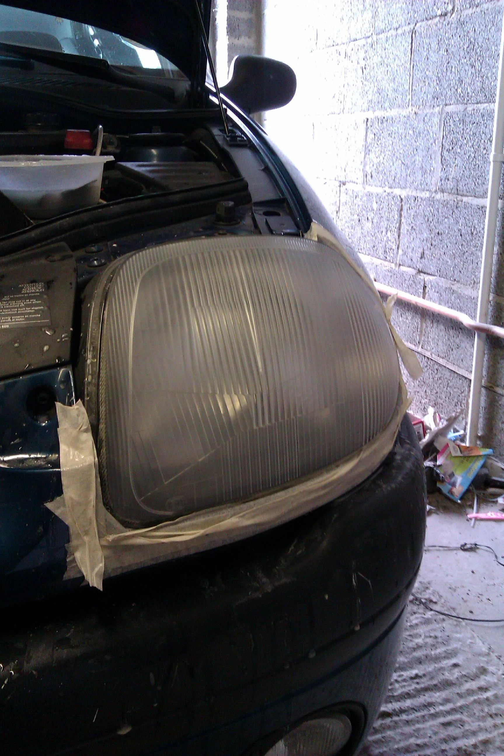

0044 - before

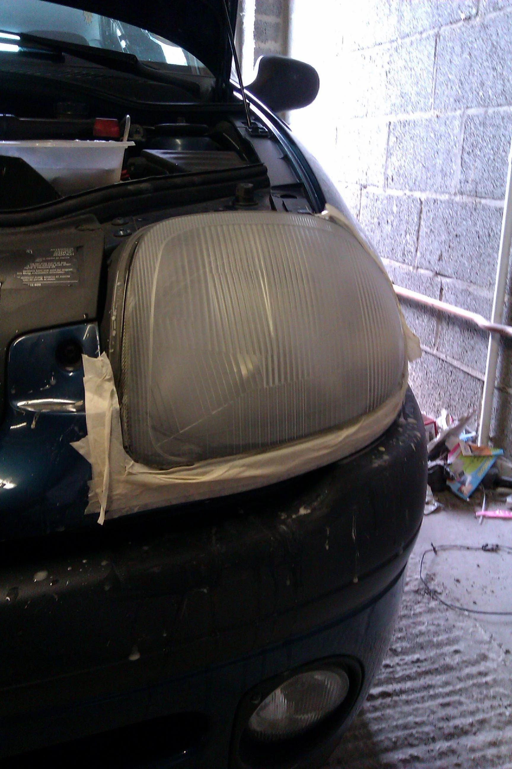

0045 - 1000 grit

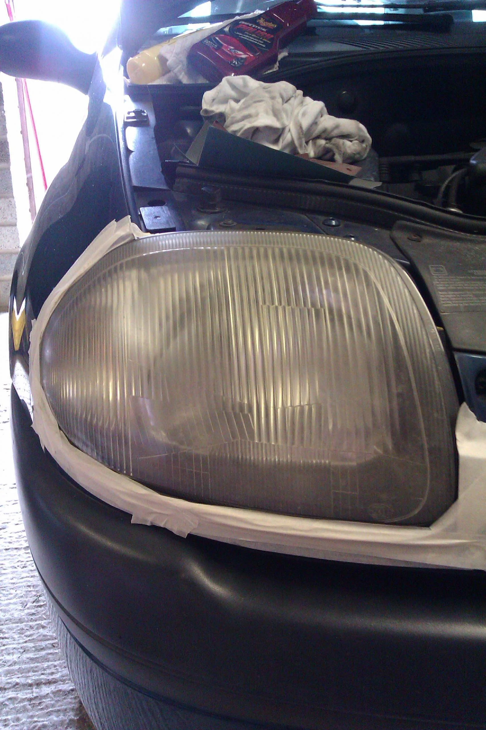

0046 - 1200 grit

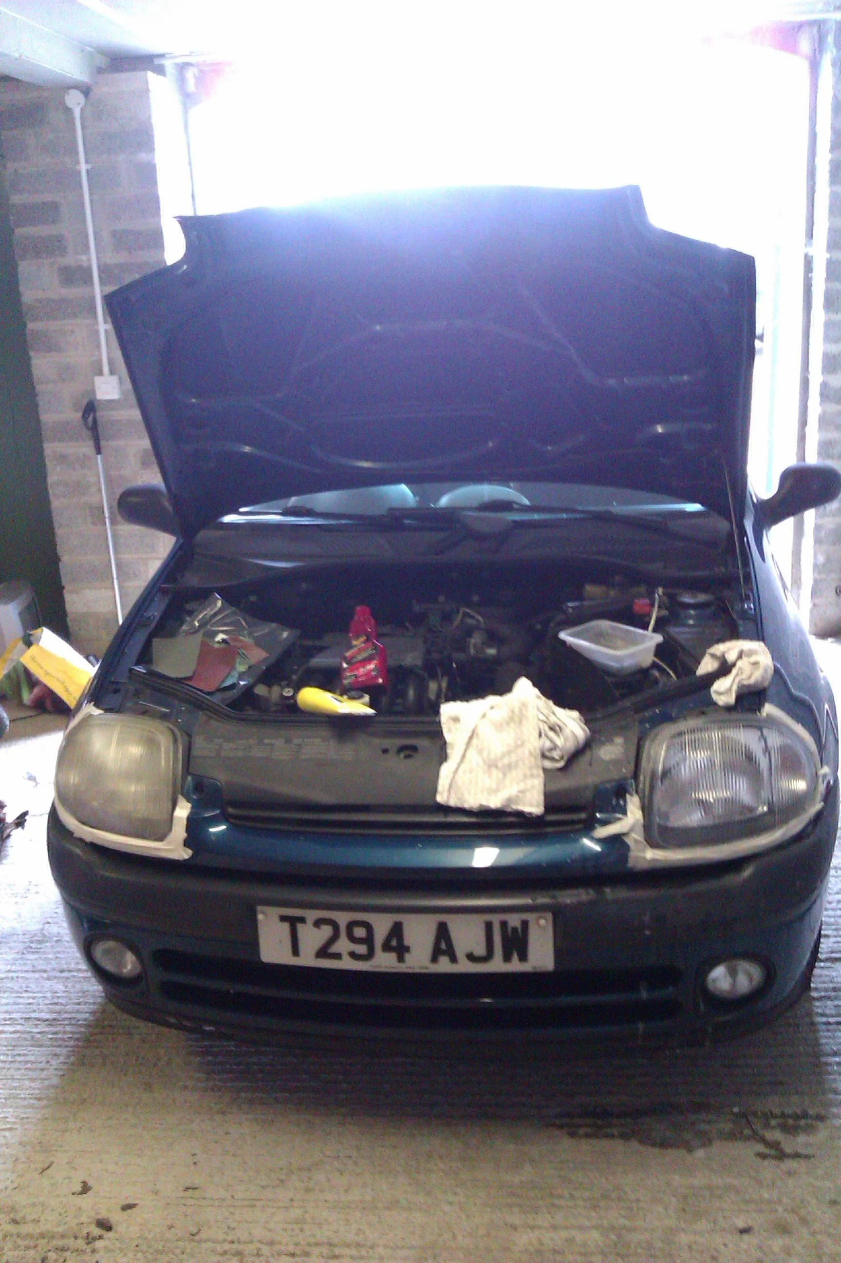

0050 - before & after
0052 - close up after

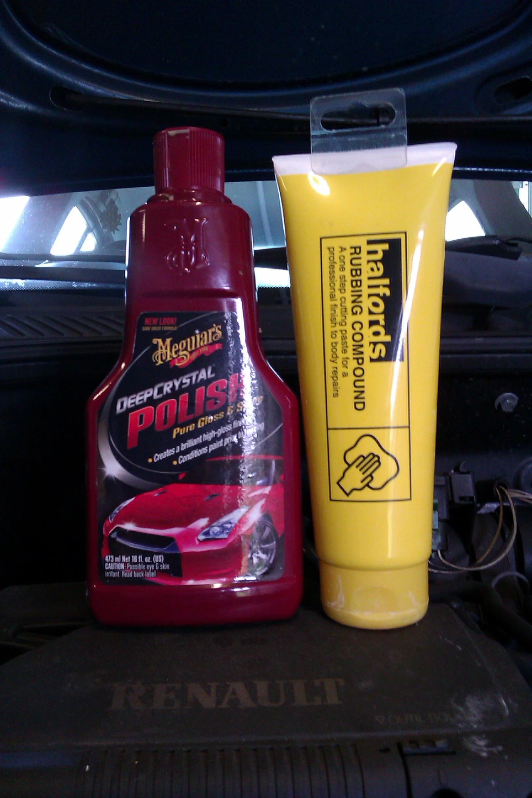

0054 - products used

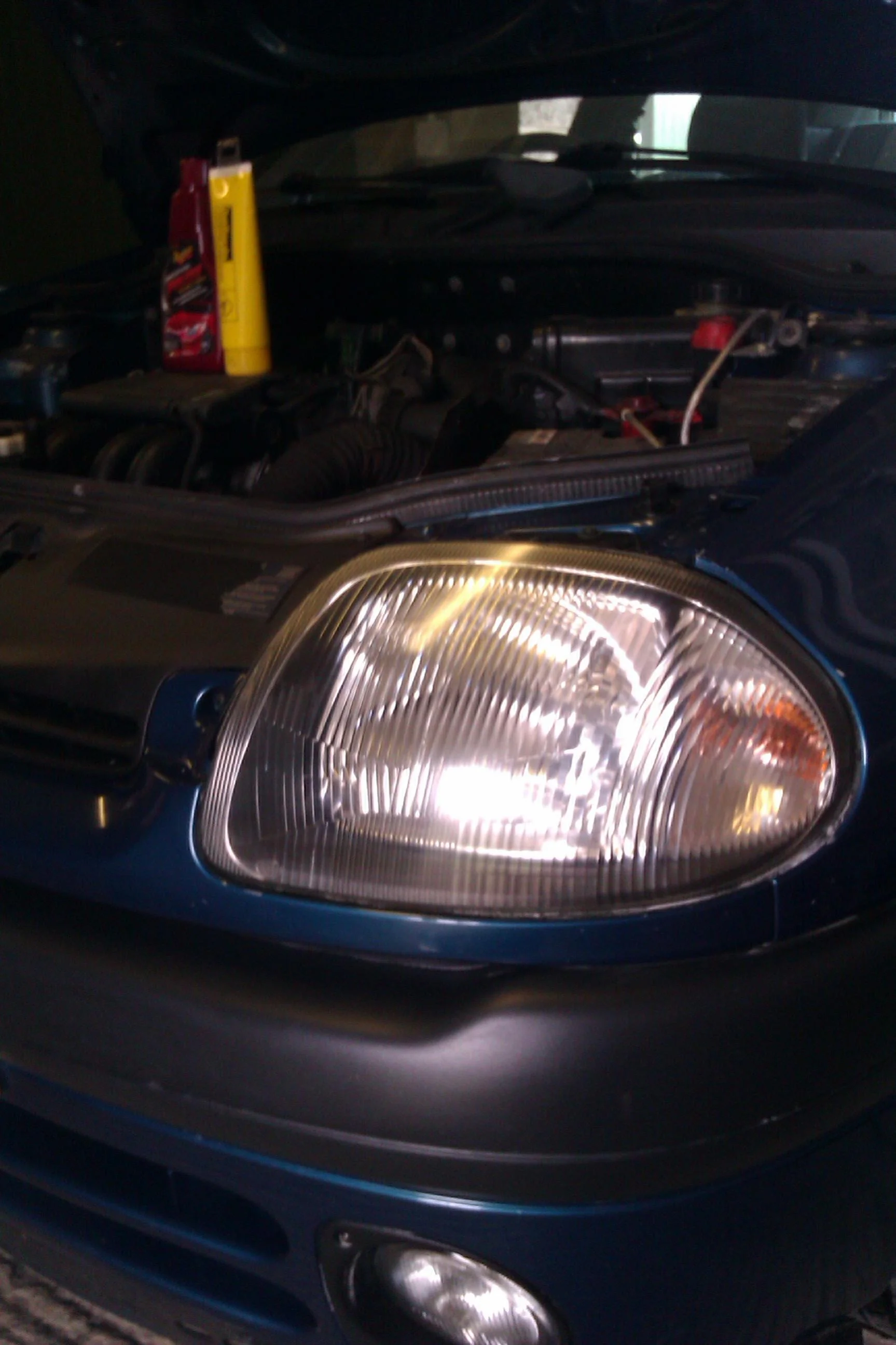

0055 - finished piece

0044 - before
0045 - 1000 grit
0046 - 1200 grit
