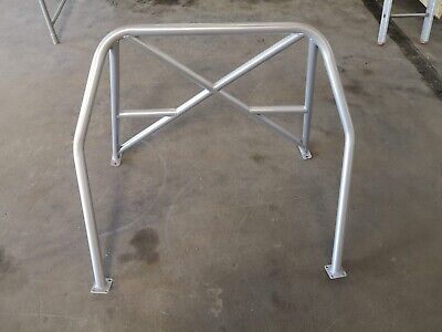

I have just bought a 4 point cage from Single Source Motorsport and fitted it yesterday
Although there is no mention on Ebay he has a facebook page which shows this is not just someone knocking out a few cages from a lock-up, but it's not Safety Devices!!
The price is very very reasonable, so I did my research and checked out the spec. The cages are made from CDS E355 and I went for all the bars being 44.5 diameter tubing at no extra cost.
The cage itself is reasonable quality, the welds are acceptable, the fit is good, though the powder coating is not the best but at the price I paid i'm happy.
The spreader plated will need bending to fit the curvature of the rear arches before welding them in. I've bolted mine in and getting the plates welded next week.
Delivery was about a month and had to chase, so not quick as quick as suggested on the website and on initial enquiry.
MY clio is used for hill climbing and is not mandatory for the class I compete in but will provide some roll over protection and will stiffen up the car a little.
BTW the rear seats have to stay in as does the trim for class 1B in hill climbing /sprinting,
On balance I think they are good value, but judge for yourself
I am not connected with the seller.

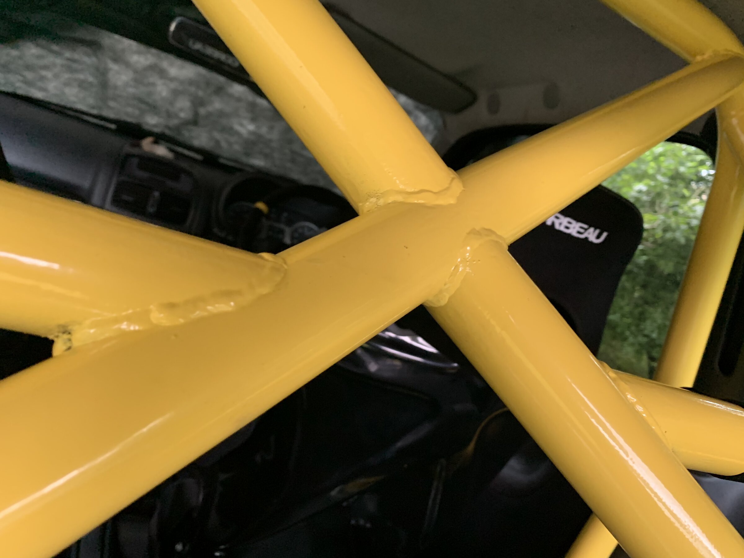

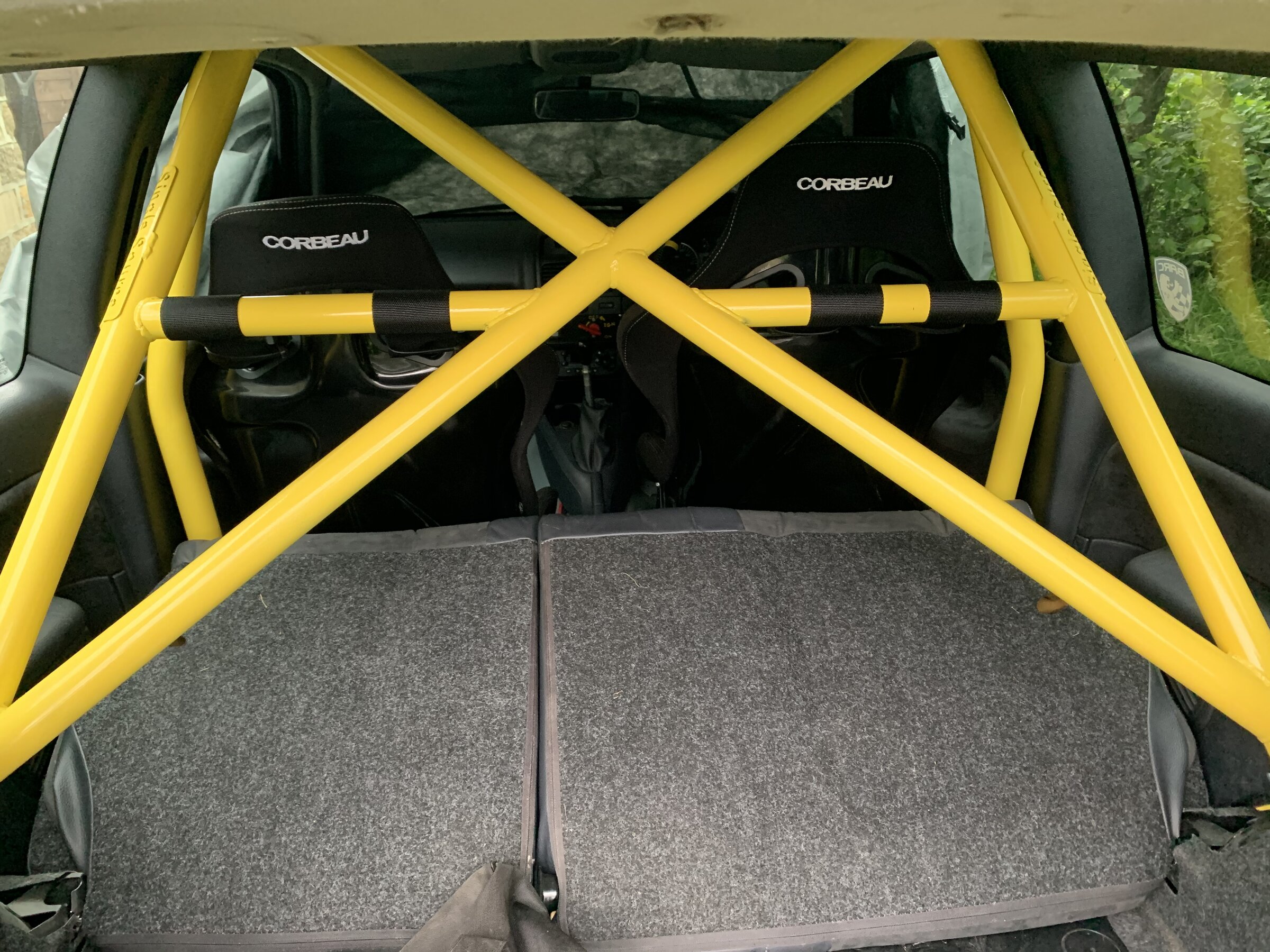

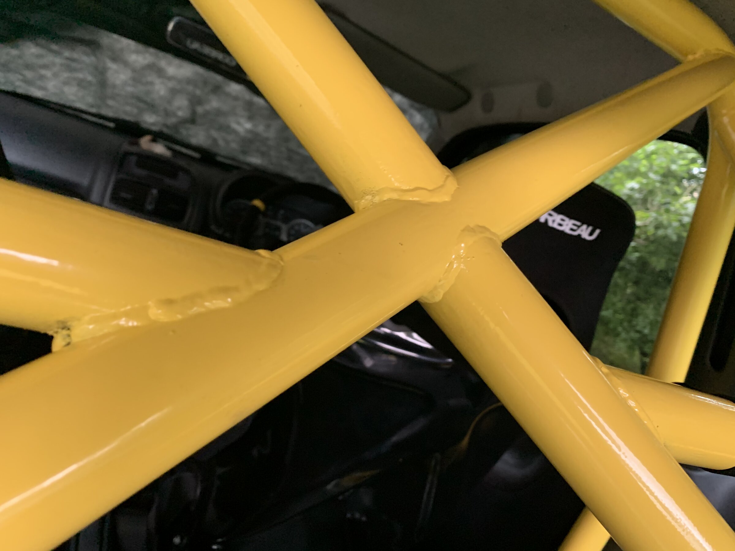

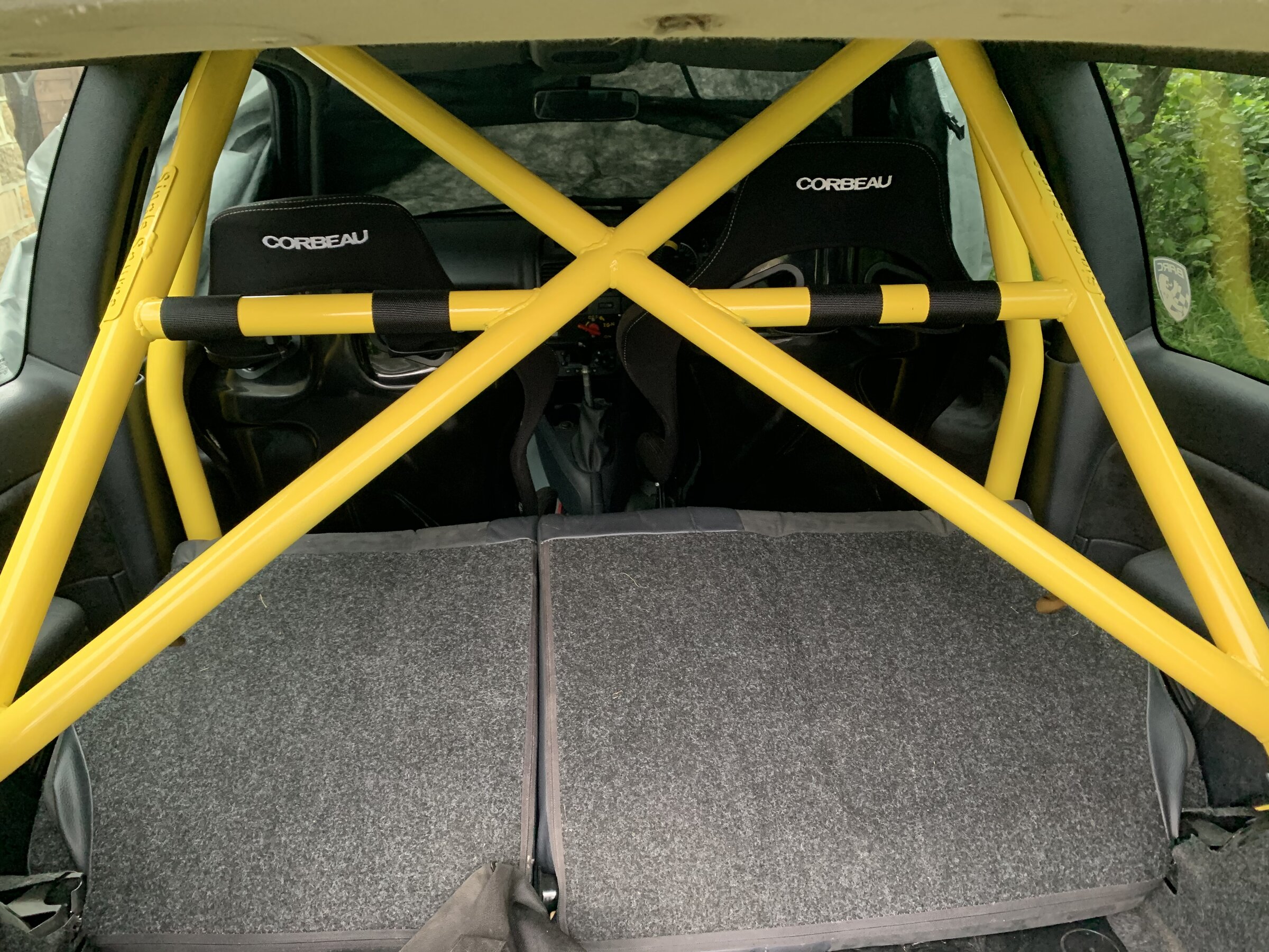

View attachment 1487395View attachment 1487394
How much was this BTW? Very interested myself.
