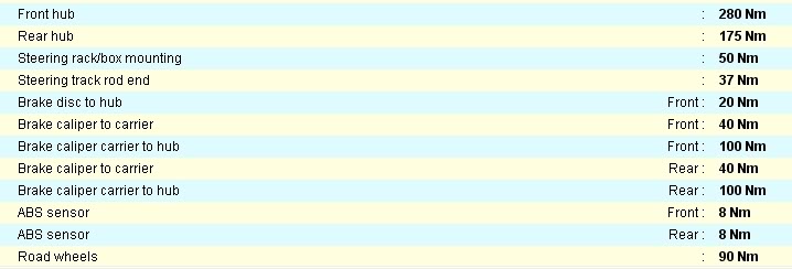

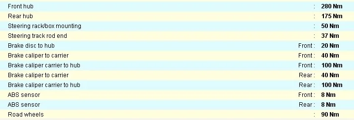

1/2 Inch drive and 90Nm according to Autodata .
