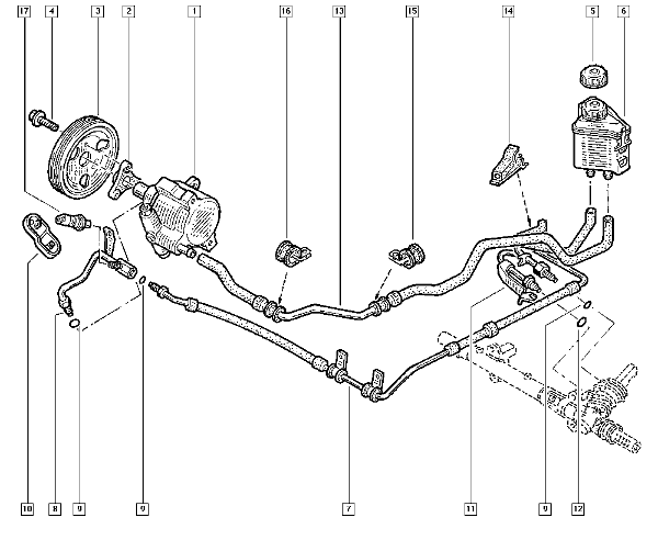

Judging from your avatar and car details i assume its a 172 cup ?
Oval plate will be CB1N
Part number for PAS pump ( this number has changed quite a few times over the years but all these are the same parts )
7700840105
6001546641
6001547641
491108814R
8200888510
8200711377
The same part is used on most clio's from 1994 - 2004. Its also used on the 1998 - 2002 kangoo 1.9d vans.
