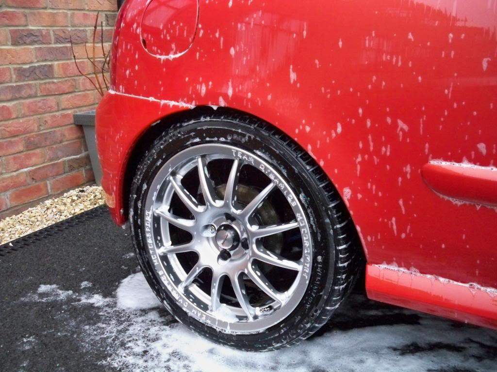

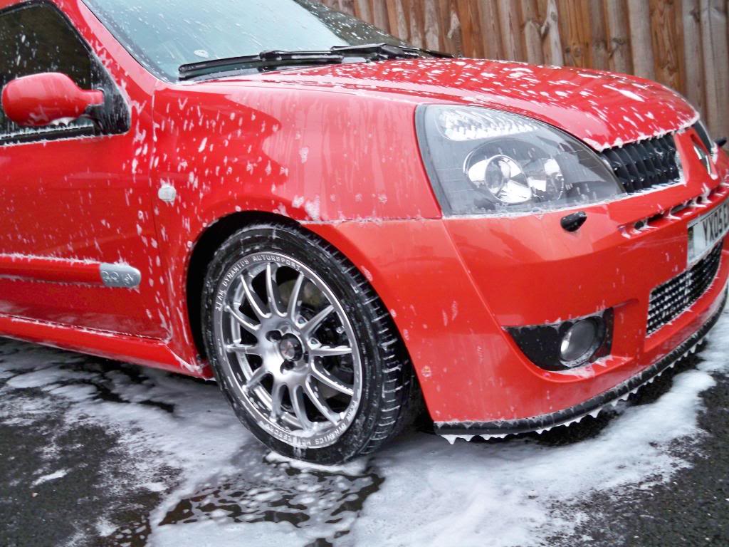

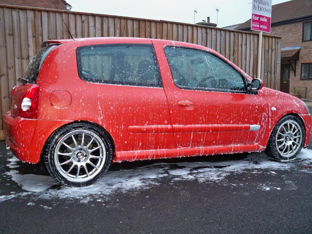

There's no denying they do offer the perfect ride height. Looks awesome in those pics. Balanced arch gaps and no 'broken spring' look at all. Saying that, from what people are saying, I get the feeling they're more about show than go. I suppose it depends on the driver's priorities. Not everyone is a b-road monster.
