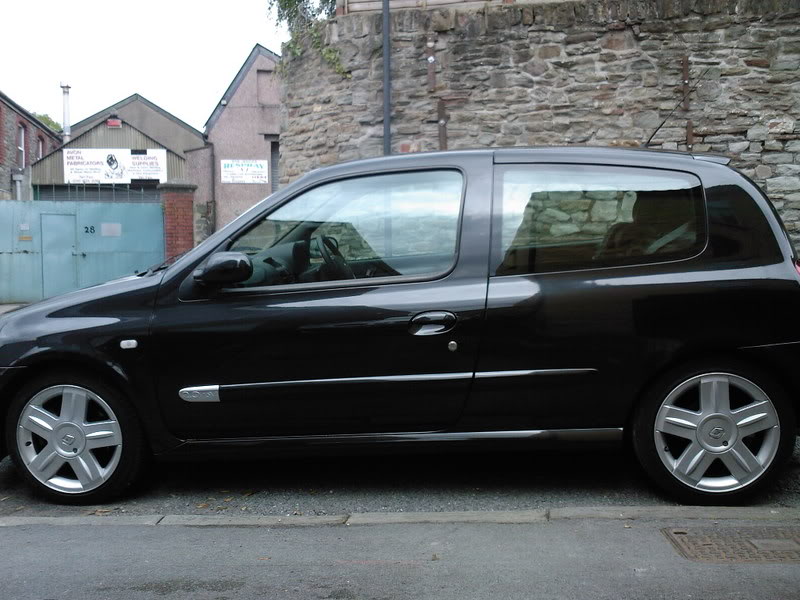

Do you have any side on pic's of yours Gweebs?
  Focus ST
Thats all I've got to hand at the mo. But I'm going to do another exhaust clip now with the decat fitted, so I'll take some side views for ya.

That looks more like it.
Does the height on mine look about right for day 1 of fitment? I hope to god they settle down as I've just sold the Apex.
More pics would be great.
