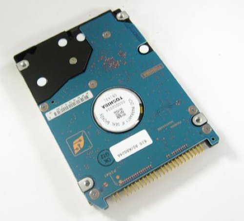

It will be an IDE unless its a farely new top spec laptop
Can replacewith normal 5400rpm hd or a 7400rpm hd if you want a bit of a performance increase

Dell (and other brands) use adapters similar to this to make it easier to pull the disk out and put it back without bending the pins, but underneath they're just normal ATA drives. 1.8" HDDs are an absolute sow though, as you can get ZIF ones, 44-pin, allsorts. And they're massively expensive if you're unlucky, and even more impossible to get hold of.
