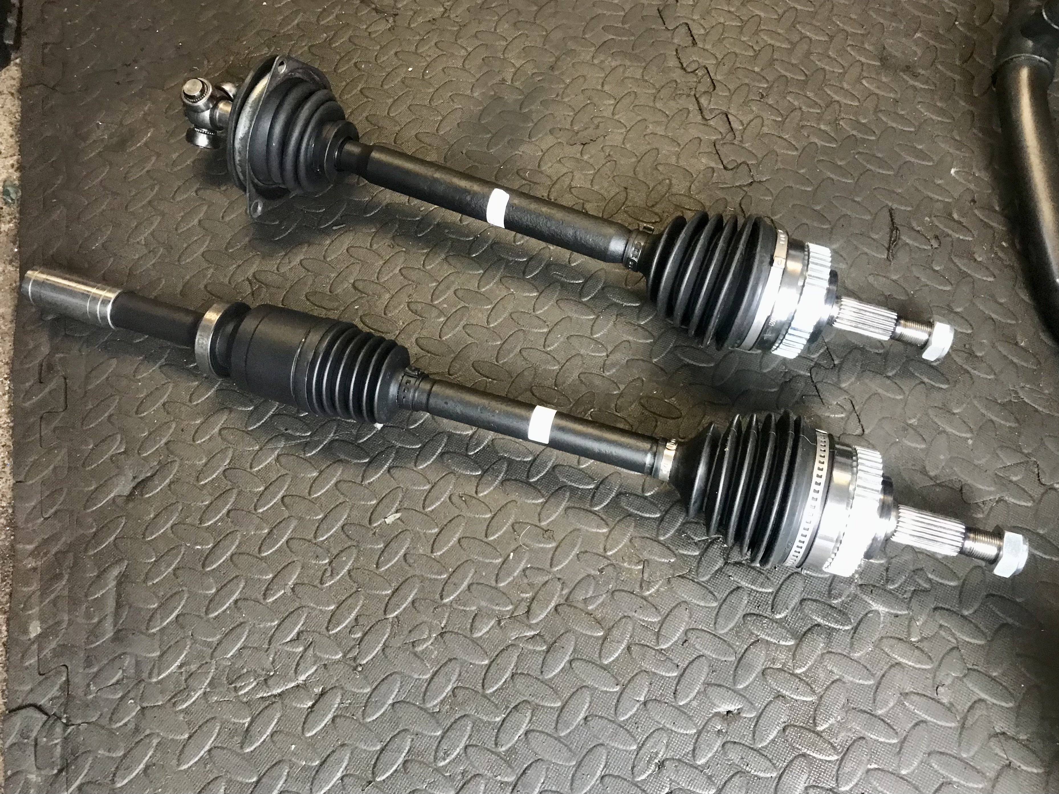

Are these correct ?
Advikaz

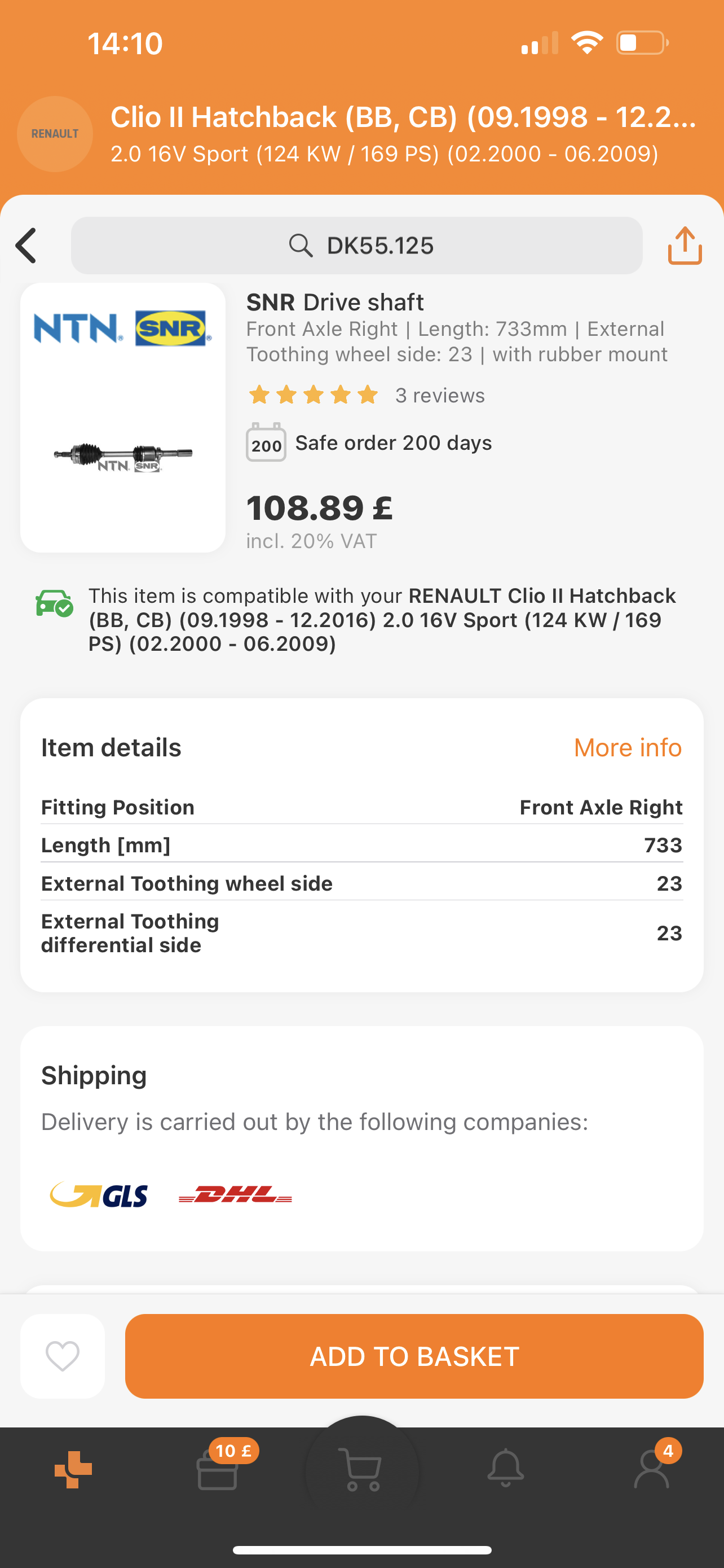

Any ideas ? For cup packed 182..
Mr Underhill
They look like the 172 but not sure if they’re different.
Shaftec are more money but they're essentially a refurbished genuine part. You want R396R (OSF - Drivers) replaces 8200352042 and R396L (NSF - Passenger) replaces 8200372167.

thanks bud. Any links or is it best to call them ?
I bought mine from DMFX in Darlington and they delivered them. EBay have some.
