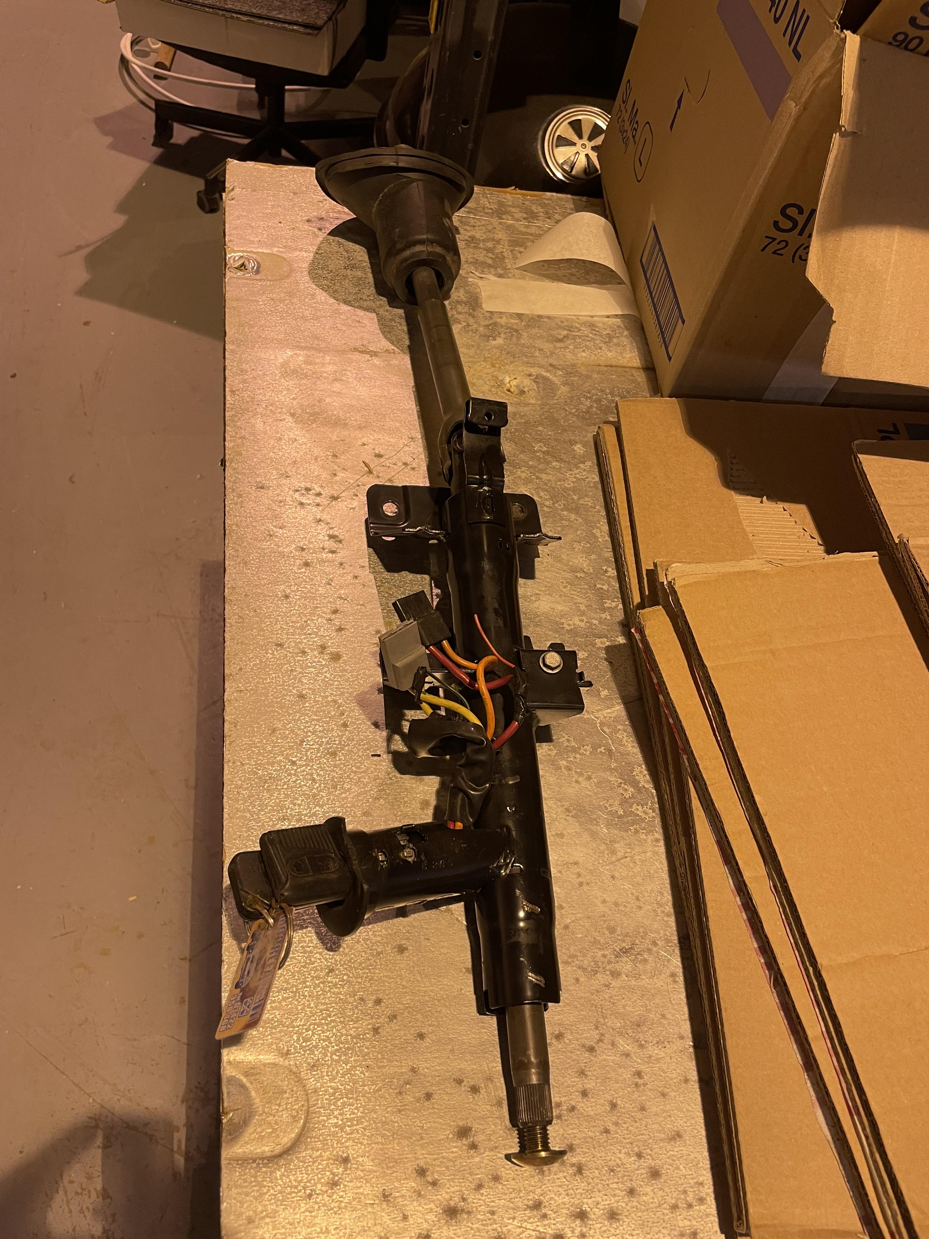

Found a column I'll collect in next few days, looks to have two connectors though I was hoping I could just plug in power and it would work? Are these just for the ignition? Also which bits need welding/strengthening on these?

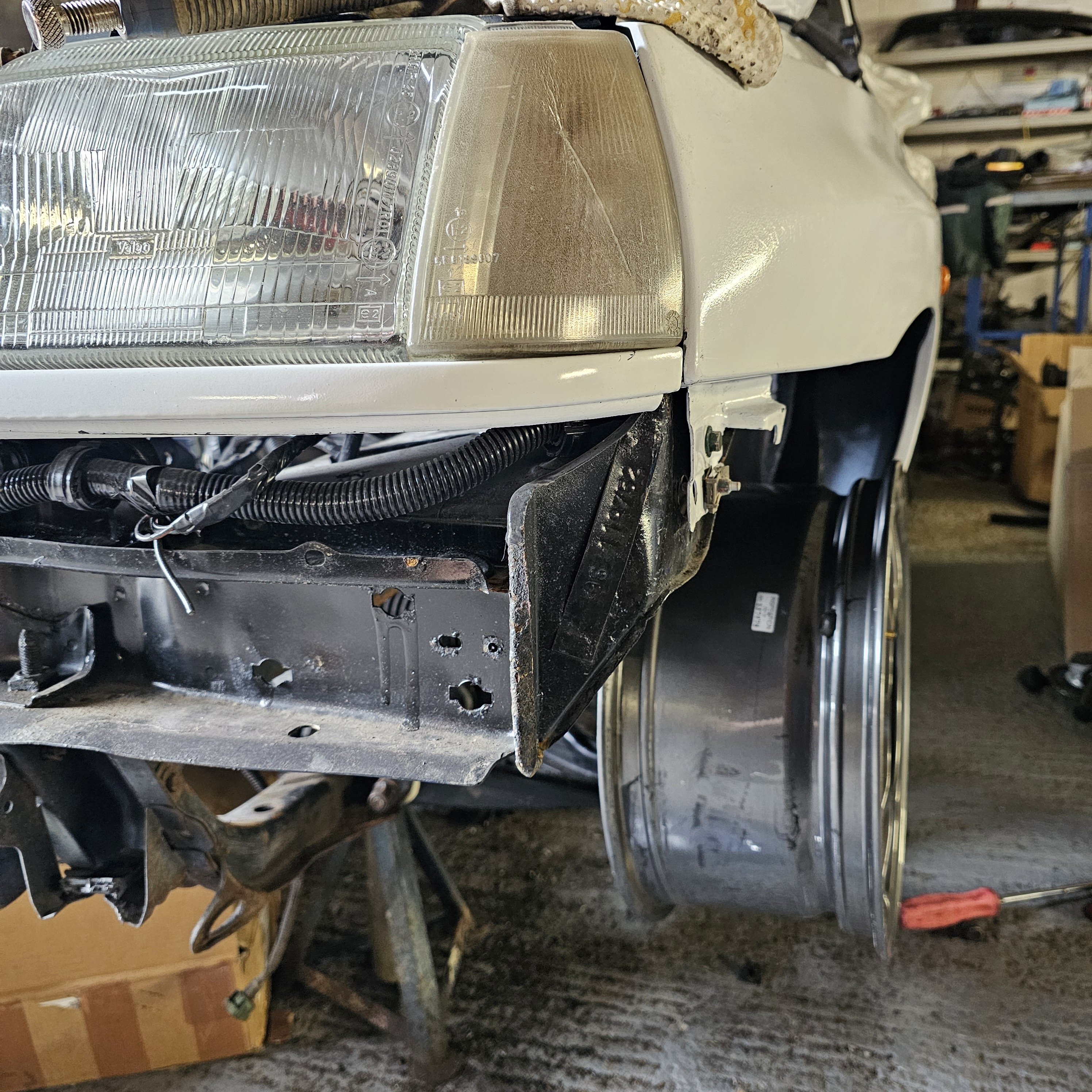

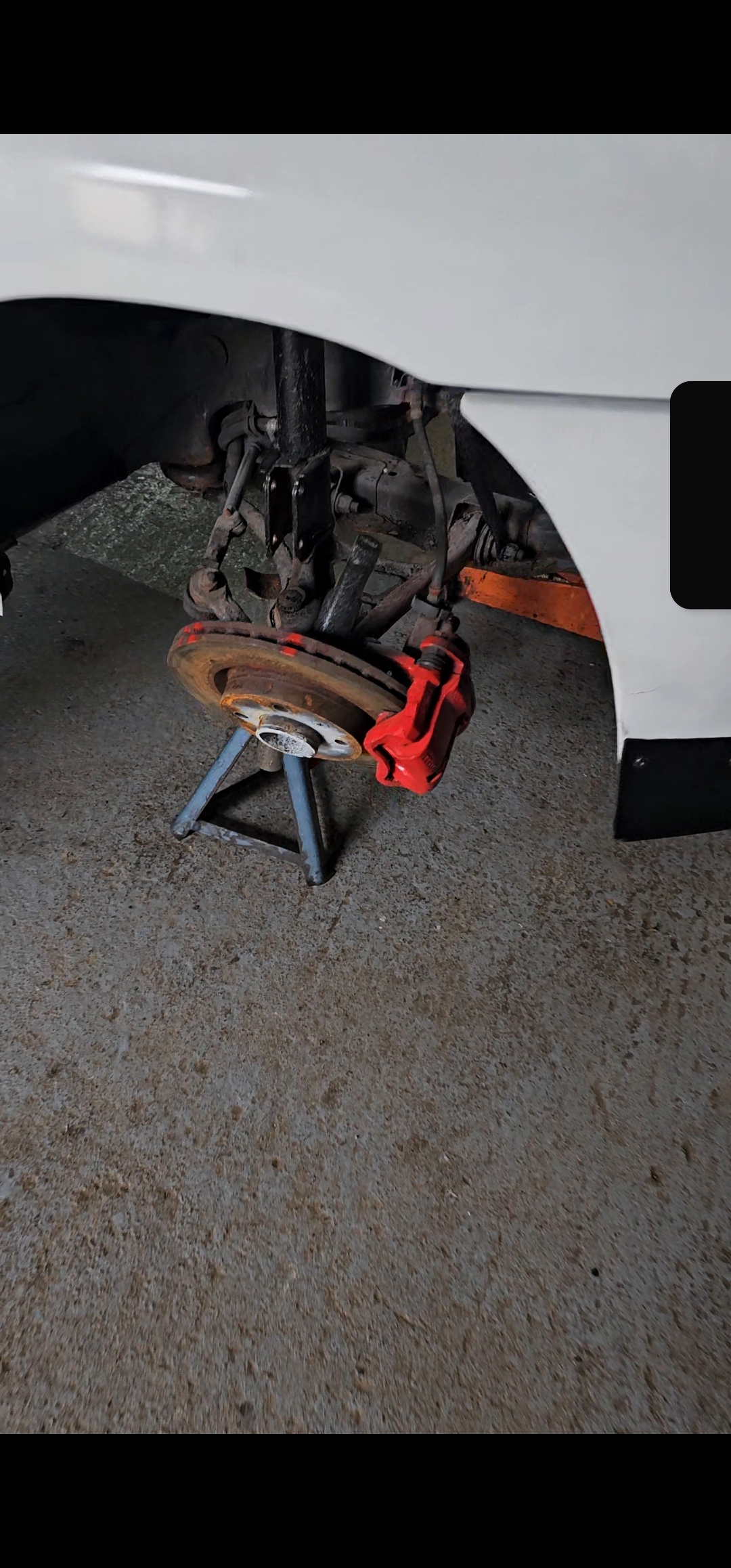

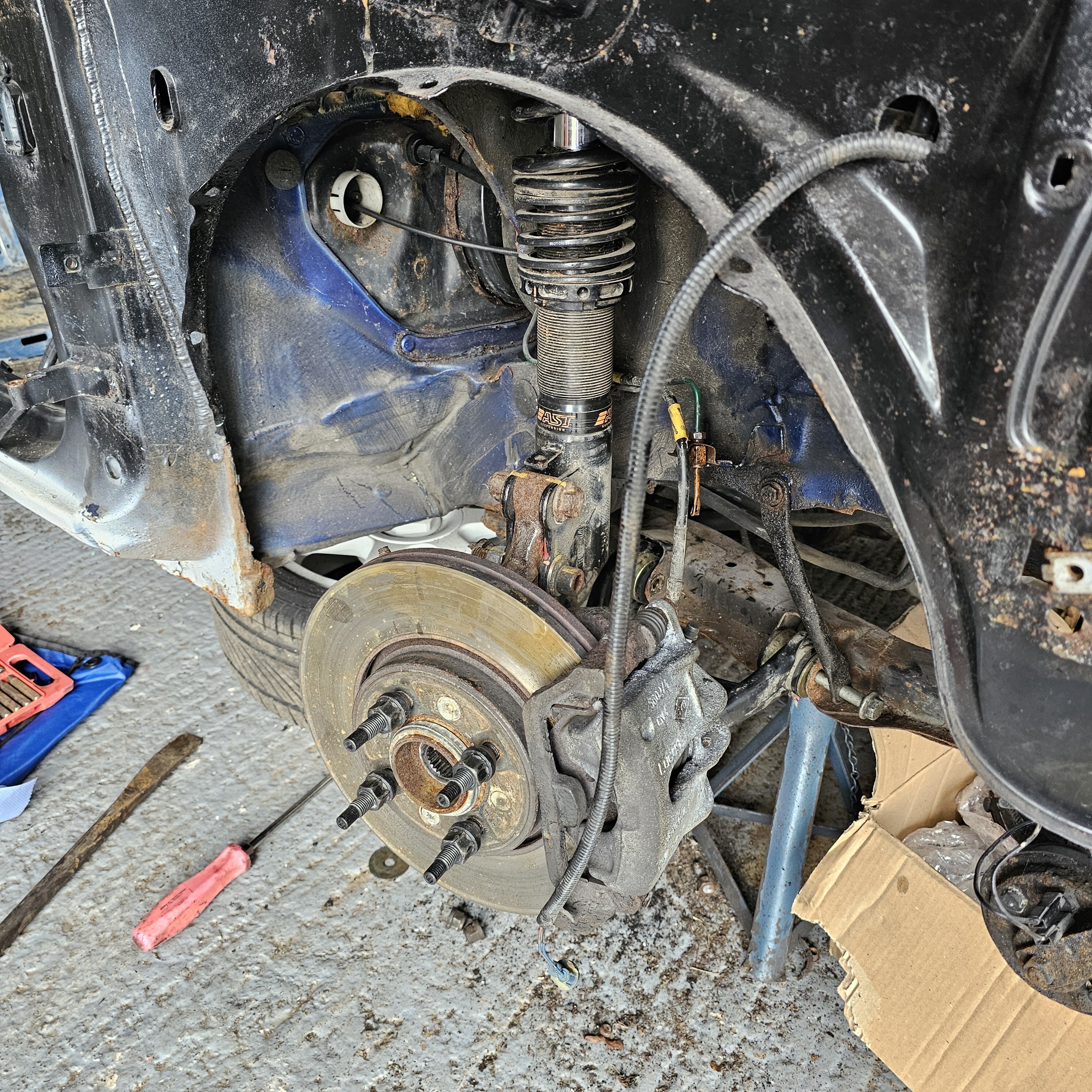

Front end coming along though, before:
After:

Do you use a power steering controller for the column or just run it as is? I've got one for a mk2 but can't see any for a mk1
16v_paddy
  Valvers & 172 Cup
I run it as is, just as a manual rack basically.
The reason for the pas column is that they're shorter than the manual column so it's just for fitment that it's needed
