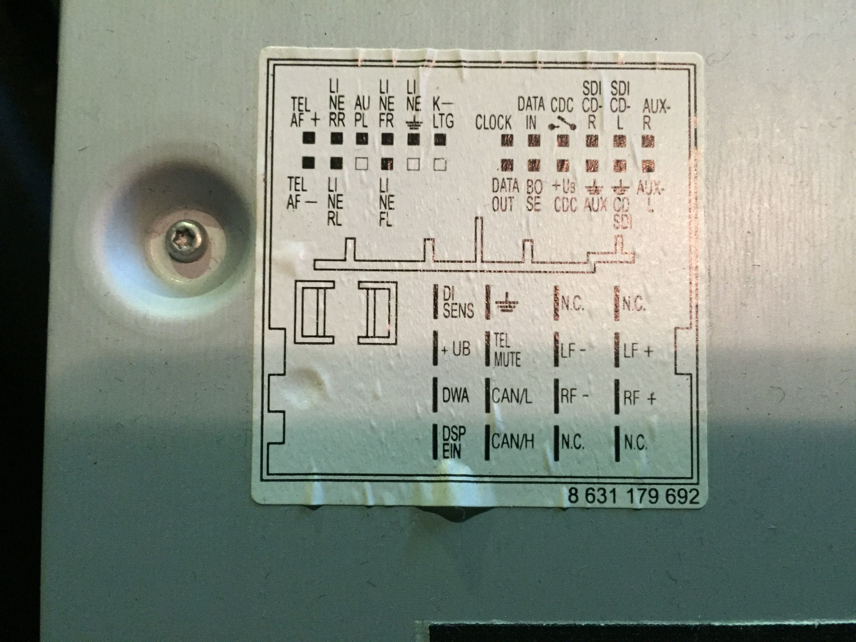

Wanting to fit an Aux / USB or something else to the audi but i seem to be having some issues.

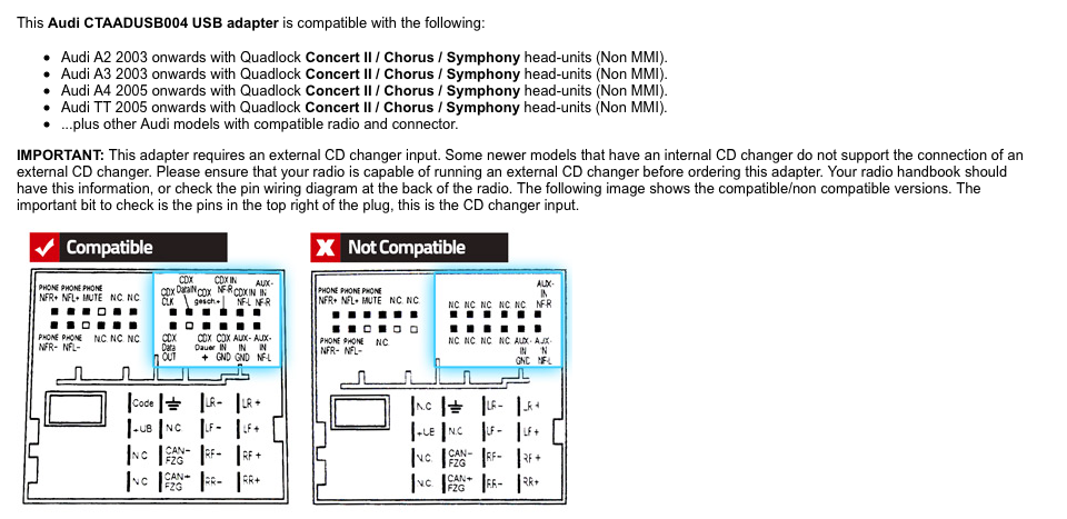

This seems ok but when looking online at the exact same kit which is a connects2 kit this comes up.
Now i took some pictures of the head unit last night as i popped it out and from what i can see i have the same as the picture on the right which shows as "NOT COMPATIBLE"
I think you're reading the diagram incorrectly. From what you've posted, yours is compatible. Seems to be the translation which is making you think otherwise. You may need to swap 2 pins on the right hand block.

Its all sorted now as per Audi-Sport.
Had to get the head unit coded via VCDS (Vag-Com) and then when i bought the Aux cable i had to move the black wire from PIN 2 over to PIN 3
