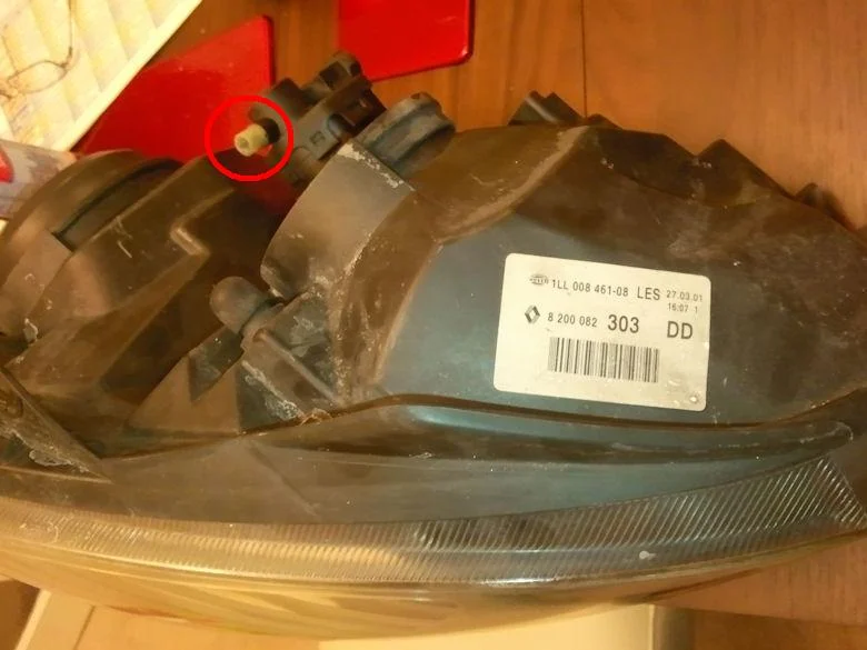

Park on a level surface facing a wall about a cars length away. Turn the car off. Adjust one of the motors and i mean about 20 full turns of it (its not a quick process lol). Turn the car back on and compare that headlight with the other to see which way you have adjusted (up or down) and adjust accordingly.
  Nissan 350z
And to clarify you are adjusting this (see attachment).
