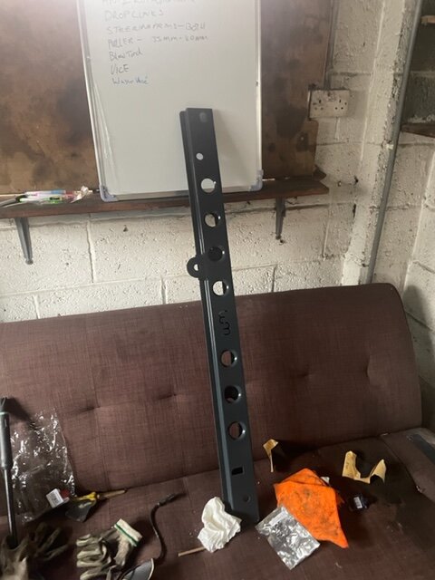

The first purchased I made for the car was an extra rear beam; this was then subsequently modified to be a PMS rear beam with their strengthening kit. I also sourced poly bushes for the car and decided to get power flex black series engine mounts. I also went for full braided lines beam back on tjhe car and replaced some of the hard lines as well.

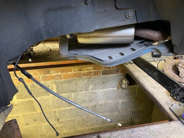

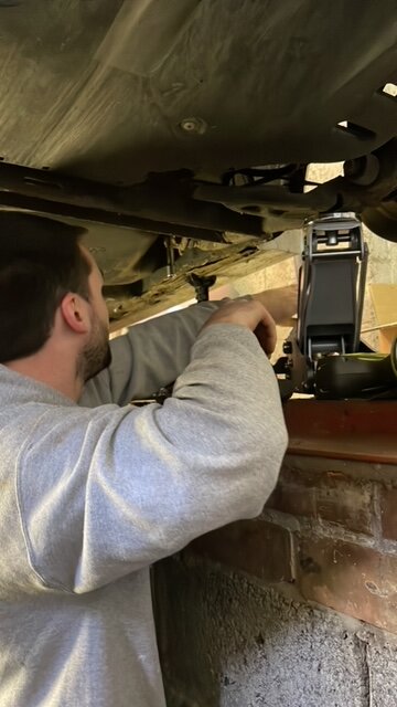

Rear beam getting remvoed / changed to the PMS Beam.
A shot of the car without a beam and a shot down into the pit of despair.

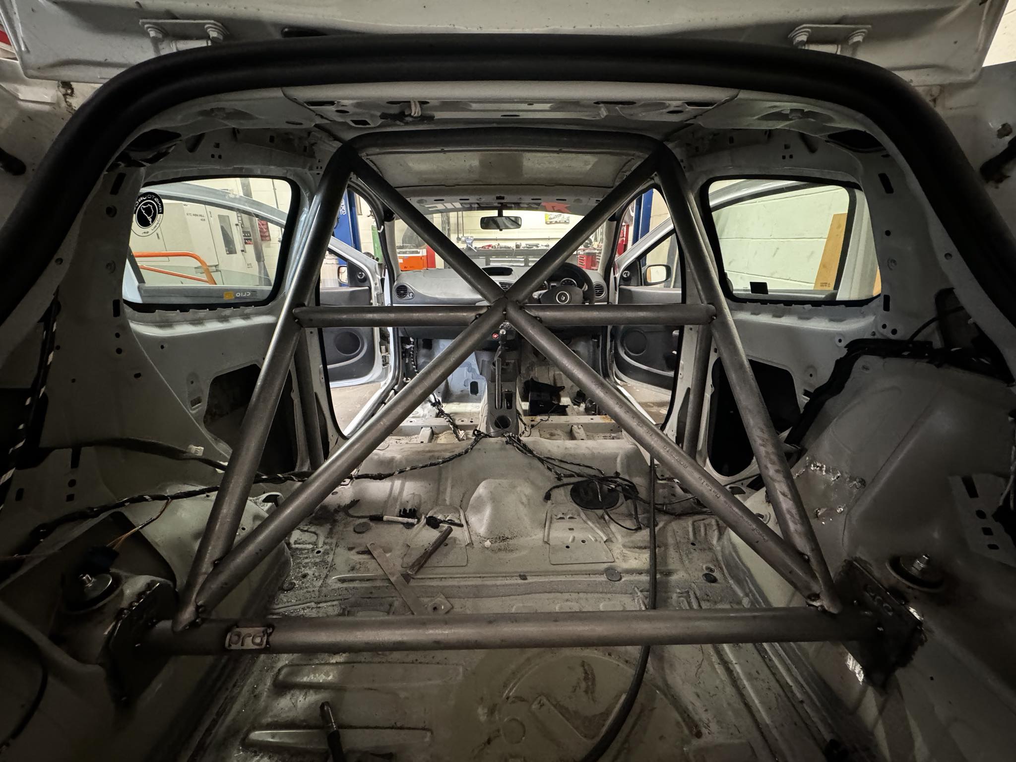

Looking into 2024, I had decided that the car needed a cage. At the time I didn't just want something that was off the shelf and got introdcued to fabricator based in Docnaster called Parkin Race Developments and decided to use him for the cage. At the time I put the cage into the car I was convinced that I was going to be still street driving the car and didn't want the hassle of hitting my head on a roll cage or looking like a complete tool when running to Morrisons in the car after a blast. So I opted to go for a welded in half cage.

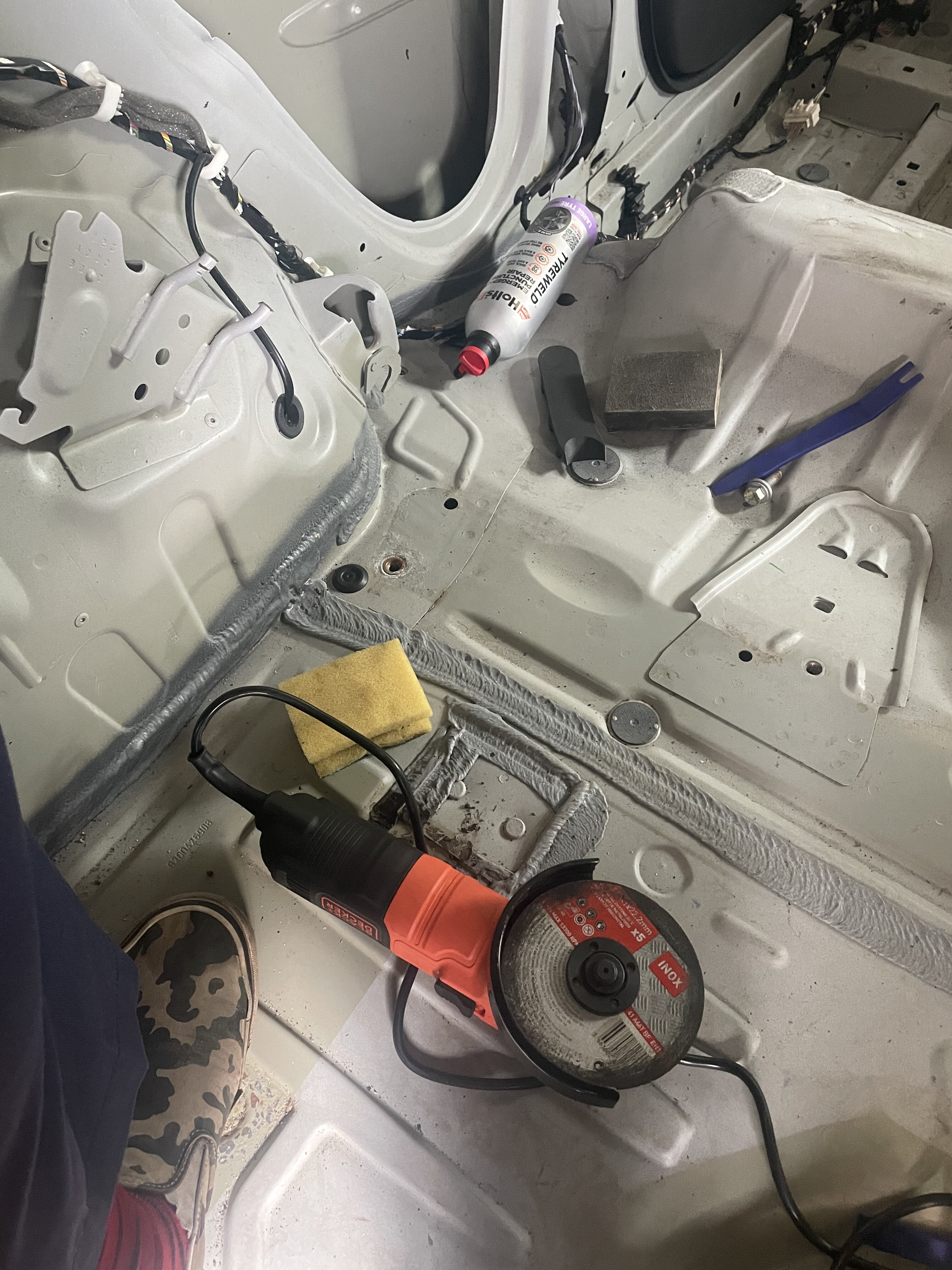

Prior to the cage going in the car was fully stripped and I decided to cut out as many useless brackets as possible to counter act the weight of the cage that was going in.

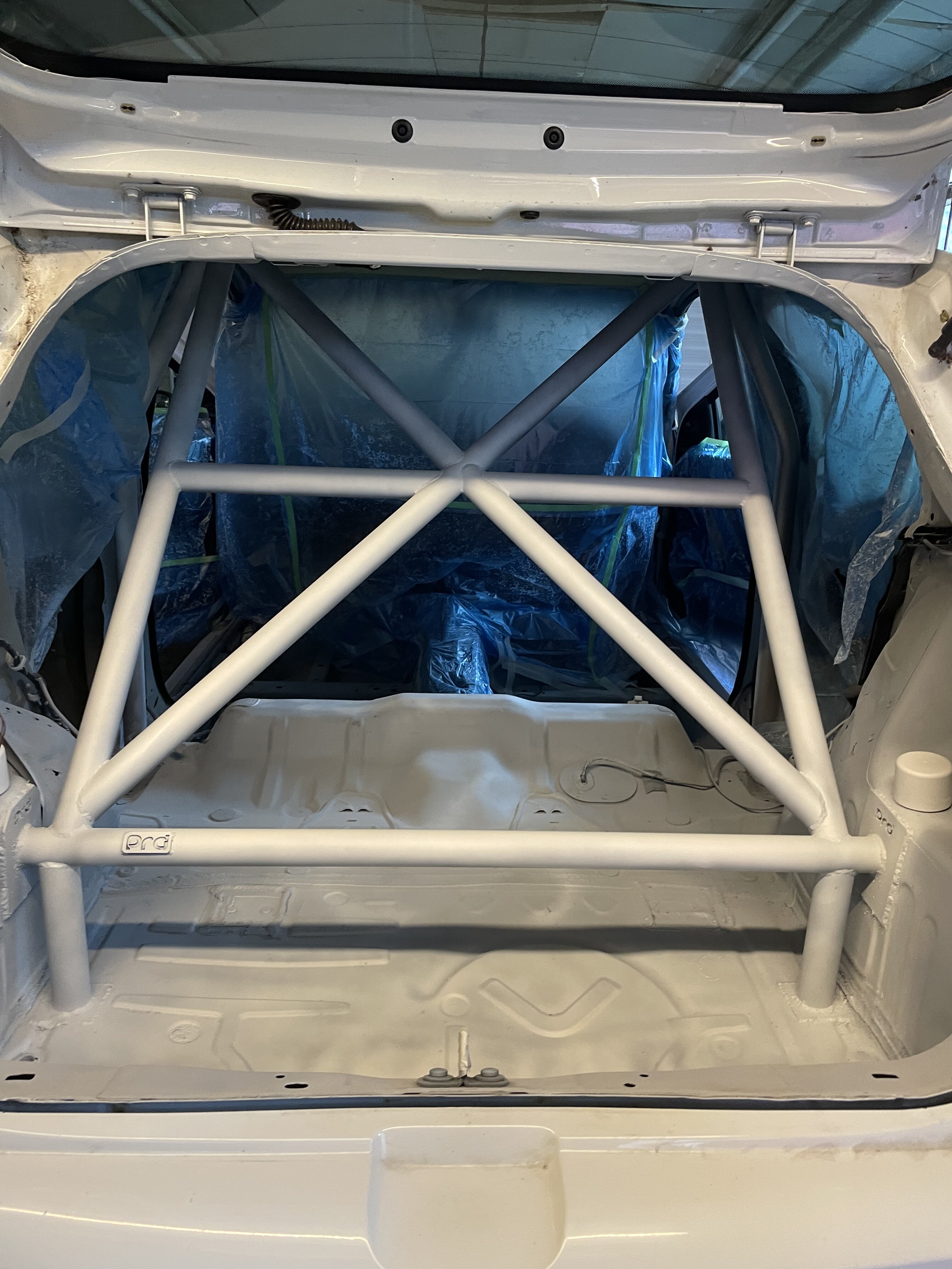

The cage takced into place.
I painted the cage myself using rattle cans, this photo is taken part way through from memory. The finish is OKAY but I'm not overly happy with it as you'll see in some later photos as the down tubes look a tw@. SO the plan is to get the interior painted porperly at some point in the not too distant future.
Some of the finish I'm not overly happy with featuring my reflection. I really think this lets the car down as other than the stone chips you get on the car from using it on track it looks pretty good and gleams as my old man would say.

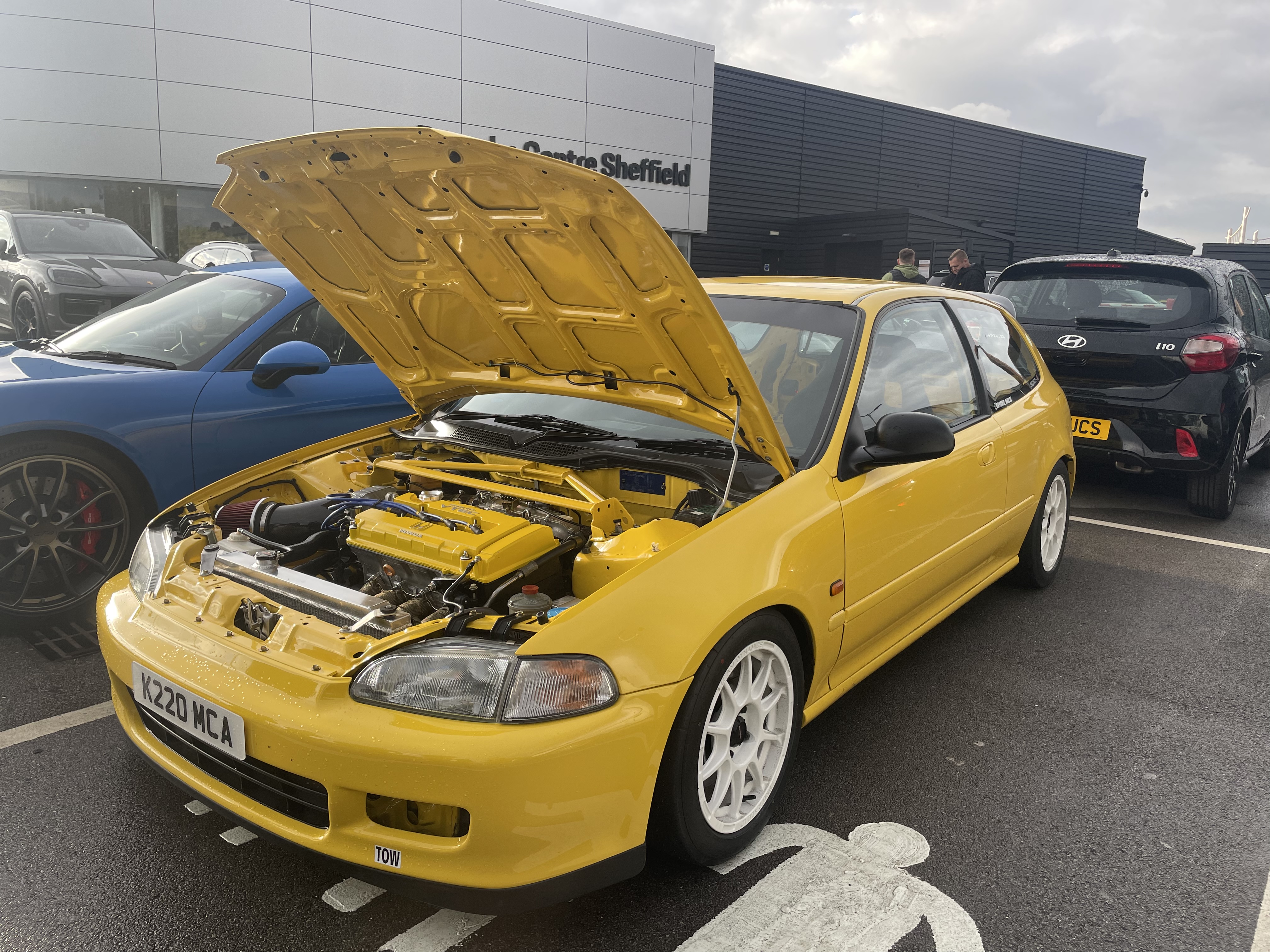

Good turn out as per! Though this eg was definitely my highlight!
Always wanted one of these. Best looking civic shape in my humble opinion! Spoke to the owner and the B18 revs to 9.5k with a capability to go to 11 if he wanted.

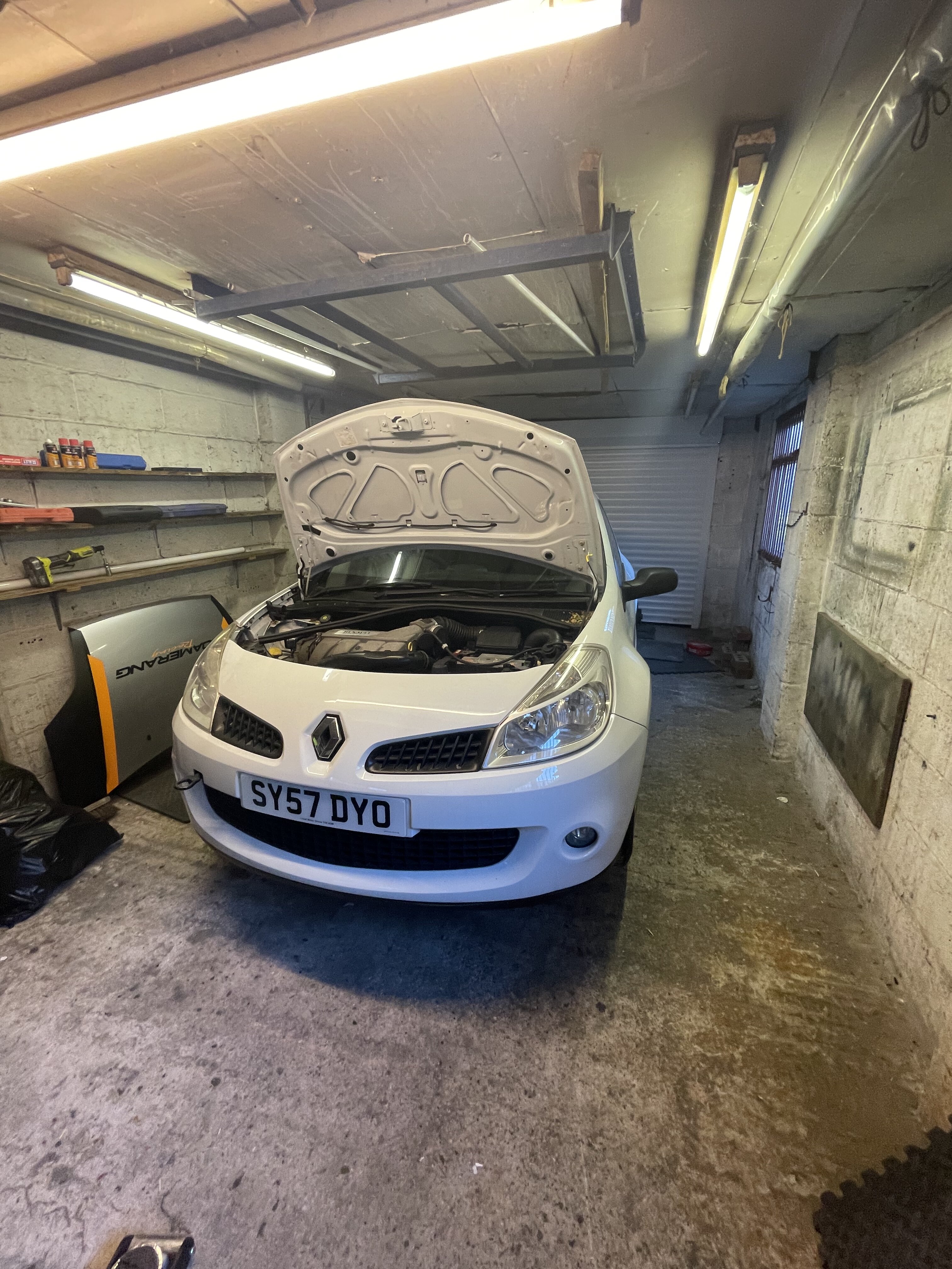

After that it was a garage day with my friend Bean working on both our cars In preparation for Blyton in a couple of weeks.

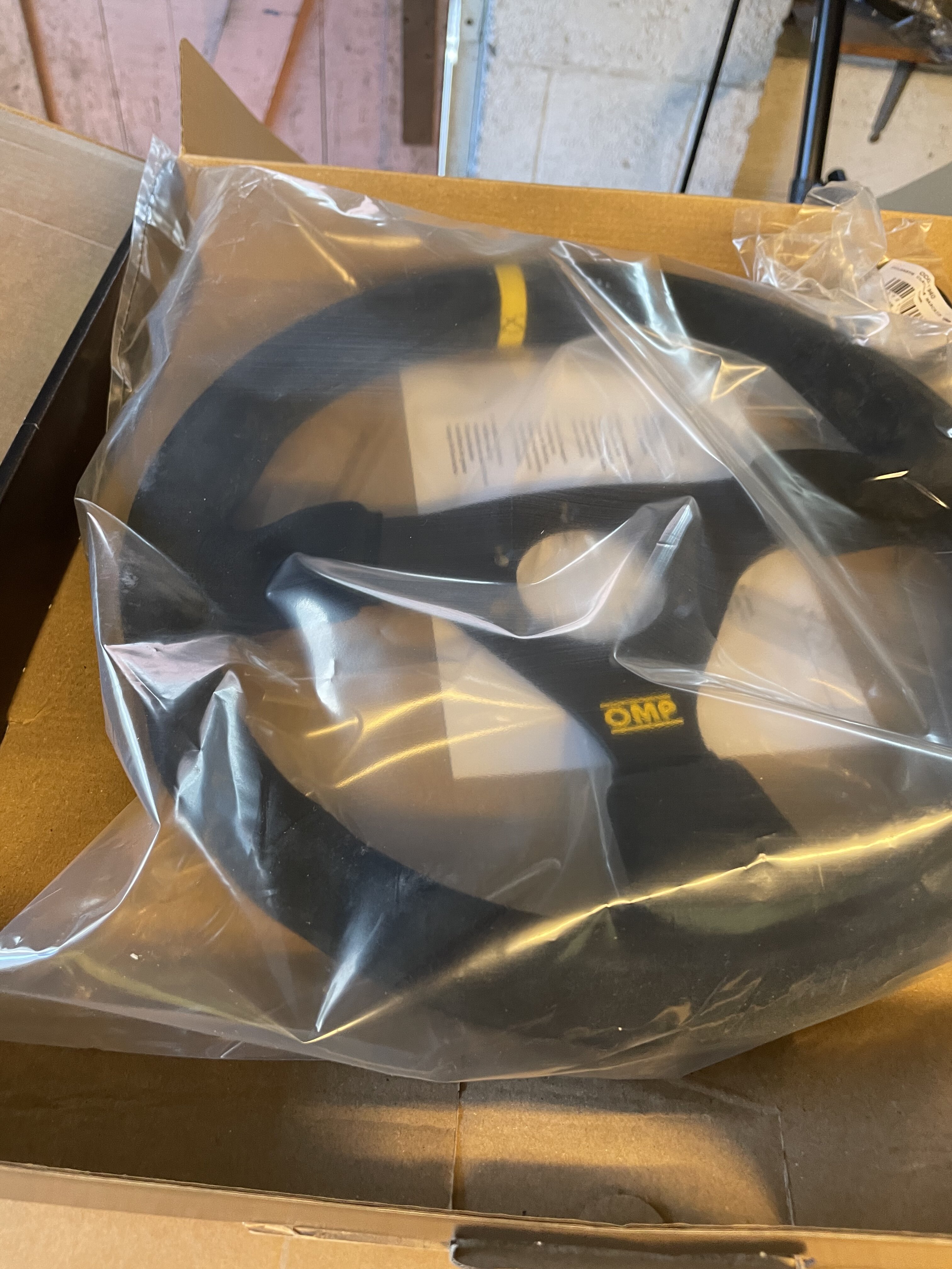

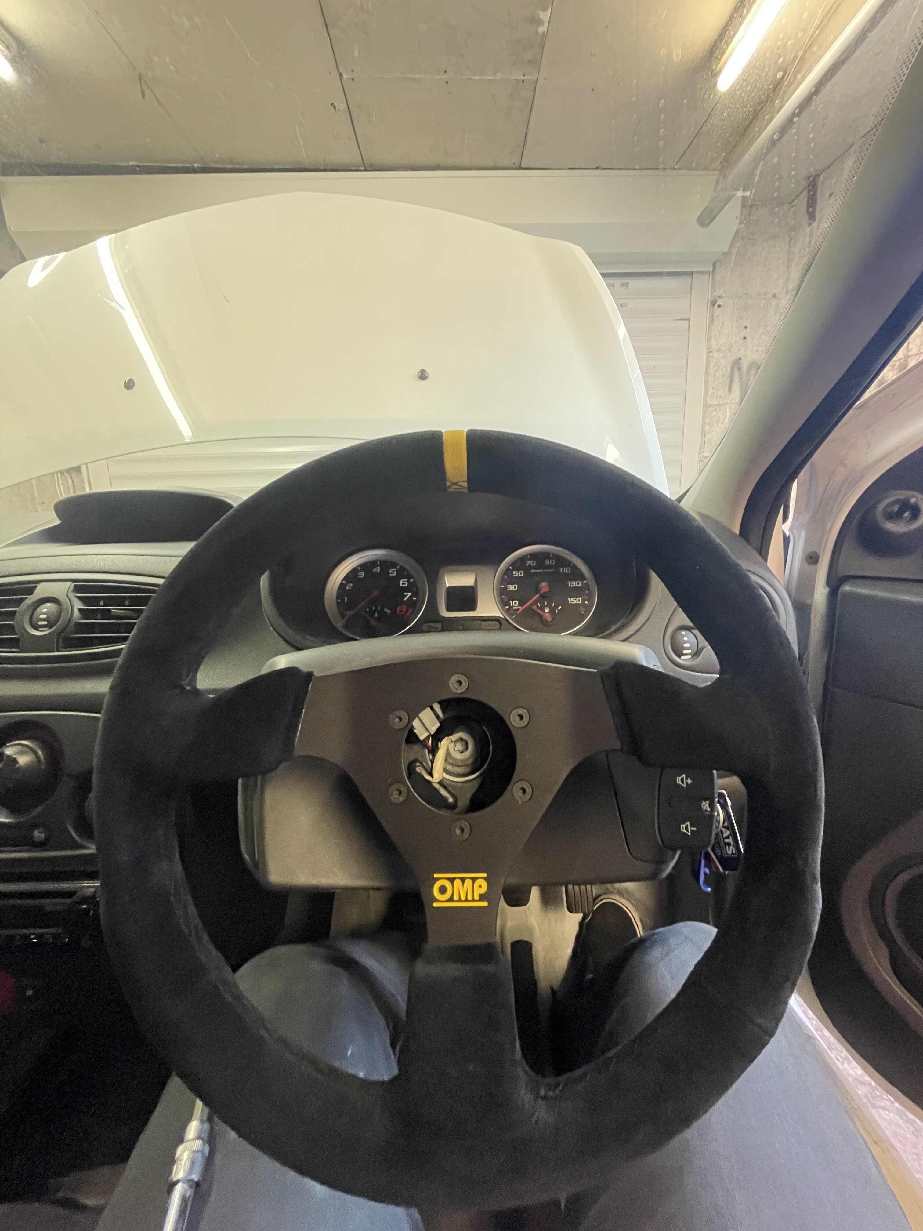

First job was a new OMP wheel for me.
Fairly straight forward job to do that I think most active members of the forum have done so won’t bother with a write up fully of doing the swap but will say putting the standard wheel through 180 degrees so the air bag release mech is facing upwards makes the job far easier.
That’s the wheel fitted. Need to tidy up the wiring and sort the horn but very happy. After a little test drive it feels miles better than the dinging of the standard wheel.

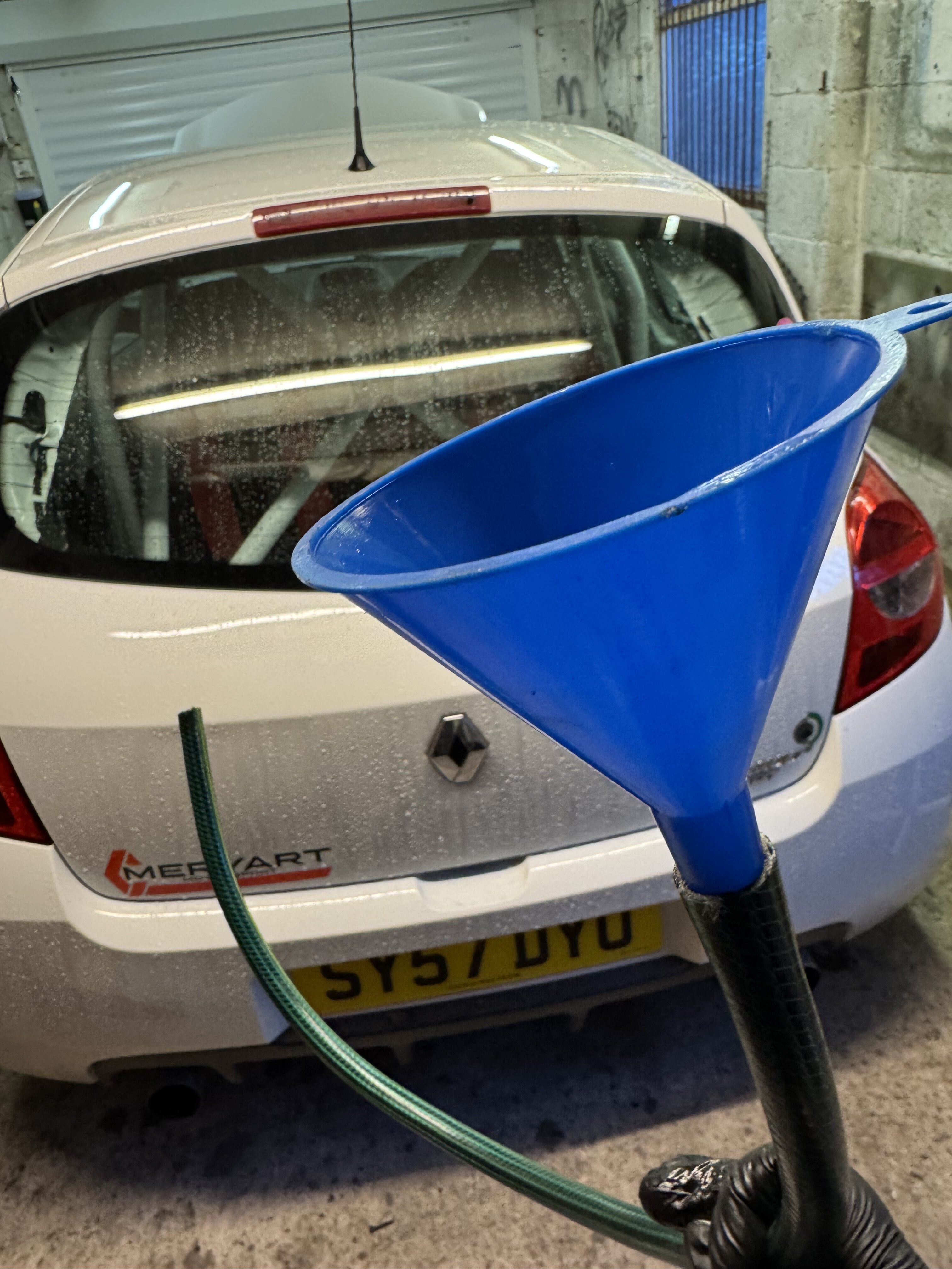

We also serviced both cars inclusive of gearbox oil changes!
Here’s the patented (bodged) gear box oil filler we came up with!
