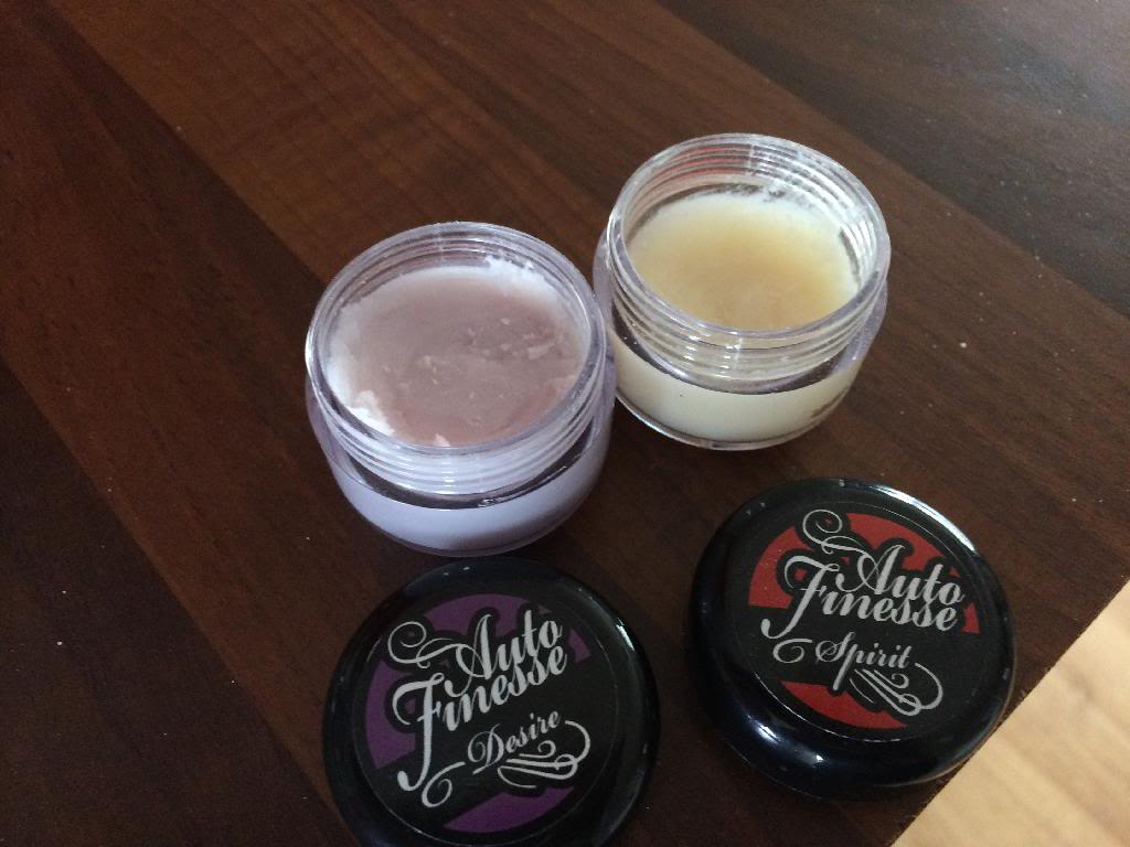

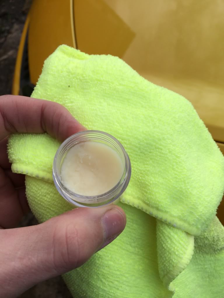

A sample pot is enough to do a 197 quite a few times, I'll get a pic.
spirit is a nice wax, desire is brilliantly glossy but I really want to try illusion.

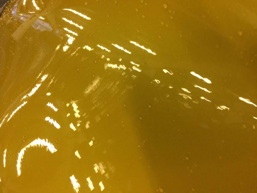

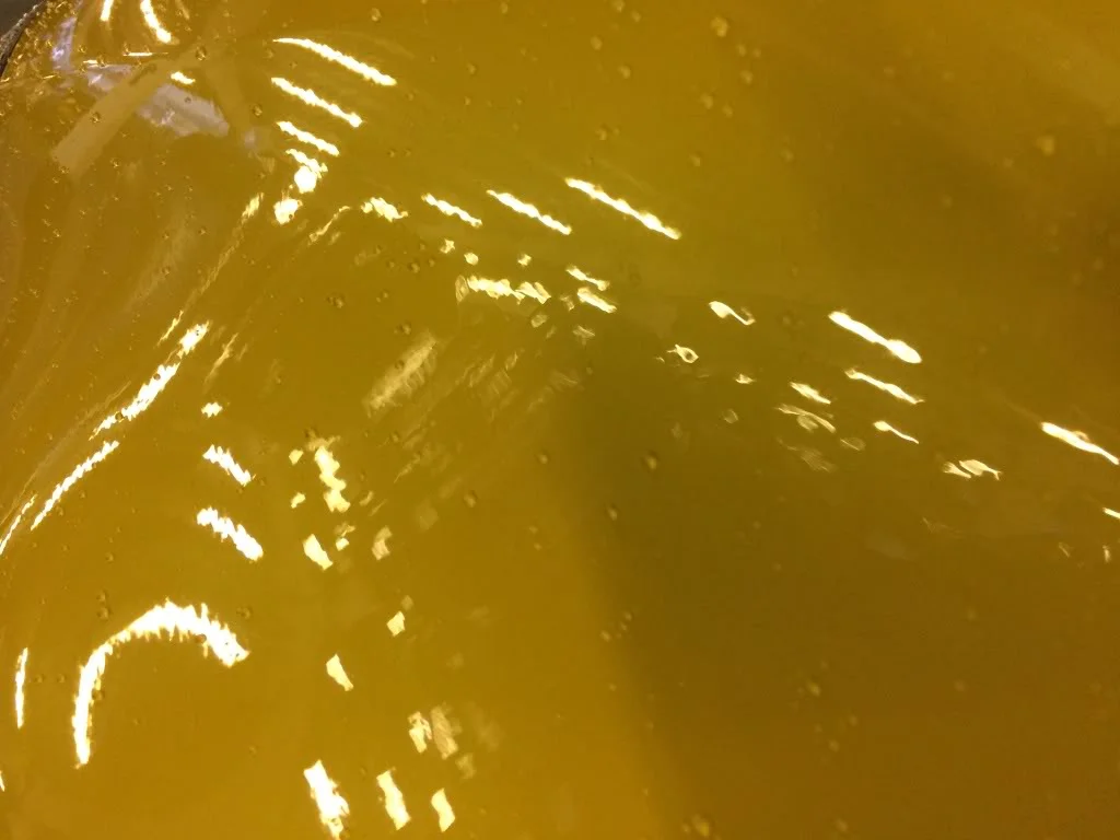

spirit after 3 layers
Desire after 1 layer

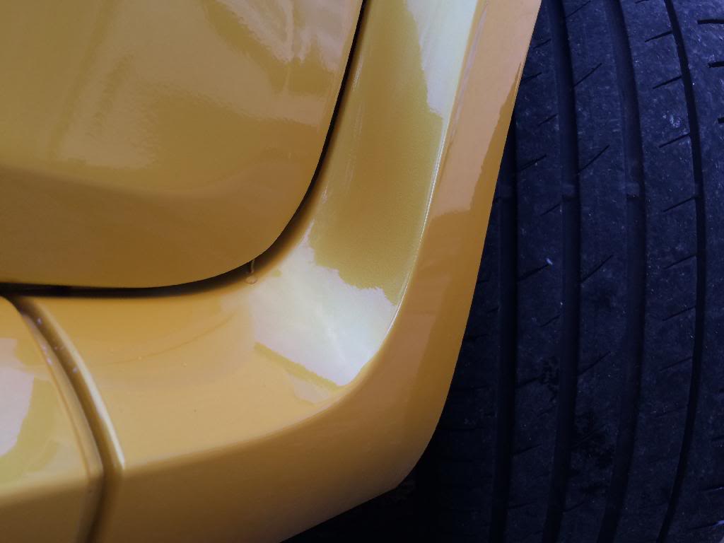

spirit on the arch
Desire on the arch, shows off liquid yellow beautifully
spirit on the arch

The sample pots will easily do two layers on a medium sized car so gives you a good idea on the wax.
