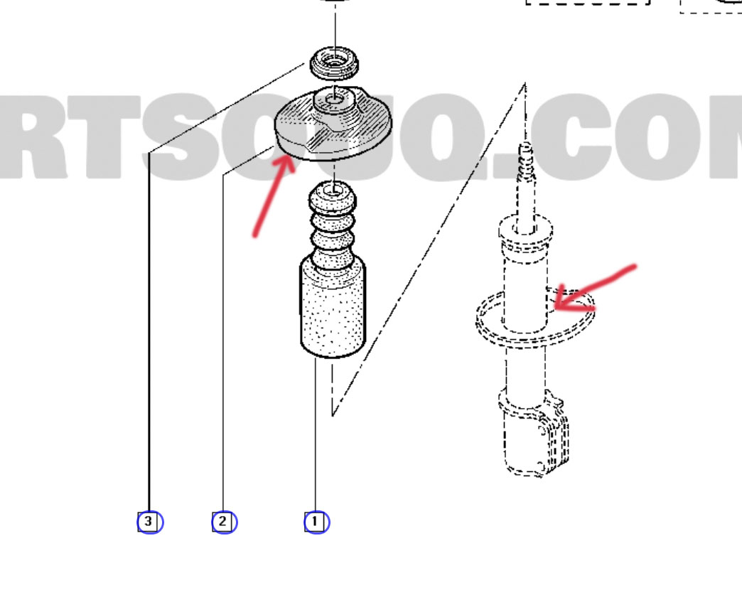

They usually come with the spring - see a picture of something similar. The factory springs had a clear piece of sleeve fitted both ends of the coil.
I have the Eibach Pro_kit springs on mine and they don't have them as standard, so i bought some plastic sleeves off eBay. Just to stop the end of the coil rubbing against the metal seats at the base of the damper.
Might not be that, but it's possible. And yes, it's a case of removing the damper from the hub and taking the spring off. Try spraying some WD-40 or GT 85 in between the spring and damper first. See if that cures it. If it does, invest in some of those sleeves.

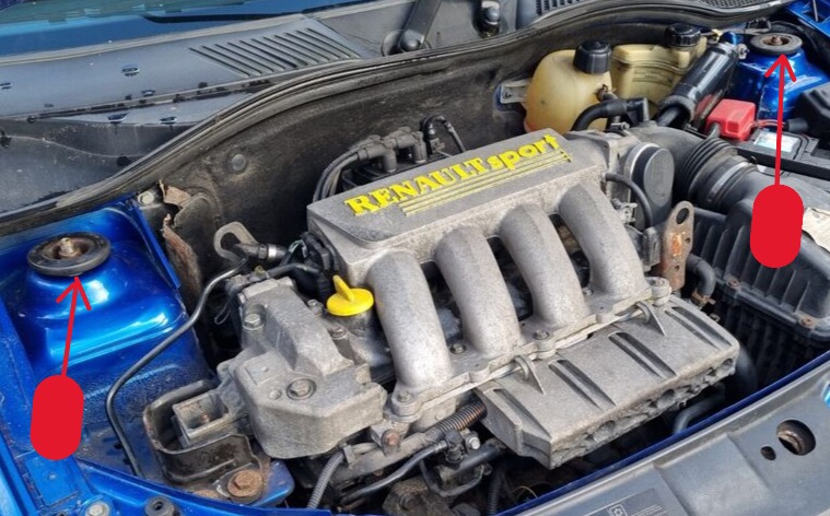

The WD40 didn't last too long until the noise returned, so a few weeks ago I squirted some bike chain lube in the space between the top mounts and the turrets. It made a huge difference but as expected it ran down over my springs. During the past week, as the weather has been dry, the noise has got a lot worse, probably as the lube has run away. There doesn't seem to be anything to hold any form of lubrication in place. Today I tried something different. I have some dielectric grease (bought to solve another issue would you believe!) and I've used a small brush to get some into the gap (as per pic) between the top mount and turret. It made a massive difference and should last longer but I can sometimes hear the noise still. I'm convinced it's being caused by the rubber on the turret but I've not read anything of this kind of issue on CS before. And just to add to the mystery sometimes it sounds as if the squeak is coming from inside my door!! It's utter madness!!
