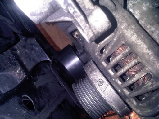

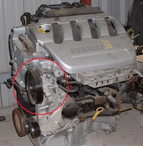

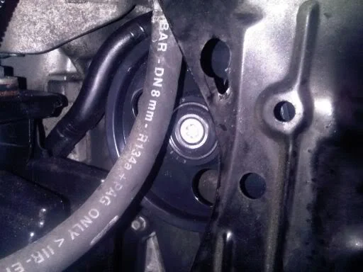

Its become pretty apparent that the upper auxiliary belt idler pulley's bearing has retired itself from service, and is consequently sounding horrid. Its a K4J 1.4 16v engine.
Could anyone possibly shed some light with regards to a part number, recognised description, or somewhere I can get hold of the pulley & bearing assembly or the bearing itself as I have trawled the net to no avail, ill call ECP first thing in the morning see if they can do anything.

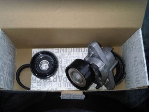

What a load of rubbish! Who ever is telling you that is full of shite as I've just purchased another x5 "Aux. Service Kits" as pictured below to go in to my stock this weekend from my local Renault dept and they currently retail at £41.34 + vat each for the K4M/K4J with A/C! The part number above, 8200641468, is I believe for the tensioner unit only which retails at around £82 + vat which is the expensive way to do it!
As fate would have it I happen to have an old "service kit" next to my desk as I changed it yesterday for a customer on their Scenic 1.6 16v and it's about to find its way in to the bin so here it is... look familiar?
Part No: 7701 477 527
I can believe that some smaller dealerships may have to order them in which may take a day unless its VOR'd but a decent dealership will usually have them on shelf in the dozens as its a common, current service part for the Clio II, Clio III, Scenic II and even some Laguna II vehicles.
Mick

This is what I found that when asking around that the tensioner alone was twice the price of the full kit that contained the same part! I had the Aux Belt kit fitted by a guy about 15K miles ago as I didnt have time to do it myself before going away, and the belt, lower idler and tensioner where all replaced. Cheers for the photo above your right that is the tensioner, and its opposed idler which as far as I can hear through a screwdriver are fine. The bearing / pulley & bearing I need for my engine isn't covered by the Aux Belt kits as the pulley shown in my first photo is actually there to serve as an idler when there isn't a hydraulic power steering pump fitted, as mine is electric on the steering column (I believe?)

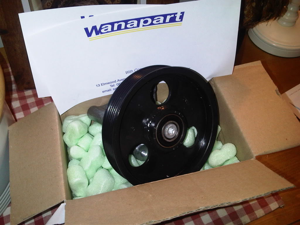

In the end I spoke to a great bloke at Wanapart and he went out of his way to try and sort me out and have ended up with it arriving around tuesday for £80 delivered, so im happy.

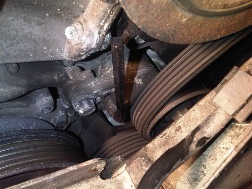

Aux belt kit

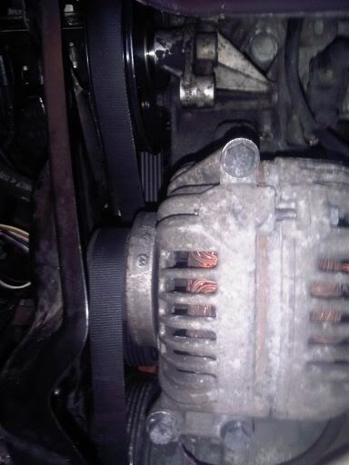

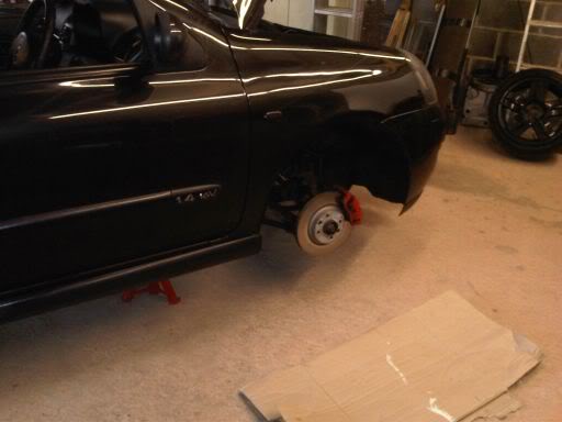

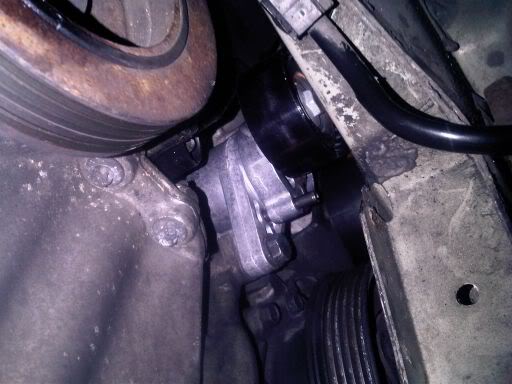

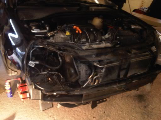

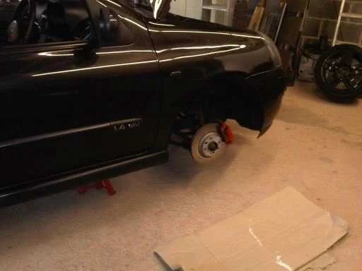

Wheel and arch liner removed to get at the pulley area

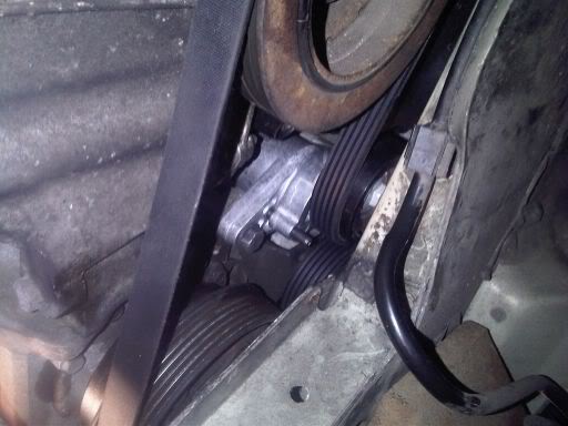

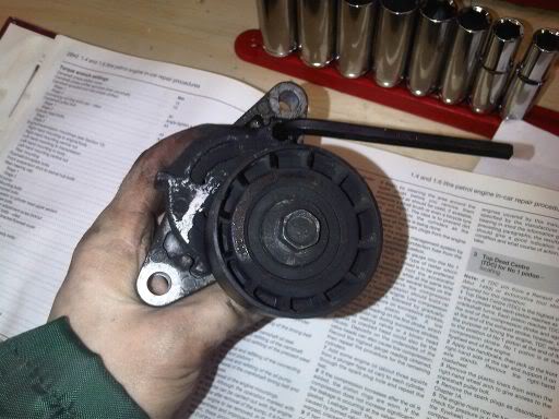

Old tensioner relieved by turning it clockwise with a 13mm ring spanner then locking it "open" with a 6mm Allen key

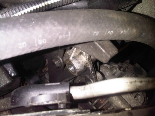

Couldn't see any other way to get to the upper tensioner bracket bolt and idler without getting the bumper and RH headlight out, the Haynes manual only covers the removal / renewal of the belt.

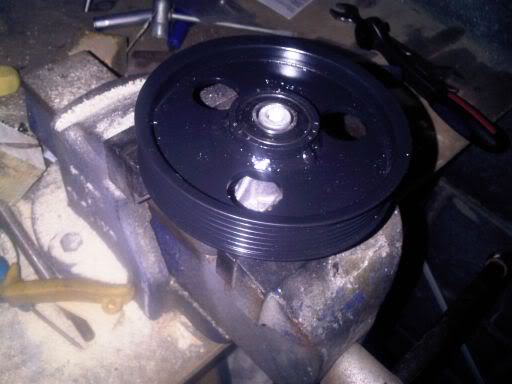

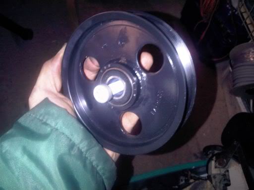

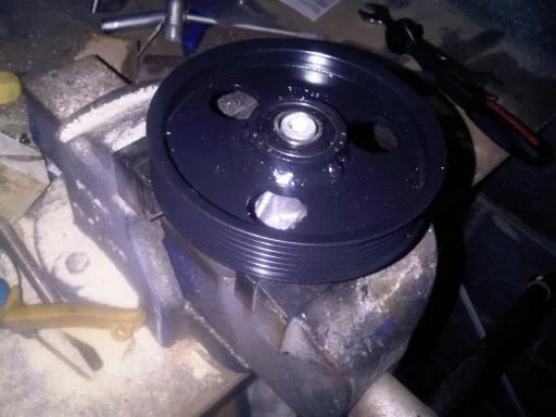

Removed the upper idler as id got a new one to fit
Old tensioner removed, the bearing would spin on for a few seconds and hiss and crunch, the new bearing as mentioned above in the thread is quite 'stiff' and silent.. ha

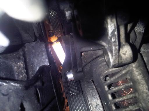

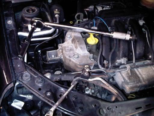

Idler removed, this was a pain, had to loosen the RH engine mounting and lift the engine by 3" or so to be able to get a spanner on properly and then actually get the bolt and the idler out as the shell is so close
New idler fitted
With the idler fitted the engine could be lowered back down and the four mount to shell bolts were degreased, wire bushed and the mount area cleaned of all penetrating fluid used to get them out. Then torqued to 62 Nm and then same procedure for the upper nut but torqued that to 44 Nm

The upper idler comes with a bracket on the back which i didn't need as its already in place, and to swap these would mean taking off the fuel rail amongst other things to get some bolts out, as there was nothing wrong with the old bracket I left it and removed the pulley from the new assembly
Upper idler fitted

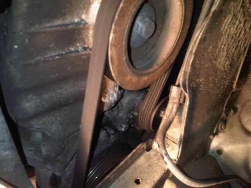

New belt fitted, (tensioner locking pin not yet removed)
Fresh new aux belt scene

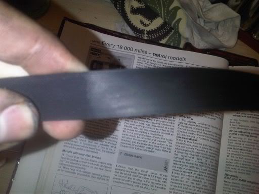

The old belt had been damaged where i think the tensioner and momentarily seized and the belt slipped over it, the flat is about 3" long and is deep enough to feel with finger tips
