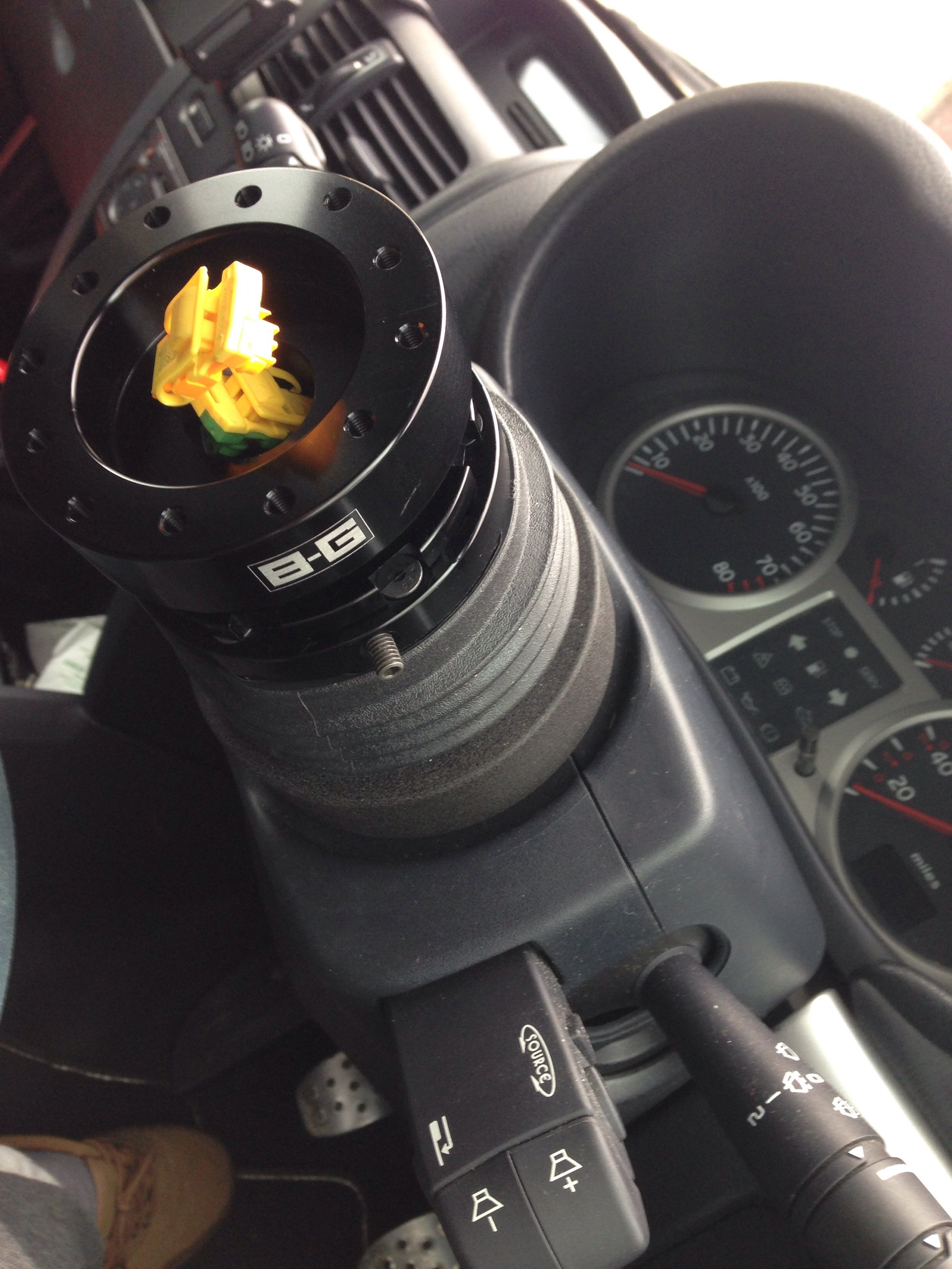

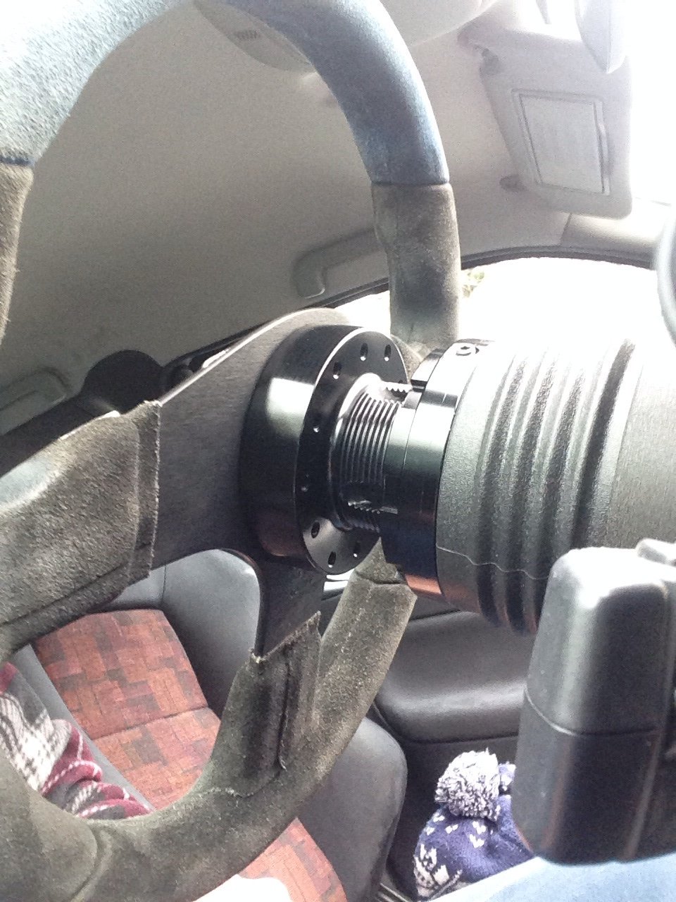

Search 'burpspeed linkage mod. It'll fix the position of the gearstick. I have fitted a sabelt wheel and additional spacer to bring the wheel forward and am going to have the subframes for my Recaro's modded to lower the seat position.
Then it'll be perfect lol.
The linkage mod brings the neutral position back, so where 4th is on a normal 182 is where my neutral is. (You can amend the lenght to suit exactly where you want the shifter to sit.)
Oh and I have fitted the shifter from a megane scenic which is longer with a yanoo kit to make the changes more positive and less like stirring porridge!!!
Cost: linkage £0
Shifter from a scenic with yanoo kit £70
Wheel: £110 2nd hand
BG adjustable spacer £55
Momo boss £55
