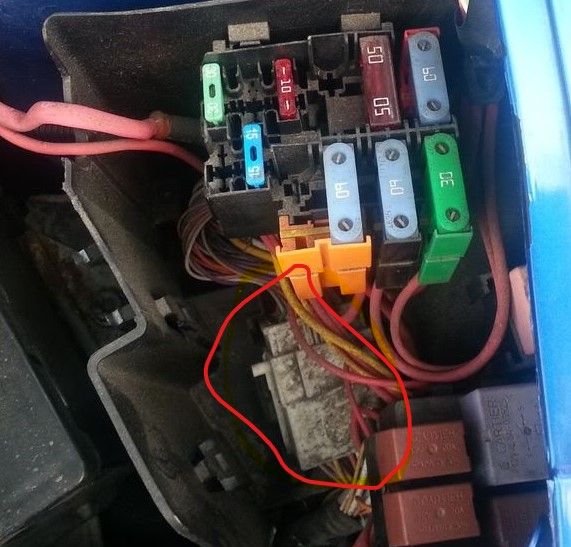

Starts and drives fine. Occasionally the warning light (Square with zigzag) below the low fuel light comes on and it drops to tickover only and will not rev – takes no notice of throttle pedal position. Restart it and it is fixed. Reading posts, it could be the sensor in the throttle pedal, but this is a recent (20k ago) new genuine unit from a Renault dealer I am discounting this for now. Next most likely issue is the big white electrical connector in the engine bay next to the fuses with the suggestion of pull it apart and clean it and this often fixes matters. So, I looked at this but cannot work out how to pull it apart as it seems firmly attached to the black plastic underneath and don’t want to use just brute force due to maybe casing more issues as the wires are tight. So, what is the knack for getting this big white connector off the black plastic base that it is attached to? Thanks Paul

I had the same issue getting the connector apart, there's not much slack on the wires, but you can wriggle it out of the plastic it sits in. Once out you will need to use quite a bit of force to get it apart. Helps if you unhook the fuse block above (don't break the clips) to give you some more room.
Think I used WD40 to loosen the connector up a bit actually, no idea if that's the right thing to do, but it worked for me.

I had to look at it with a head torch on as its dark and dusty around the white connector (WC) so difficult to see why it does not just pull out. On the engine side of the WC is a lip in the black plastic backing and this needs gently prising away from the WC and then you can gently wiggle it out being careful not to pull on the wiring as it is tight. Not much room to just try and pull the WC apart by hand, so you need to use a c.15 mm wide edge inserted between the raised lips on either side of the WC and twist it at alternate ends of the WC and gently prise apart. I used a hard plastic car interior type tool as using a large metal screwdriver may crack the WC. Cleaned with electrical cleaner and reassembled. It does make a click when fully pushed together. Only driving it will see if this has fixed it. As this WC seems mentioned in many posts, probably a preventative maintenance activity to pull apart and clean.
