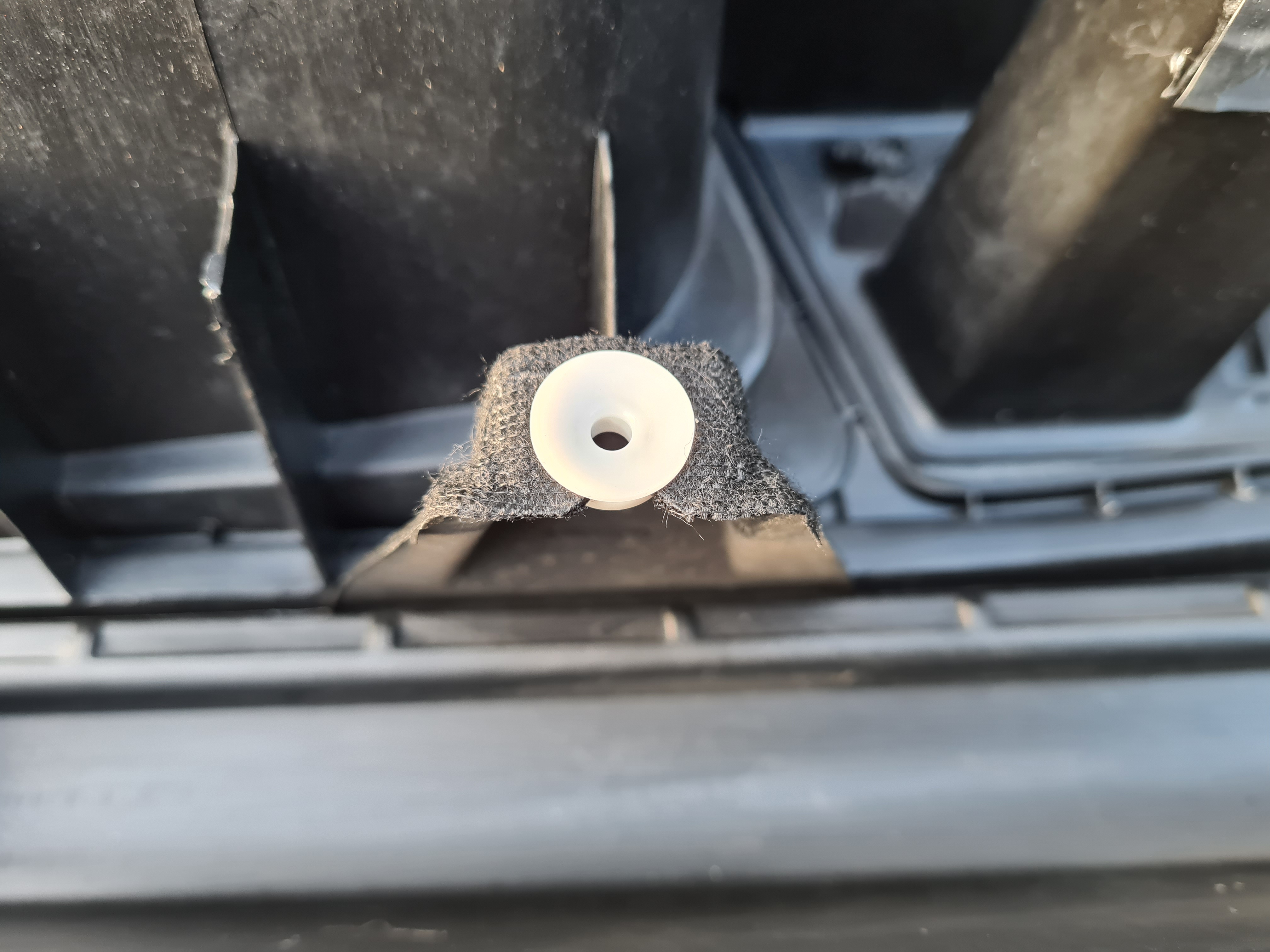

Hi Folks. I have a few of these pop clips which have broken. They hold the interior B Pillar trim on.

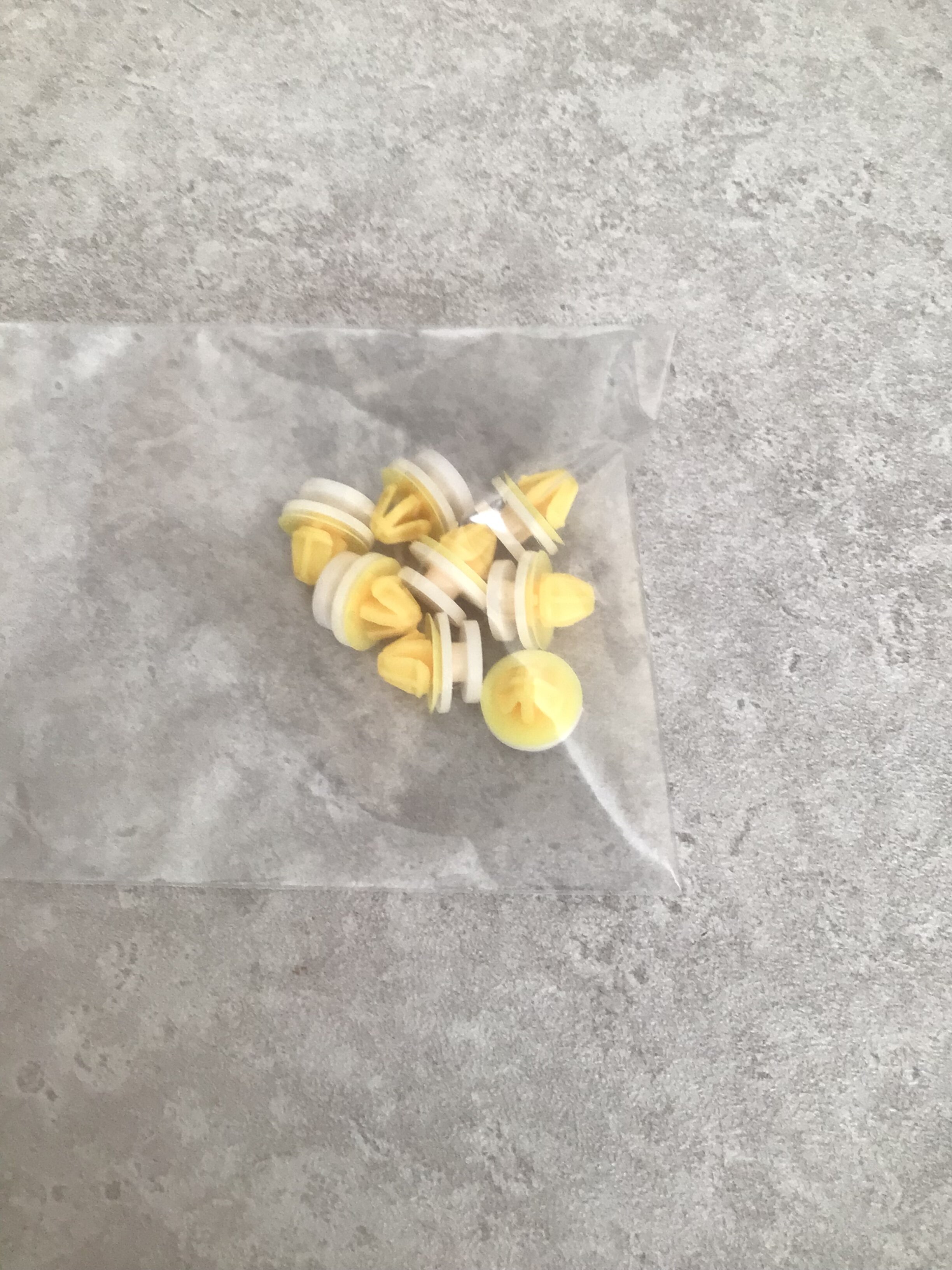

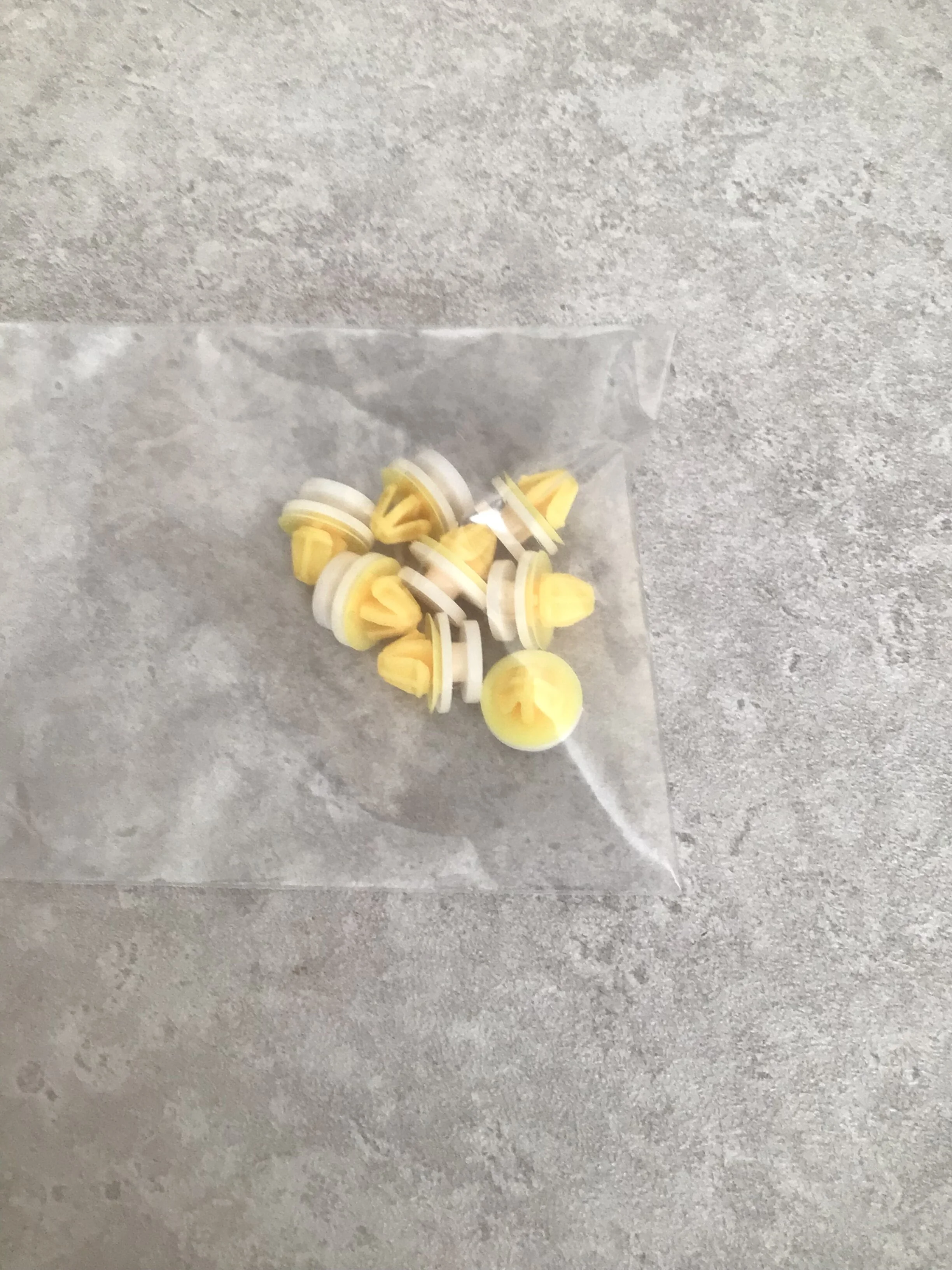

Clips arrived today and I’m slightly stumped.

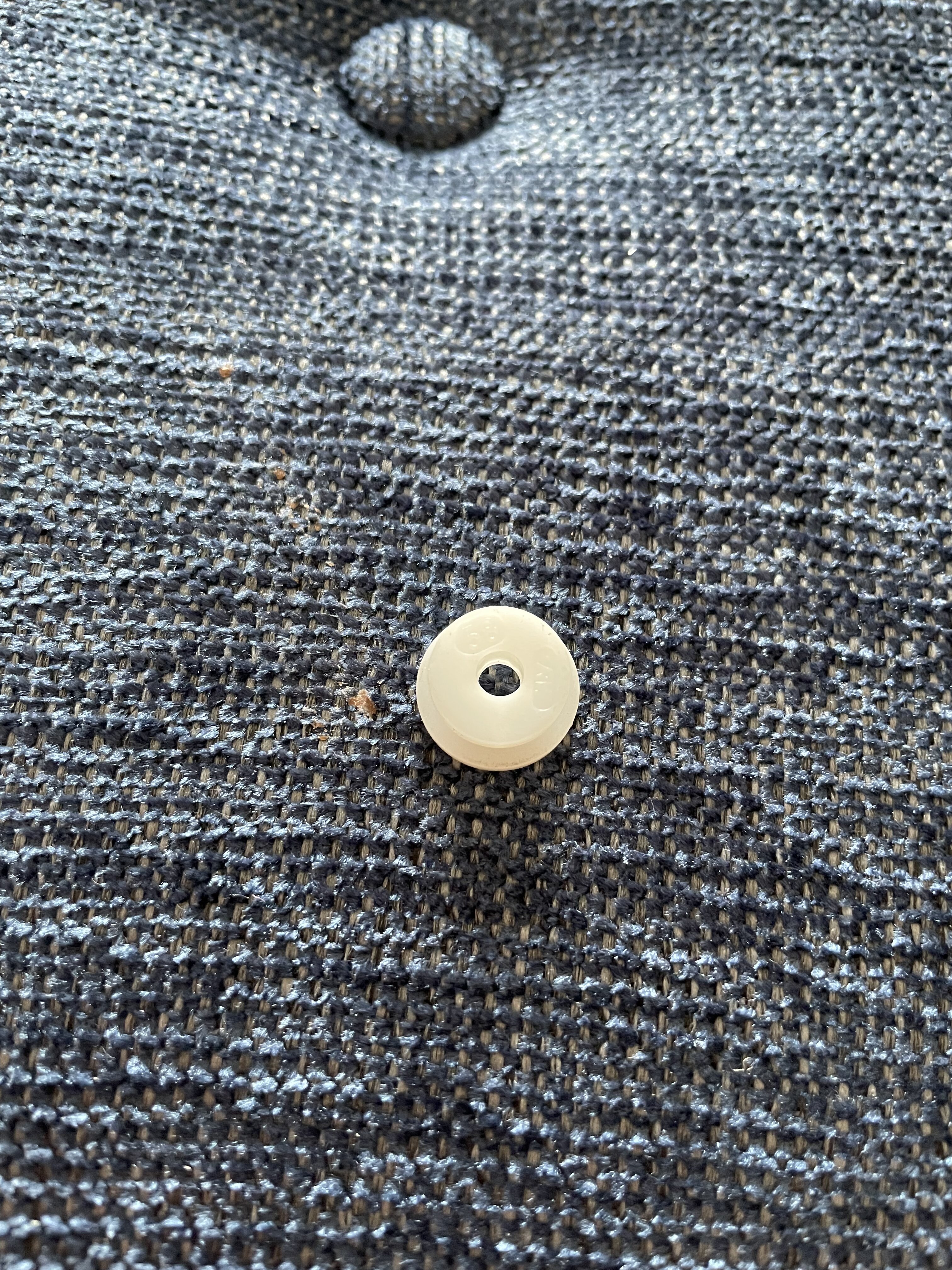

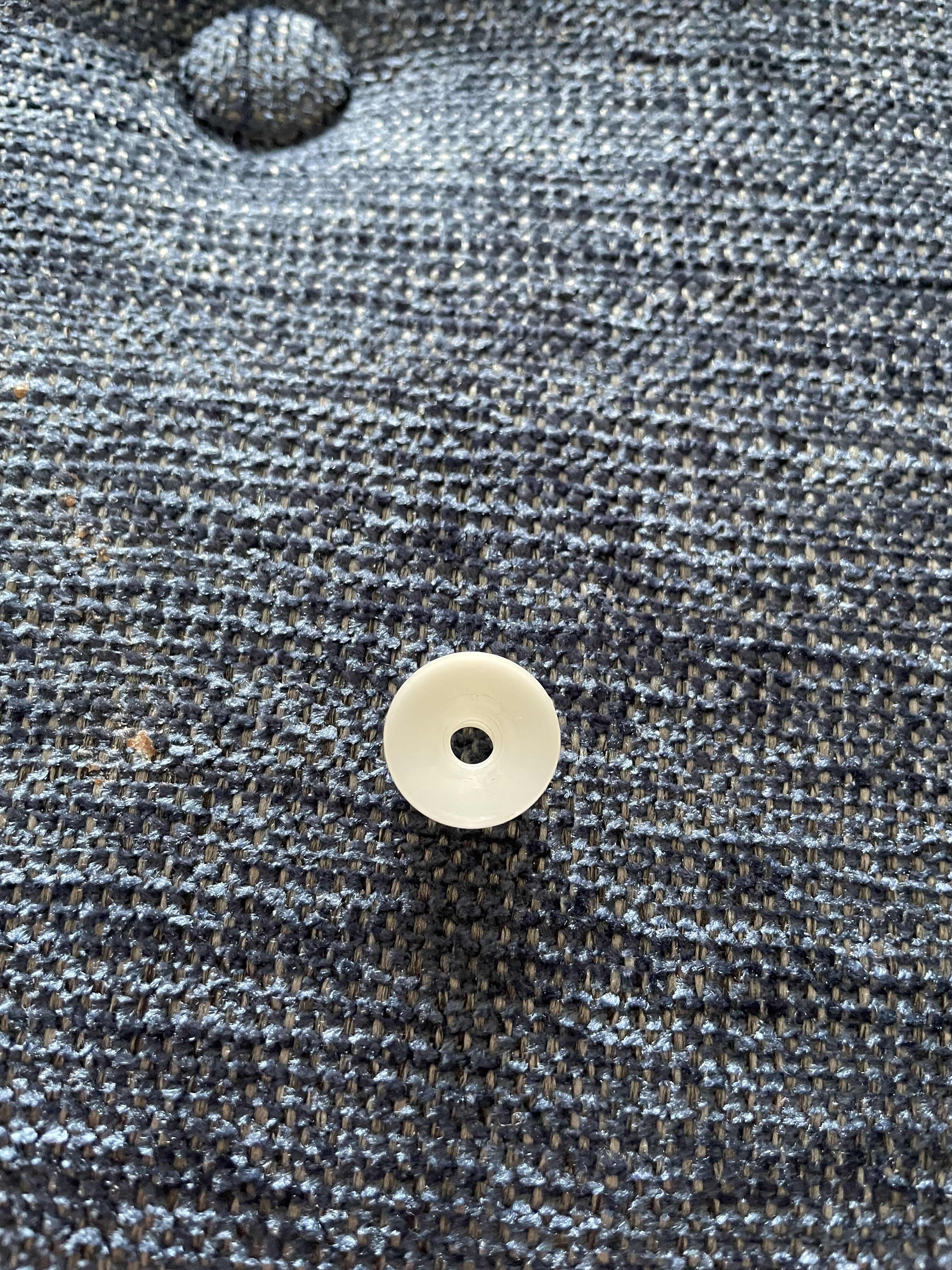

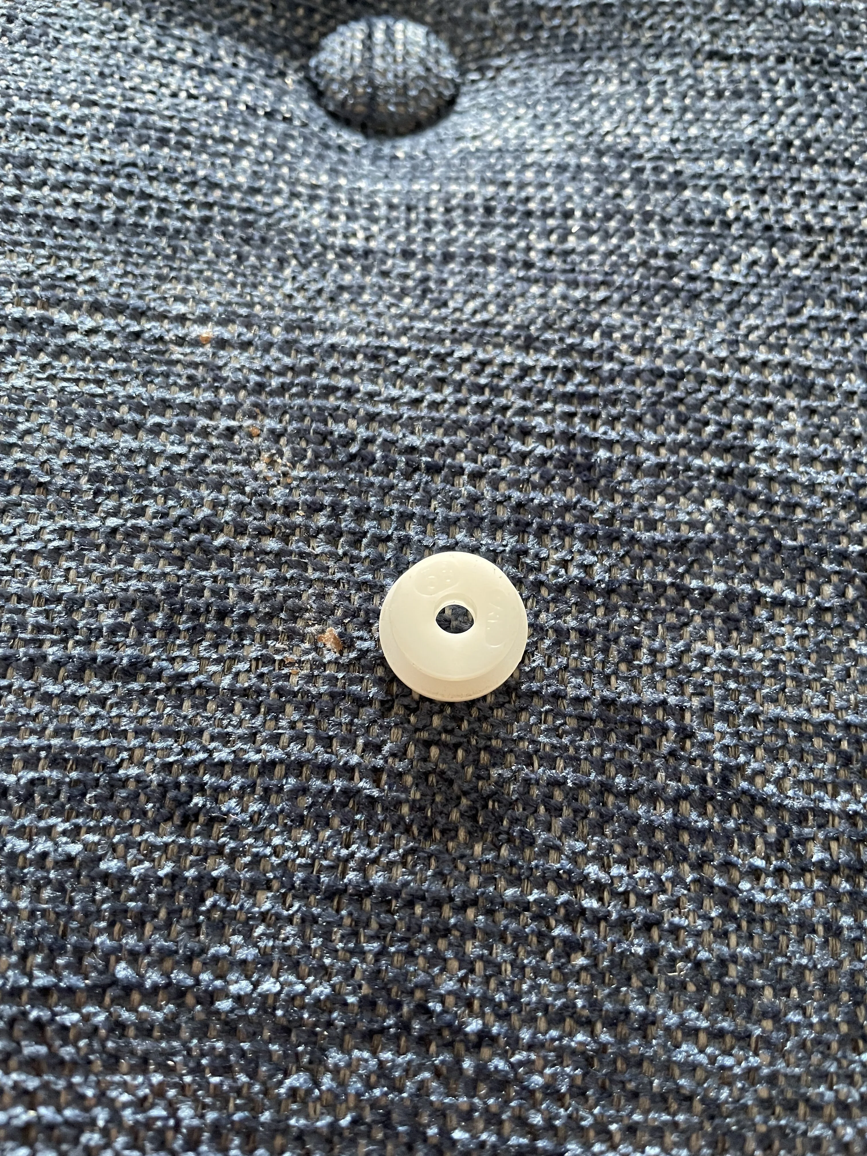

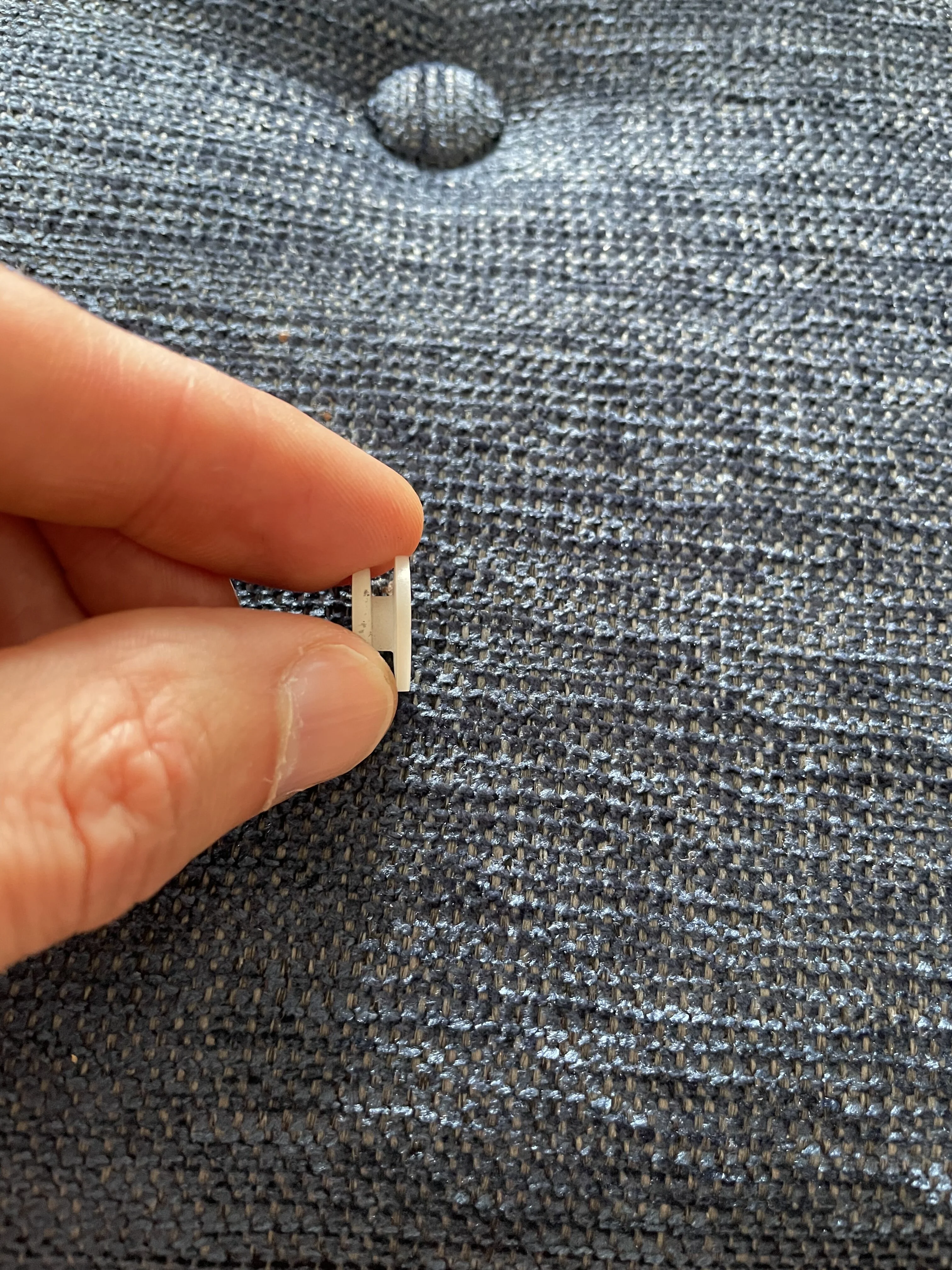

Does anyone know how I can separate the yellow bit from the white bit ?

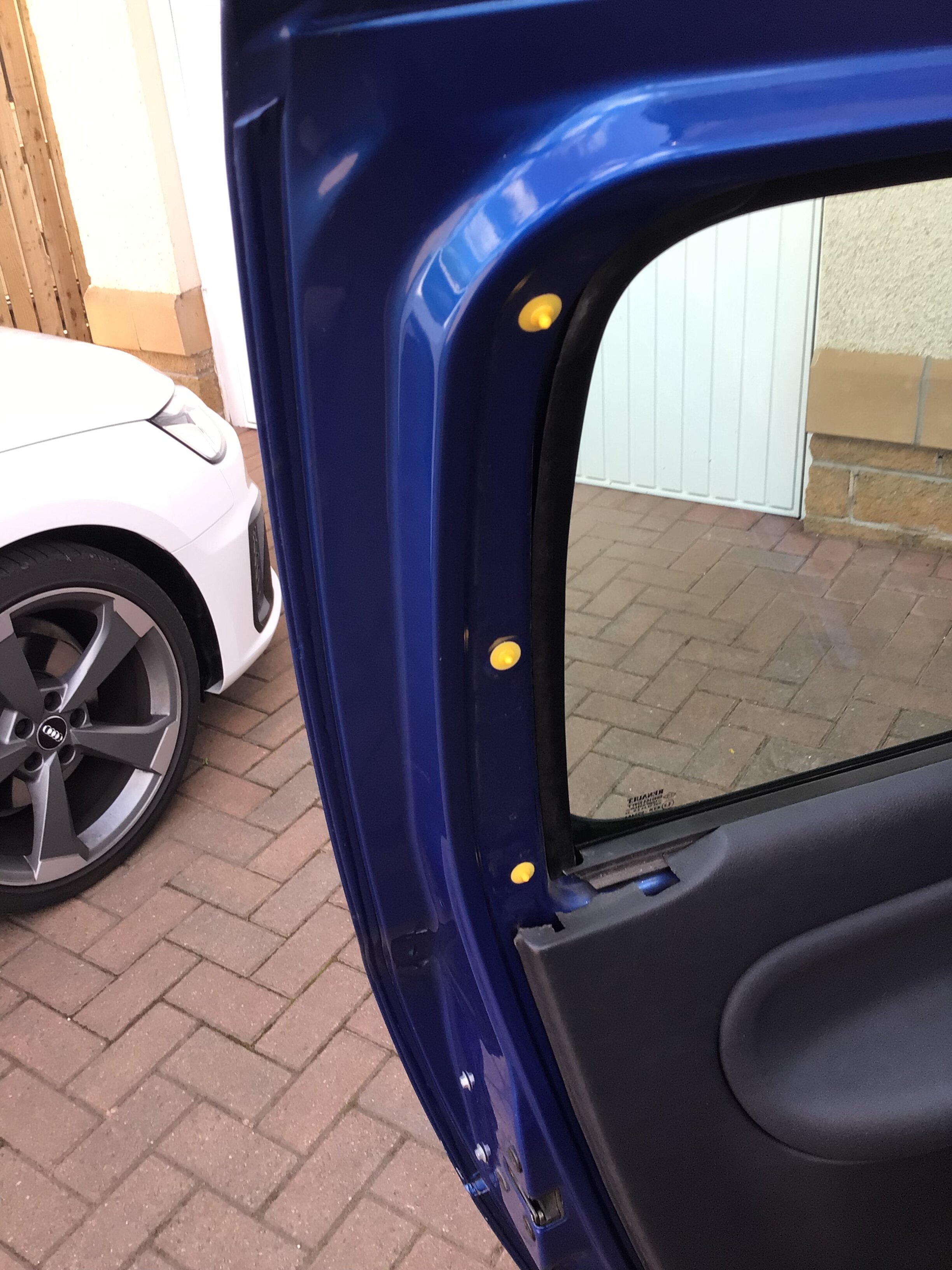

Or an easy way to remove the yellow clips from the door ?
I wedged a trim removal tool with two prongs between the two parts and it popped open. A fork might work as well.
You won't easily get the yellow parts out of the door.
