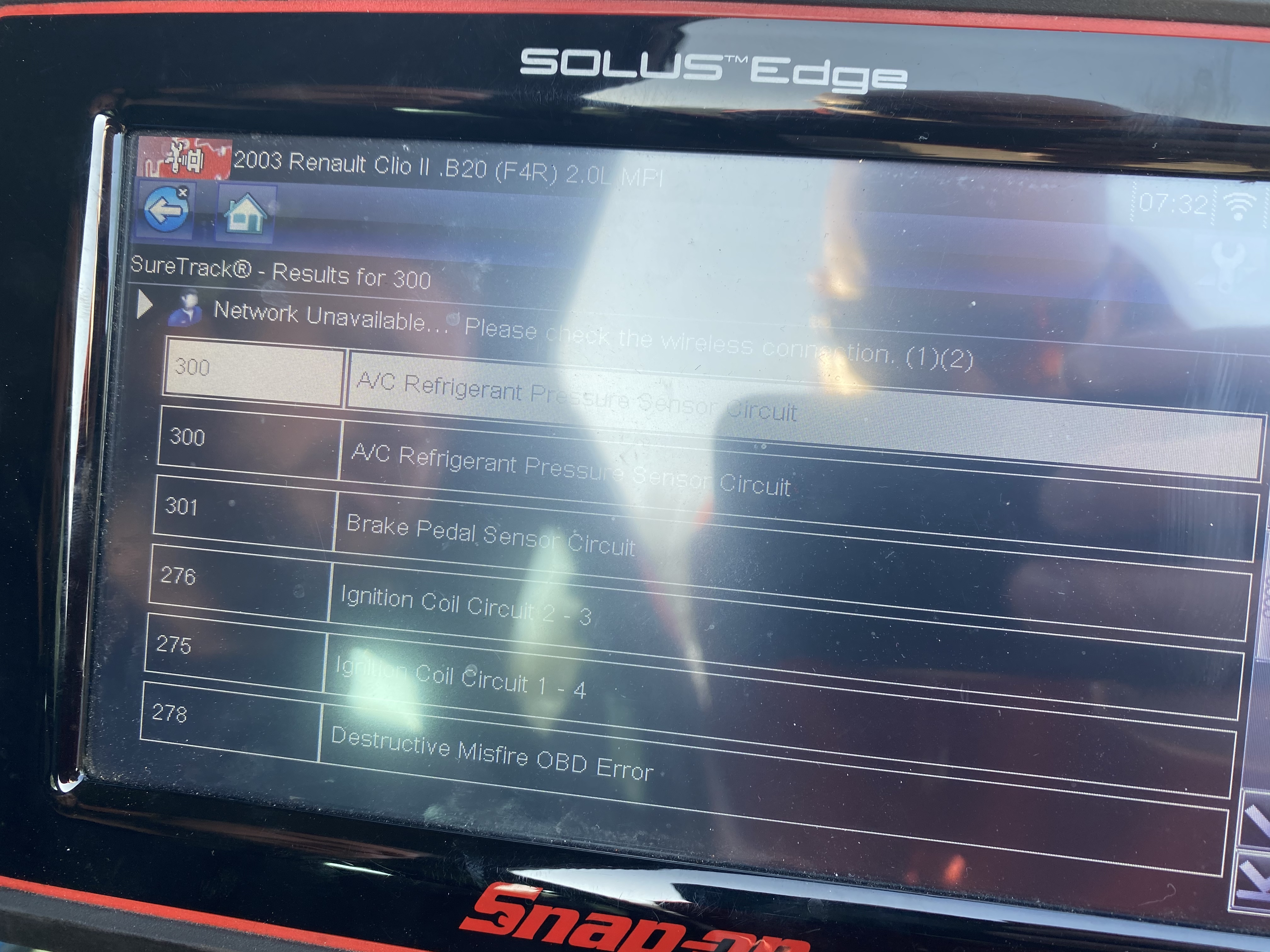

Just had the car scanned and this was the result. Coil pack was new from RPD a few months ago.

Did you have historical codes removed previously? I plugged mine into my RS tuner for the first time last week and had several old stored codes, which I removed. Best to clear then recheck in my experience
Yep. Cleared and then restarted and no codes at all 🤦‍♀️

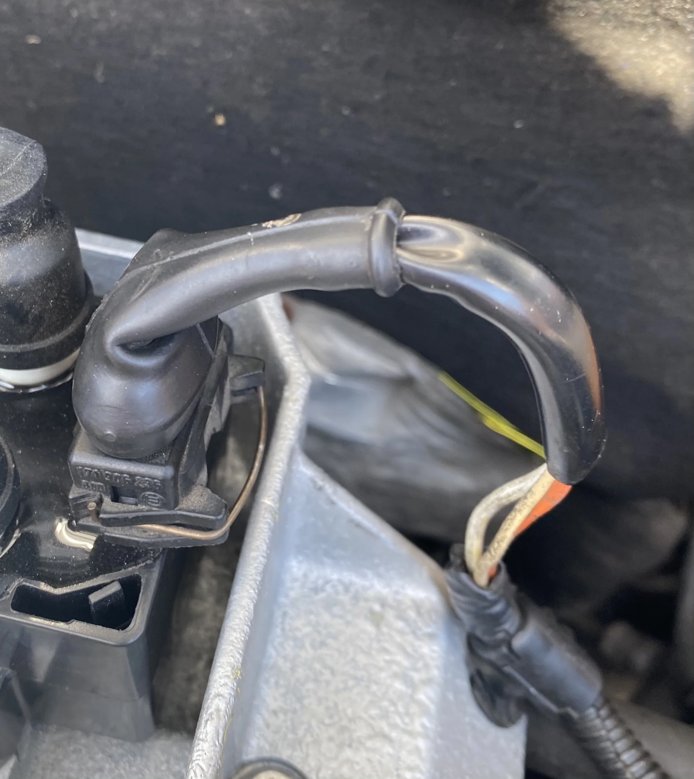

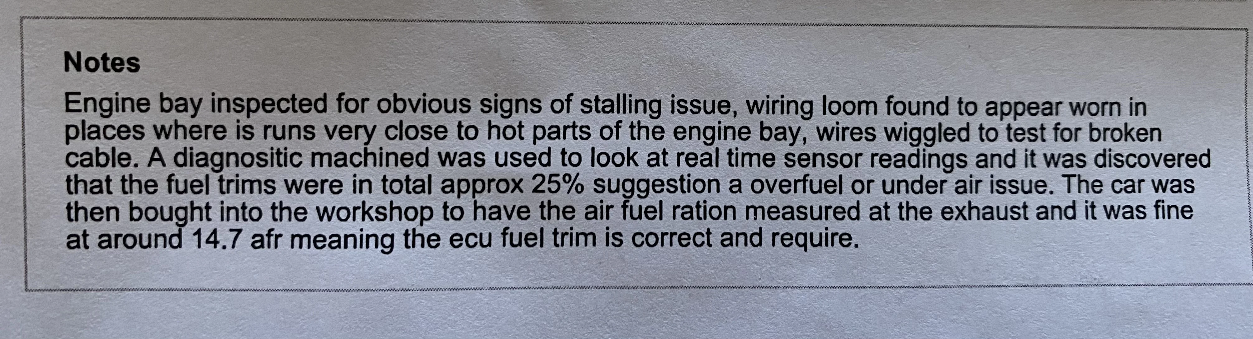

Results from the diagnostic today. They recommended cleaning the VVT solenoid and checking timing. Screenshot of their findings below.
I popped into my local garage (who ran the basic diagnostic Monday) as I had to catch up with the owner on another matter and he asked if he could have a quick look. Within a minute he’d found that when wiggling the plug into the coilpack as pictured the car cut out immediately. He pulled back the cover and the centre wire appears secure but wiggling causes an immediate cutout, wiggle again and she fired up so that’s our starting point. I’m going to find a replacement plug and we’ll see if this cures anything.
Dyno centre feel that lambda sensors are fine as they gave readings. They suggested electrical could be an issue too.

If anyone has that plug and a foot or so of the wiring from it, please let me know. Ta.

Glad you've hopefully found the cause!
Hope so bud. To be fair I don’t even know where to start with wiring but they picked up on the loom that runs under the throttle body close to the block and that the insulation is a bad crap. Another fix needed.

if the 25% is accurate thats a massive trim value
That’s what they said. They are 99.9% sure the o2 sensors are working too. We’re going to try that plug with the wobbly connection and see what that does but on shorter trips I haven’t had any issues - first time was after driving 70 miles without issues and last time slightly more than that. Bloody odd.
