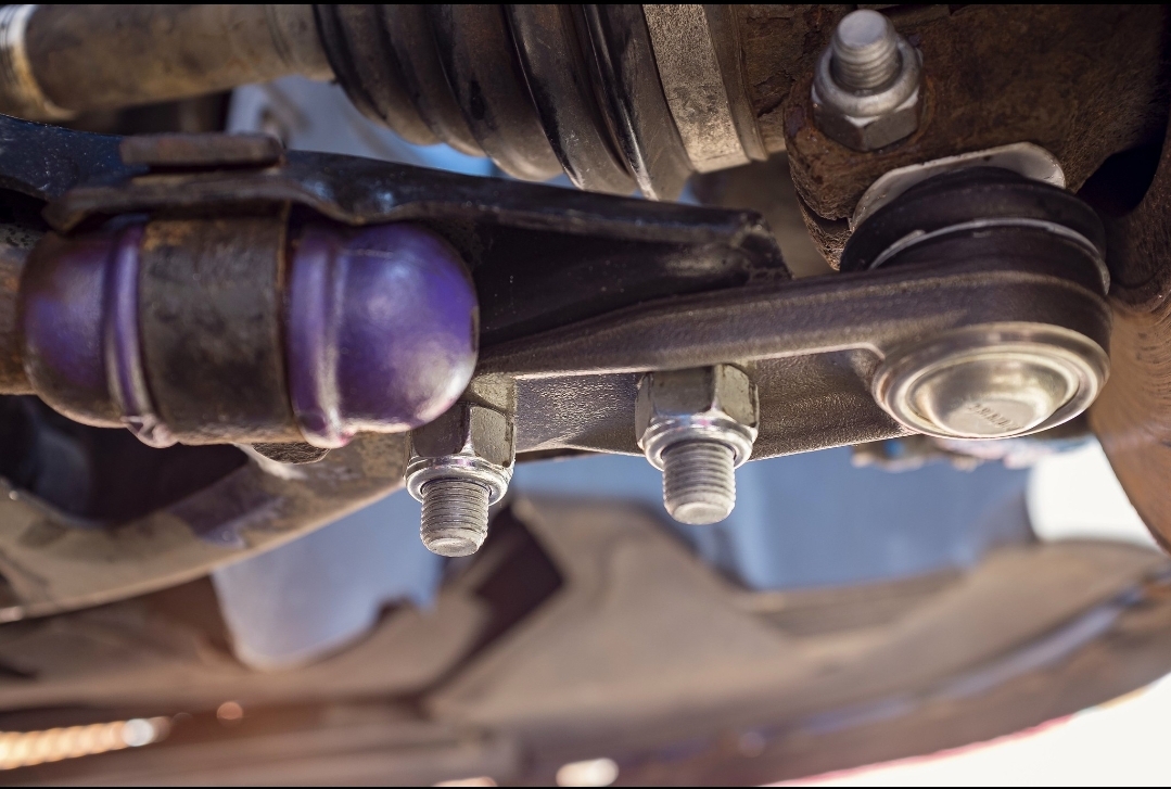

I seem to have a problem where the outer most bolt that secures the balljoint to the wishbones keeps loosening off. The actual balljoint is fine with no abnormal play, the end bolts just require a tweak up now and then.
Reading around a bit on the forums, it seems the original Renault bolts are a finer thread or something to most aftermarket ones available and sometimes it causes this? Its quite probable the bolts have been changed for the new ones in a pack of aftermarket parts in its 16 years of age. Tried to order new from Renault and they're marked NLA.
Does anyone have the specs for these bolts? I know they're M12, guessing around 10.9 tensile? But as far as length and pitch i'm not too sure. I'm hesitant to measure the existing ones as they're causing me problems.
Any other advice regarding them loosening is greatly appreciated
Cheers

Shouldn't be coming loose tbh.
New ones come with Lemforder ball joints.
Bang them on at 62Nm.
It is worrying why they keep coming loose.

Changed a mates ball joints on the weekend and the 2 bolts didn't look anything special in terms of thread.
Just either 8.8 or 10.9 grade M12 bolts with nyloc nuts.

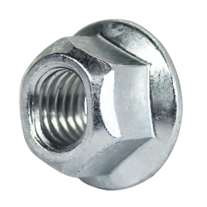

They're not nylocs on there. I don't know the proper name for these type of nuts, I've had them before with car parts though. Best way to explain is they look like they've been squashed ever so slightly oval from new. I guess they 'lock' from always trying to pull back to that oval shape?
I've had them with lemforder etc on previous vehicles before but like I say no idea on the name

Shameless theft from google, but they look like that. It looks like a bad picture because the threaded hole isn't round but that's actually how they are.
Definitely had them with lemforder and the like before, Internet reckons they're 'torque prevailing' style lock nuts 🤷‍♂️
Klumpy Dumpy
Not all gingers stink of piss. But I do.
Ah right okay, built-in washer type. That's just so you don't forget the washer and have it pull into the metal, it's just for pressure spreading across a surface.
Yeah get a dab of Loctite on em and it'll be reet
  406 V6, Race Buggy
No, it's a deformed nut - that's why there's two flats on the thread - the nut actually distorts to give a locking effect, like K-nuts.

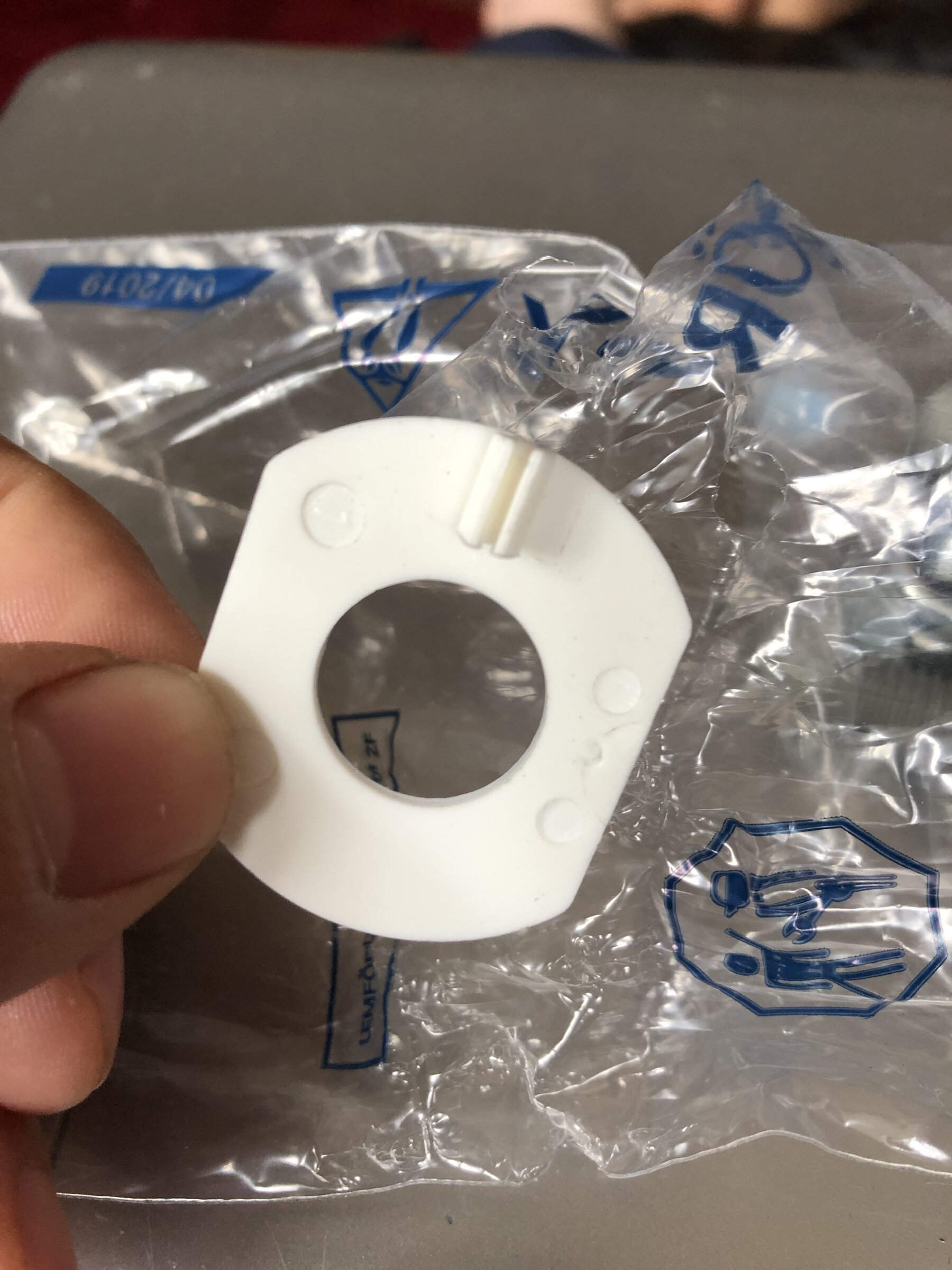

Hi, thought id add to this one rather than start a new one. Just got a pair of Lemforder ball joints to fit from Euros. Comes with the new nuts/bolts/washers etc but also comes with a white plastic template like thing. Can anyone tell me what this bit is for please? Thanks

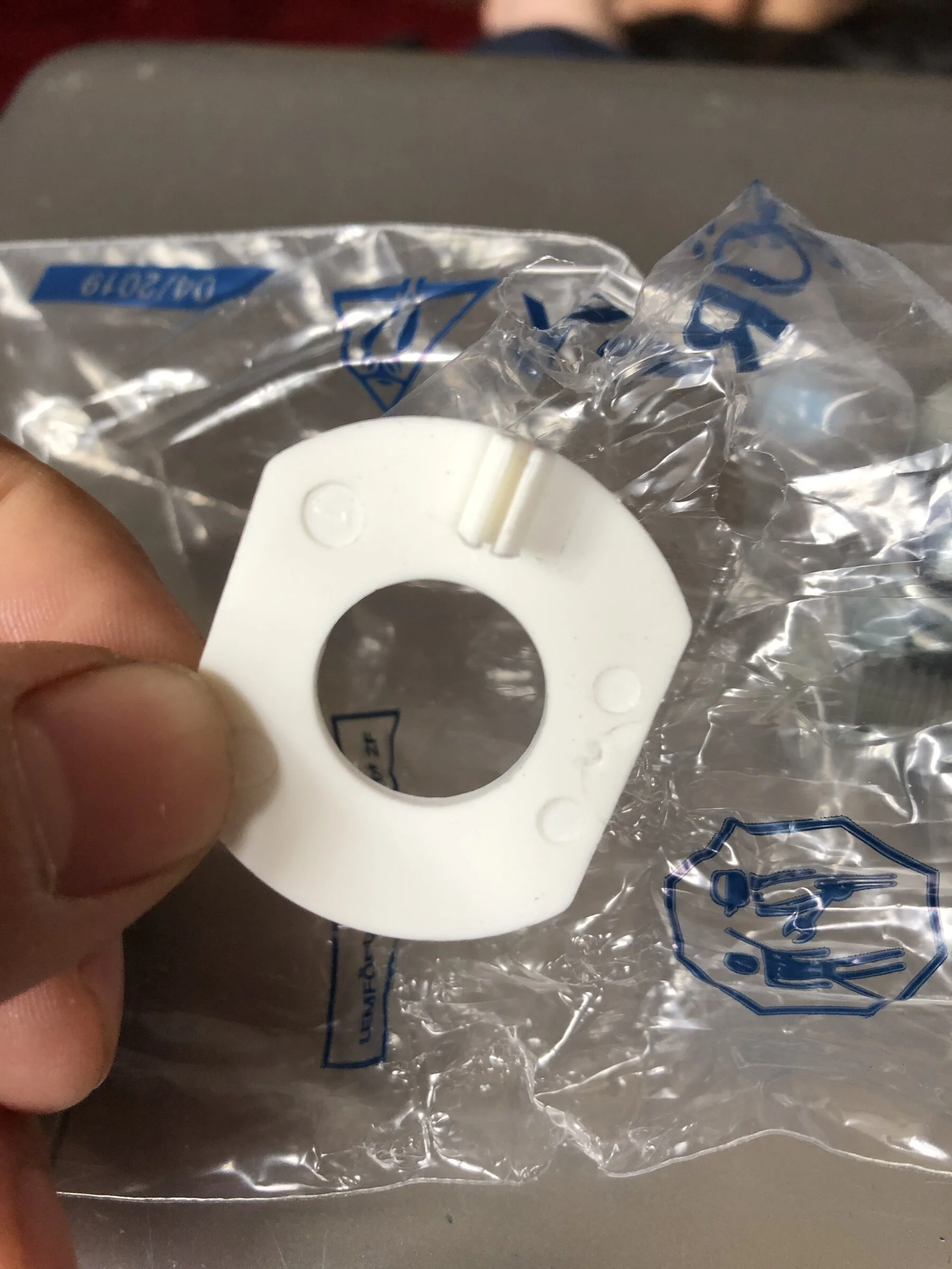

Does anyone know if you can buy these separately? Got new wishbones but they haven't come with any and i didn't have any on my car to start with.
