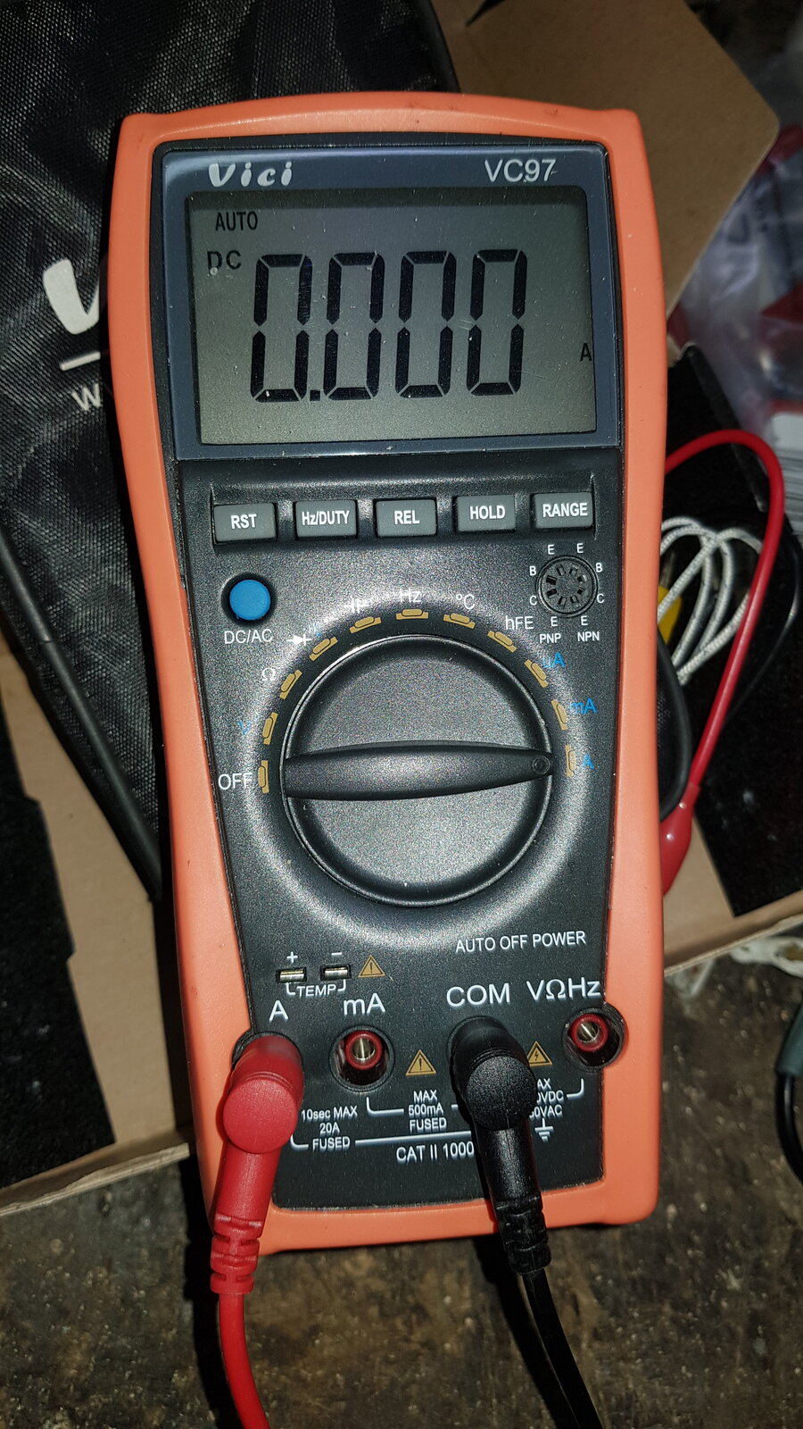

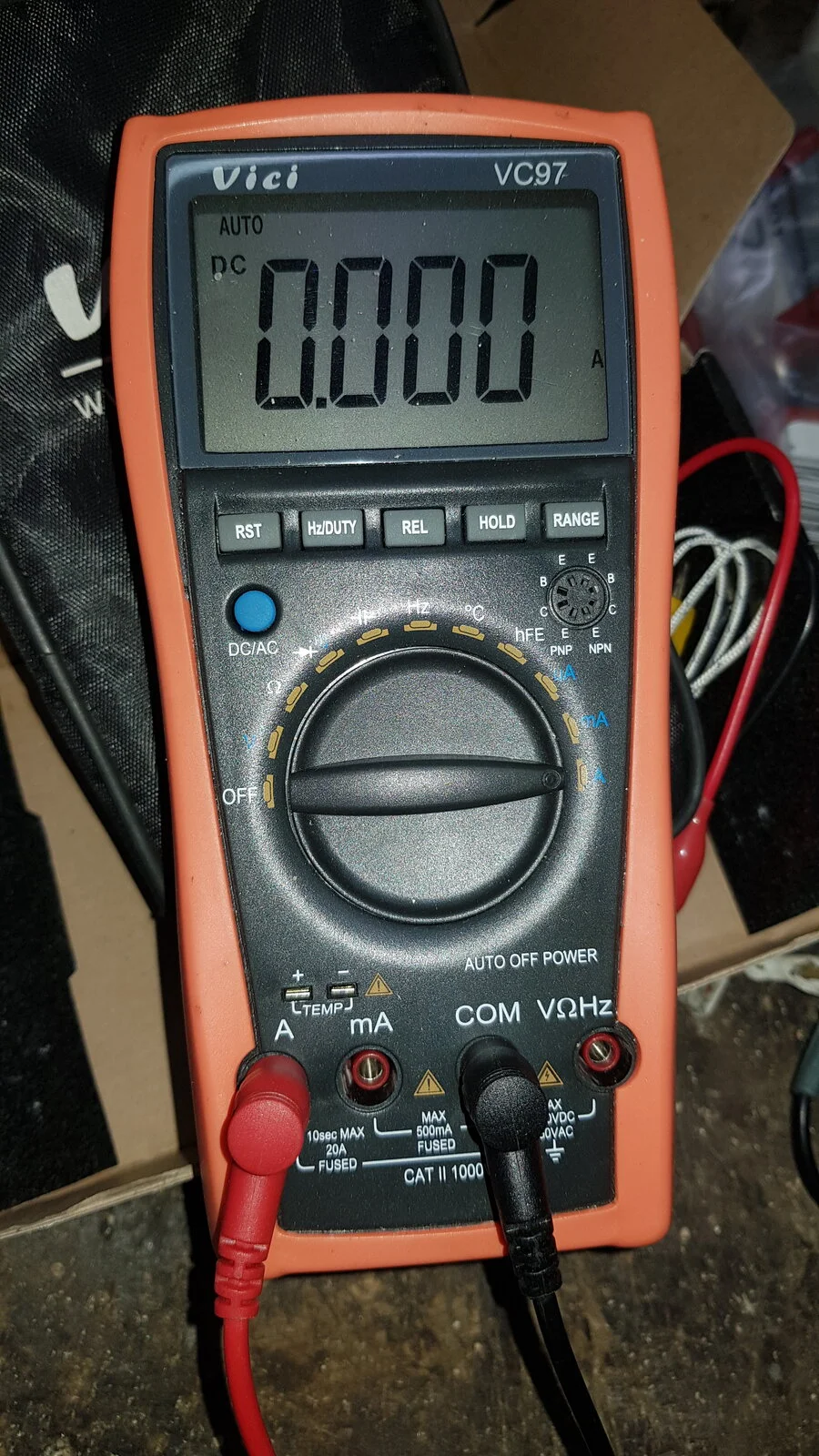

So with a few days off before Christmas I've tried to test it with a fully charged (new last year) battery and my multimeter inline between negative lead and terminal but I'm getting no readout on the highest 20A setting or the mA range. I e double checked with a spare meter but same result. What's that all about?
Also to add insult my clock has gone into Back to the Future mode😫
Yeah amps DC, tried on the high range and low with both meters. I'm sure it must be me though, I did watch a few YouTube videos first

Yeah looks right.
You're getting no reading at all?
Daft question but is the positive lead still connected on the battery :ROFLMAO:
Yeah still connected, I cant have blown the fuse in both meters surely, set them both to highest settings first.

Tried that too then gave up in a bit of a strop, not even getting a flicker on the readings. Just cant believe two meters can be faulty, I really scratched the probes into the post and terminal too to make sure I han a clean contact.
Not sure if it makes a difference but did you try it with the probes either way round, like black to battery and red to the lead and vice versa.
Take the fuse out and use the multimeter to measure resistance. Should be a few ohms. Borrow a 5A/13A fuse from any household plug if you have to.
Assume you’ve got this covered, but current must be measured in series.
Positive terminal stays on battery. Negative terminal disconnected from battery. Multimeter “bridges” the gap between negative terminal on battery and negative on loom.
Trying to measure current in parallel (directly across the terminals like you’d measure voltage) or trying to measure current with the engine running/starting will blow the fuse.

P.s fuses burn relatively slowly, I’ve permanently damaged a multimeter before by drawing more than its rated current, even though it was fused correctly. Voltage & resistance still worked but current no longer read correctly.

The first paragraph, which fuse do you mean me to take out?
The 12A fuse had blown, dont know why as I had it set on the highest range. Ordered some new glass fuses

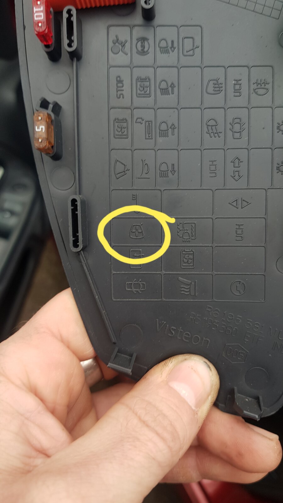

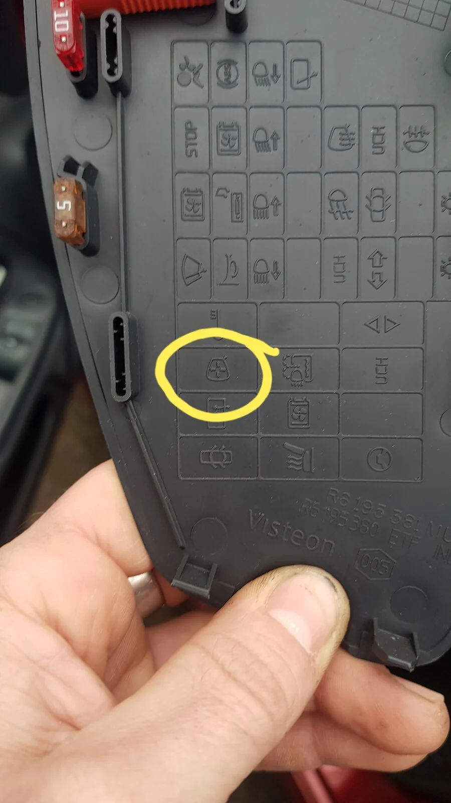

I've carried out a battery drain test to try and find my problem circuit, found it quite quickly. Is this the hazard switch?

Yeah I think that's the one too.
I take it the lights and radio aren't on when you lock the car?

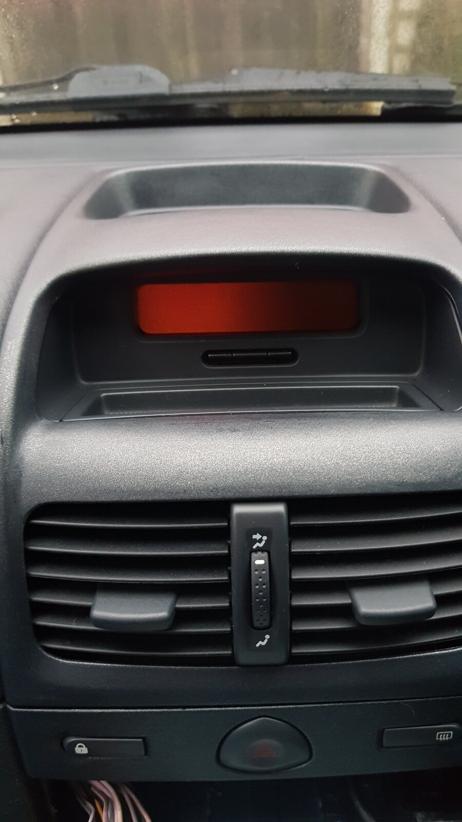

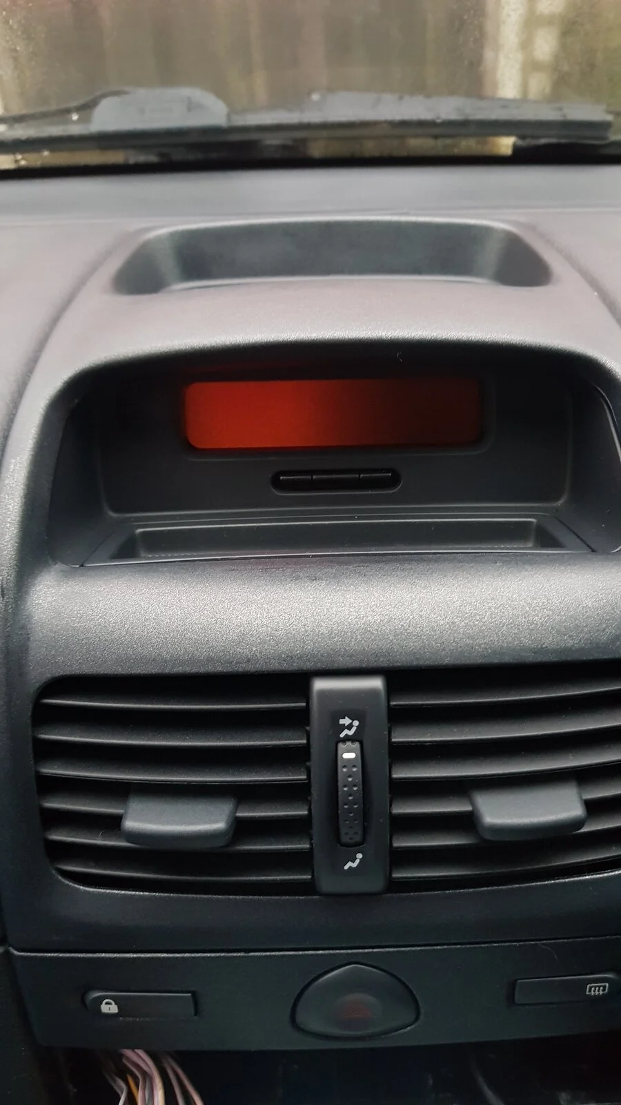

No but as the light is fading here I've noticed this, one half of the clock display is faintly lit so I'm certain it must be that

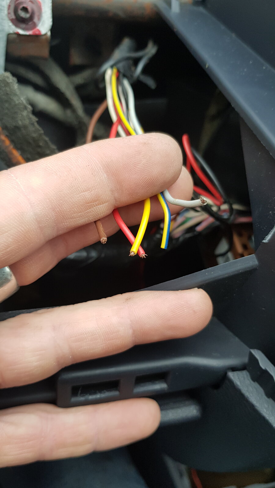

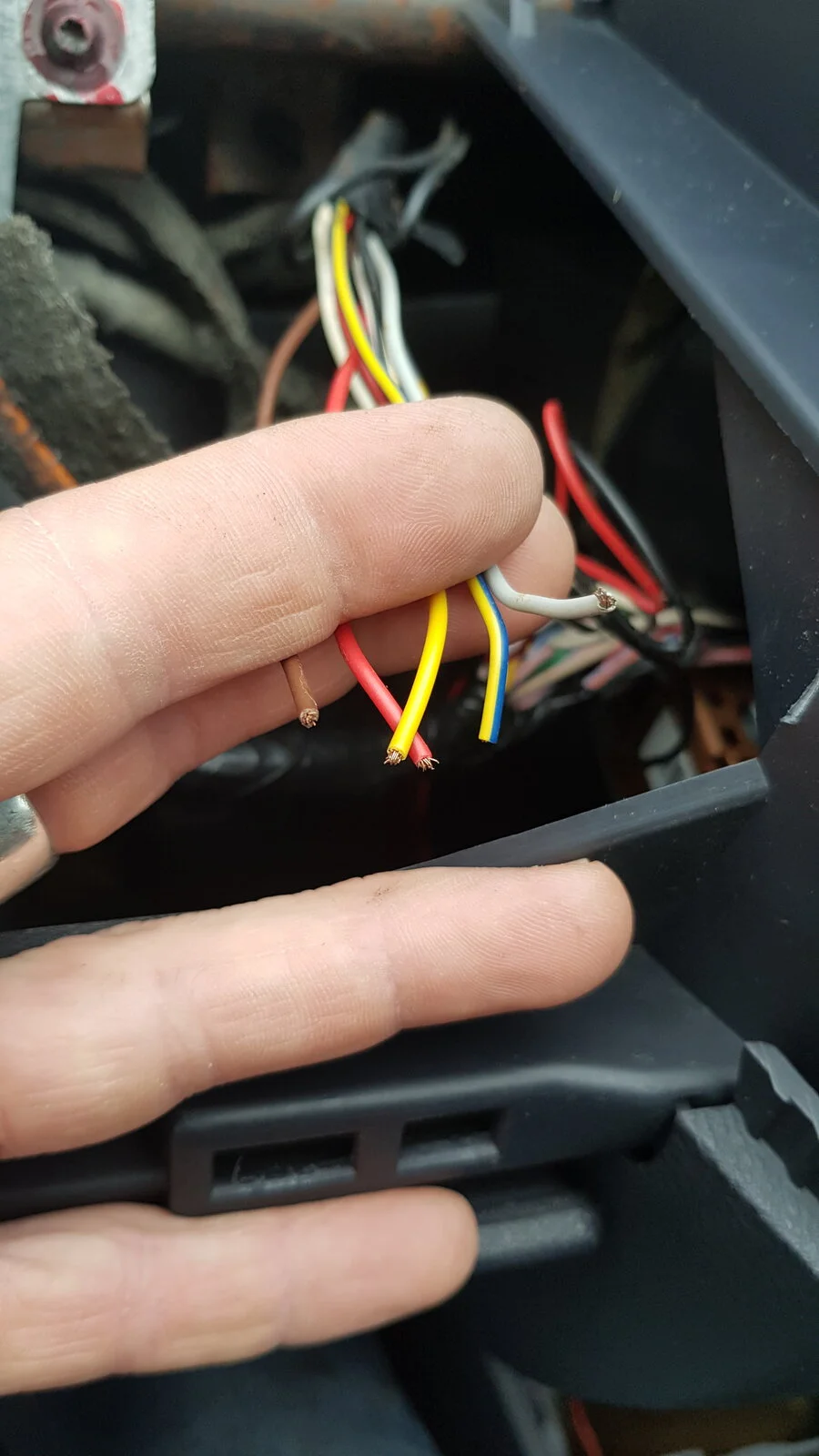

Maybe these cut wires from a removed aftermarket head unit?

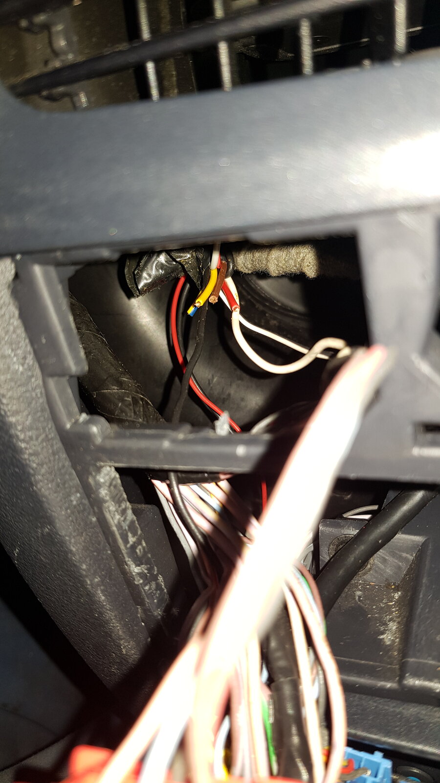

Ive had the dash top off today and found a poor connection on the clock causing the back to the future clock and semi backlighting but also the interior light had some tarnished contacts.

Back to these cut wires, they go into an insulation wrapped loom that hangs under the glovebox so as everything else seems ok I'm assuming they are from a previous head unit and can be ignored.

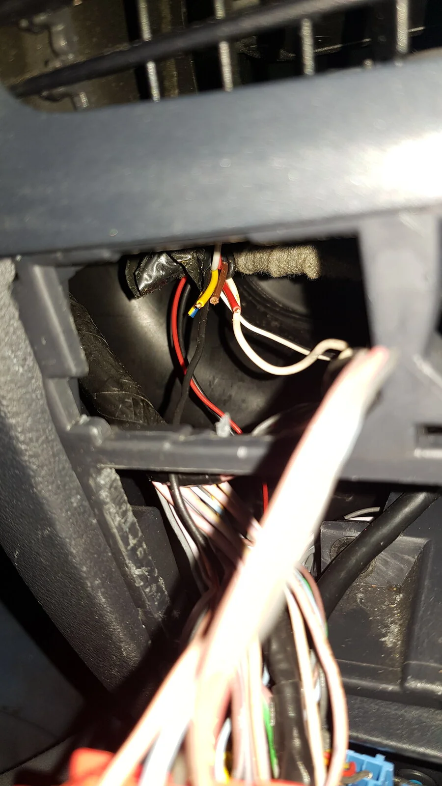

Only other oddity is two wires clamped under two fuses going into the engine bay fuse box
Just stick a bit of tape over the ends of those cut wires, just so they don't come into contact with anything. Should be fine.
That looks like the wiring for the aftermarket alarm.. is it also bundled/taped up to the black and red pair which goes to the LED in the centre console? If so then its definitely the alarm loom and nothing to worry about.. Just stagger cut the wires neatly and tape and forget..

Yeah goes into the loom with the black and red alarm wires, the alarm is still working though as it woke me up at 3am the other day! All taped up now so I may just pretend I never saw it.
