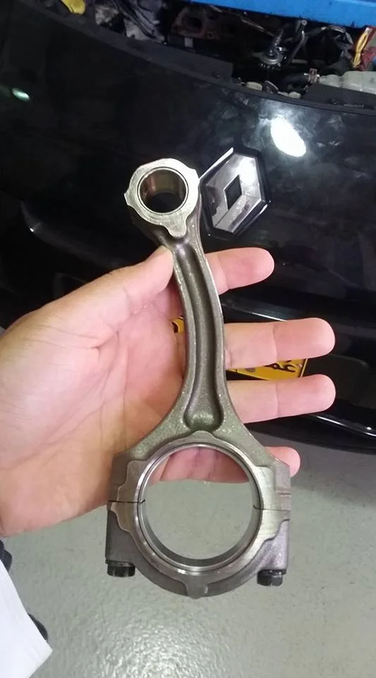

I wasn't at the workshop, I was on the workshop office, so I didn't see the engine but the rod shown to be damaged. The bent rod is clean with no physical damage.

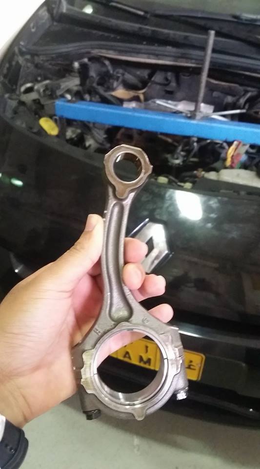

I took a photo of the bent rod

No way has that 'just happened' what's the piston crown like?
I'd be looking for who to beat to death with that if it was me.

Having seen many bent rods in race engines that has impacted something at high RPM , the piston and valves on that cylinder are likely toast as well unless it did the head gasket and dumped a shed load of water in
thats had a huge load through it , so either water(hydraulic damage) and piston would look fine or the piston is toast

Would you have believed this was from your engine if they handed it to you?
It`s actually from a VW that suffered head gasket failure.Notice how the piston crown has been washed.
You need to see the rest of your engine,and identify it as YOUR engine.
Thinking in a different direction,were the plugs replaced or removed and gaps adjusted?
The head could have been full of oil,or if the engine was pressure washed,water.
I`m actually surprised they would strip out the block,as opposed to just remove the head and see the pistons were at different levels at TDC.

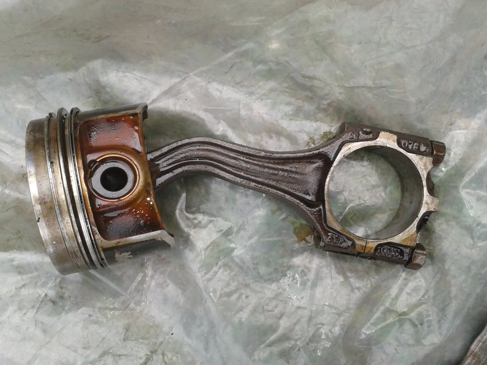

I bend a rod in my Alfa 156 after stupidly :grimacing: driving through deep water, The first picture looks very much like my con rod did after I took the engine apart. After stripping and replacing the big end bearings and changing the cam belt the engine ran again but as others have said on here there must be considerable force being transmitted to achieve the bend.
I`m not sure I would trust a crankshaft once this had happened.

I drove the car for another year before it failed its not for rust and sold for spares. As the car was not worth much it was worth a try. Don't think I would be doing it again .
