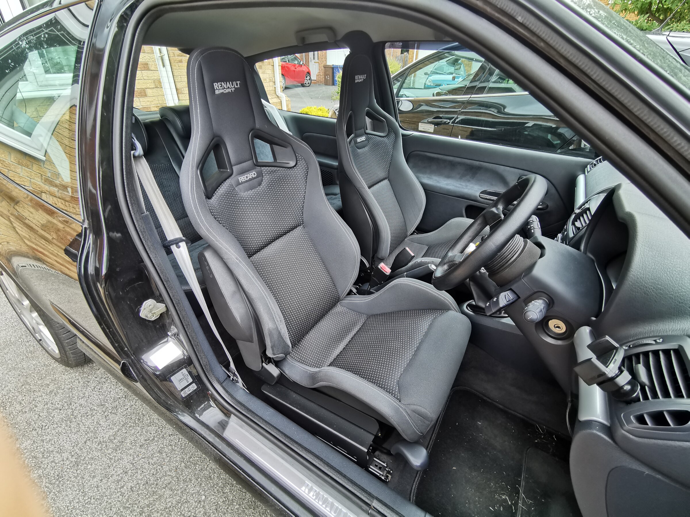

Corsa seats are similar, but the bases don't have as much support as the Clio ones. They are the recaro cross sportster CS. They will probably be easier to fit in mk2 than mk3 clio ones. The base and seat back are bolted to the base frame separately. You can either get a replacement frame from @JON FOZ or hack up the mk3 frame and use it to fab up the mk2 sliders. The mk3 frame is 9 inches high at its lowest setting and the seat is too tall to fit in a mk2 as it comes out of the mk3!
So no, they are not easy to fit🤣. Solo worth it though 😉.
