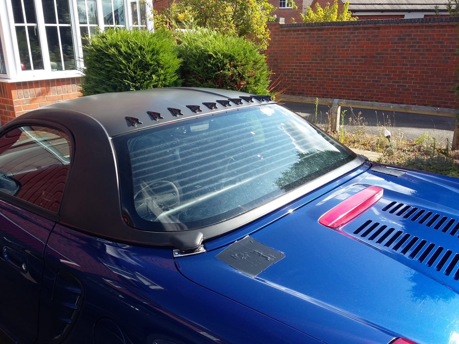

Right, instead of fitting a big gay wing I've decided to try and reduce lift, drag and improve air flow over the car.
What I've noticed with the MR2 is it has a big air bubble behind the hardtop going down the rear deck as the rear window and 80% of the rear deck doesnt really get wet when driving in the rain. Also I noticed when my mate was flicking cigs out the window at motorway speeds the butts were travelling over the bubble around a foot away from the contour of the rear and then suddenly moving vertically bouncing off the end of the boot lid.
So after much reading on aero and reading on various MR2 forums its seems fitting vortex generators to the back of the hardtop and fitting a small lip spoiler and the end of the boot lid reduces this bubble effect and increases air flow over the body of the car.
Parts were only £20 so it's worth a punt. Also if it does improve the airflow then a big gay wing would be much more effective with low pressure flowing under the wing and high pressure over.
Vortex generators will look a bit shite but if they're functional then I'm not arsed how they look.
