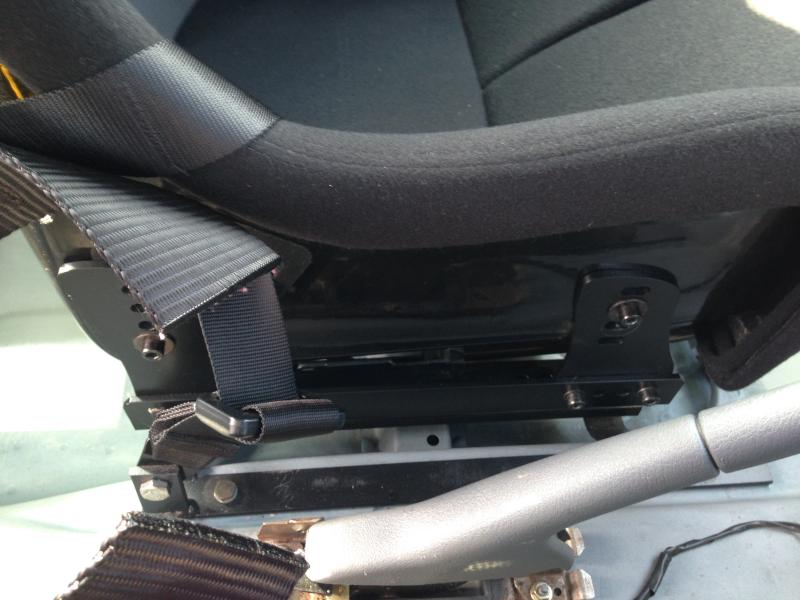

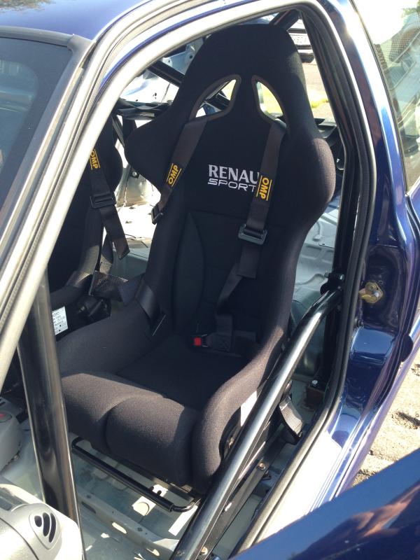

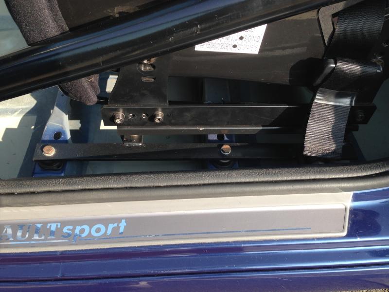

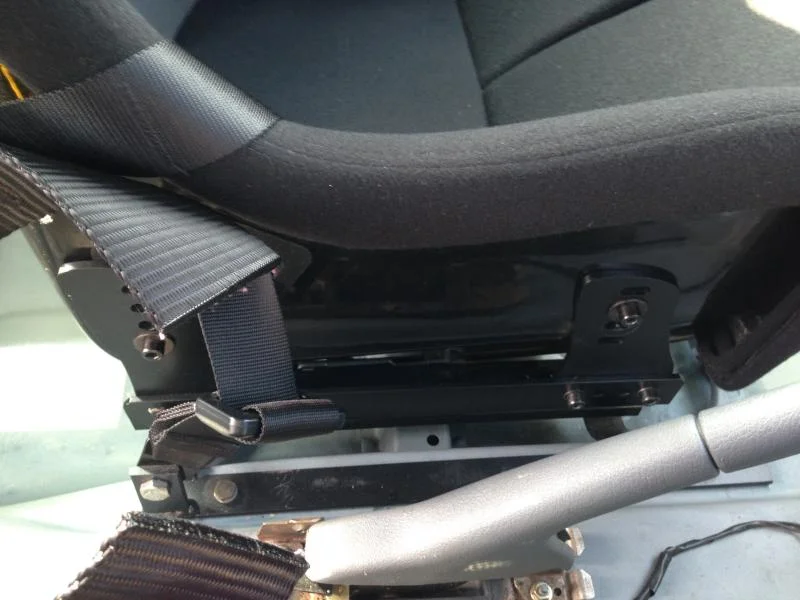

I had them fitted in my PH1,mine were fitted to Cobra X-low subframes along with sliders,each seat only takes 5 minutes to fit but as said you do need subframes to suit the Clio

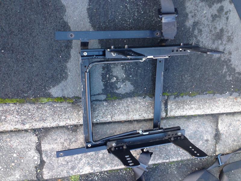

This is the hardware you require for fitment, the subframes are handed so you need a right and a left
Hope the pics help you.
