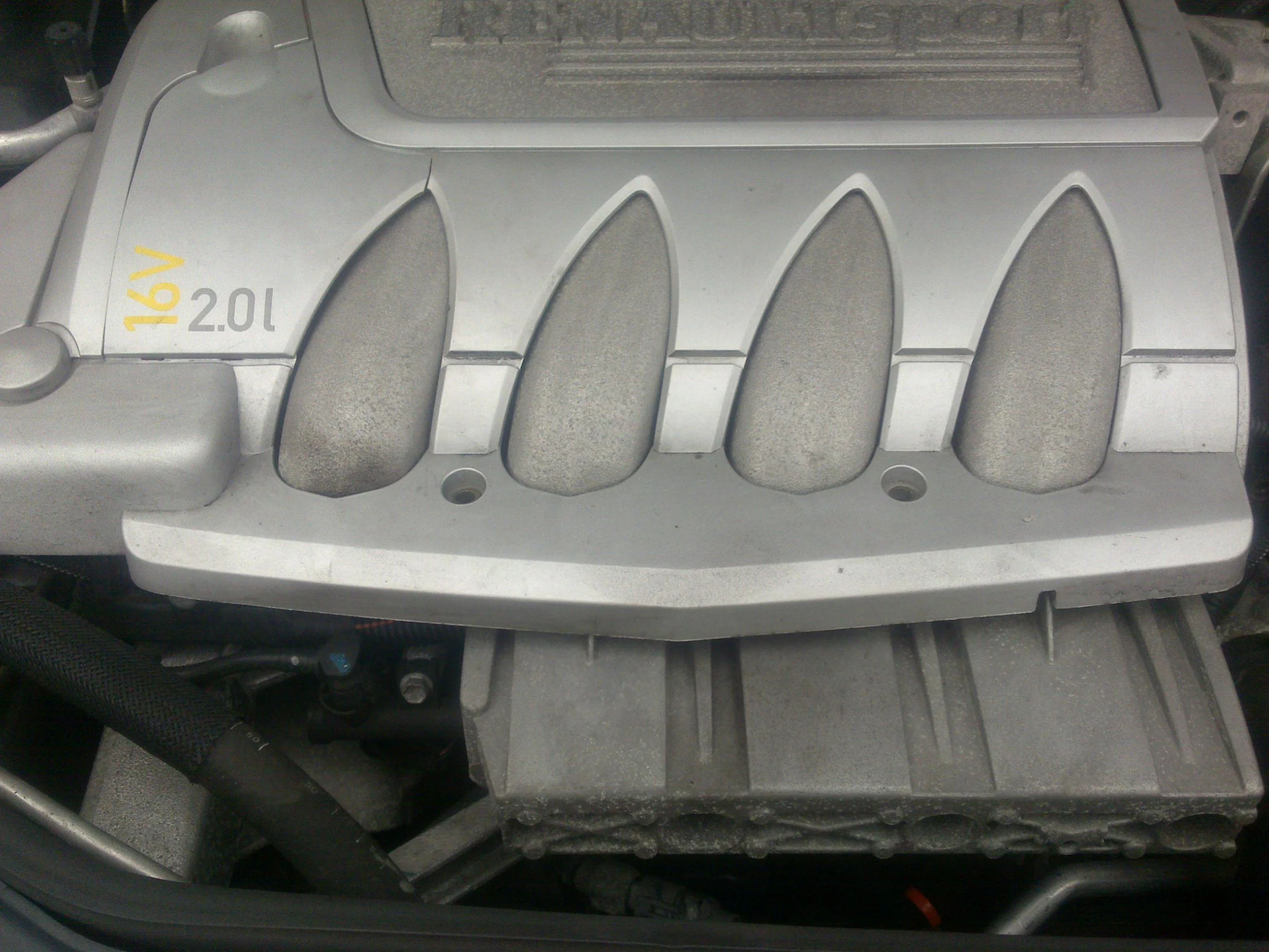

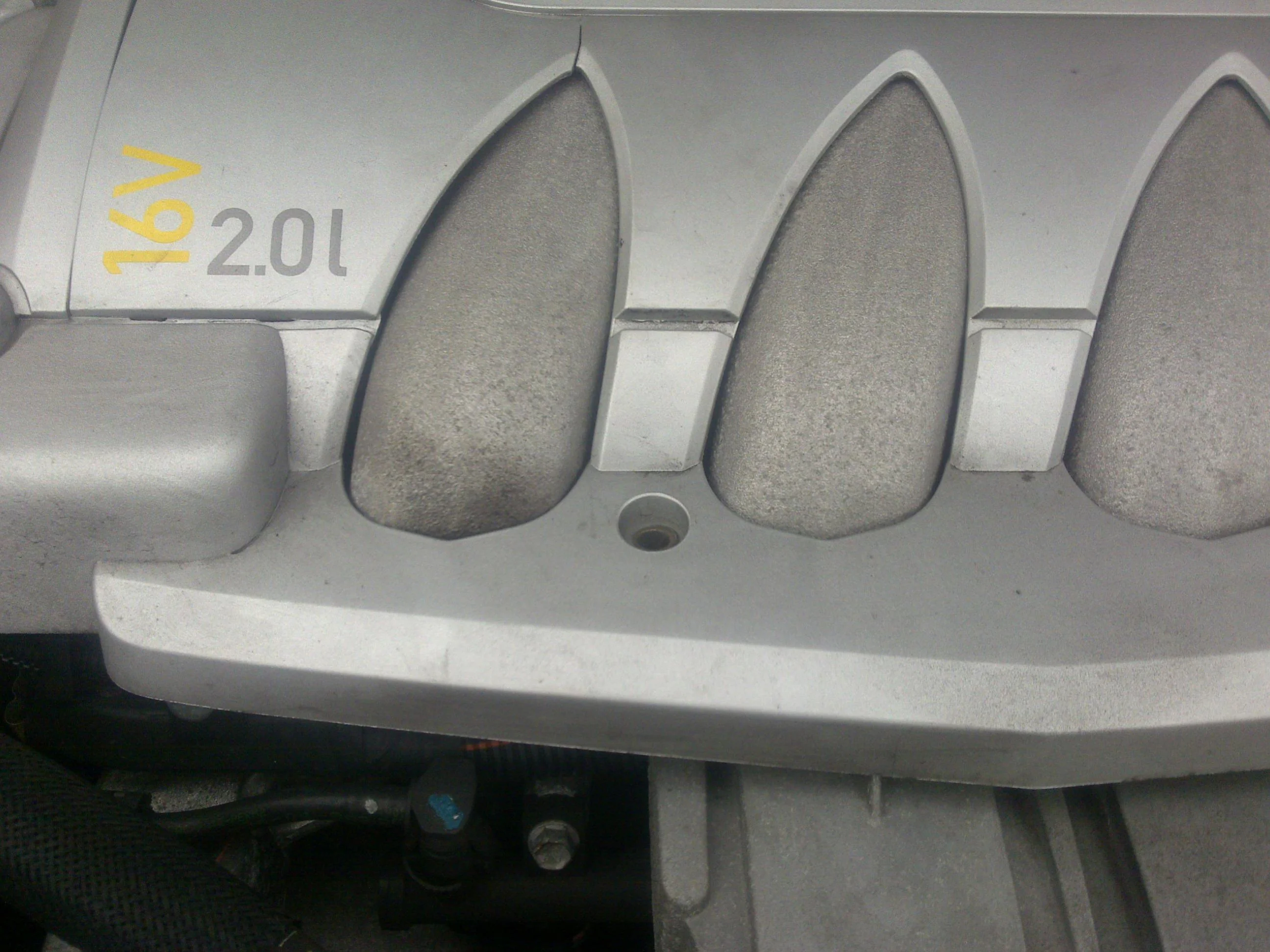

Yesterday I wanted to check my engine oil level. I lifted up the bonnet and went about my merry way checking it. Oil level was still perfect so that was all good.
I then had a look at the engine and i noticed some black build up on the left of the engine.
I then lifted up the engone cover and noticed that it is isolated to just one part of the engine.

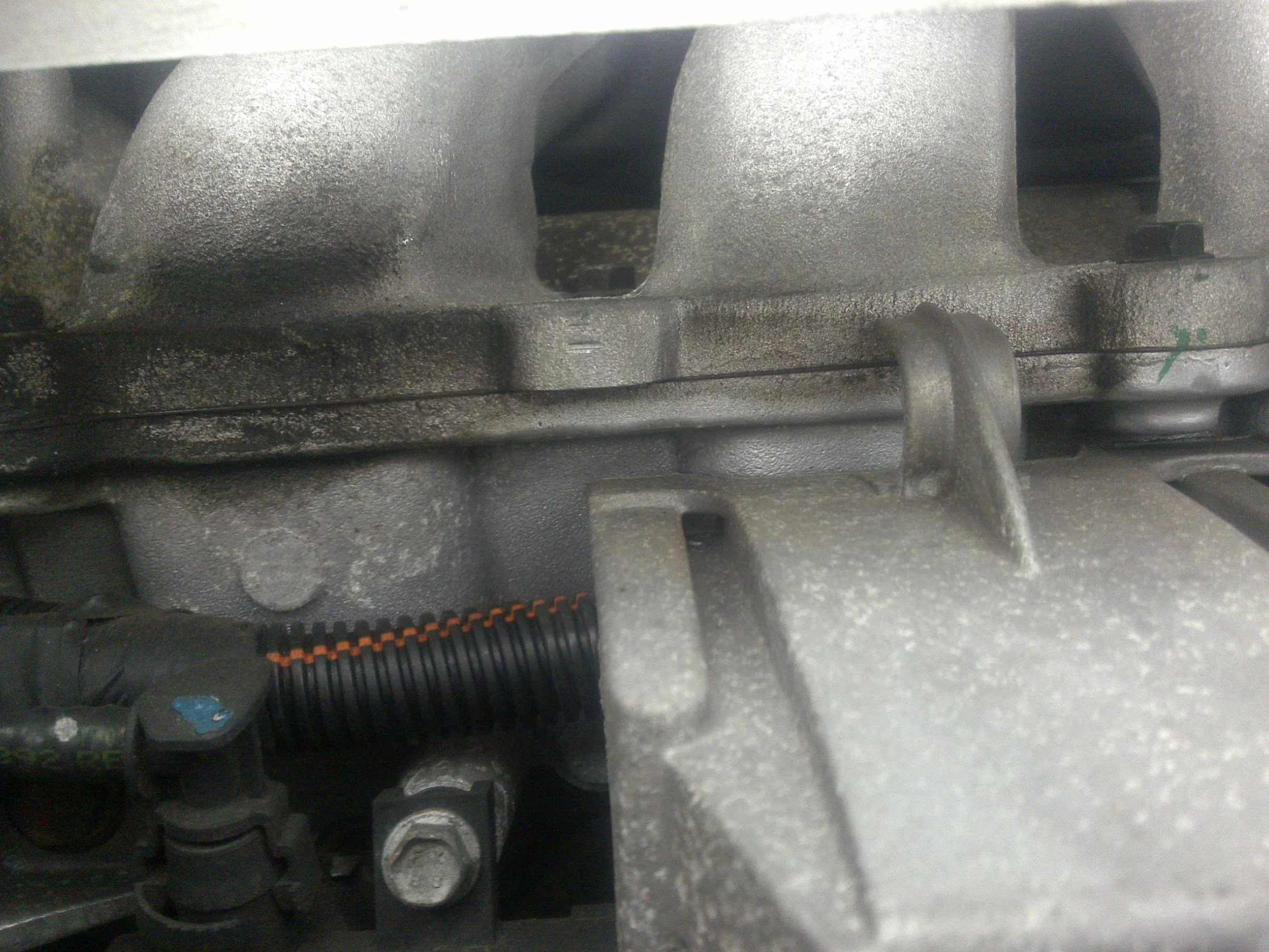

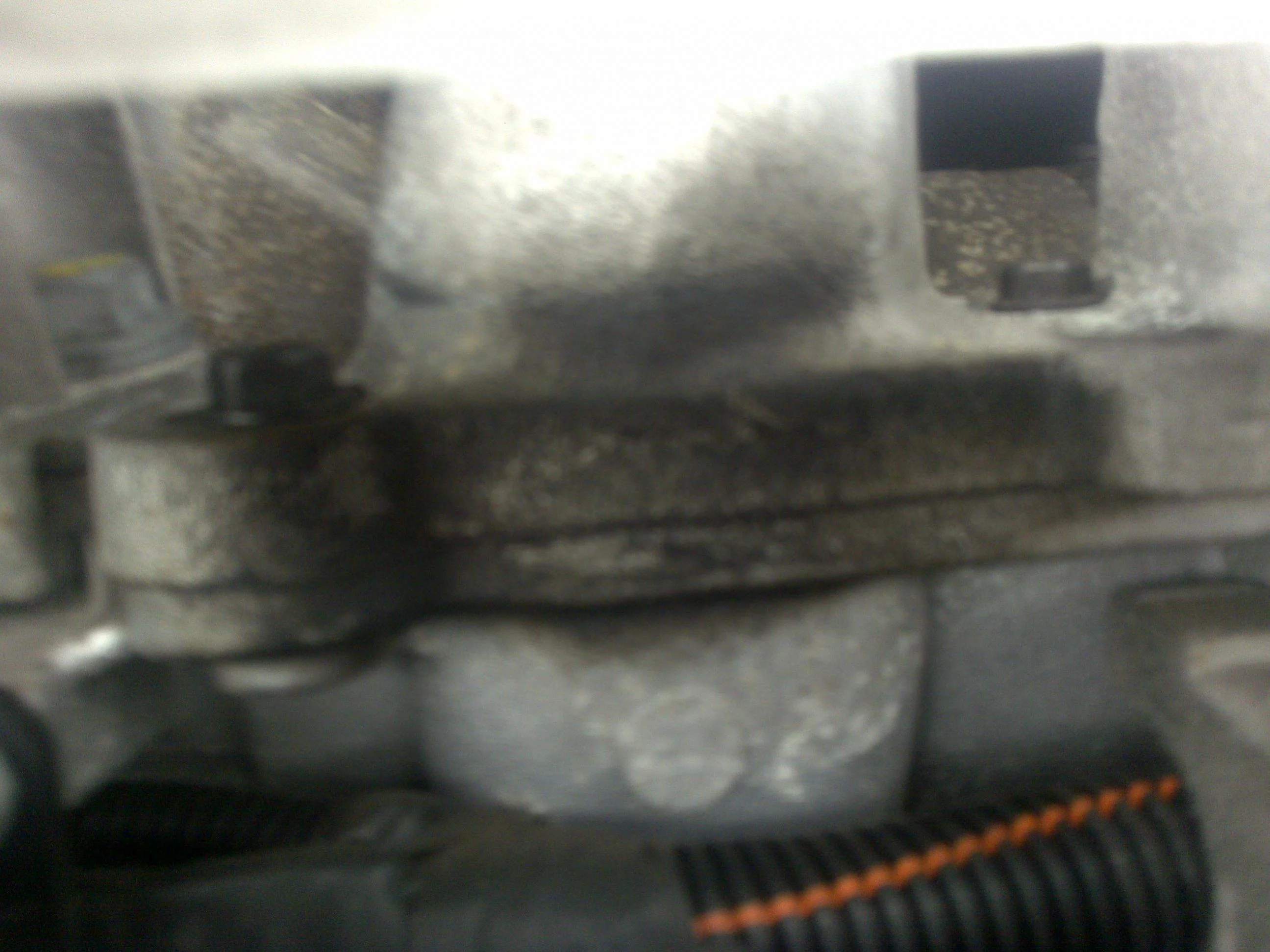

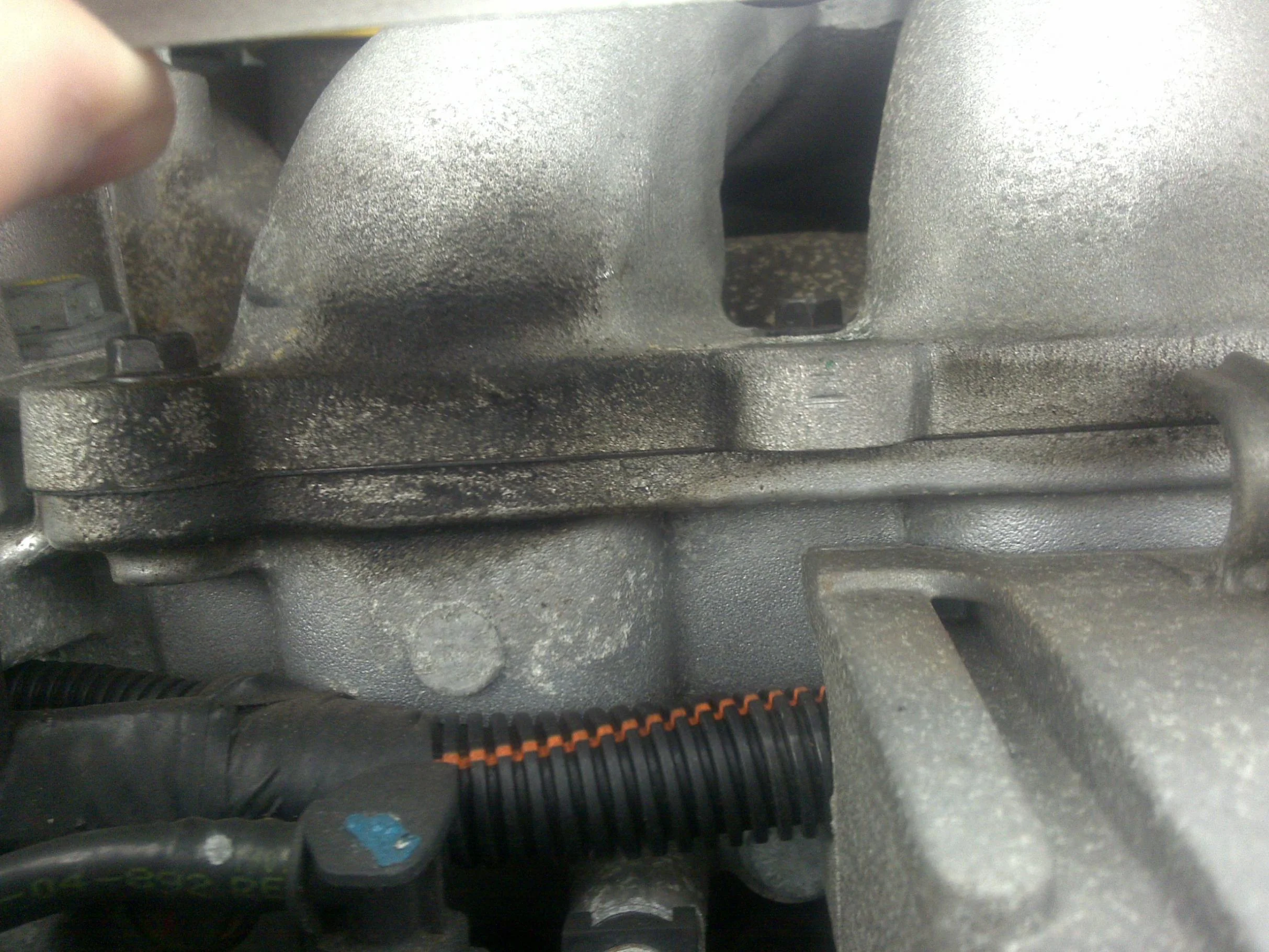

Now I like to think I know abit about the mechanical workings of a car as I have spent quite alot of time reading about engines on the toilet. But i have to say I don't know what this is, if it is a problem at all. At a guess and this is purely a guess, I'd say the top gasket that is inbetween the rocker cover and the engine body(unsure if thats right) has a hole in it.
Any advice or thoughts on this matter are gratefully received.

At a guess, i'd say its either where general dirt and crap has stuck to overflow that hasnt been cleaned up from an oil fill
Or its general crap dished out by the timing belt
Or its a bit of puke spat form the dephaser
Or its general crap from the power steering (the wee pressure sensor sometimes leaks)
IIRC its in teh line of fire of the AUX belt kicking crap and oil up as well.....sometimes that power steering pump leaks a bit...
I wouldnt fret tbh
HTH
JJ
  2003 Clio 172
p.s.
Thats only an inlet, as far as I know....there is no oil or fluid in or around that area, so its not a leak form the engine IMO.
JJ
  RS Clio 182 FFBG55
ok thats cool. Ill clean it off and then see how quick it builds up again. I suppose that could be a sign of how serious a problem it could be if any.
