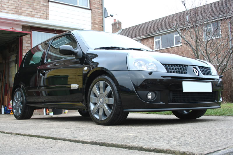

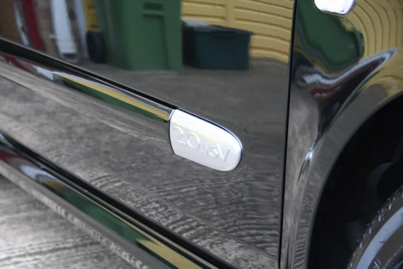

r-jay said:
1.Megs Clay,
2. AG Super Resin, (Forget the Megs Stage 2 IMO)
3. AG Extra Gloss x 2
4. Wait at least 24 hours or till after the first wash an top with P21s
Cheers
Rich
cheers m8ty, could u clear up step 4 m8, "or till after the first wash" - wash the following day b4 waxing? cheers
After applying a sealant you need to leave at least 12 hours to allow it to bond and set up for maximum protection. You should do this before applying the Carnuba Wax. You can either keep the car clean and dry while this happens. This is not always possible so you could wait until the next time you wash the car - say the following weekend and then apply it.

lookin good r-jay:cool:
Cheers Matty, no probs.
Can never be bothered to set the presure washer up here, a good blast with the hose pipe first is must. Loosen up the grime and then spray on the cleaner an scrub.
nice pink bucket
stunning! so much effort must of gone into that r-jay, pro job as usual :D
