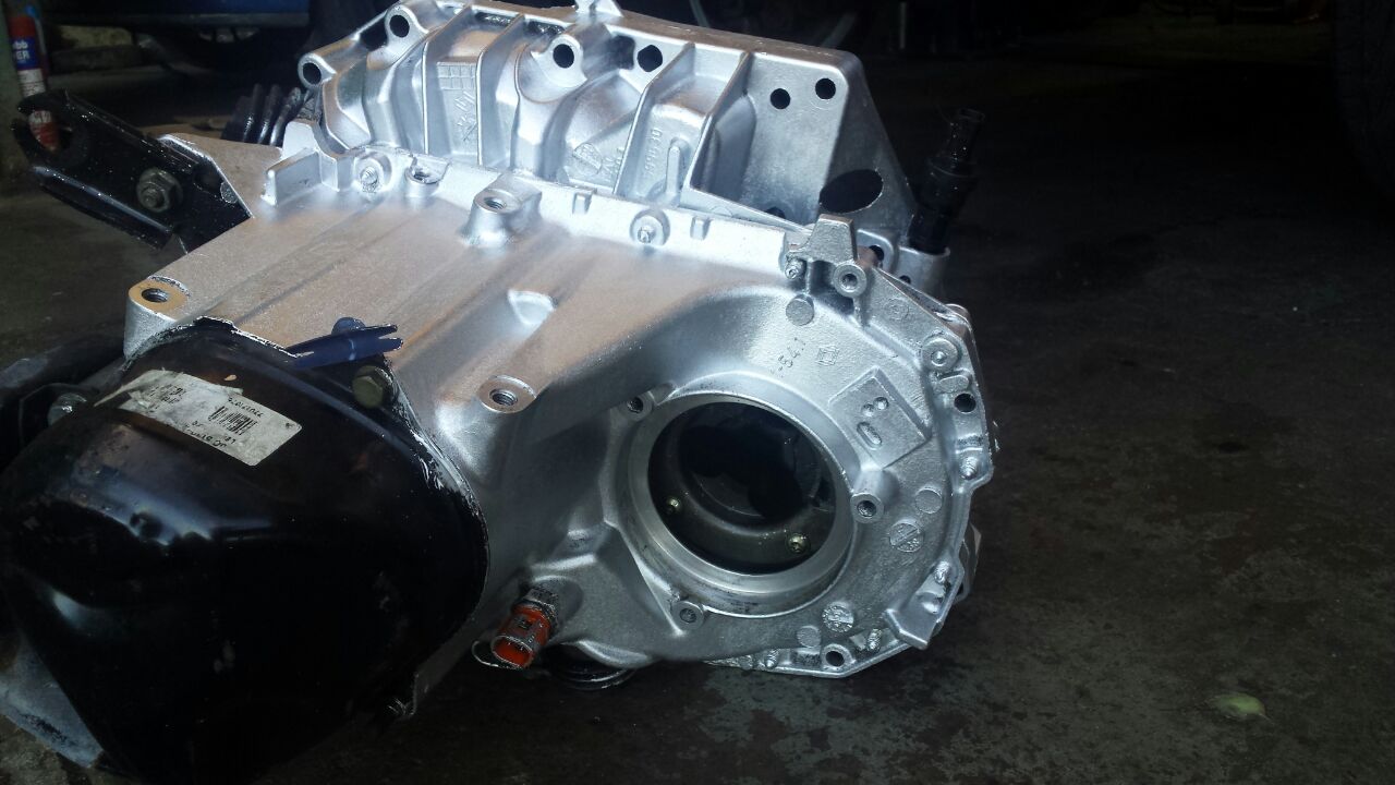

I had standard JB3 GT Turbo gearbox on my modified R5. 25 years old box with no problems. Then I decided to use JC5 from clio 172 because of better gear ratios. I disassembled it to check if box is in good condition. Found worn 1-2 gear fork and worn diff circlip and washer. So it would be interesting to find why is this happening on clio gearboxes. I have another JC5 box for parts and same thing-worn diff washer and circlip.
NorthloopCup
I seem to recall that Renault modified the circlip when you buy a replacement one. They just made it thicker so it fills the groove better. It's by no means a permanent fix though imo.
  R 5
Gearbox reconditioning goes on.
I ordered new washer under the circlip. There is thicker 2.5mm and thinner 1.8mm washer.
Disassembled gear shaft (gear pyramide). Shaft is hollow so oil is going through it and lubricate gear bushes and synchrons. It was dirty from inside and between bushes and shaft. So my advice is to put it all apart and thoroughly clean all parts when reconditioning the box. Bushes must be heated to 150 C when disassembling and assembling them.
Again problem with ordering parts. There is spring for 1st and 2nd gear synchron. It is not the same as on non sport jc5 boxes. When you order it you will get non sport spring. Right part number for this spring is 7700116330 (only for jc5 089, 129, 130 box) and is temprairly out of stock. If anyone knows where to buy this spring i would appreciate it. Shaft washers (for tappered bearings) are insanely expensive-cca 150 pounds a set for only one shaft!!! Other shaft washers are cca 40 pounds.
