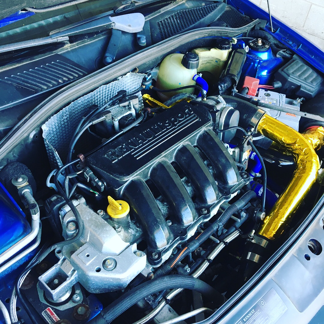

It’s got some kind of uprated corrugated heat shield attached to the bulk head but was thinking about getting the manifold/down pipe and turbo ceramic coated.

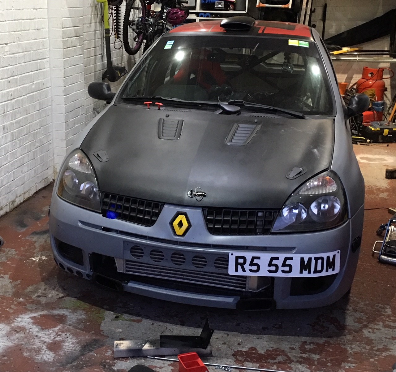

I removed the rear rubber strip on the scuttle to allow airflow out, had a couple of focus RS style bonnet vents and made the front grills removable for track use

I removed the rear rubber strip on the scuttle to allow airflow out, had a couple of focus RS style bonnet vents and made the front grills removable for track useView attachment 1367641
Yeah was thinking of vents but wanted to try and keep it sleeper looking ideally as a lot of people came upto me once it had been out, I had a lot of “what the f***s in that?!” ??
Was thinking about some bonnet raisers to help the temp escape? Don’t know how effective they’d be?

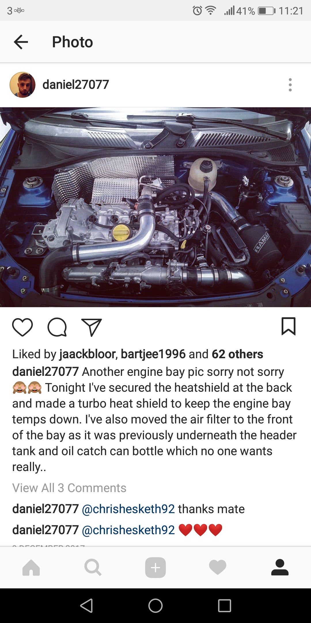

I've also made a secondary heat shield just for the turbo which sits on top. Seems to work very well
Sounds good mate
Any pics of your heat shield?
d11nyd
  Clio 172 cup
It's just nimbus heatshield which you already have but cut to size. Easy to do as you can imagine.
Yeah mine seems a bit short and only just covers the brake fluid bottle
Will buy some more and have a redesign it

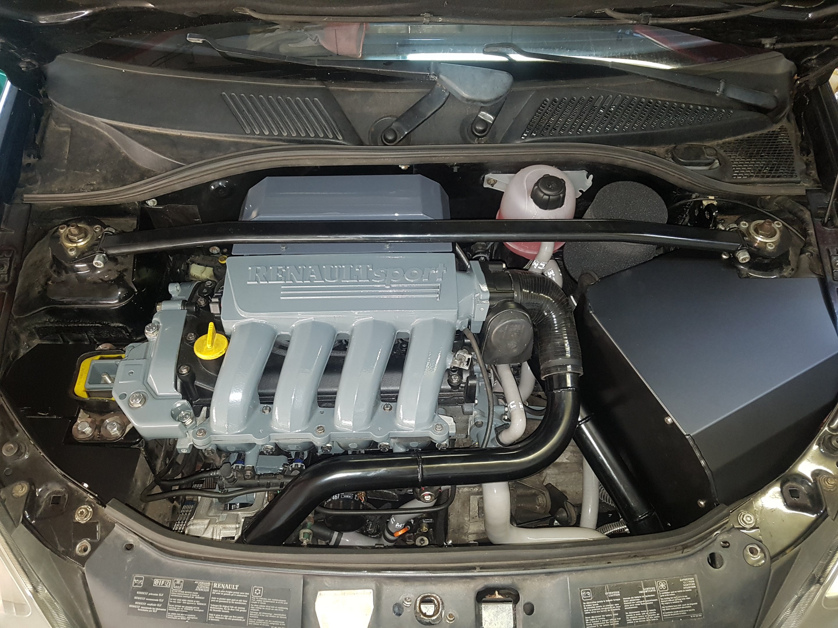

Filter will be fine where it is, my lads twingo has got a td04 on it and the filter is about 3" away from the compressor housing and bat's are fine on that.
If you go epas though you can move the filter to where the reservoir used to be.
