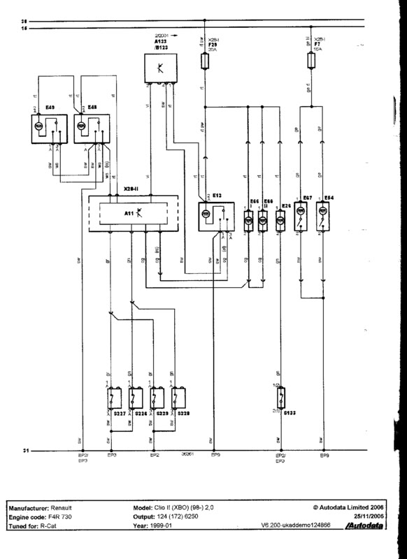

This is the layout, E12 is your main interior light.
E26 is your map light.

It's very simple, you have 2 positive feeds to the interior light, one from the door locking and one from the door switches. Swap the 2 feeds over and the door switch will operate the Map light instead of the main light.
