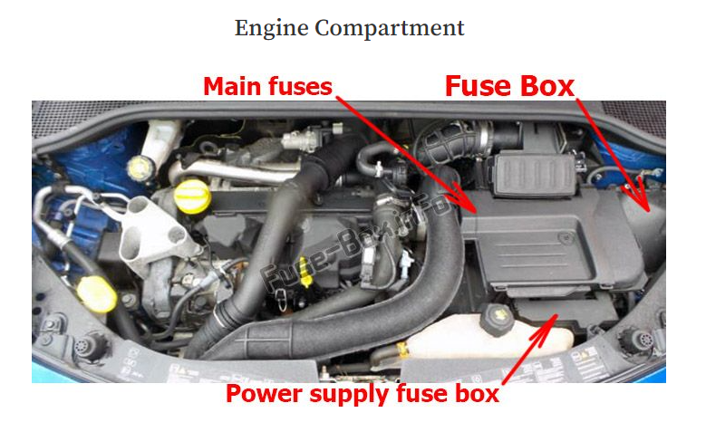

Before my boot stopped opening it would release the catch when you locked or unlocked the car, thinking it might be a relay as the wipers sometimes don't park in the normal position or stop at all, and when I checked the fuse box under the bonnet was damp.
  Renault Clio Mk3 1.2
I assume from the picture below it's the one marked "Fuse Box" which has the torx screws?
I have just checked all fuses located under the steering wheel and all fuses in the engine bay to the right, all are good.
I wasn't able to pull out any of the relays as seem to be really well stuck in.
Confirmed no moisture in either fuse boxes.
