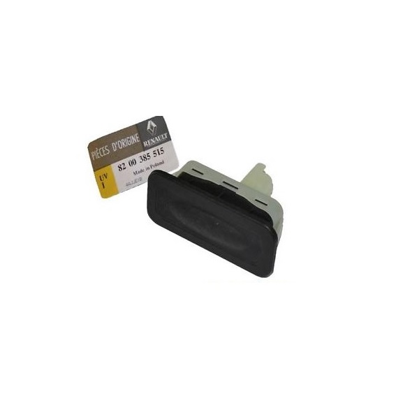

Sounds like the boot switch to me, this bit:
Cheaper, non-genuine alternatives also appear to be available, but can't vouch for them personally.

As said above, you need a new boot switch. Common fault on them.

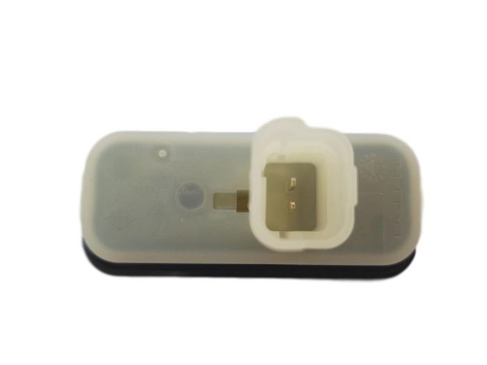

Could try putting a paperclip between the pins on the socket that connects the switch, see if the light goes off. Doubt it'd blow a fuse, but that's the worst case by shorting it I think.

I was just thinking short the pins on the connector that goes into the boot switch, only 2 pins by the look of it.
