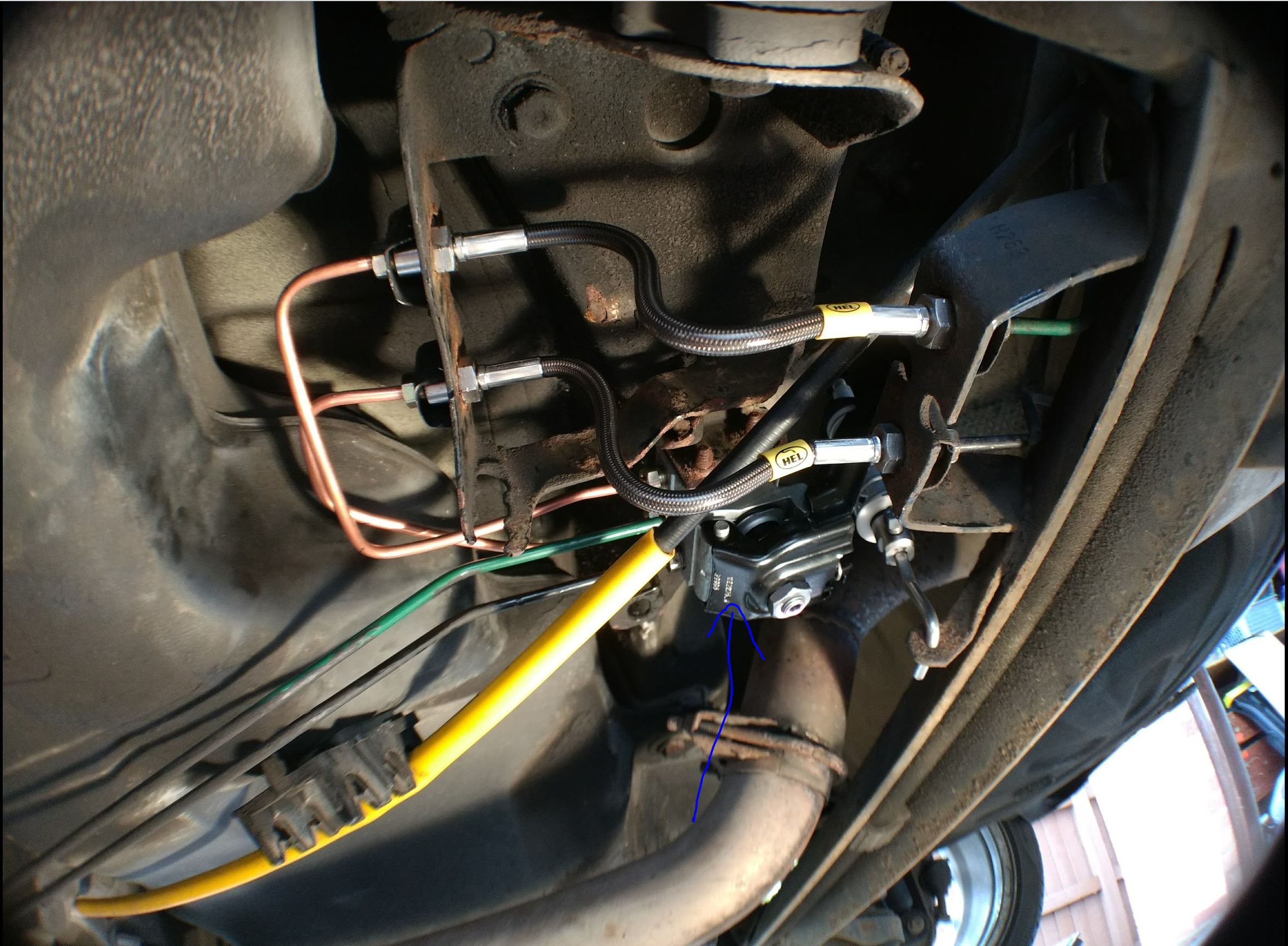

However, 172s are getting on a bit and it could be that the compensator valve on yours is in need of replacement. I DIY'd mine along with renewing brake lines and new braided hoses locally, and ensured connection to the suspension beam because I was fed up with being challenged at every MOT test. Compensator valve location arrowed in blue:

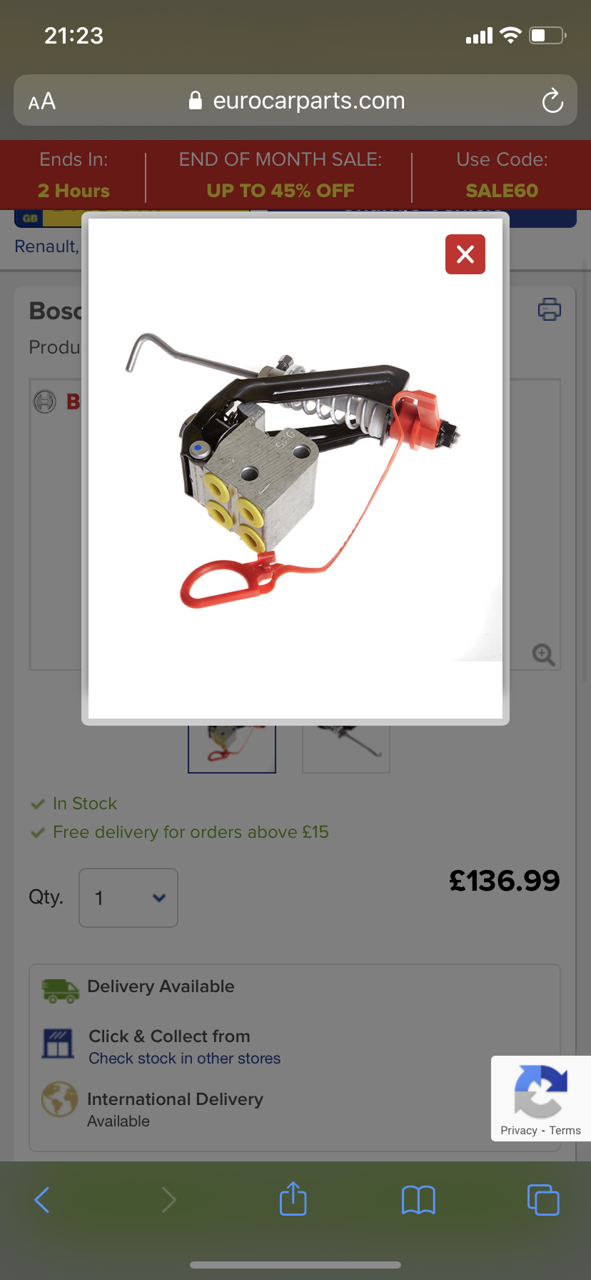

Thanks for the reply I looked my paper work from when I brought the car and previous has print out the information you posted link to. I was more worried about ordering the right part. This is the part I’ve ordered I hope it right 🤞
