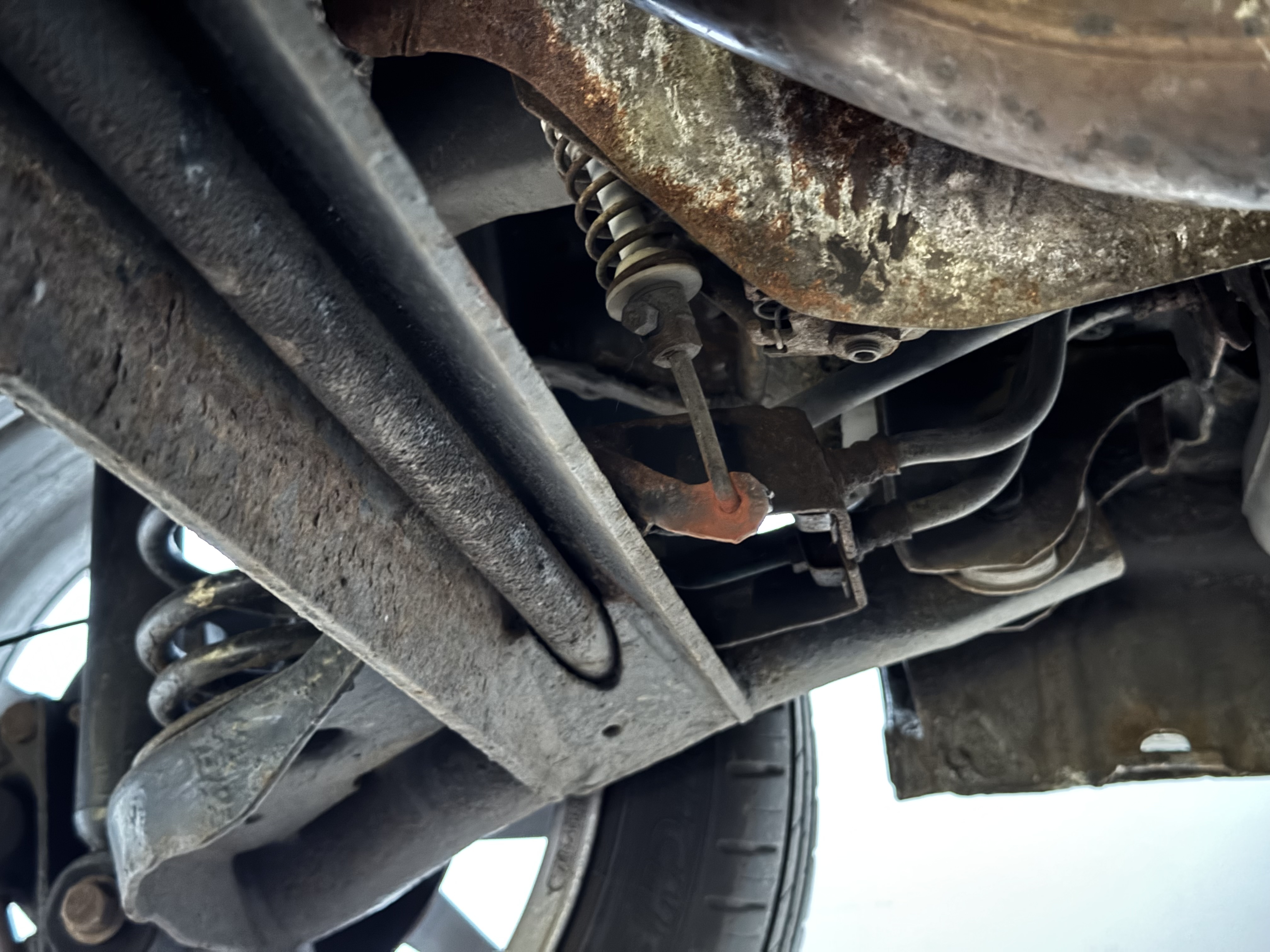

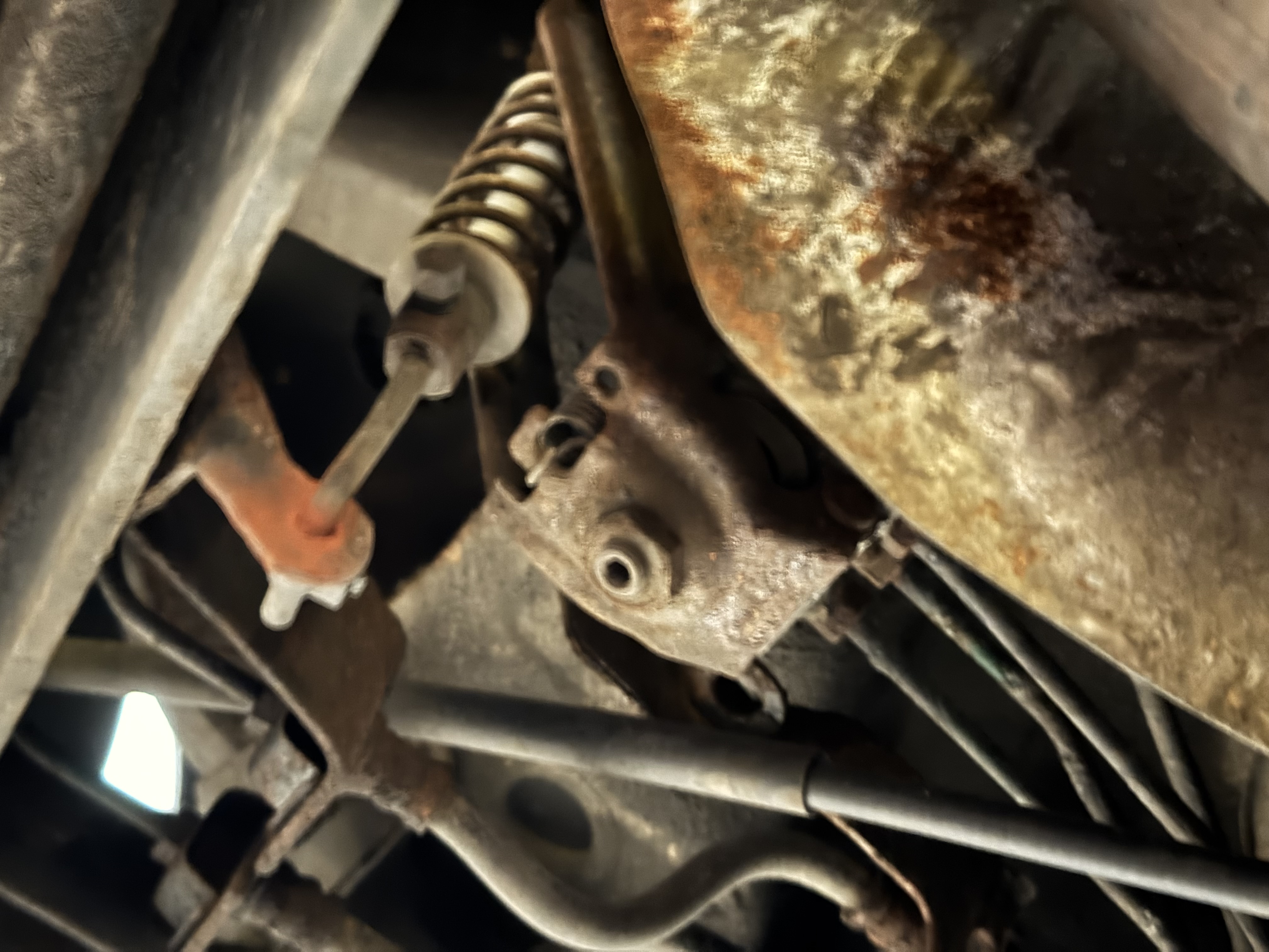

Are they not the same valve, just with the big spring and rod removed?
Matt Cup
  Iceberg 172 Cup
Mines connected 🤷🏻‍♂️
