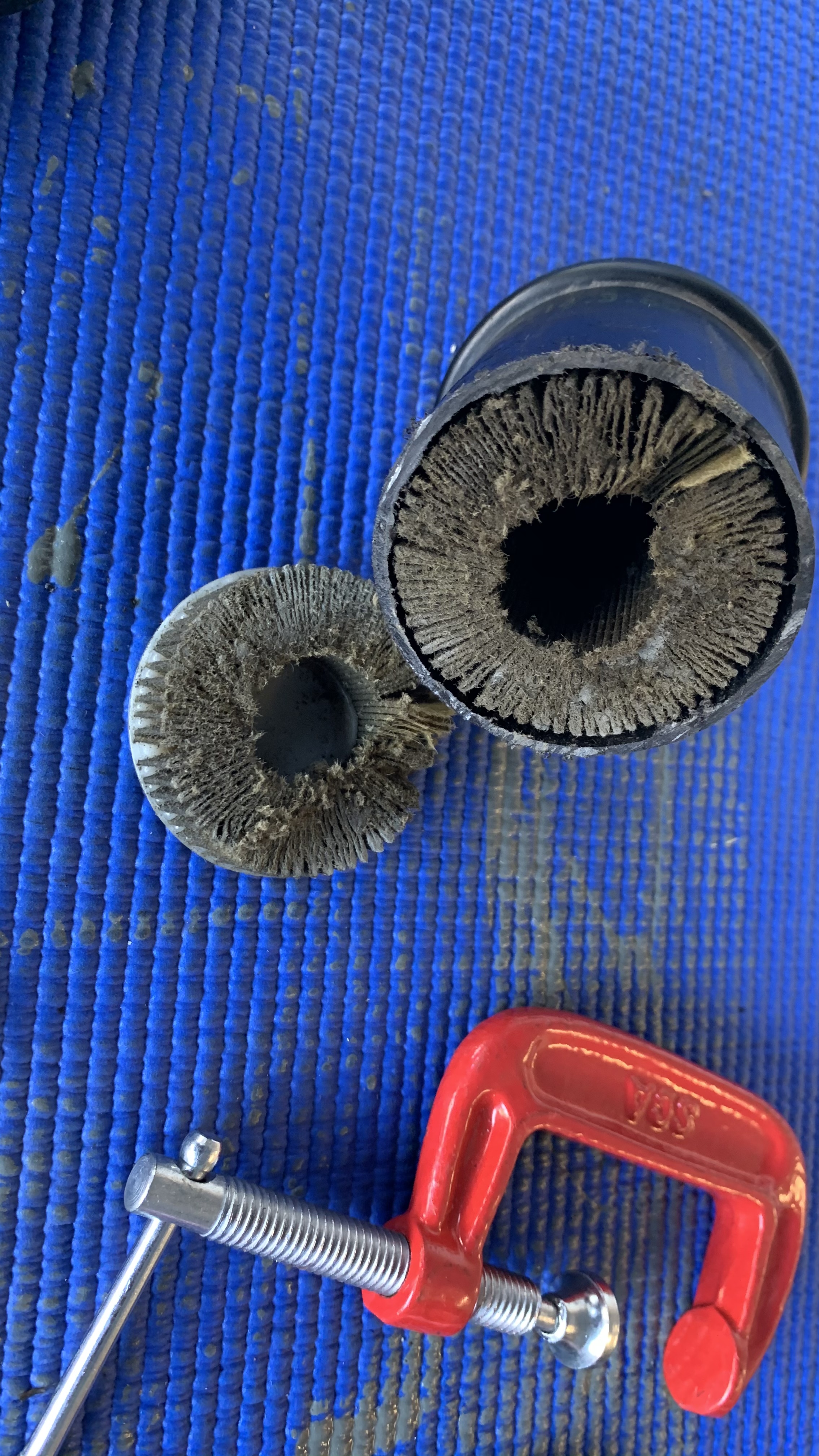

Here’s the old filter.
New filter in and problem is still there.
when cold, its fine. Drives like normal. As soon as its warmed up, problem return
