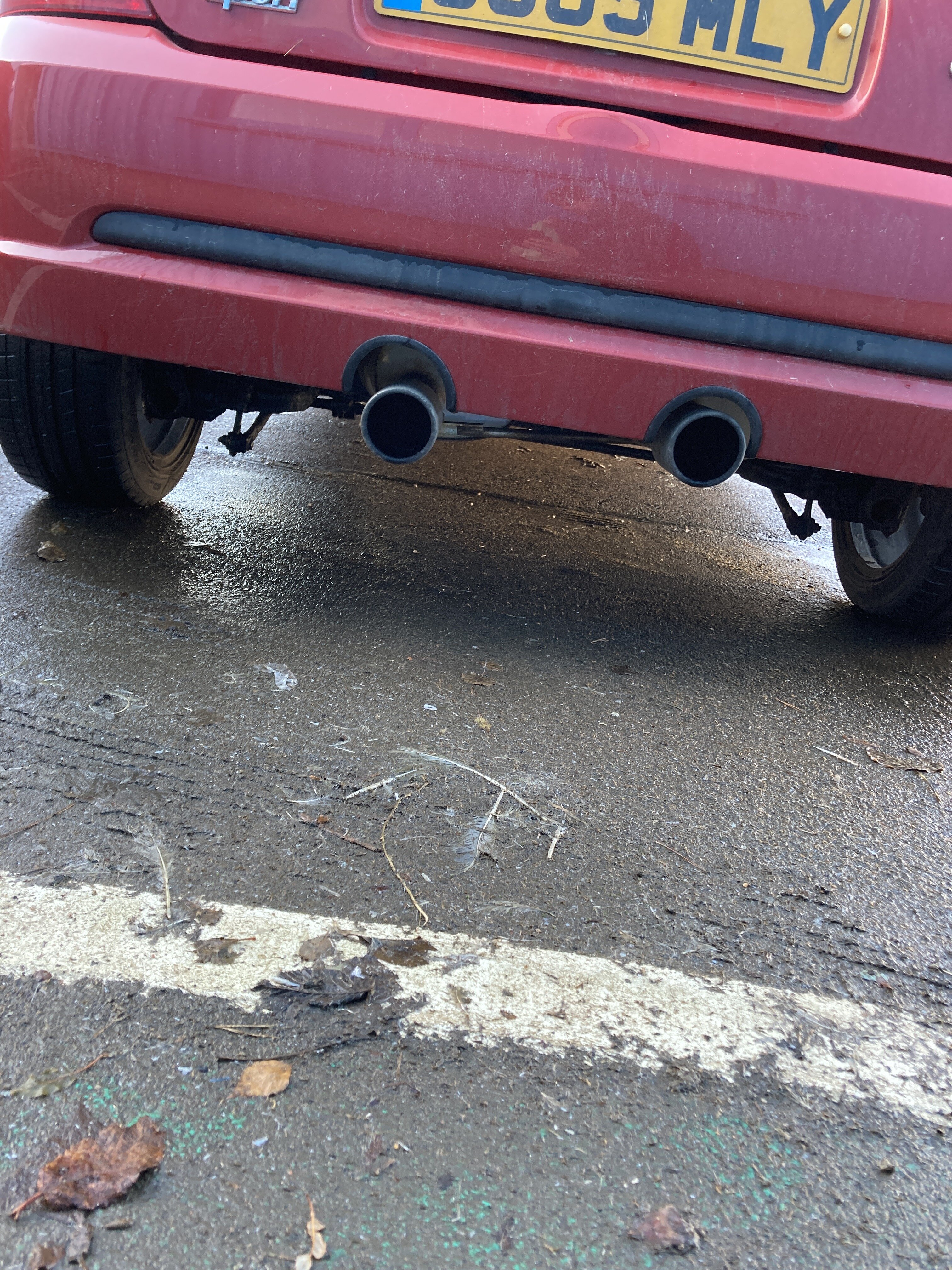

Looks like the originals are NLA from Renault, has anyone gone with these from BRR?
One of mine has had its day...

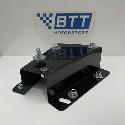

I have 2 for my 182 but haven't fitted them yet.
I gave them an extra coat of rustoleum, probably a bit of overkill but I know they'll never rust again when I eventually do for them.
They're very good quality.

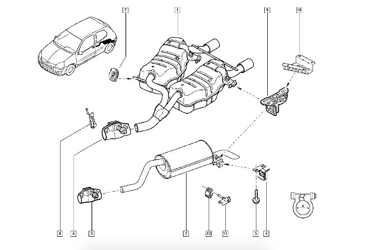

It's definitely this part as my mechanic mentioned it's the part that bolts directly to the boot floor and between it and the rubber mount.
MarcB
  Too Many
It would be Item number 10 which are NLA from Renault as you say.
BTT or ProAM are both decent and will both work with no issues..
@Patrick Bateman I have a couple of spares (2 pairs if you are Stirling)
