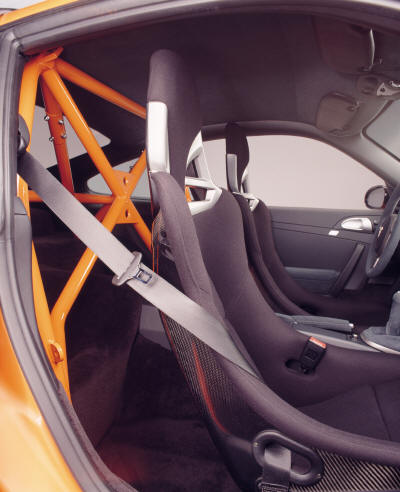

you can thread the belt through bucket seats ! I did it for about a year !you just undo the bar at the bottom of the B-pillar where the seatbelt is bolted to, thread the belt through the side hole in the bucket seat and then reattach the belt to the bar.
( it will look like this )
