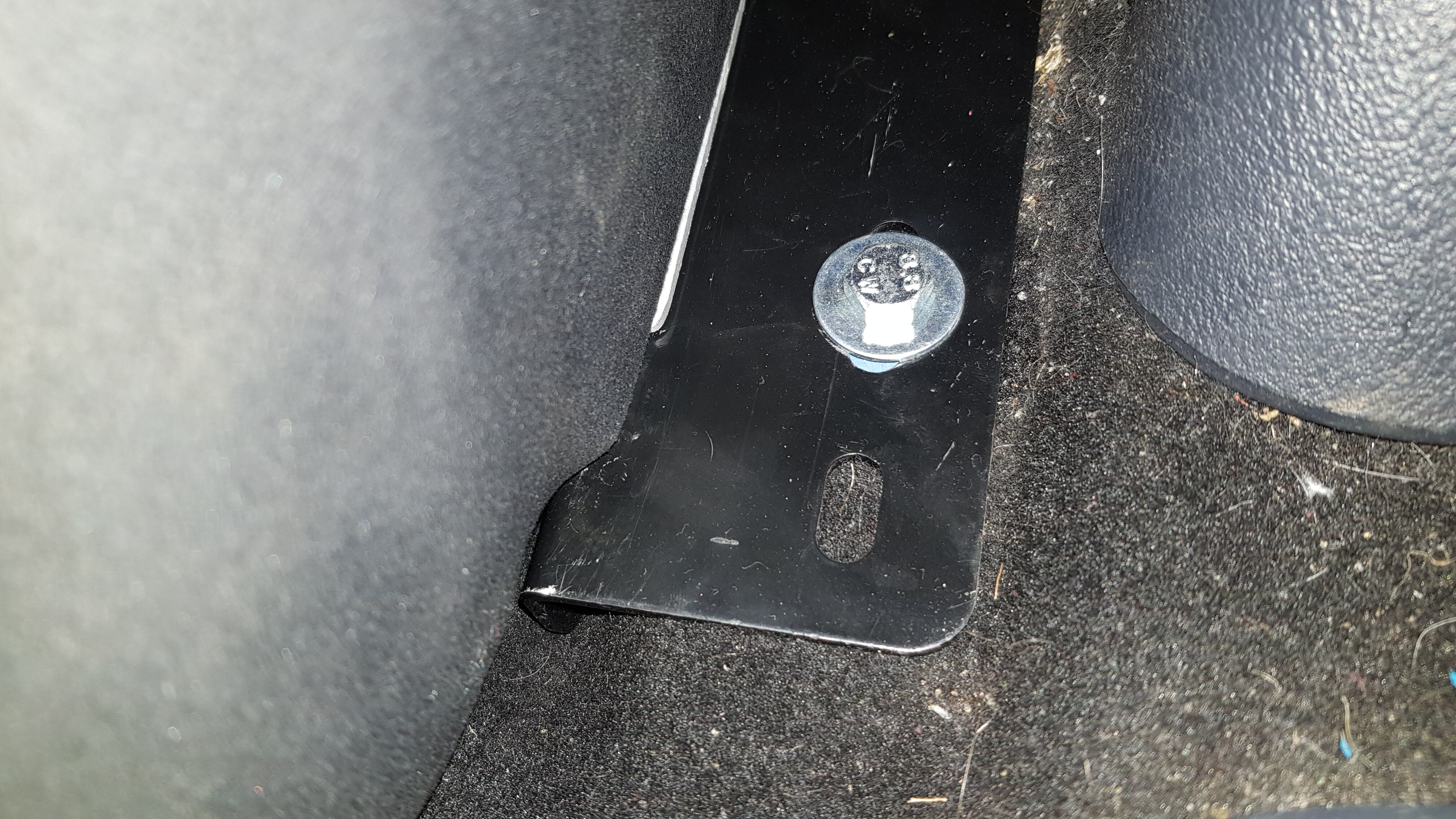

When I had Evo 8 Trendlines in my old RB, I bought the xlow bucket seat mounts and mounted directly to the subframes without runners. The underside of the seat needed to sit flush with the exhaust tunnel as the seat was too wide to drop any lower and still sit central to the wheel. But this allowed me to drop about 5 inches lower than the standard seat.

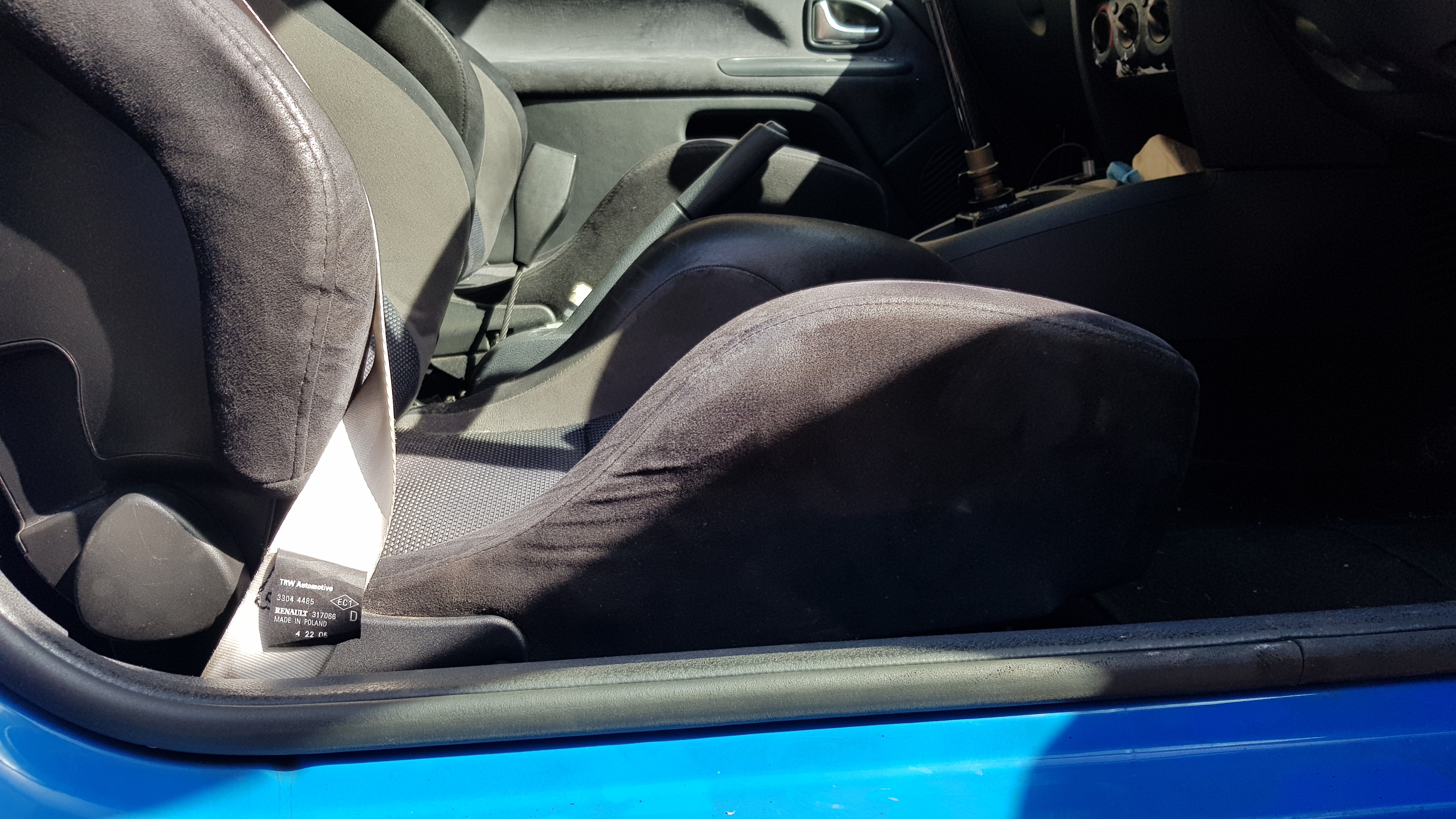

This is passenger seat in the background is using the jon foz recaro mounts vs the driver seat drop using the xlow subframes for reference

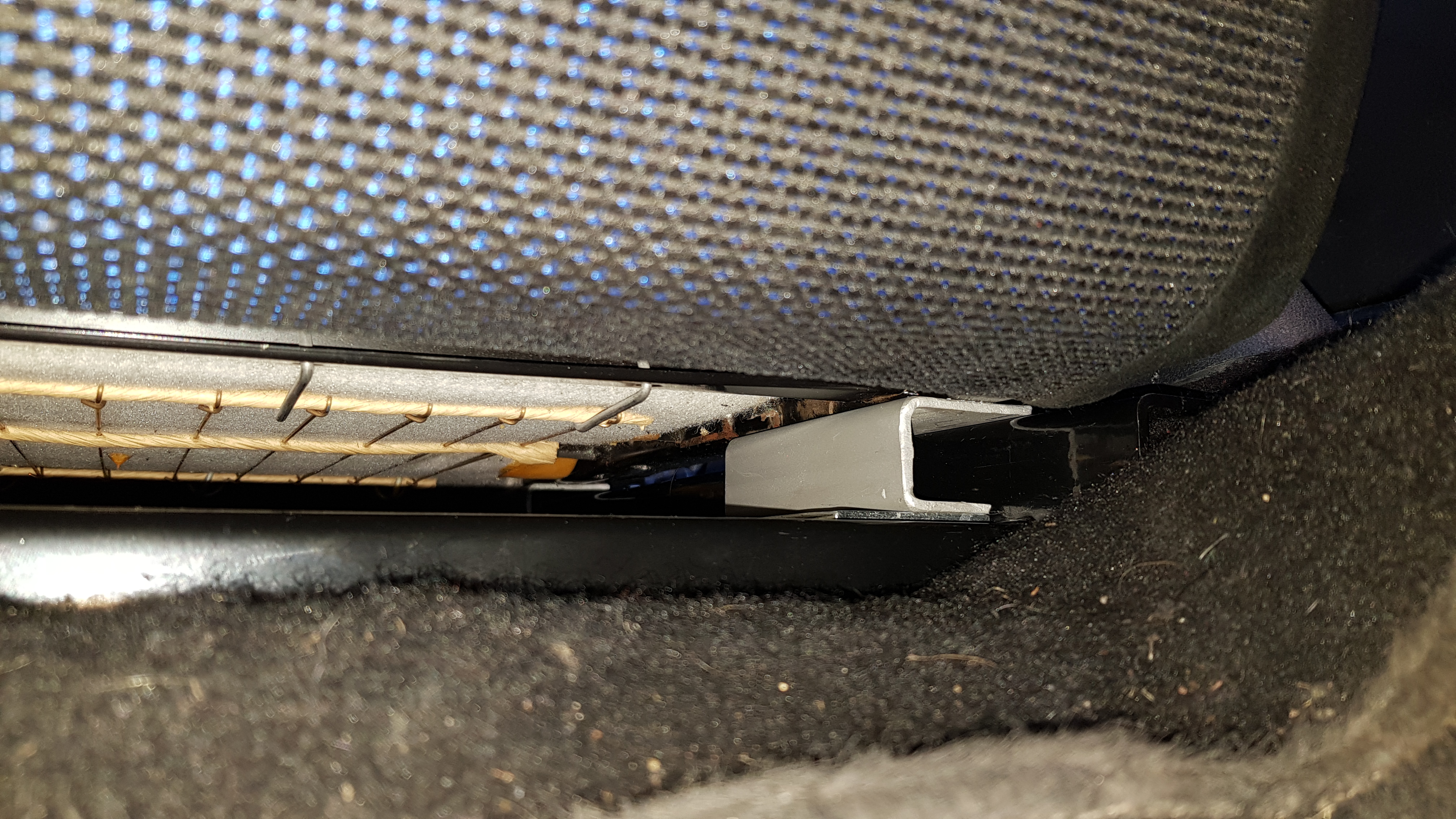

I needed to use some spacer to avoid clashing with the exhaust tunnel, so a section of 25mm x 40mm (may have been 30mm deep) box section was cut, with a 3mm washer underneath.
And from the top the seats were a few mm too wide hence this was the lowest they could be mounted and be central to the wheel
I can't find any pictures of the belt buckles, but i used a Pug 106 buckle and fixed to a eye bolt through the subframe and tunnel with spreader plate underneath.
