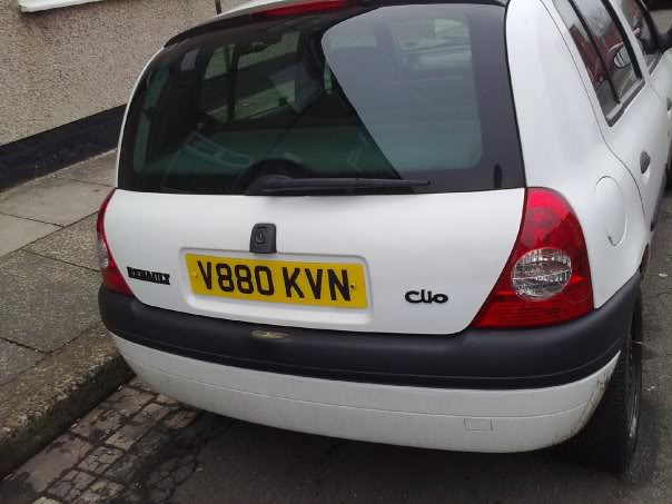

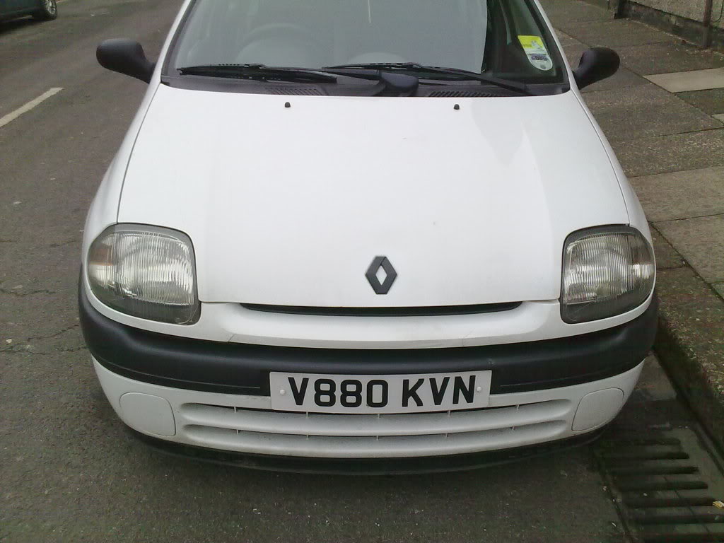

Im thinking of painting my bumper strips gloss black has anyone done this?
