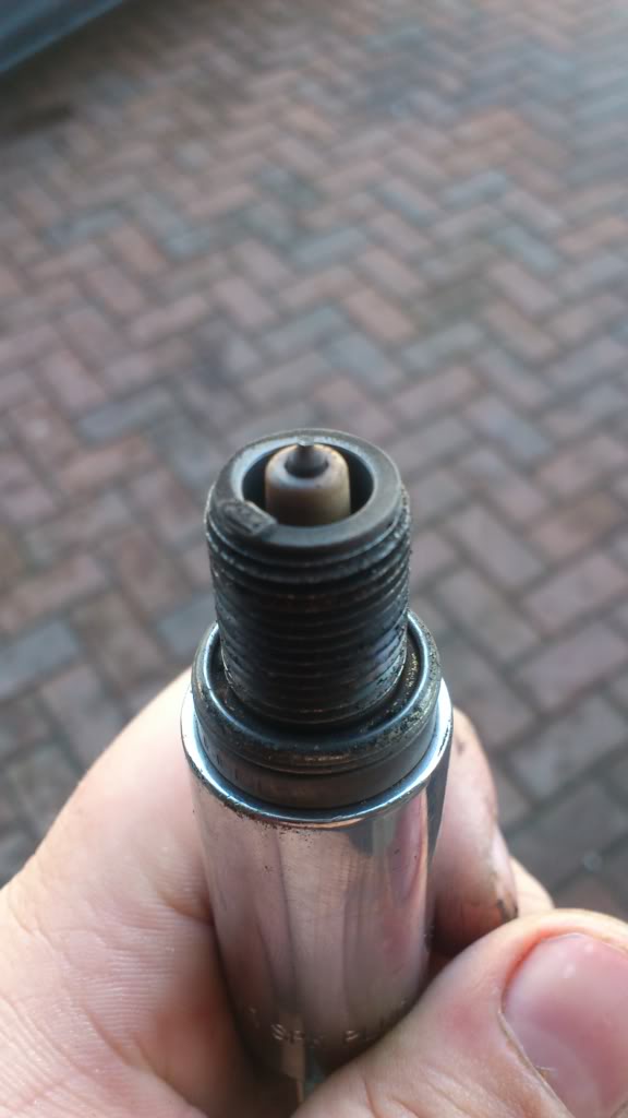

miss fire has been doing my head In for ages plug leads coil packs even gone and bought injectors but today I thought ill rip it apart as I was looking for a new engine lol I kept saying it cant be the plugs there only 2 month's old then pulled one out the one Id had problemsmwith the lead coming off and
boom found this
That'd cause issues....
Is the snapped off part now inside the engine?
well what I could see down the whole looked fine nice and smooth and they where the ngks oem ones and hopefully im one lucky f×£k and it go out the exhaust but I cant feel any loss in power
