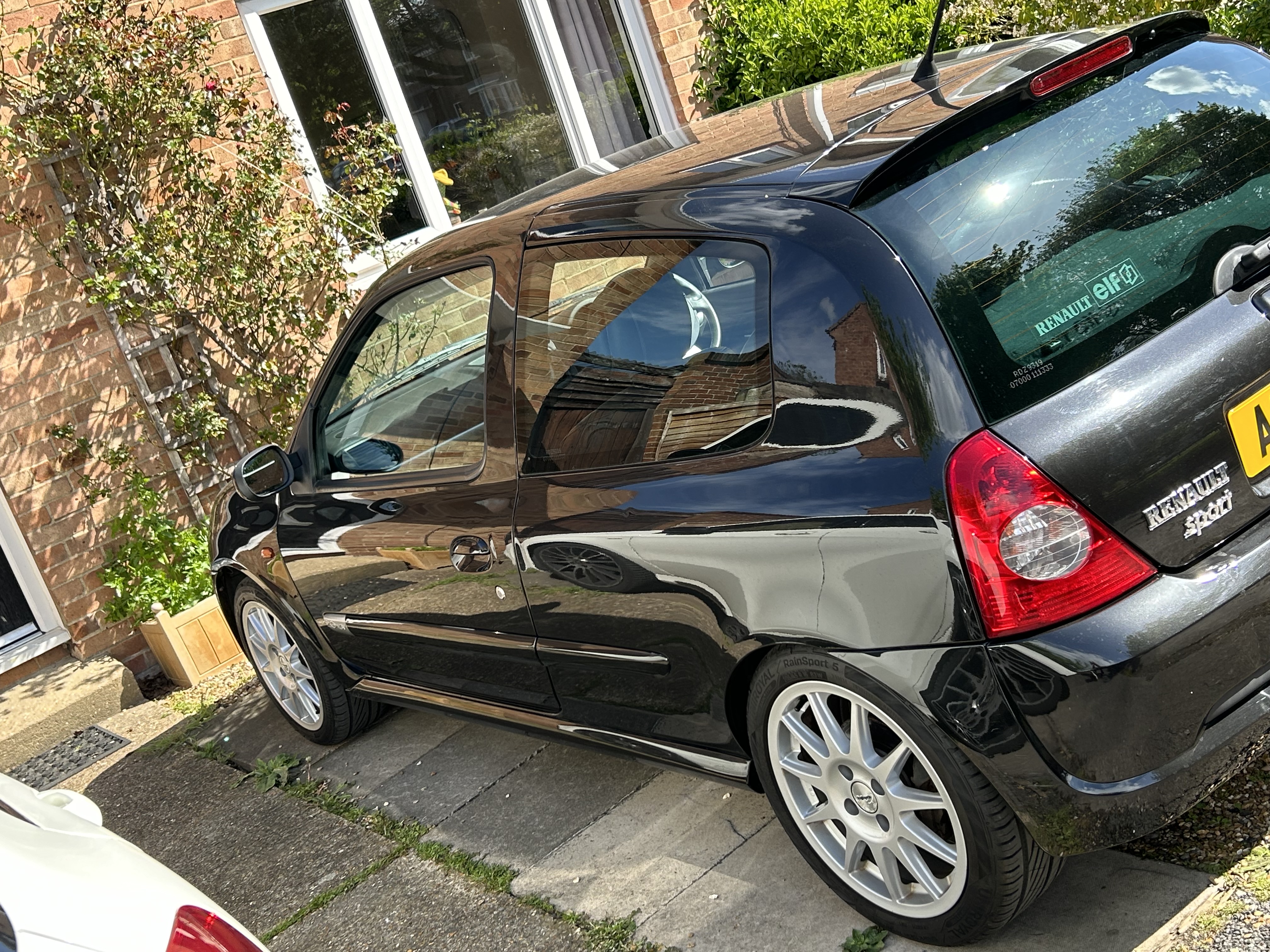

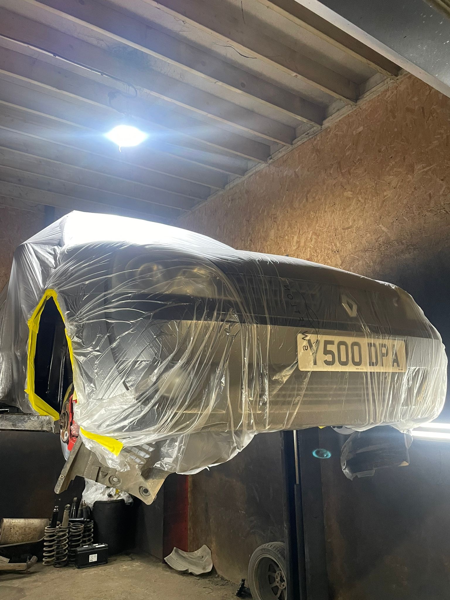

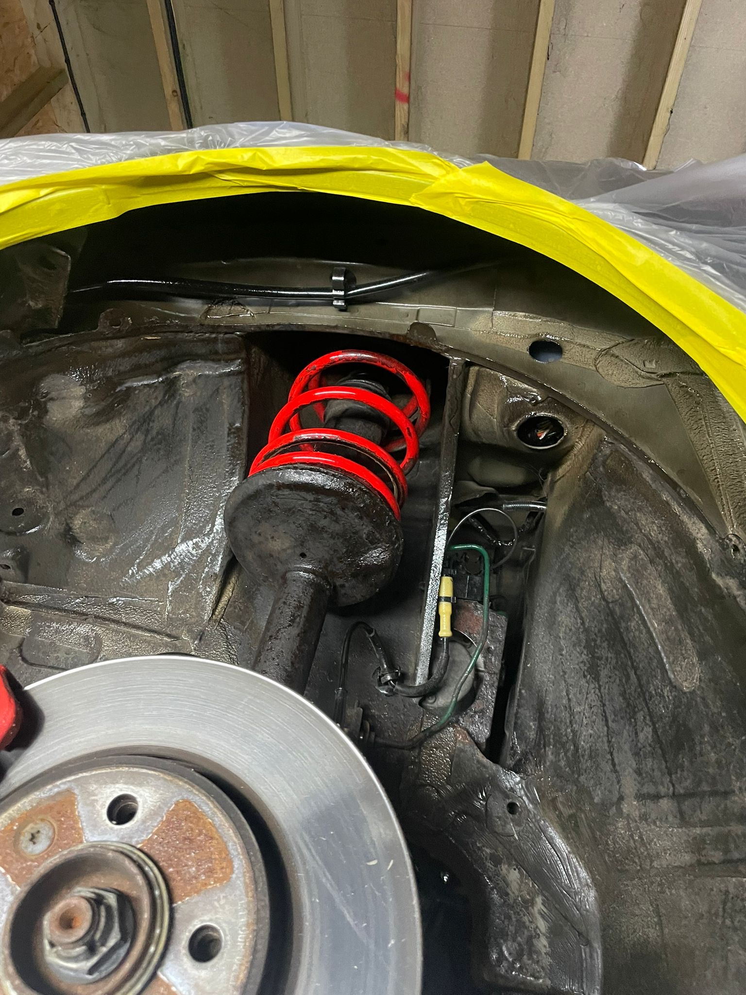

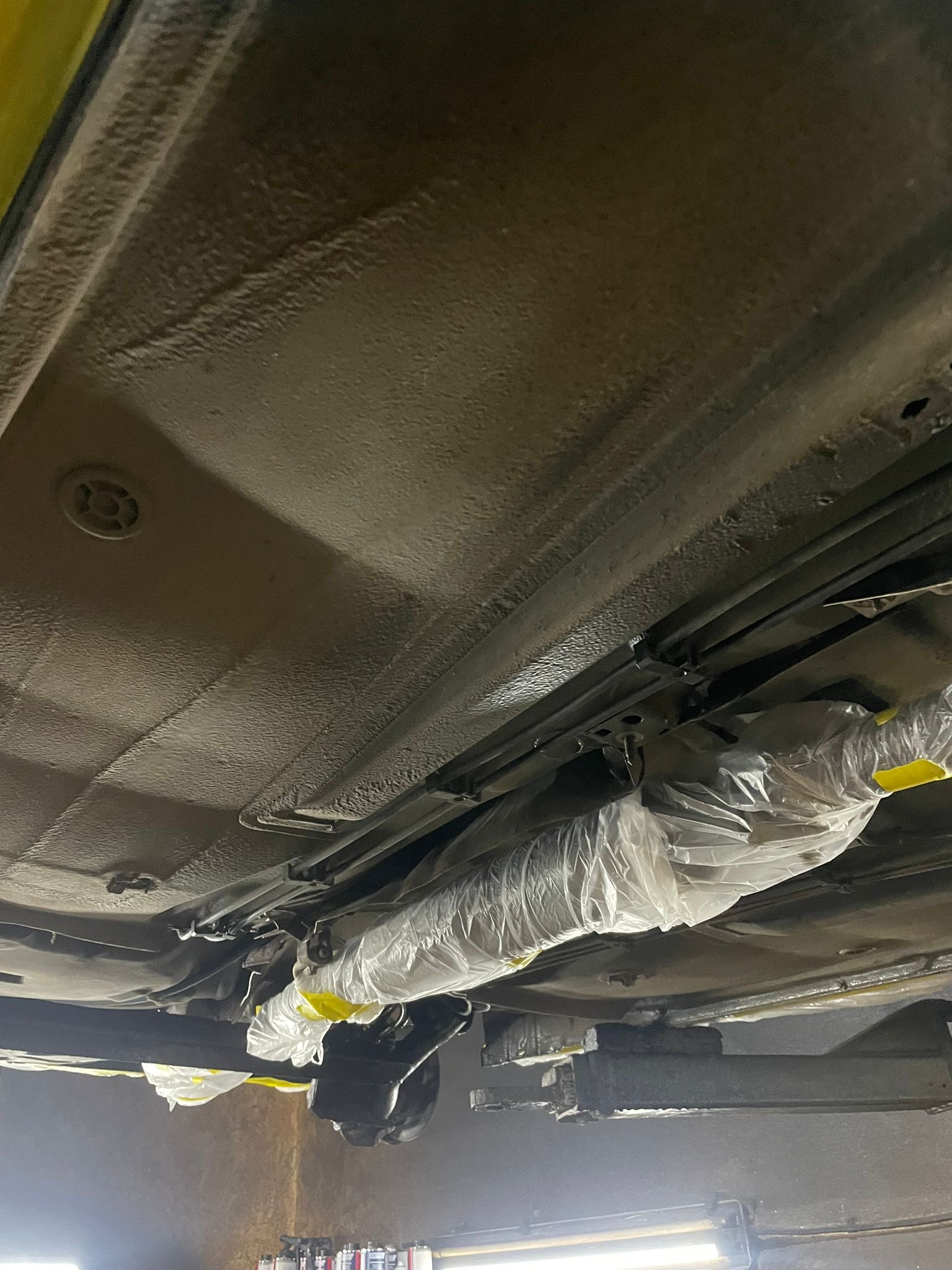

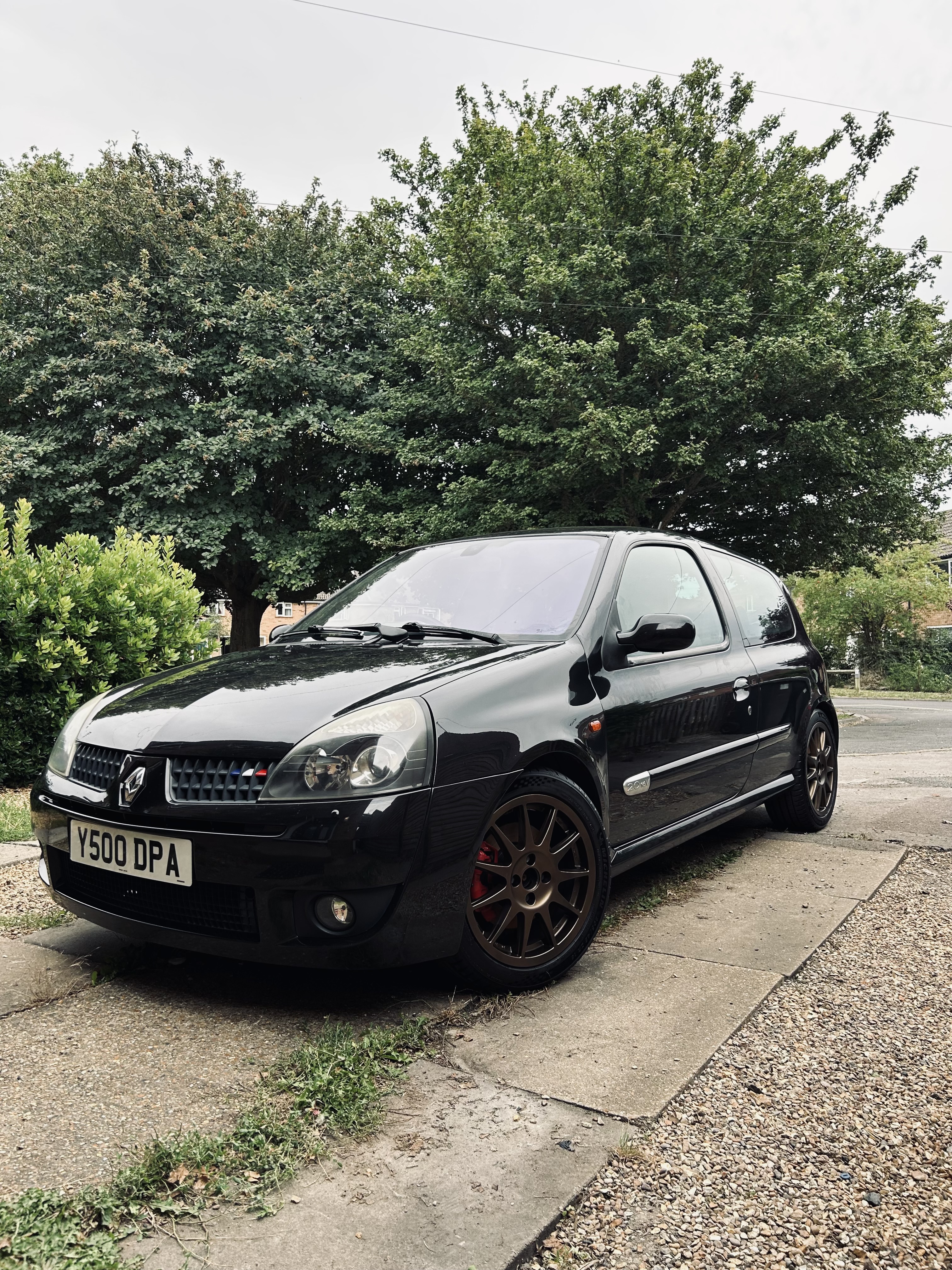

Hi all,
This is my daily and I have owned this car for about 2 years and realised I haven’t done a thread on it.
When I bought it, it was in reasonable condition but needed a lot doing.
In my ownership it has had the following (most work done by Alex at AW Motorworks):
* Induction kit
* Vibra technics engine and gearbox mount
* Timing belt/Aux belt/dephaser and water pump
* Polybushed throughout (purple/black mix)
* Came with a questionable JB5 gearbox, replaced with a JC5 with Blackline LSD (+ new clutch and rear main crank seal)
* Refurbished and powder coated wheels
* Michelin PS5 tyres
* Replaced headliner from a 182 as original had sagged
* New cup rear shocks (it is sitting on Eibach springs)
* All sensors replaced
* Camber bolts running about -2.5 on the front
* Fastchip RON 98 map
* Underside and engine bay blasting
* Aircon delete using the PMS kit + new alternator
* Alpine stereo and speakers
* All new injectors, spark plugs, coil pack
* Lambda sensors replaced (still on OEM cat)
* Brembo discs and mintex 1144 pads
* RBF 660 brake fluid
* Braided hoses front and rear
* Replaced handbrake cables
* KTEC stealth exhaust with resonator
* Stock interior
* New clutch cable
* Removed sound deadening from engine bay
Some photos from when I got it and now:
Since I sorted out all the common issues, it hasn’t missed a beat! Currently on 107k, healthy engine pulls great!

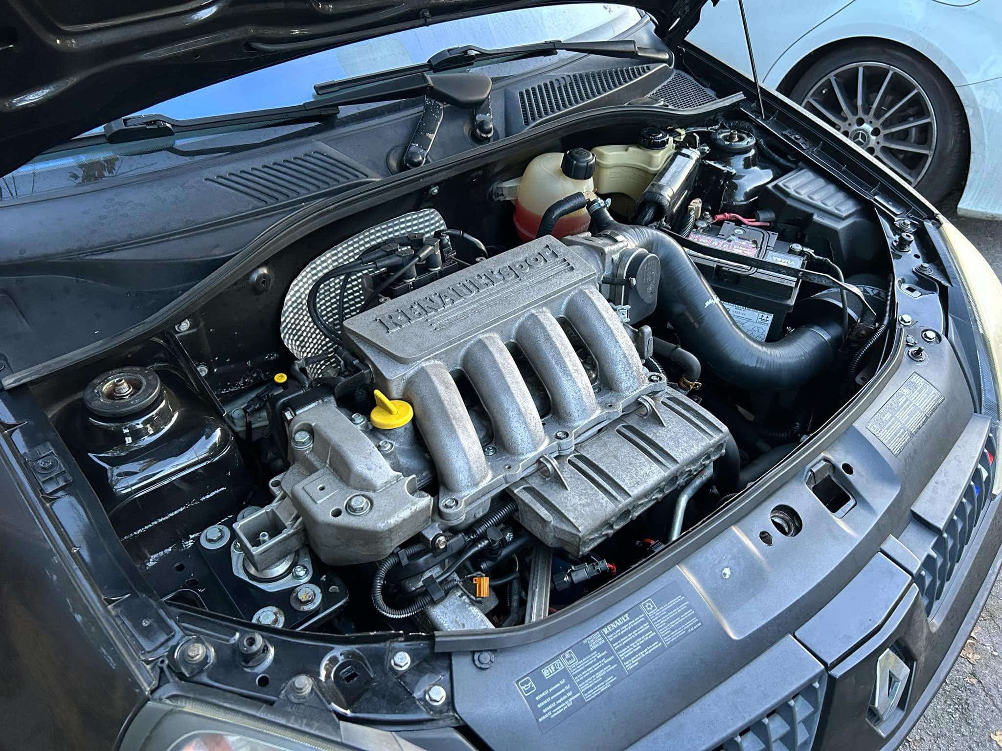

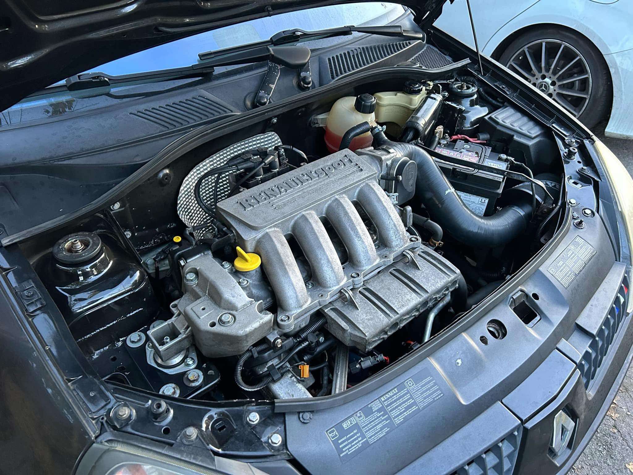

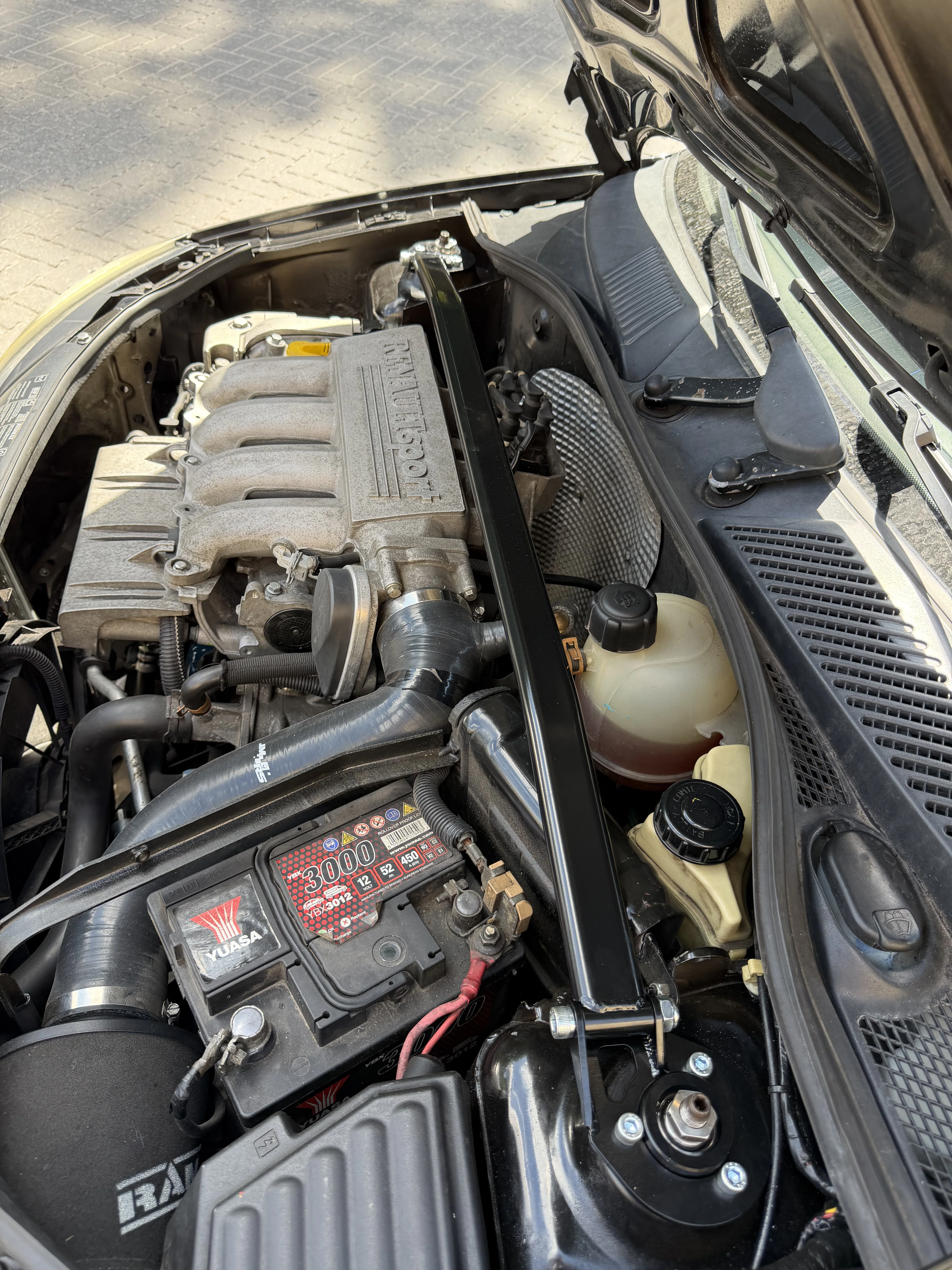

When you installed the PMS AC delete. Did you remove the AC evaporator unit on the drivers side? (As the expansion valve is missing on the bulk head).
Nice work!
Yes indeed, the plate has been changed as well on the bulkhead. In that photo of the engine bay, AC was only partially removed (the compressor was still on the aux belt, it was before the PMS AC delete kit was fitted).
Ah right.
Got a cup spec AC delete on the shelf pending install. Im assuming you get these bulkhead plates from non AC cups and povety spec clios. May need to look at shipping one over.
If you removed the AC evaporator behind the bulkhead. Doesn't this include the blower? Meaning you need to replace the whole unit? Or can you just split the unit apart and remove the evaporator separately?
*Apparently you can't fit 172cup style blower on FF 172/182's: https://cliosport.net/threads/172-cup-blower-into-a-182-cup.816051/
Ah right.
Yeah I think the idea is to remove the ac evaporator and blank it, have a look at https://www.pure-motorsport.co.uk/d...te_kit_instructions_with_standard_pulleys.pdf

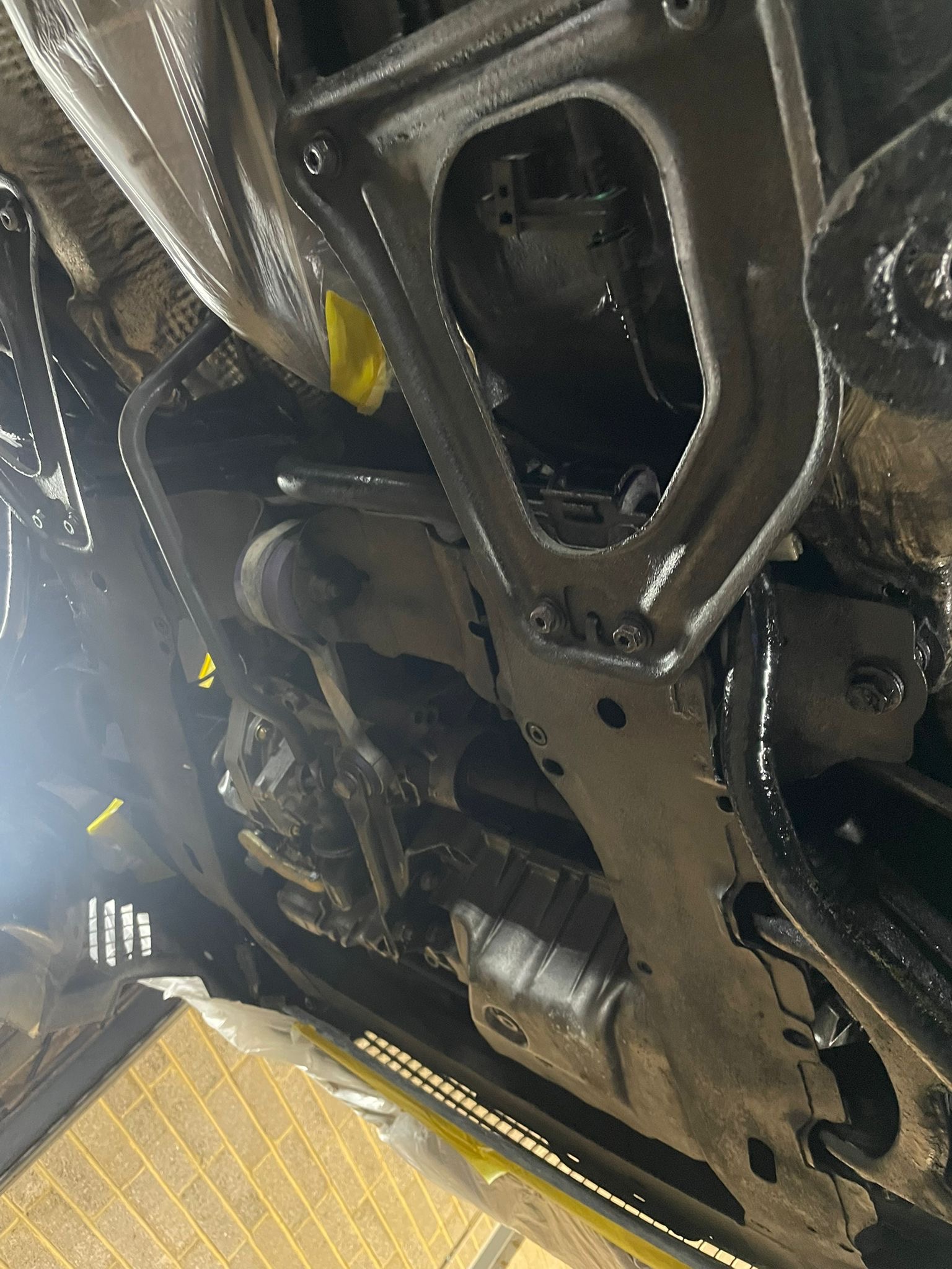

Car wouldn’t start after a long drive. Starter motor solenoid is cooked. Previous owner didn’t fit a heatshield. I got an aftermarket bosch unit along with a heat shield.
Looking forward to doing this on the drive..
Yeah, nothing like working on old clios in less than ideal conditions. Weirdly I actually prefer working on the Clio to my alpina, the engine bay is less crowded with s**t. But it is rustier.
We all need a Sreten (M539 restorations) setup really, don’t we.
Good luck with the ballache you no doubt have ahead with the starter.

The problem with the Clio starter is removing the bottom most bolt. It's very hard to reach, and in my experience only seems possible with a spanner, not a socket.
The heatshield is a real pain to install/uninstall, clearance between subframe where it bolts to and the anti-roll bar is too small to get your fingers in there without developing arthritis mid-job and the angle is so awkward that not even a spanner can locate. When I've had to remove it, I try to loosen the 2 bolts (10mm I believe) with a spanner even if it slips out from the awkward angle just enough to loosen the torque, then make a pincer with my thumb and pinky to loosen it the rest of the way, and when doing so you'll curse Renault for adding such a long captive thread for such a simple shield! 😅

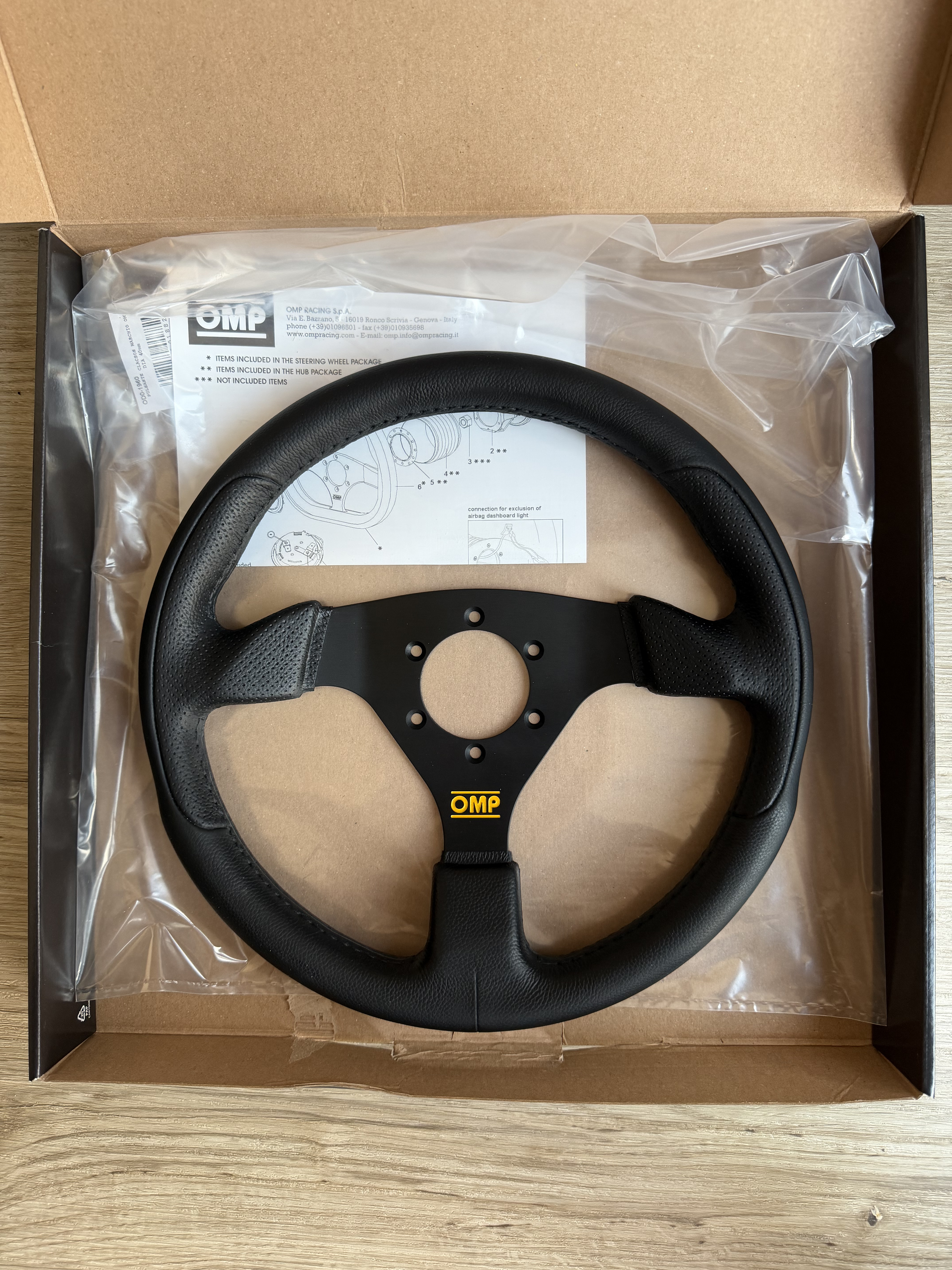

I’ve got the same wheel, used the buttons below for the horn, plugged in and worked perfectly.
Thanks for that, just bought the buttons 👍
