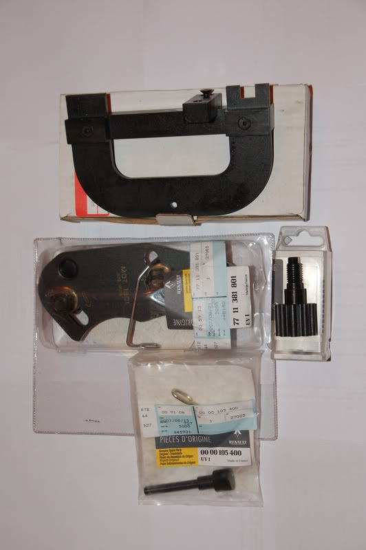

you've got no chance without the tools

I got the nut undone on the other one just dont have an alan key big enough so need to know the size so i can buy one

but i would not be taking that cover off if i were you. the cams are spring loaded into the head via the cover,
have you locked the crank at TDC?

the engine will be completly out of time, before you removed the belt you should have locked the cramk at least.

i havent removed the belt yet all i have done is loosen the slackening nut and the nut on one of the wheels. im not an expert and dont know why taking the cover off is such a big problem. i had a qaulified mechanic with me at the time and he did not mention that there would be a massive problem. just that it would need to be retimed when it was put back together

well im sure the tools will be used then! im not retiming it and im sure the place that is will have the tools

if its timed up correctly, the tensioner is set correctly, and if he hasn't damaged the cams or the camcover then it'll be fine
but it sounds like he's tried to remove the camcover without removing the pullies = bad
cams should be left to the experts imo! I'd do pretty much anything, but thats the one part of the car I leave well alone.
